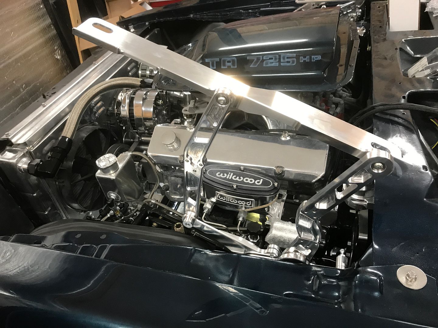

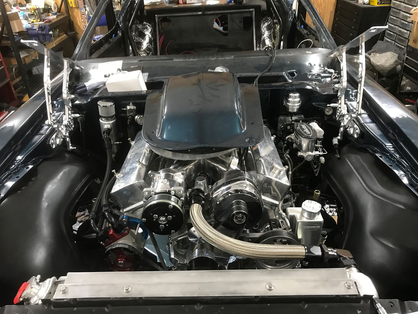

Bought some Ring Brother's hinges to finish off the under hood look.

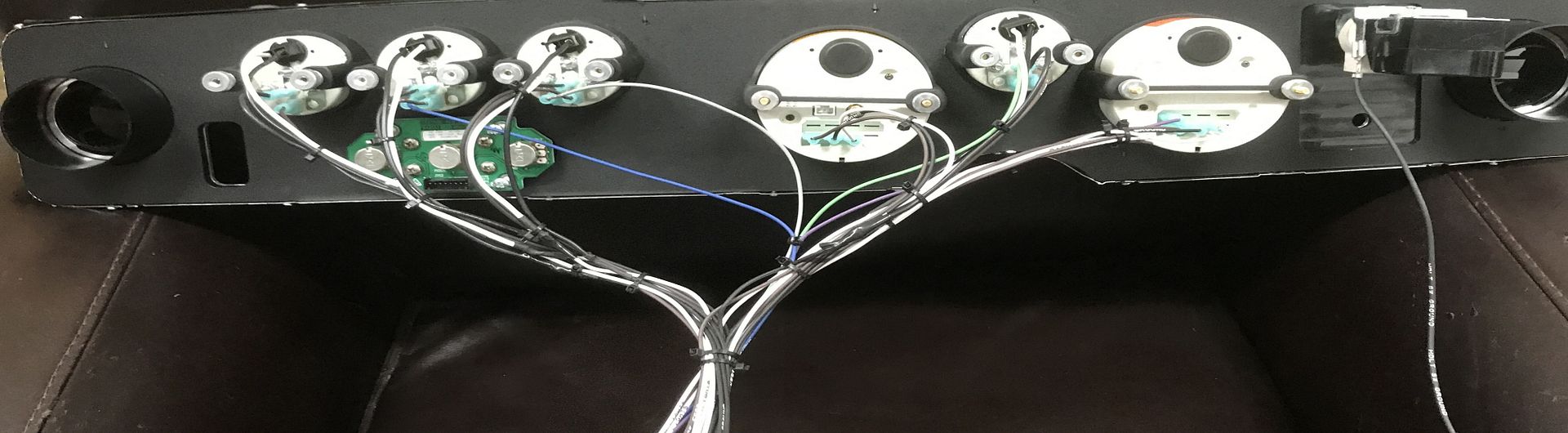

The Custom Bezel is now wired up with new gauges.
http://i213.photobucket.com/albums/c...psg9xjpdjo.jpg
http://i213.photobucket.com/albums/c...psj6rn3fwi.jpg

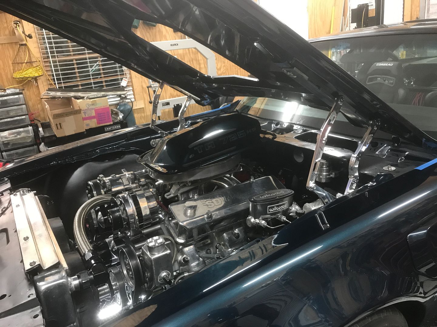

Hood is back on after all this time!
http://i213.photobucket.com/albums/c...psi12dfjoq.jpg
http://i213.photobucket.com/albums/c...pssbe8lnqm.jpg
