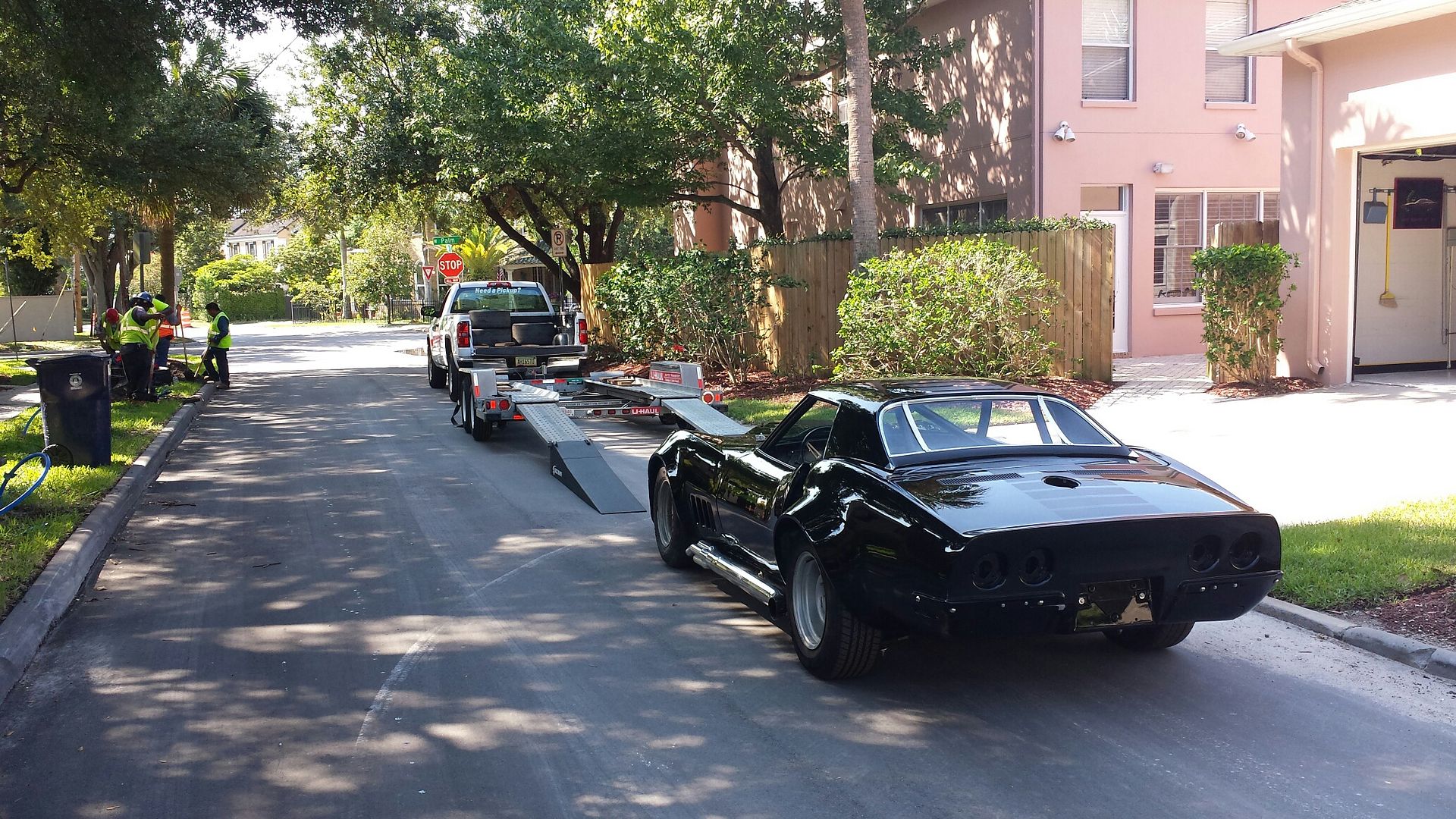

Well, after 8 months of having to find a new roll cage fabricator, an emergency out of town work assignment, and a city water main replacement project in front of my driveway, the car finally came home today. I'm looking forward to the wiring and interior project, as I have never done that type of work before.

WSSix 09-08-2016 05:52 AM
Congrats! The car looks great, Neil. Be sure to document your wiring so you can trouble shoot it in the future without having to trace all the wires.

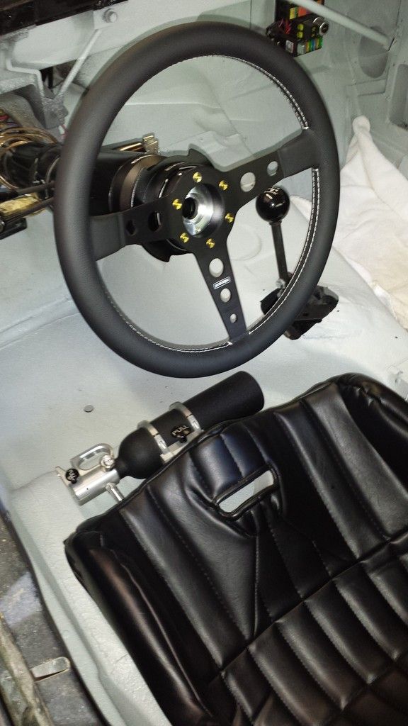

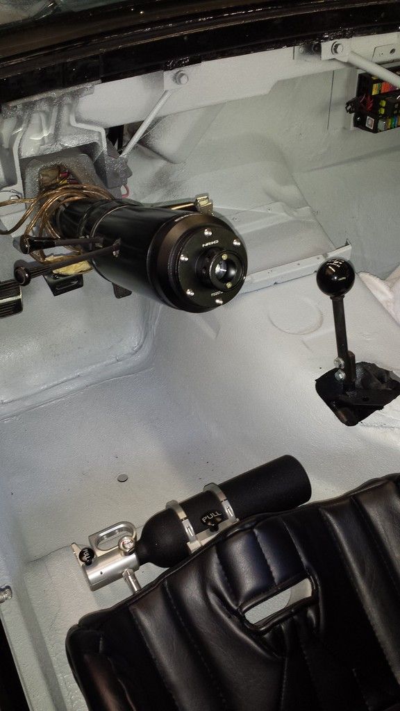

Here is the mock up of the driver's seat and steering wheel. I chose a Momo Prototipo wheel and mated it to an NRG short hub and quick release. The quick release was a must-have with the Kirkey race seats and side pipes. I will be using the stock Tilt/Tele column. The tilt mechanism had some play in it so I pulled it out and replaced the lower knuckle/lock shoe pins, column sphere, and upper/lower bearings. I'm retaining the turn signal switch but the ignition and starter switches will be relocated to the dash.

Blake Foster 10-04-2016 01:50 PM

Neil B 10-04-2016 01:57 PM
Originally Posted by Blake Foster (Post 646688)
is that the C10 Tom argue built with our Chassis in it? in the back ground?
DUH. look one more post down before you start asking stupid questions!!
Yes, Tom did the paint and misc. fabrication on my car. That C10 is badass.

syborg tt 10-04-2016 08:15 PM
Evening Neil,
What a great looking project and thank you for sharing the build up.
Also this post has finally confirmed it that is exactly the steering wheel I am looking for. I guess I will give old Tommy Boy a call in the morning and tell him to order one up for me.
http://i162.photobucket.com/albums/t...psbse94jf0.jpg

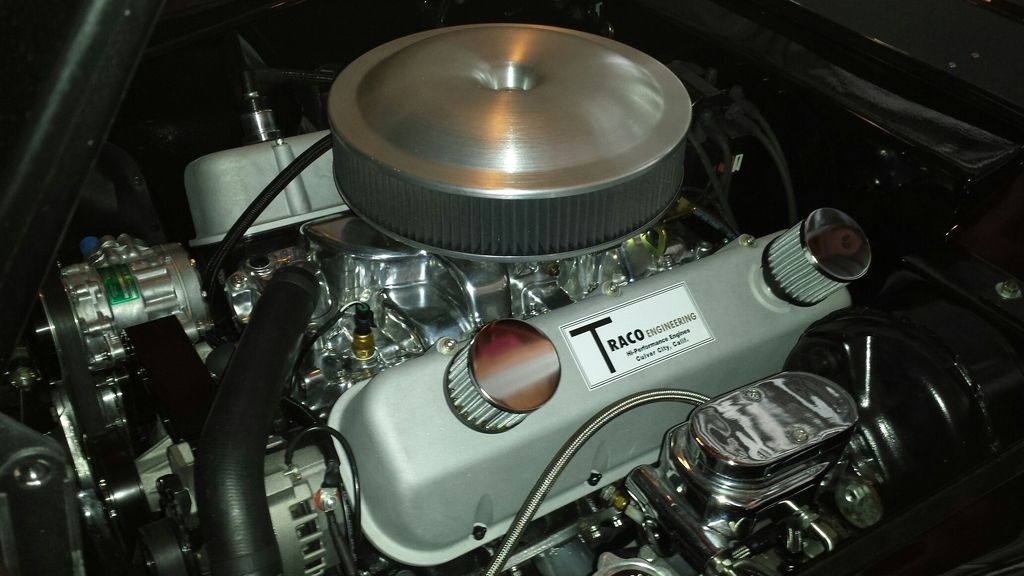

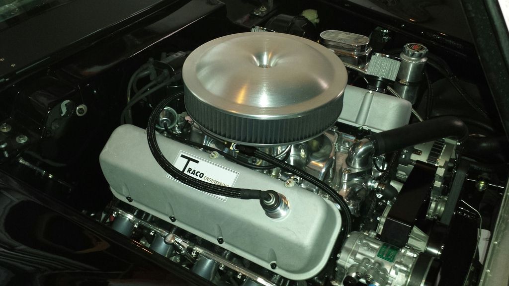

I just completed lots of little odds and ends under the hood. Not a trace of Pro Touring in here... just old school hot rodding. Here is the finished engine bay.

66tintop 12-21-2016 10:29 AM
Old school ( sort of ) still works today !!!!
Awesome corvette , excellent project ! Love it all ! If I may ask who makes the valve covers or are they vintage ?? Thanks for sharing!!!!
Neil B 12-21-2016 11:48 AM
Thanks! I really struggled to find a set of valve covers that fit around the booster and had the right look for my project. I ended up finding these which are made for offshore powerboats by Hardin Marine. I bought them raw and had them media blasted.

Valve covers
Thanks for the valve cover info, much appreciated and enjoy your corvette ! Perfect c3

badbu68 12-22-2016 09:01 AM
Like the look of the raw casting valve covers, always a fan of vintage looking modern tech.

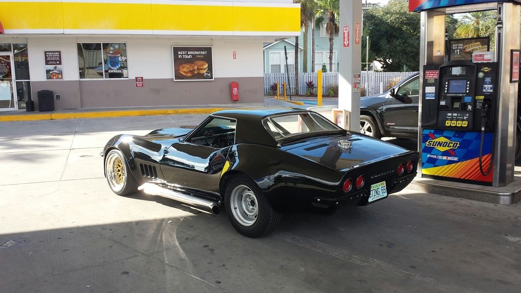

Today was a perfect day outside, so I finished up a rough alignment and Hoosier'd up! Here is her first 'real' drive. I got about an hour of run time on it. The car will be going back to Tom Argue this week for a few little things while I work on interior prep items back at home.
