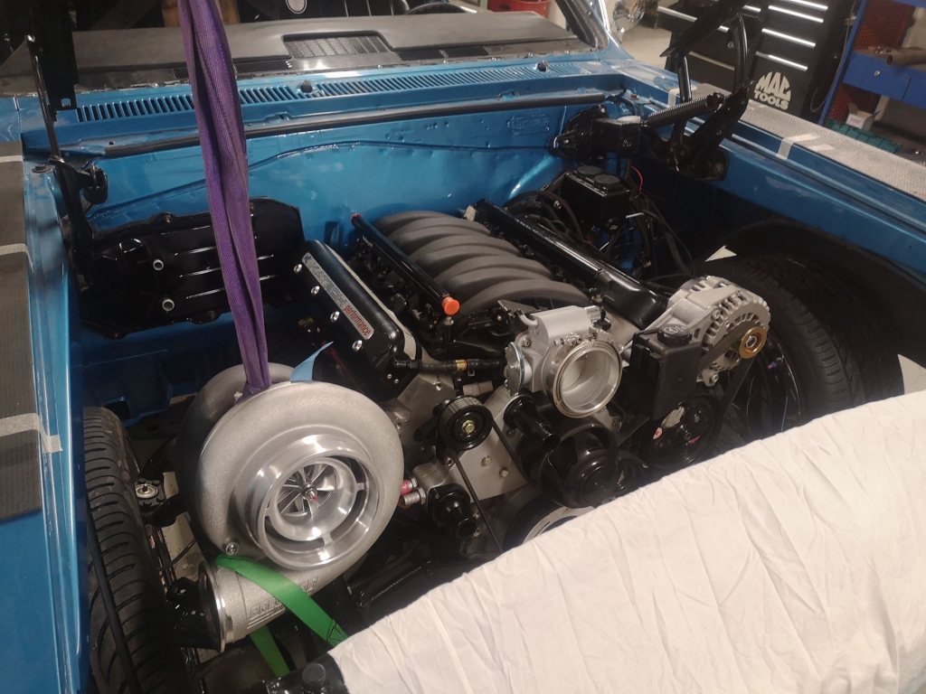

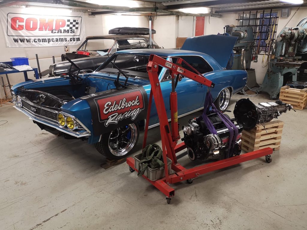

https://rejsa.nu/im/user/8648/2019-1...04abffd9d.jpeg
Engine in place, new Bosch 1300cc injectors also. This is planned turbo location :gitrdun:
Che70velle 10-19-2019 01:39 PM
That is a BIG turbo. Glad to see you making progress.

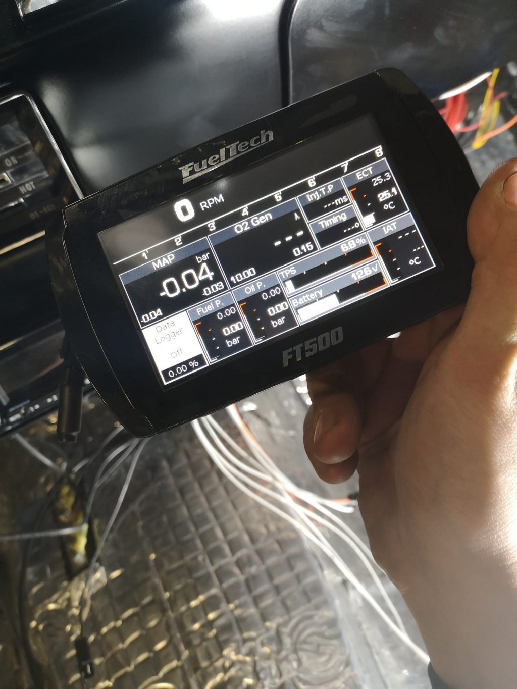

warhawkchevelle 11-22-2019 11:23 AM

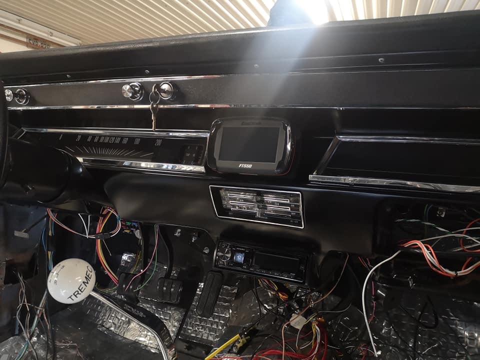

https://rejsa.nu/im/user/8648/2019-1...1fc1384fa.jpeg
Power on today, fortunately No smoke anywhere :D
https://rejsa.nu/im/user/8648/2019-1...09659ad05.jpeg

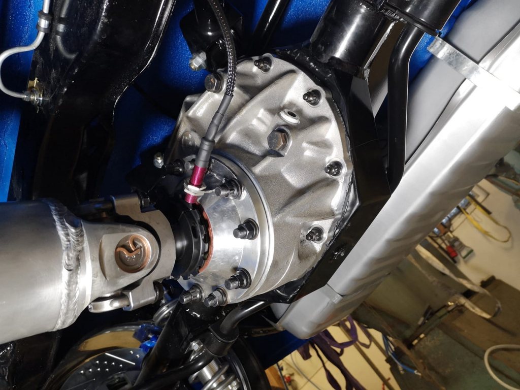

Triggerwheel and sensor installed and wired for traction control wired to the Fueltech 500 efi.
Brakes and clutch are together and bled.
I have more wiring to do before its time for interior.
Gotta install buttons in the steering wheels for rollcontrol and launchcontrol.

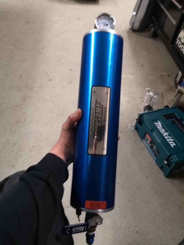

Engine primed with an Accusump today, worked perfect so I turned the key for the first time and had good pressare right away!
https://rejsa.nu/im/user/8648/2019-1...43a112e2e.jpeg

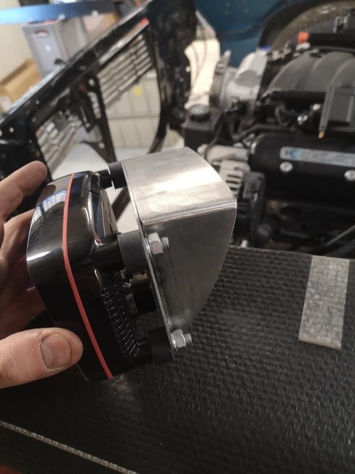

A buddy spent a couple of hours here today designing some small stuff that I need to get milled.
A block off plate for mapsensor with a connection for my LS7 manifold, so I can use the one built in to the Fueltech.

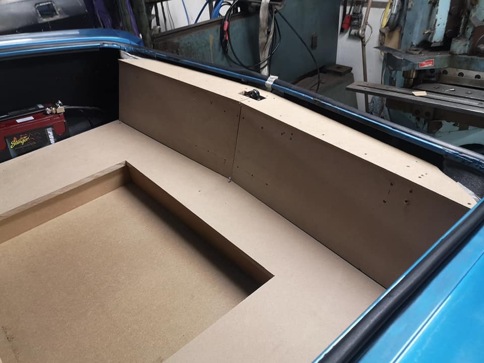

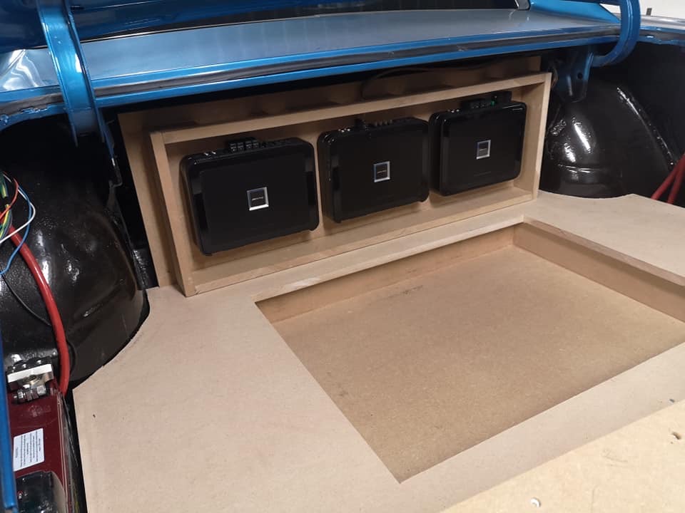

https://rejsa.nu/im/user/8648/2020-0...67c5eff3f.jpeg
https://rejsa.nu/im/user/8648/2020-0...e0be6fb69.jpeg
Had to take a break from all wiring and have started with some panels in the trunk.

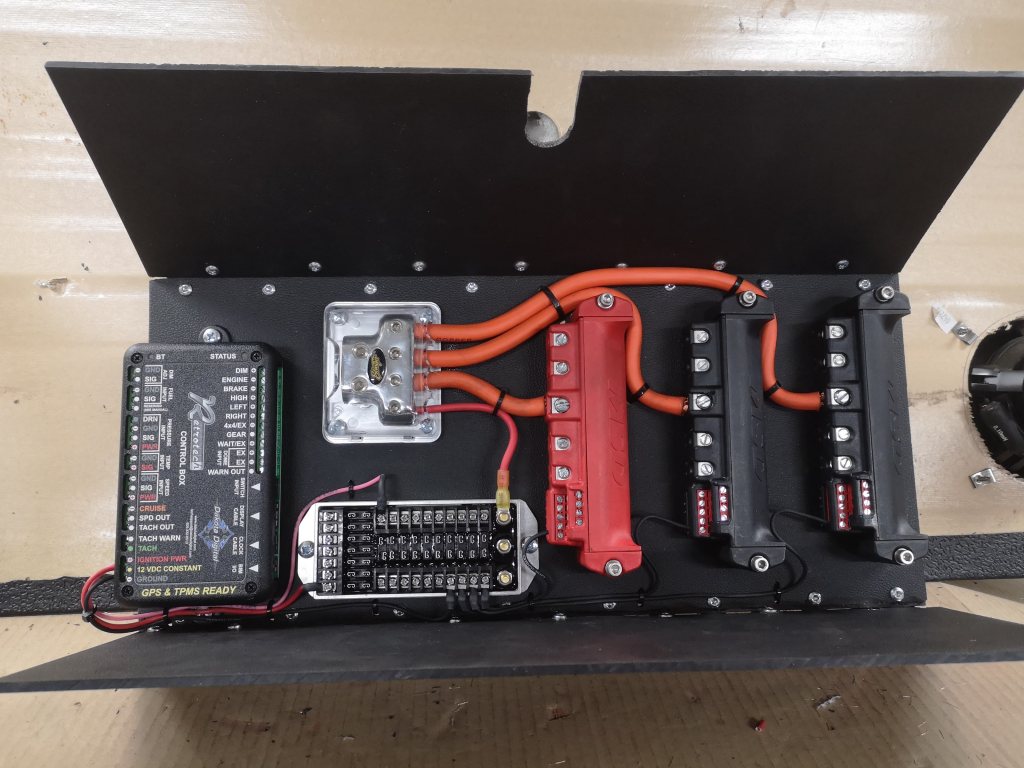

https://rejsa.nu/im/user/8648/2020-0...2c60d150c.jpeg
Lack of'progress is almost embarassing here :confused59:

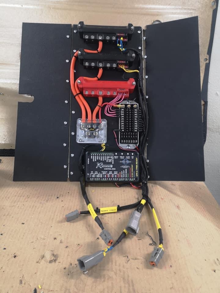

However, I made a new layout for the engine management wiring inside glove compartment.
Made a new one in plastic and have ordered a bunch of Deutsch connectors to wire it up completely before install.
waynieZ 03-29-2020 11:33 AM
Nice neat job! It looks great.

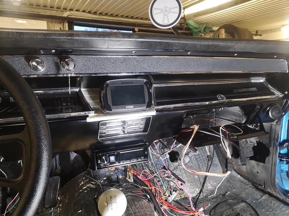

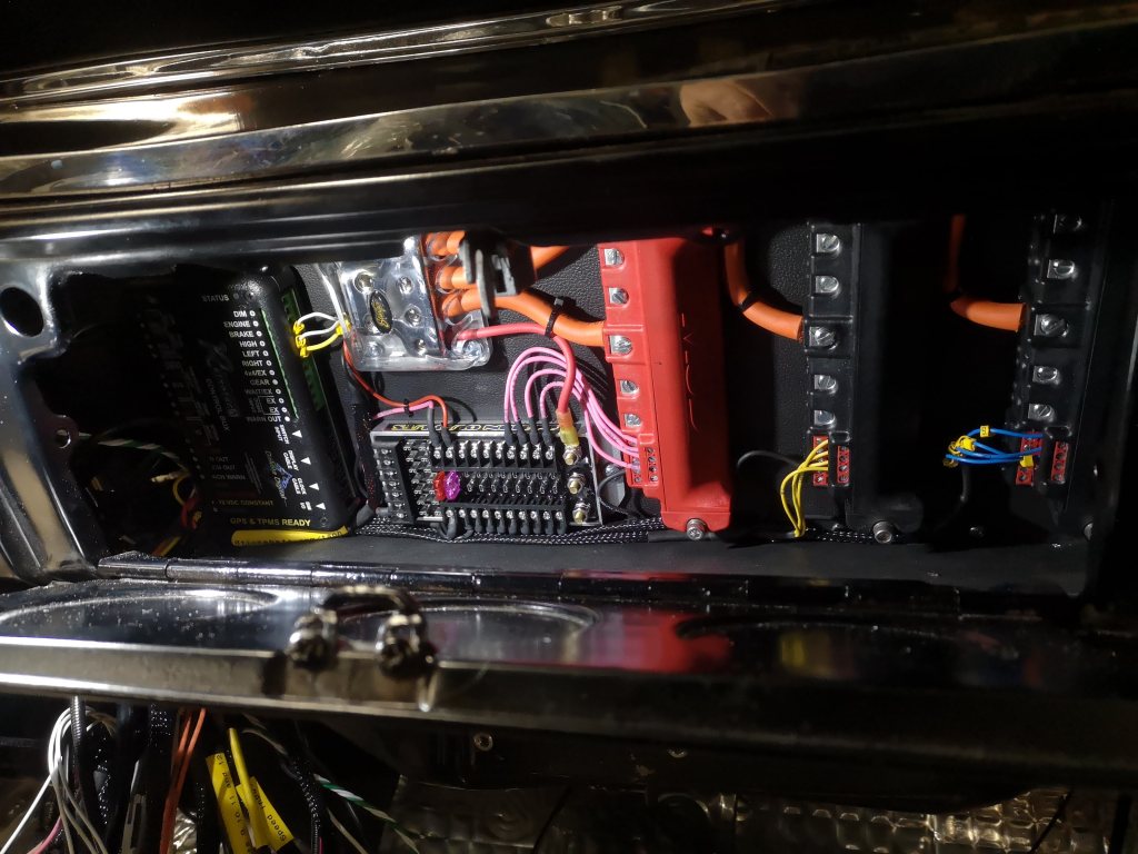

https://rejsa.nu/im/user/8648/2020-0...c064e7409.jpeg
Ecu is installed and connectors plugged in, got some connectors left inside the car before I can connect the batteries.
https://rejsa.nu/im/user/8648/2020-0...516981bd2.jpeg
This is wired and ready for install. Power and ground cables are in the car and ready to connect.
WSSix 04-04-2020 05:28 PM
Very clean! Nicely done.
