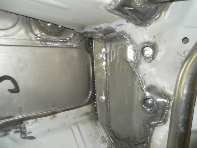

Goosesdad 07-09-2017 09:27 PM
4 Attachment(s)
Pretty good progress this weekend, passenger side is complete. Spent a fair amount of time doing some clean up of the driver side just to ensure complete symmetry.

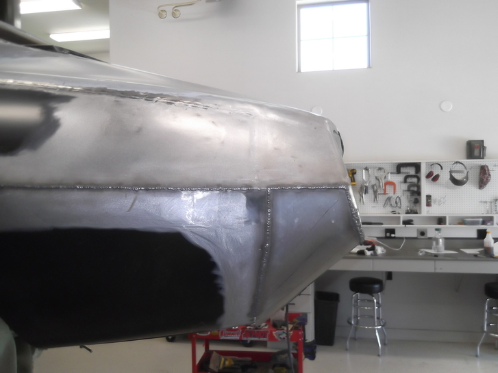

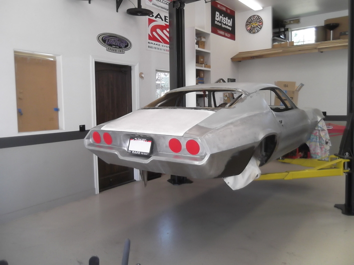

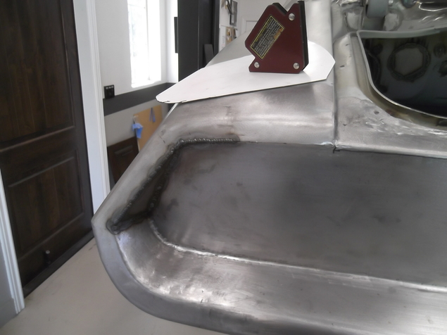

Goosesdad 07-30-2017 07:06 PM
4 Attachment(s)
Pretty light progress lately but finally mostly finished the new tail section. Very happy with how it came out. Kept the original lines for the most part, just enhances them a bit to fit with the flared fenders.
Attachment 62756
Attachment 62757
Those aren't real tail lights...just some poster board painted red so I could make sure the placement looks right before drilling the holes. This is basically the stock location...basically.

WSSix 07-31-2017 09:07 AM
Looks great, John. Good job!
waynieZ 07-31-2017 10:45 AM
It looks nice, did you make the cardboard lights bigger then the originals?
Josh@Ridetech 07-31-2017 11:12 AM
Metal work looks fantastic. I love your garage setup too!
grendel 07-31-2017 06:16 PM
Awesome work man.
Glad I could push a bit :)

Nope, same size. I'm using the factory tail light lenses. Just looks like it cause I painted the paper cut outs all red...doesn't show the trim ring.

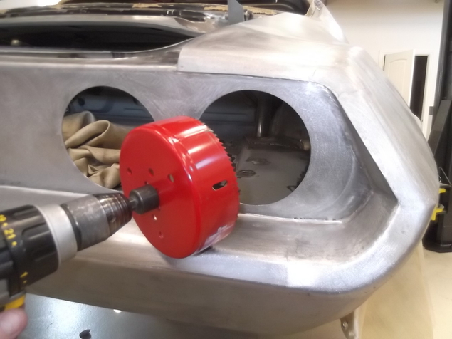

Goosesdad 08-19-2017 09:41 PM
9 Attachment(s)
As you can imagine, a 5 1/2 hole saw is a monster to hang onto even at low speed. I did weld a 3/16" plate behind the tail panel so the pilot bit had something to guide it.
Attachment 62891
Fab'd up the tail light housings. I couldn't use the factory ones because of all the tail panel modifications and I wanted to slightly adjust their location to fit better with the widened tail.
You can't see it in these pics but there is a rubber seal between the tail light lens and the body.
Ended up adding about 4 lbs extra to the car but didn't really have a choice, in order to use a rubber seal, the bracket needed to be relatively stout. Had the shapes cut with a plasma table and then drilled the holes, just to help with the the weight. LED lights will mount inside later.

Looking really good. A mag drill is your friend :).

It looks nice with the lights in there, your going to confuse a lot of people wondering what is different. I like it a lot, nice work.

Agreed, had one lined up for the weekend but got impatient.

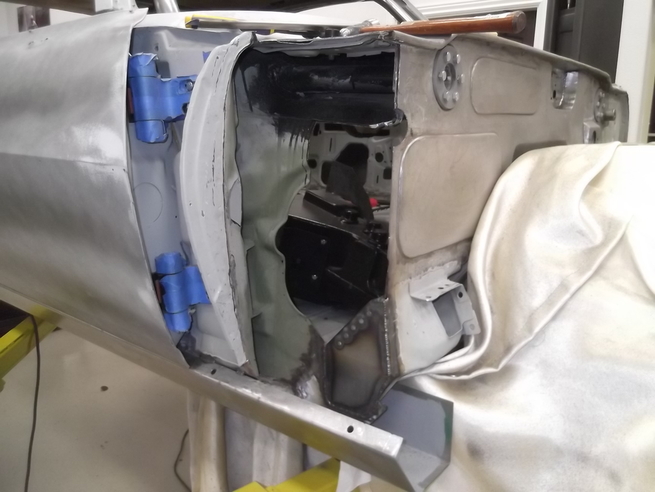

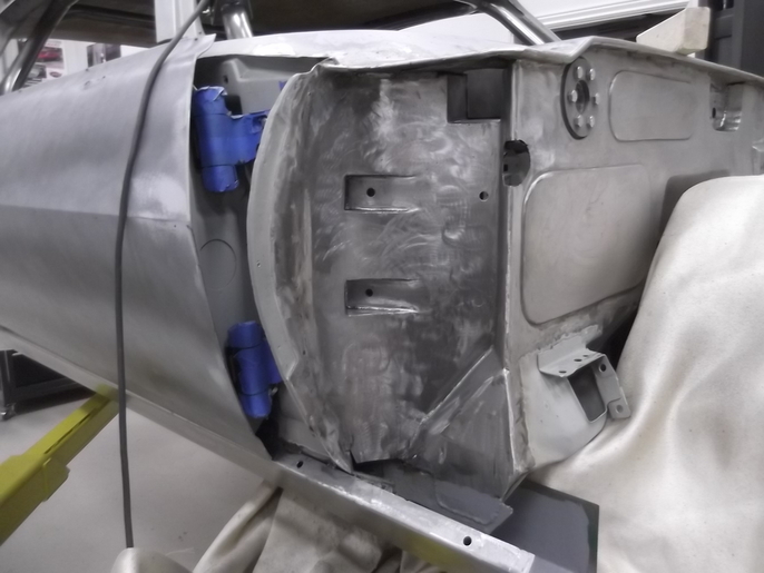

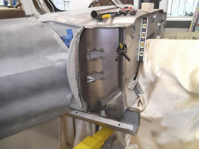

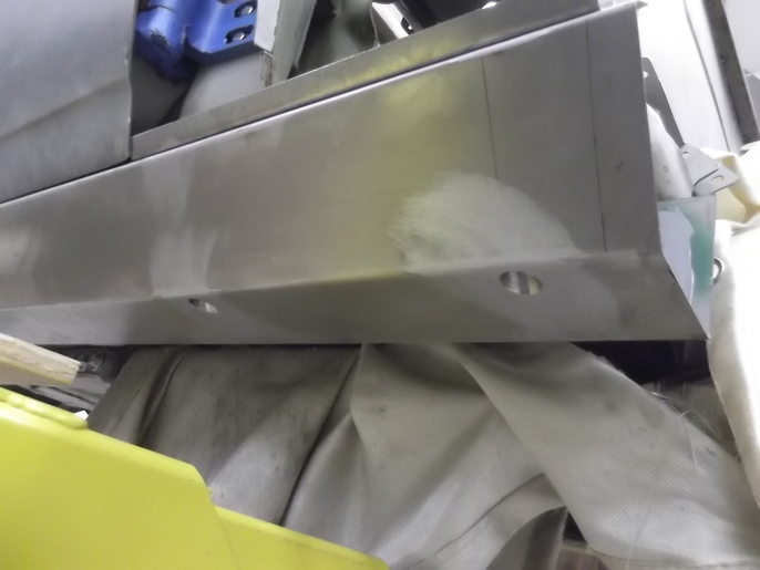

Goosesdad 09-04-2017 07:39 PM
4 Attachment(s)
Started on the rockers. I'm doing everything I can to seal up any access for water to get into the rockers but I did seal the insides of them up just in case. Will put a drain as well.
WSSix 09-05-2017 09:34 AM
Nice, John. I've been thinking about extending my rockers down to the pinch weld also when I finally get around to doing that work. My rockers need to come off to fix some minor rust issues anyway.
Goosesdad 09-05-2017 10:21 AM
Hi Trey. I kept a 1" wide sliver of the rocker that I bent up if you want to use as a template, glad to send to you, not sure if it will be exact on your car but it might give you a place to start. I kept with Dr. Hermance's concept of not flaring out the rocker but just letting the door line continue down.
grendel 09-05-2017 02:01 PM
I am waiting for mine to come back from forming... my rockers originally had a chrome panel, so I am doing that in CF and dropping it down to the pinch and including a flare for the rear tires... so they don't look so much like a "dually" with a 345 on the back...

dhutton 09-05-2017 03:38 PM
Awesome build and skills.
No matter what you do the rocker will not be totally sealed and moisture will accumulate. A couple of drain holes would be a good idea so that moisture can escape.

Goosesdad 09-14-2017 11:04 AM
Don
Thanks Don!! Yep, totally agree. I sealed the inside of the new rocker with Zero Rust before I put it up and I sprayed Eastwood's frame rail seal inside the existing rocker. I decided to leave the existing rocker as I don't think the weight savings was worth any potential chassis rigidity. I will include some drains....I agree with you, these areas seemed to have been designed to gather as much water and debris as one could find! - I wish I had picks of the leaves I took out when I stripped the car!

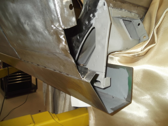

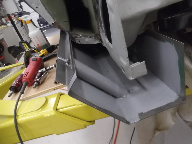

Goosesdad 09-14-2017 11:11 AM
2 Attachment(s)
Started finishing the rockers.

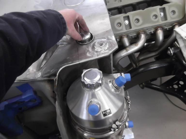

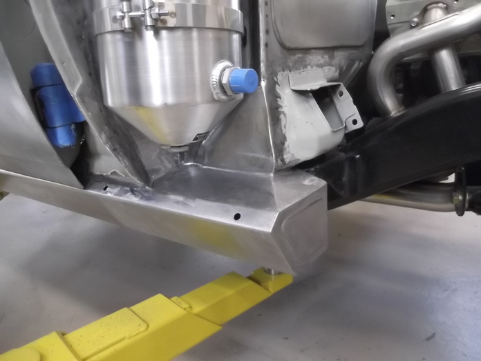

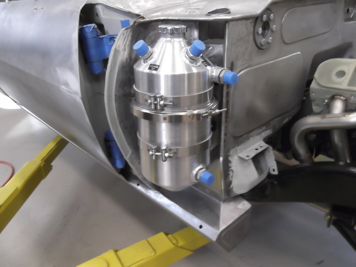

Goosesdad 12-30-2017 10:23 PM
10 Attachment(s)
Combined the install of a 2.5 gallon oil tank with finishing the fab of the extended rocker panel. Thanks to many here...Steve, JJ, Tim McGilton and others for the concept and advice!
Attachment 64069
Used a 1" tube through the rocker to provide access for a bolt to attach the front fender. Even though I've done everything I can to eliminate any water from getting down here, I still prepped the metal to withstand the elements.
Attachment 64070
These access holes will be covered by a splitter...coming later.

Had to push the tank into the interior just a bit.
Attachment 64073
Attachment 64074
Attachment 64075
Sealed off the rocker.
Attachment 64076

Will have to relocate the filler and install a site tube. Prepped for this but will wait until I'm routing the oil lines.
Attachment 64078
