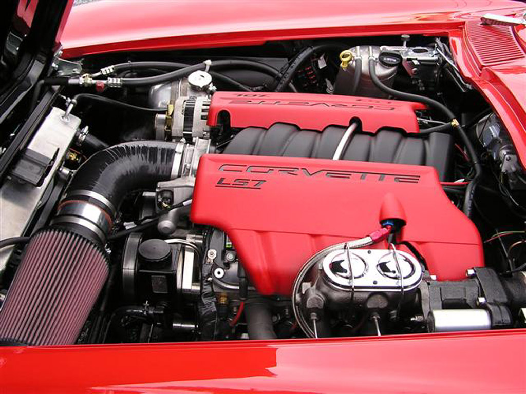

Here is an image of a C2 Vette with an LS7 installed by https://www.streetshopinc.com/, showing how they chose to move the fuel line around the front of the hydraulic brake assist unit and master cylinder:
http://www.hydratechbraking.com/images/C2LS7.jpg
Hopefully you won't have to get too involved in re-engineering your fuel line!
