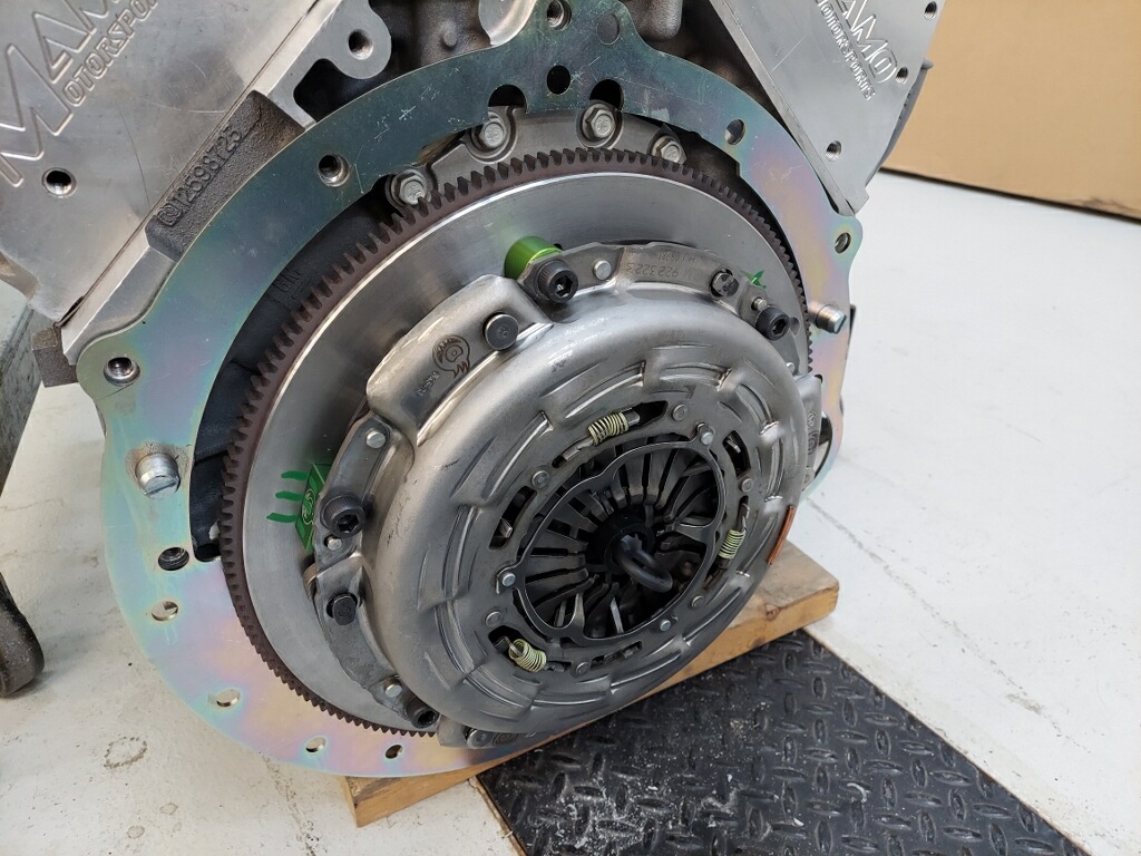

Minor setback... as we attempted to get the driveline in, we had some issues with the Katech LS9X clutch I had planned to use. The LS9X clutch is a package developed by Katech combining the dual disc clutch that was used in the C6 ZR1 Corvette with a flywheel adapted for the 6 bolt crankshaft of most LS engines. As it turns out, the LS9 clutch is a meaningfully “thicker” clutch and won’t fit within a standard LS bellhousing. I’m using a standard Quick Time LS bellhousing.
In order to use the LS9X clutch within the Quick Time bell housing, you need a spacer between the transmission and the bellhousing that is approximately .85”, which moves the transmission back in the chassis .85”. D&D used to sell an aluminum spacer that they CNC machined to provide the appropriate clearance (Stielow used one of the D&D spacers when he put a LS9X clutch in his Mayhem build). I’ve already positioned the transmission cross member, transmission tunnel, as well as a custom QA1 carbon fiber driveshaft assuming no spacer. So the D&D spacer was not an option for me.
Based on some quick research and through discussions with the folks at Tick Performance, I ended up purchasing a Monster LT1-S clutch, and will need to sell the Katech LS9-X clutch package. The Monster clutch is similar in concept to the Katech LS9X clutch, but a newer variation. While the Katech LS9X clutch uses the C6 ZR1 factory dual disc clutch with a modified flywheel for 6 bolt crankshafts, the Monster LT1-S clutch uses the GM OEM dual disc set up from the C7 Corvette, again with a flywheel modified to work with LS engines. Importantly, the Monster clutch is physically smaller than the Katech clutch and fits within the standard QuickTime bell housing.
I’ve read a lot of great reviews about the Monster clutch; hopefully it works well in my application. Like the Katech LS9X clutch, the Monster clutch is supposed to have a factory feel, with absolutely no rattling or chatter that is common with dual disc clutches.
Back moving in the right direction, but the whole thing has pushed us back a bit. We won’t get the clutch until Friday so motor and transmission won’t go in until early next week. A little frustrating, but not unusual to have a few bumps in the road along the way...

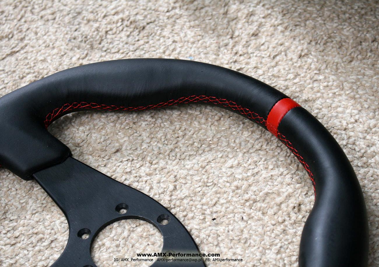

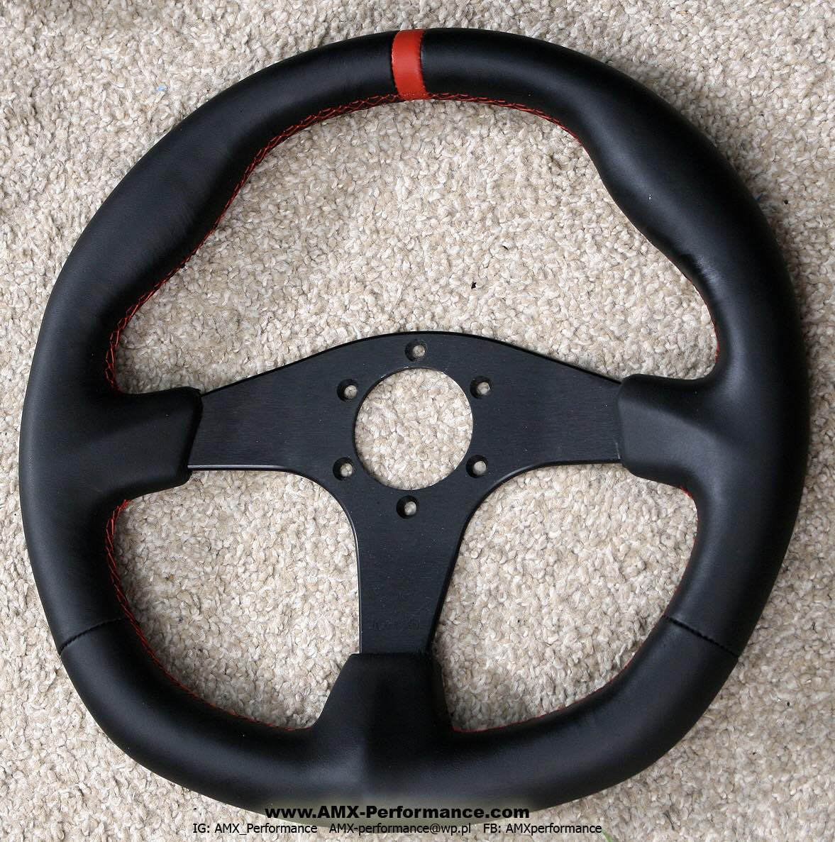

Have been looking all over for the “right” steering wheel for the Nova. I was looking for something with a flat bottom (but not too crazy) that fit the look of the interior. Looked at a bunch of Momo wheels, Sparco wheels, and NRG wheels. The wheel I like best is a Quark model that Momo makes.
Attachment 72772
I really like the look of this wheel... pretty stealthy, flat bottom (but not too crazy) and nice thickness. Problem is that the wheel is made out of polyurethane with leather inserts. I wasn’t liking the feel of the polyurethane on this wheel, which is a huge deal for me since the steering wheel is your most direct connection to the car that you’re constantly in contact with.

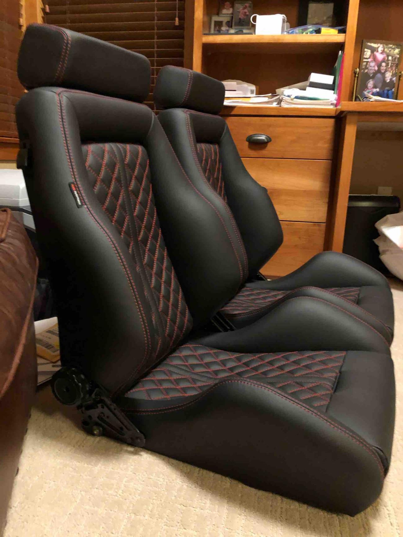

Recently, someone here on the forum asked me about the seats I’m using for my Nova. I forwarded the link to the web site for the craftsman (Marek) that did my seats. I noticed that he had a new website that had a gallery of a bunch of his work/projects and I noticed that he recovers steering wheels. So, I reached out to Marek and discussed what I was looking for. Marek suggested we buy the Momo wheel and recover it in the same leather that he used to cover my seats. He also said he could add a stripe at the 12 o’clock position, and could stitch it together using the same red thread he used on my seats. He finished the project this week and the wheel is currently in transit to me, but he shared a couple of pictures with me. I can’t wait to get it and see/feel it in person. Let me know what you think. I’ve also included a picture of my seats as a reminder.
Attachment 72773
Attachment 72774
Attachment 72775

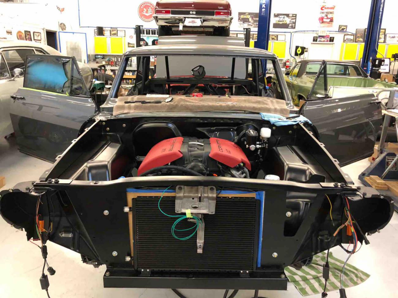

We got the clutch issue resolved - new Monster clutch fit perfectly, shimmed the slave cylinder to Monster’s spec, and got the bell housing aligned properly with the help of some offset dowel pins.
Attachment 72842
Attachment 72843
Motor and trans installed. Kurt also made a custom bracket to mount the Dominator ECU up under the dash in a location that allows decent access to the various connectors that plug into the ECU.

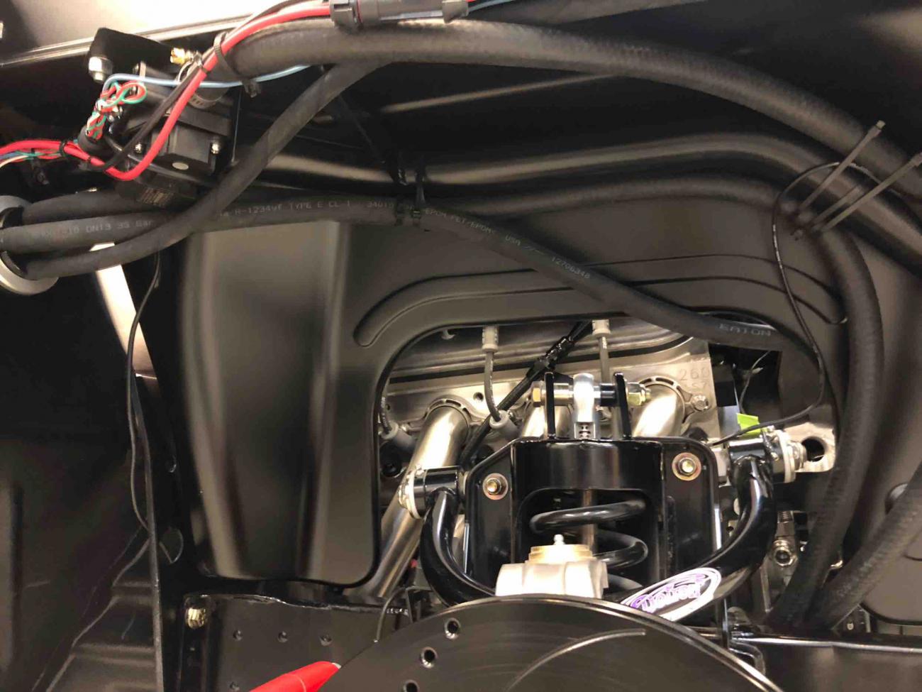

bkswede 09-29-2020 07:20 PM
‘63 Chevy II Pro-Touring Build
10 Attachment(s)

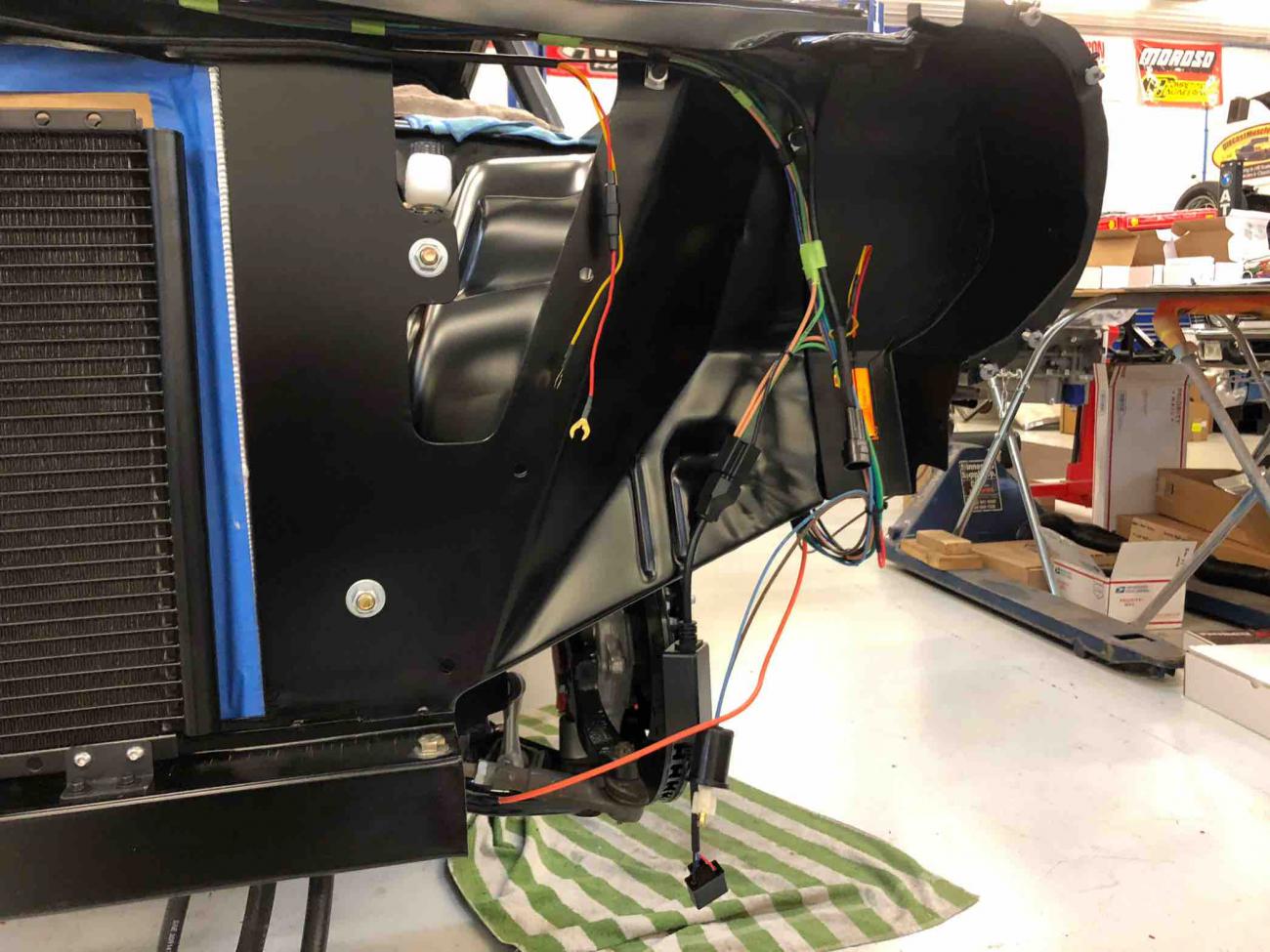

Stopped by the shop today to check out progress on the Nova and work through some questions on wiring with Kurt and his team. They’re nearly finished with the wiring, and doing a great job of routing the wiring and plumbing neatly and out of sight. A/C, heater hoses and heater control valve all hidden under the passenger inner fender well. The heater hoses and A/C hoses that are shown in the pictures routed into the engine compartment aren’t yet cut and fit to the water pump and A/C compressor. Once those are fit, we will secure those hoses and route them more neatly into the engine compartment.
Attachment 73044
Attachment 73045

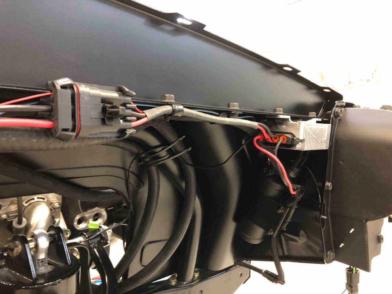

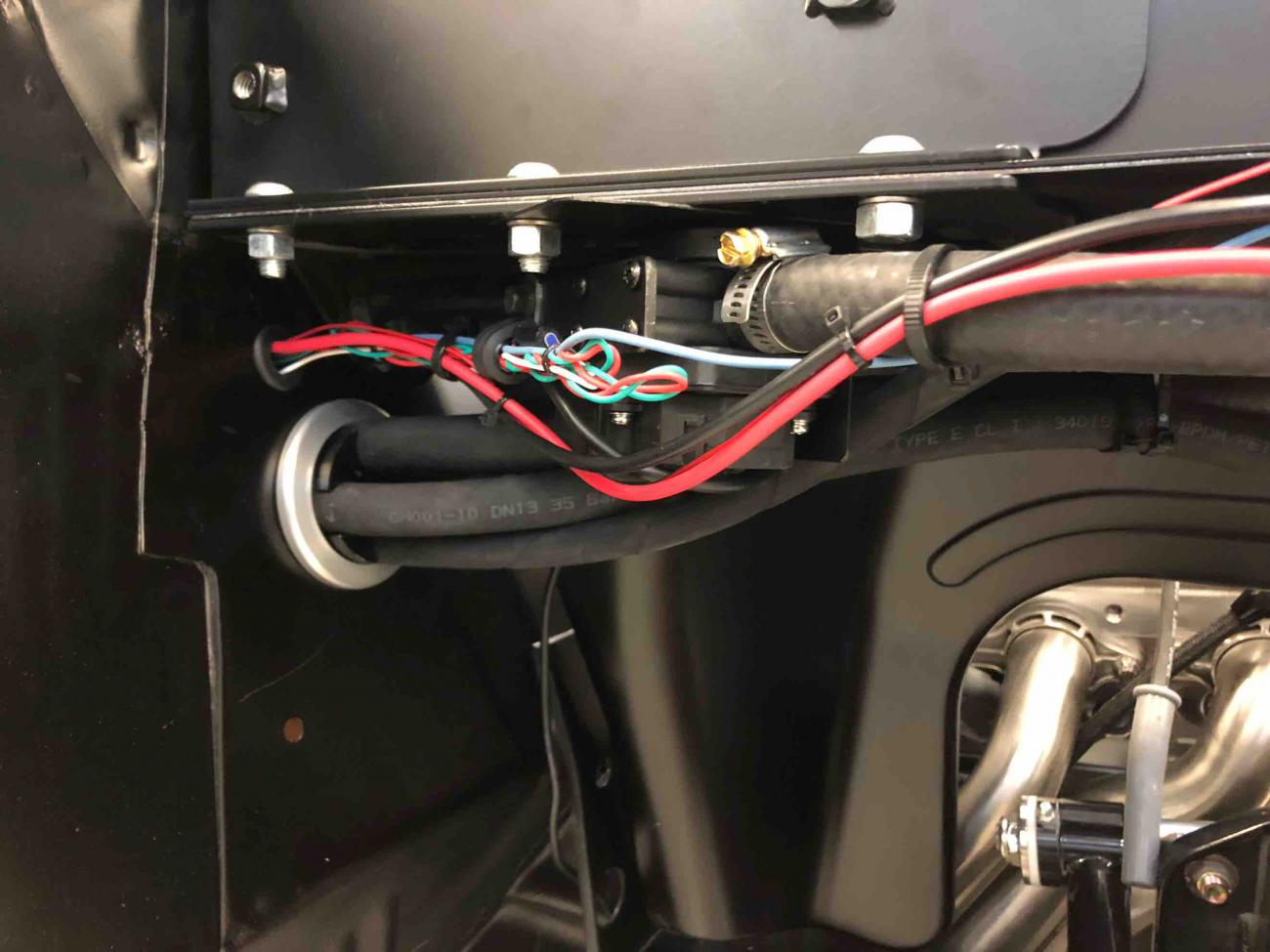

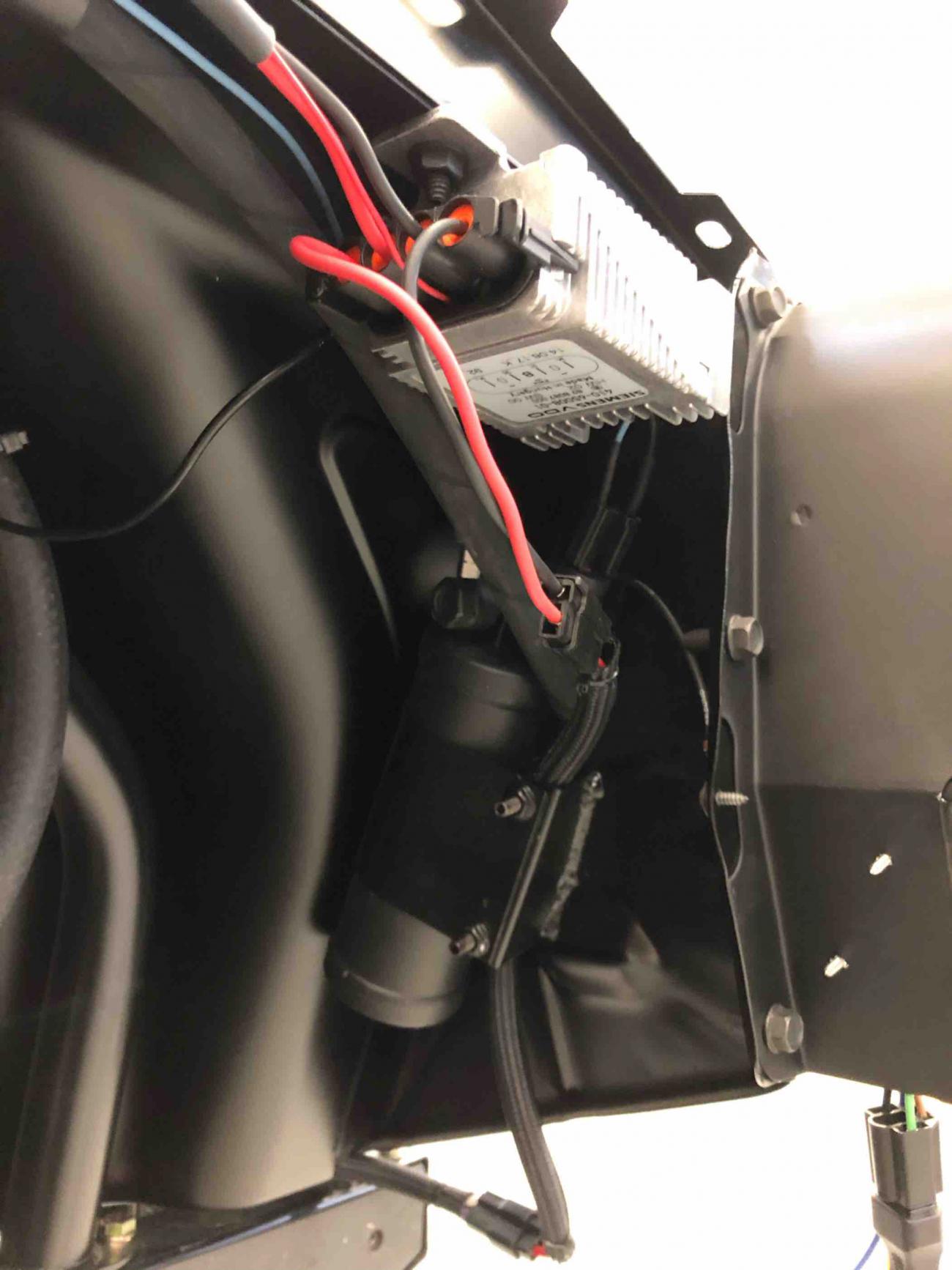

The pulse width modulation fan control module is also mounted under the passenger inner fender well, as is the A/C drier. The output from the PWM fan control module is wired into a really slick Spal harness that splits the single set of output wires to the fan into two sets of outputs to feed each of the Spal fans, all using Spal wiring connectors. The dual wiring harness is fed through the inner fender well at the base of the radiator and plugs into the fans along the bottom of the radiator - barely visible in the engine compartment.
Attachment 73046
Attachment 73047
Wiring is all ready to go for headlights, parking lights, etc. The headlights are LED with halos. The halos function as daytime running lights and are white, except when you use the turn signals, when the halos flash amber with the turn signals. A little tricky to figure out the wiring as the instructions weren’t very good, but we got it figured out.
Attachment 73048
Attachment 73049

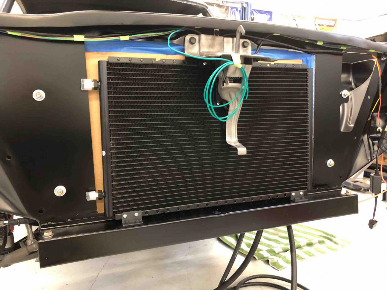

The A/C condenser is mounted nicely and A/C lines will be run discretely through core support. Once all of the A/C lines to the condenser, as well as oil cooler and power steering cooler hoses have been measured and fit to the radiator, we’ll pull the radiator and have it powder coated (except for the core itself). Hood latch still needs to be painted...
Attachment 73050

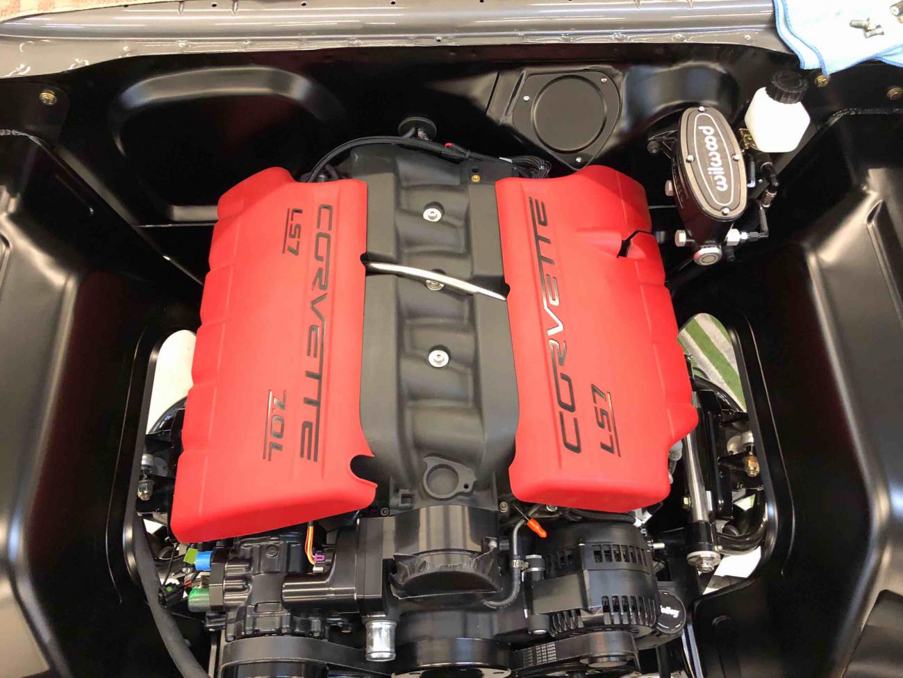

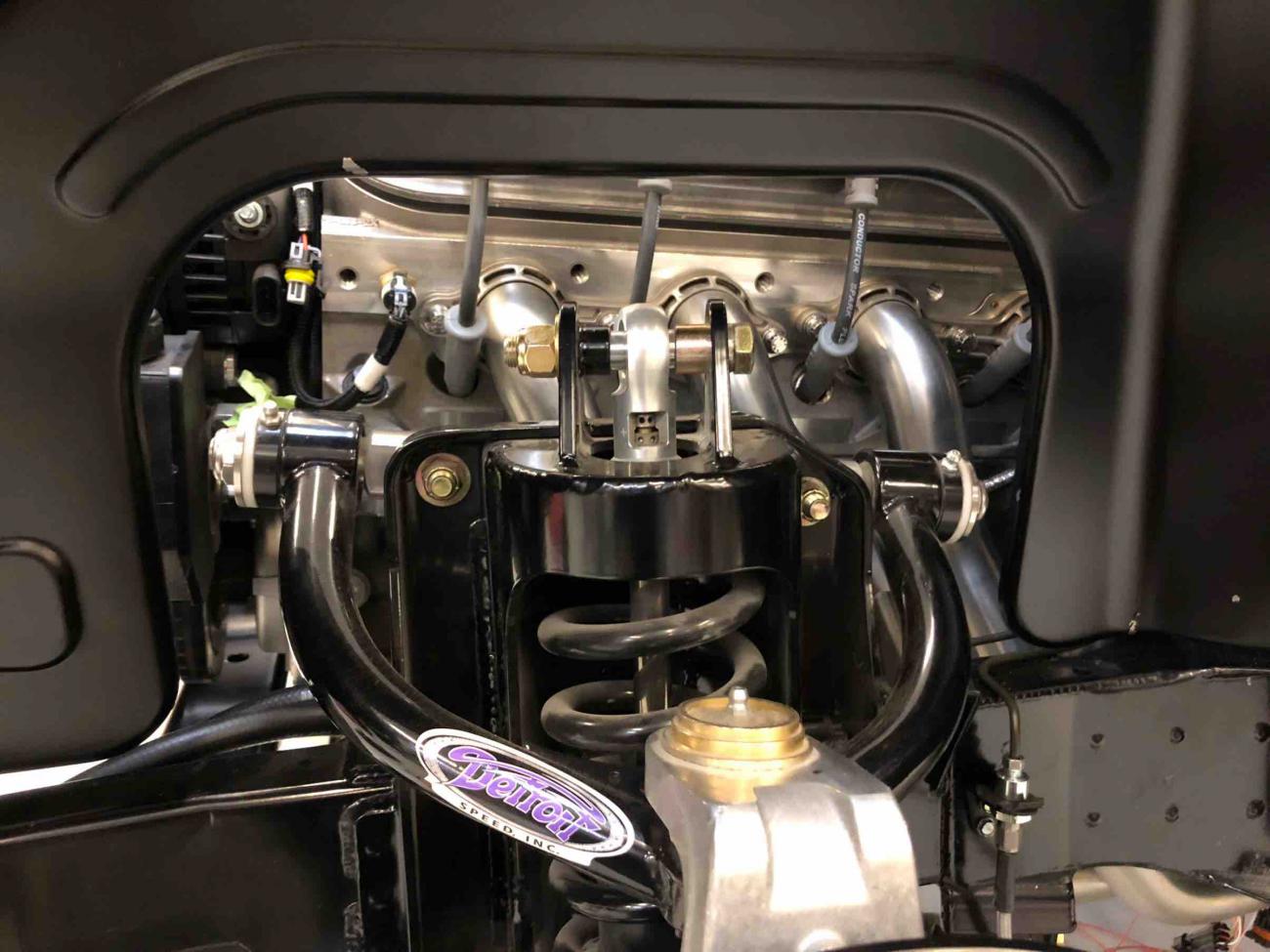

Holley engine harness is connected, but hidden nicely under fuel rail covers. Engine bay is really clean. We need to powder coat the air intake, which isn’t shown here, but first need to weld in a bung for PCV connection.
Attachment 73051
Attachment 73052
View from driver’s side inner fender well.

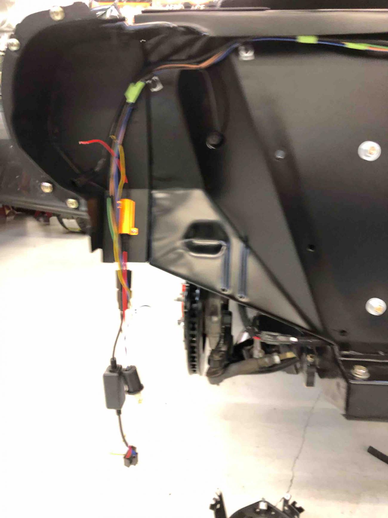

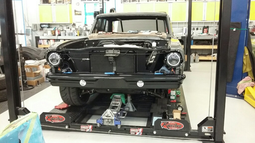

bkswede 10-20-2020 06:58 PM
10 Attachment(s)
Made a trip to Eau Claire recently to meet with Kurt and check out some nice progress on the Nova. Wiring is basically finished up, but for a few items that will require mock up of center console (e.g., power window and lock switches). Kurt got the Vaporworx PWM fuel pump module mounted in the trunk (wiring is nice and tidy), along with the battery and the II Much fuel vent.
Attachment 73195
Attachment 73196
Attachment 73197
The headlights are also mounted and wired up. These headlights are LED units with halos. The halos shine white most of the time, so they serve as daytime running lights when headlights are off. When the headlights are on, I can either leave the halos on or switch them off - I have them wired to a virtual switch on the Holley pro dash. When turn signals are activated, however, the halos shine amber and blink with the turn signals. Pretty cool, and excited to see them in action.

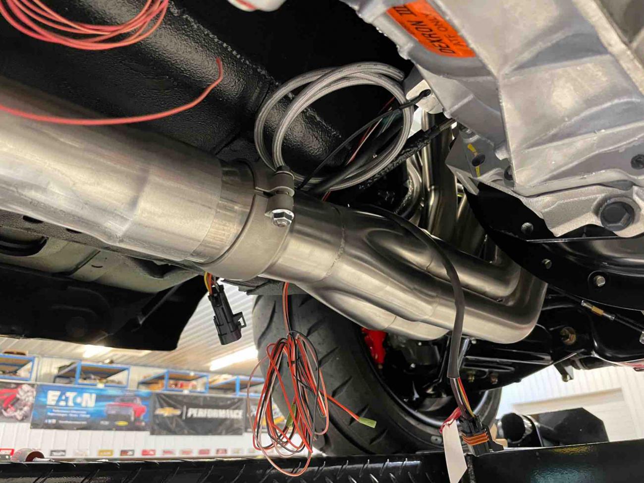

Kurt had moved the Nova on to a four post lift as we’ll be working on the exhaust next. Was cool to get under the car and see some of the work close up. QA1 carbon fiber driveshaft installed, and good look at the aluminum center section 9 inch rear end.
Attachment 73204

A couple of under car shots where you can see where we will run the exhaust from the headers...
https://uploads.tapatalk-cdn.com/202...c0c816a703.jpg
https://uploads.tapatalk-cdn.com/202...3ba79be300.jpg
For exhaust, I’m using Spintech oval tubing from the headers to an X-pipe to their 3000 series mufflers. The oval tubing is 3 1/2” wide and 2 1/4” tall, and the equivalent to 3” round tubing. The oval tubing will give us a little more ground clearance to tuck the exhaust up tighter to the floors. The mufflers are oval inlets and 3” round outlets. The round tubing will exit the mufflers and go over the rear end, angle toward the back corner of the rear of the car (the fuel tank has clipped corners) and will exit near the rear bumper. System will be Tig welded together but for a handful of V band clamps to take it off in sections. Once completed, we’ll coat the exhaust black. You can see one of the mufflers, the X-pipe and other oval tubing in the photo below. The exhaust components are sitting on lift in front of the rear tire.

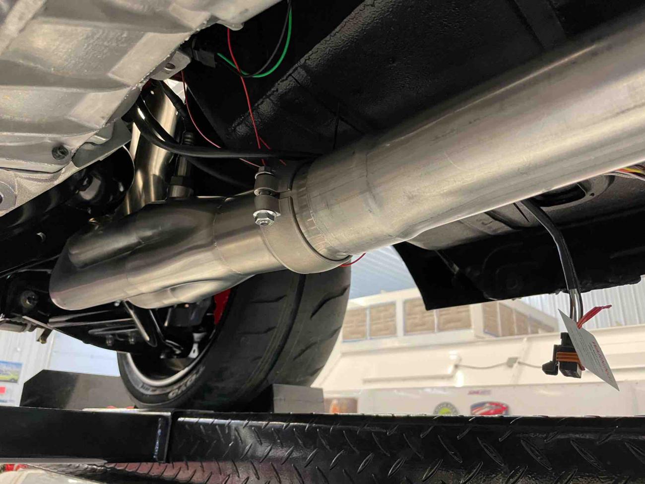

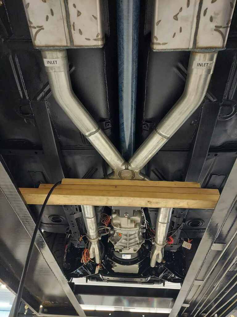

Got a few pictures from Kurt showing some progress made on the exhaust this week. Front part of the exhaust pretty much done and TIG welded together... and were starting on the pipes from the mufflers to the tailpipes.
Attachment 73248
Attachment 73249
Attachment 73250

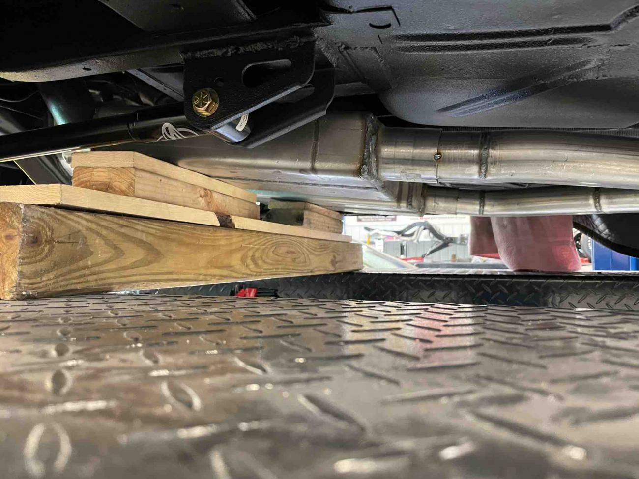

bkswede 11-07-2020 07:37 AM
10 Attachment(s)

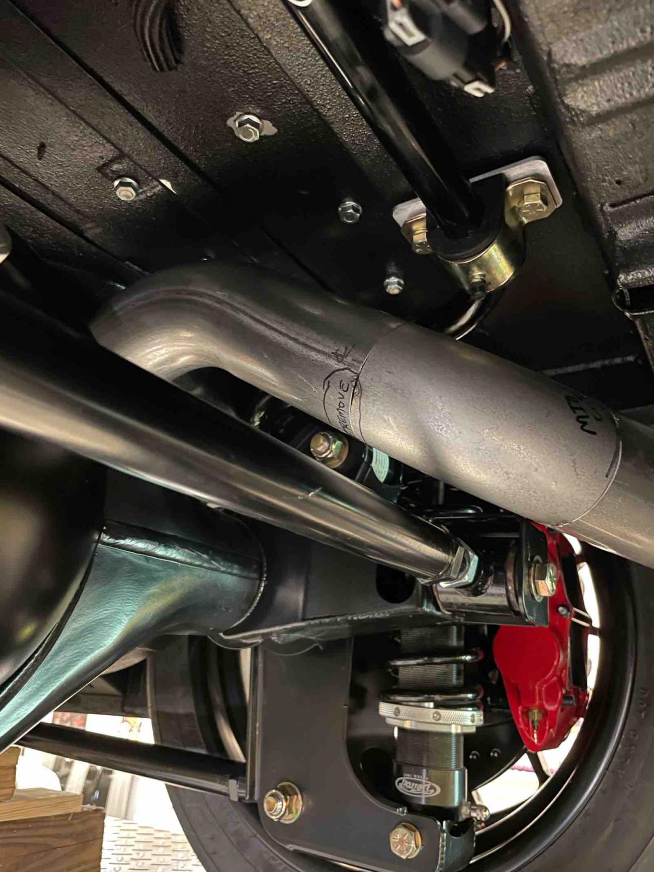

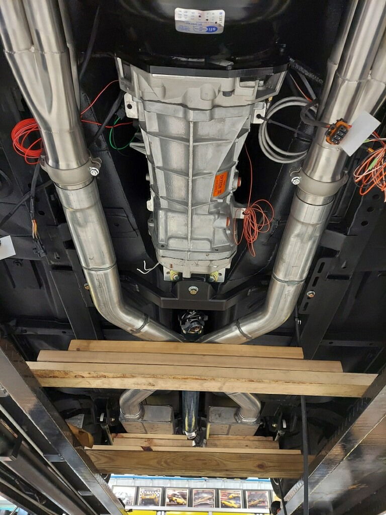

Stopped by the shop yesterday and was able to check out recent progress... exhaust is mostly complete, though I don’t like the way the tailpipes are routed, so we need to re-do those, which shouldn’t be a big deal. Here are some pictures I took of exhaust - I’m using 3 1/2” oval pipes (equivalent in flow to 3” round pipe) from headers through X-pipe to Spintech mufflers. The mufflers have oval inlets and round outlets, so easy transition to 3” round pipe from the muffler on back, since the round pipe is much easier to snake above rear suspension and around fuel tank.
Attachment 73275
Attachment 73276
Attachment 73277

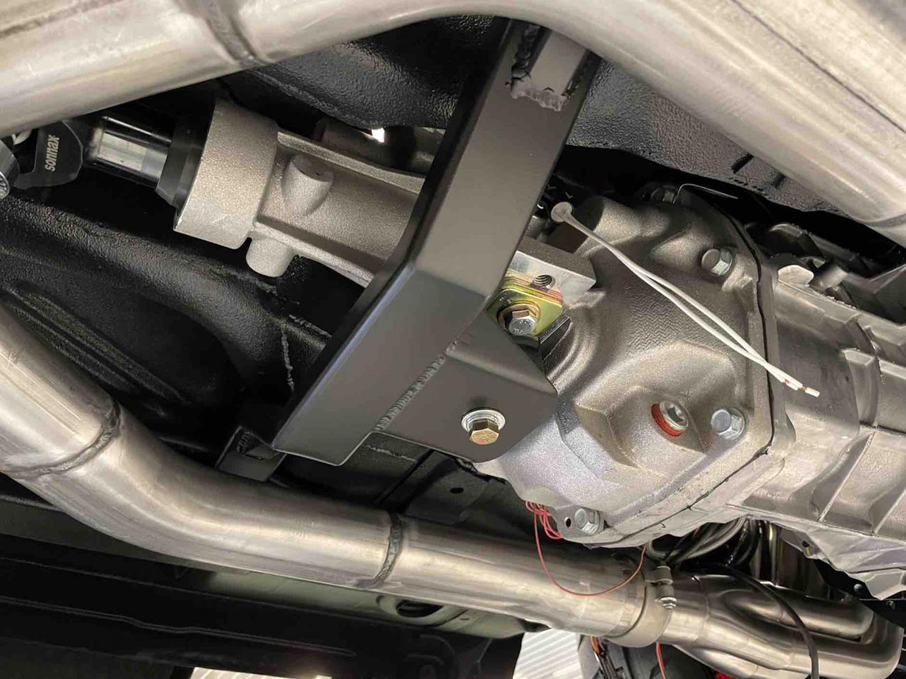

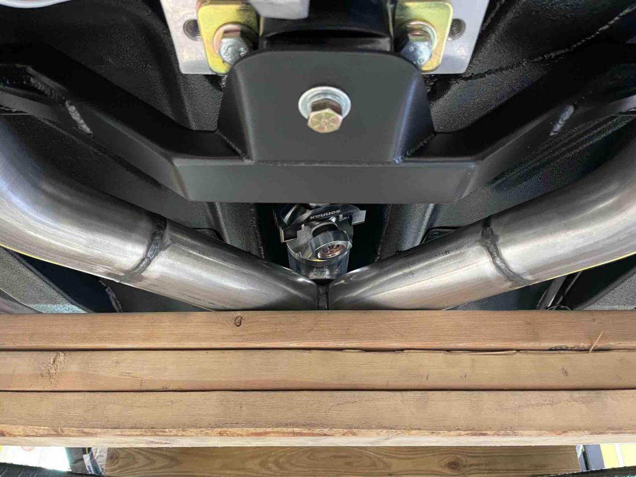

Kurt modified the transmission cross member slightly. The change kept the transmission mount height exactly where it was, but elevated the sides of the mount about an inch, which gave us another inch or so clearance to tuck the oval tubing closer to the floor.
Attachment 73278
Attachment 73279
Attachment 73281

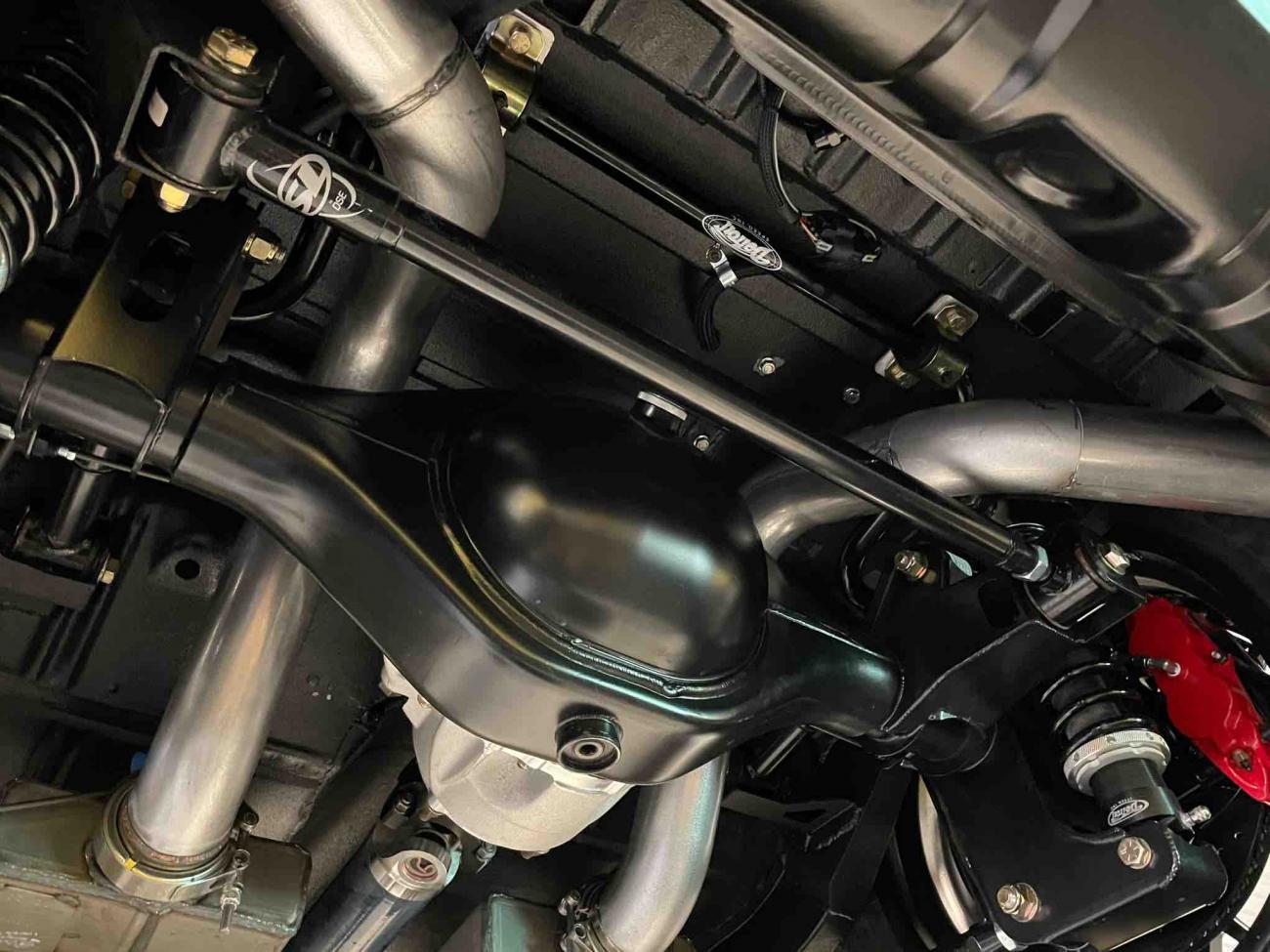

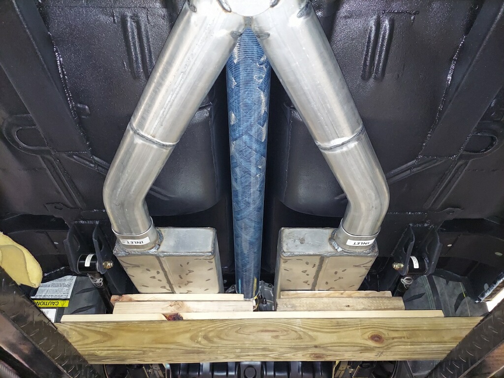

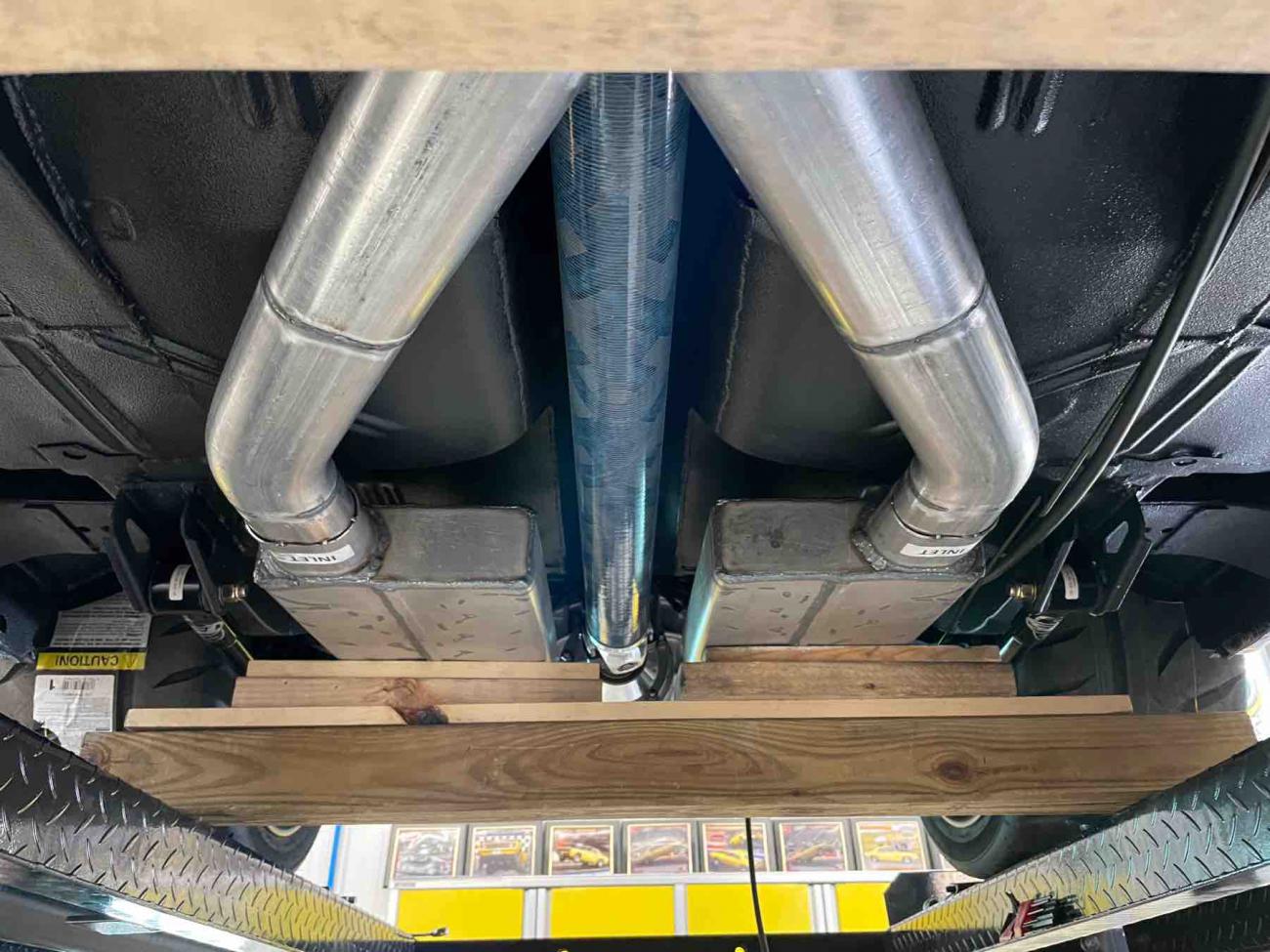

Transition from muffler to tailpipes are made with V-band clamps right off the muffler.
Attachment 73280

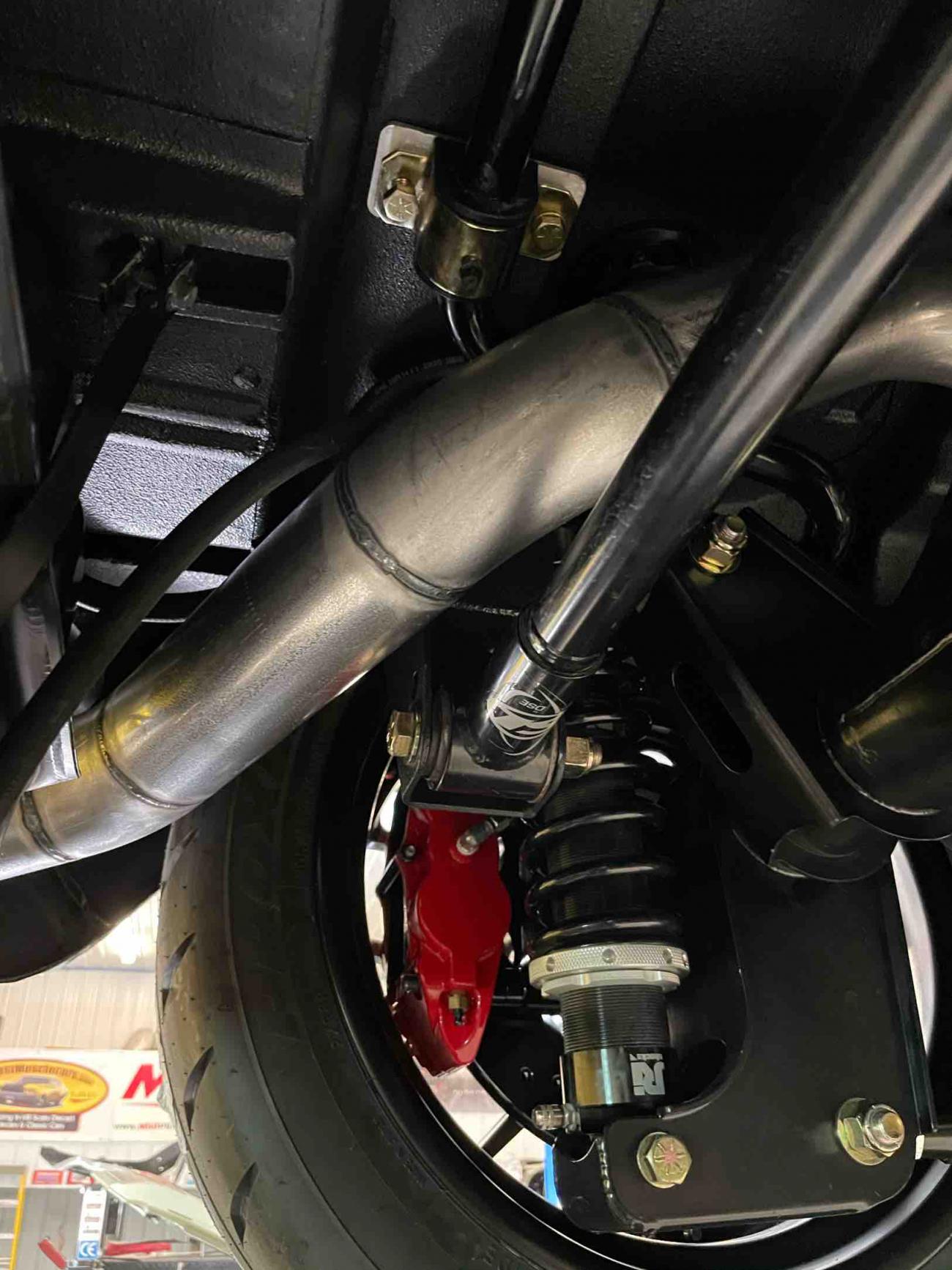

From there, exhaust snakes up and over axle and QuadraLink, and around fuel tank.

As I mentioned above, the tail pipes are tacked together and currently turn to the side and dump behind each rear wheel. I really don’t like this look, so we’re going to re-do this portion.
https://uploads.tapatalk-cdn.com/202...64436a21b4.jpg
https://uploads.tapatalk-cdn.com/202...2ad4ecda15.jpg
https://uploads.tapatalk-cdn.com/202...4ff3556ab7.jpg
https://uploads.tapatalk-cdn.com/202...7545c51a05.jpg
https://uploads.tapatalk-cdn.com/202...4ac5bbd4a6.jpg
There is plenty of space to turn the tailpipes up and run them inside the rear quarter panels, above the pinch weld, so they can’t be seen from the side of the car. Below are some photos of what I have in mind from a nice ‘67 Chevy II exhaust project detailed on Steve’s nova site forum. Pipes will turn down and exit toward the ground near corners of rear bumper with everything up above the bottom edge of the rear quarter panel.
https://uploads.tapatalk-cdn.com/202...b4e47b178c.jpg
https://uploads.tapatalk-cdn.com/202...51815e72c6.jpg

Got a nice picture of the wiring and plumbing for the Vaporworx PWM fuel pump controller while I was crawling around under the car :)
https://uploads.tapatalk-cdn.com/202...a457d1bd99.jpg
https://uploads.tapatalk-cdn.com/202...08272371be.jpg

Attachment 73195
Attachment 73196
Attachment 73197
Attachment 73198
Attachment 73199
Attachment 73200
We also got the radiator back from powder coating and it turned out great! We powder coated the tanks, top, bottom and sides. The fins weren’t powder coated in traditional way, but coated in a very thin coat of similar color to ensure no degradation of thermal transmission of the fins. We still need to deal with the radiator cap. We didn’t want to coat the cap as it has a rubber gasket that we were concerned about putting in the oven as part of the curing process. Instead, we’re going to have the cap coated with Cerakote, a product similar to a powder coat, but thinner and can be air cured rather than oven cured.
Attachment 73201
Attachment 73202
We also got the catch can mounted. Went with a Mighty Mouse catch can. Will connect via a -8AN adaptor on the valve cover oil filler. We had to modify the fuel rail cover - drilled a hole and will connect a 90 degree elbow fitting with push lock hose that will connect to the catch can. Other line out of the catch can will plug into nipple on the intake manifold.
Attachment 73203
Attachment 73204

Got a nice view of some of the wiring that was done under the car. I mentioned previously that the C6 Corvette PWM fan unit is wired with a nice splitter harness from Vintage Air that splits the output signal from the fan control unit in two into pigtails that plug directly into the Spal fan pigtail harnesses. Works awesome... we will need to secure the harnesses so that they don’t block the air flaps in the shroud, but is super clean.
https://uploads.tapatalk-cdn.com/202...1990347cac.jpg
I also installed multiple temperature sensors to monitor oil temps and power steering fluid temps. My C&R radiator has oil and power steering coolers. We wired in temperature sensors in the input and output lines so that we can monitor oil and power steering fluid temps as they enter the cooling unit and after they exit the cooling unit. Because these all feed the digital dash (rather than a physical gauge), it is easy and inexpensive to monitor this data in a digital environment where you don’t need physical gauges.
https://uploads.tapatalk-cdn.com/202...e509b6dd3c.jpg
https://uploads.tapatalk-cdn.com/202...ae47a1847b.jpg
https://uploads.tapatalk-cdn.com/202...1f0838b8b5.jpg

Momo steering wheel that I had recovered in same leather as my front seats, and added red stripe at 12 o’clock, as well as red stitching...
https://uploads.tapatalk-cdn.com/202...3432f3d793.jpg
https://uploads.tapatalk-cdn.com/202...c77f10257f.jpg
