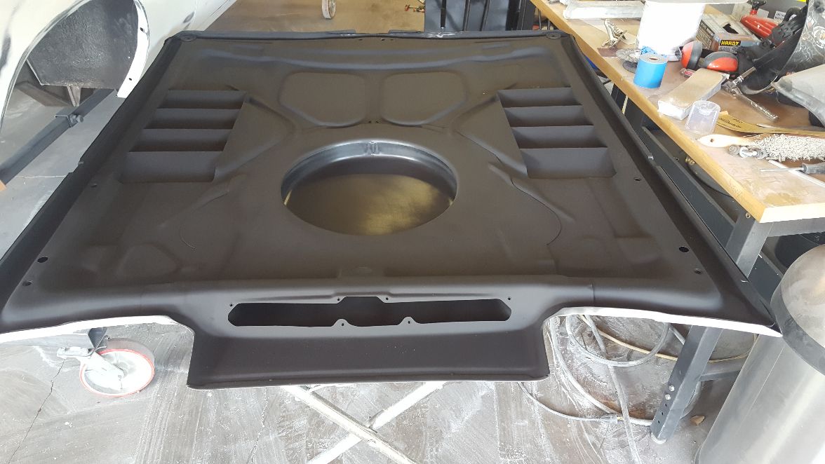

garickman 04-23-2022 02:17 PM
4 Attachment(s)
Top of the hood is now flawless with the Gray Area Steel hood louvers. Bottom is in epoxy primer and ready for body work.
Attachment 77918
Attachment 77919
Attachment 77920
Attachment 77921

Musclerodz 04-28-2022 10:34 PM
Attachment 77918
Attachment 77919
Attachment 77920
Attachment 77921
I would bolt the hood to the car and block it. It will change as soon as you have hinge pressure on it.

garickman 04-29-2022 06:44 AM
We had the hood on and latched in place with the hood bumpers set when we did the mud work around the edges. Took it off to work the center and underside. We will bolt it back in place to lay down the polyester primer, guide coat and final blocking. I have done a few builds over the years, nothing to this level. It still blows my mind how many times this car has been assembled, dis-assembled and re-assembled.

Musclerodz 05-04-2022 07:48 PM
just wait till its painted, and then start scratching your head wondering why it won't go back together just as perfectly as you took it apart to paint.
