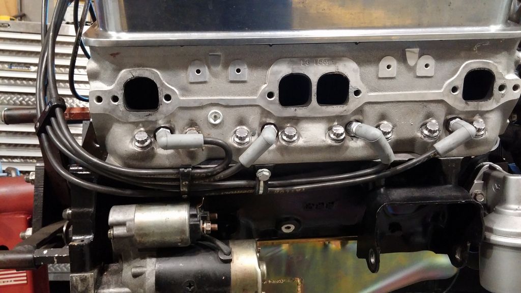

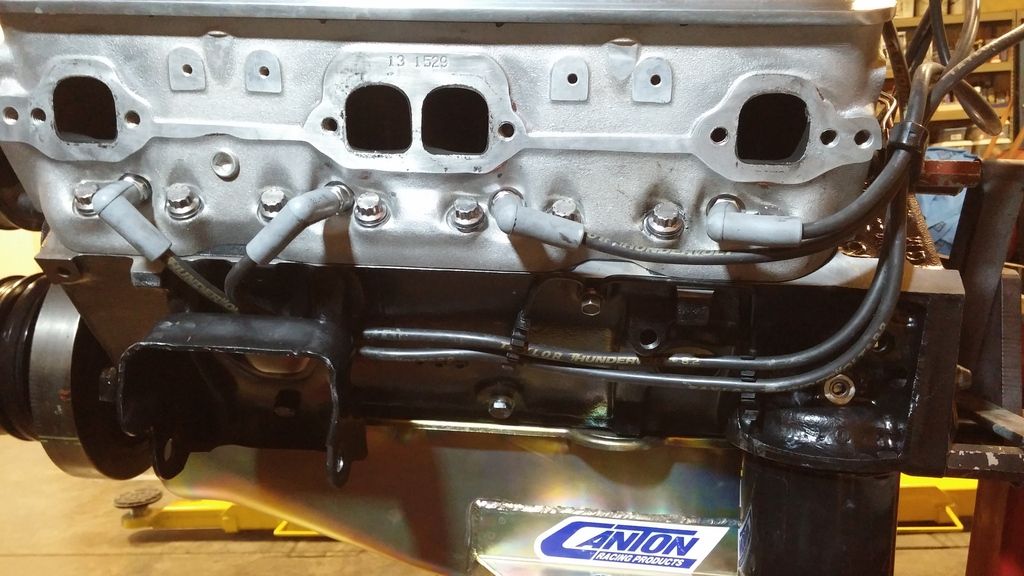

Worked on my plug wires today. 5 years ago I used these Made4u bracket looms to run my wires up over the valve covers.
http://img.photobucket.com/albums/v3...psip6jl0hj.jpg
They attached to the holes on the side of the head seen here.
http://img.photobucket.com/albums/v3...psriw6krig.jpg
With the way my header flanges are now moved up on the fastburn heads, this was no longer an option, plus its just a much cleaner look with the wires under the headers. I also won't have to fight them anymore every time I deal with the headers on the engine, something I hated as well.
I looked around and found this bracket on a shelf already bead blasted and painted...
http://img.photobucket.com/albums/v3...psnirqkpdr.jpg
It's from the 305 I pulled out but I never reused it. And my wife makes fun of me for being a pack rat.
That and an insulated clamp and a few looms tidied things right up.
http://img.photobucket.com/albums/v3...pseollpjpk.jpg
Mucho better...

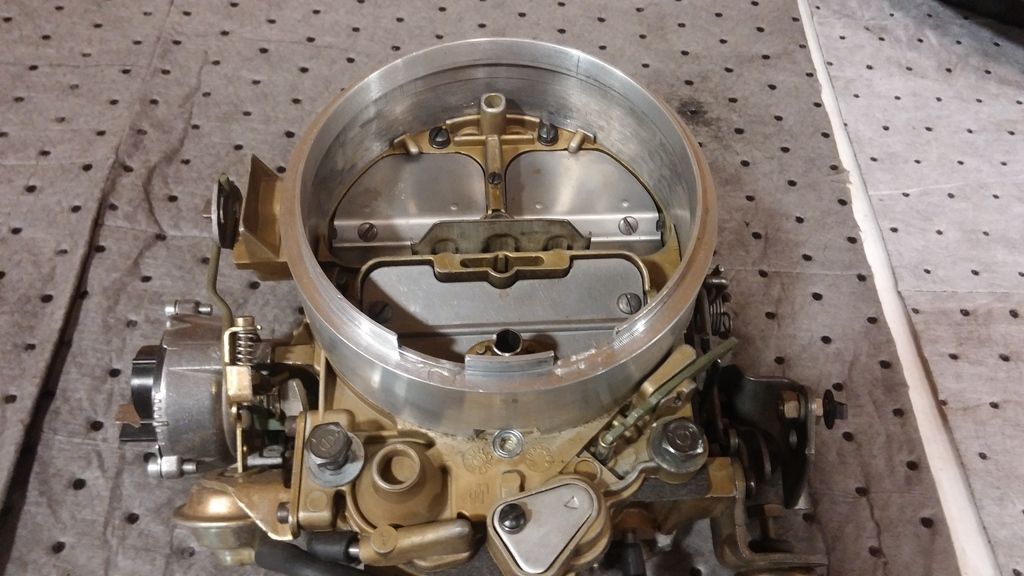

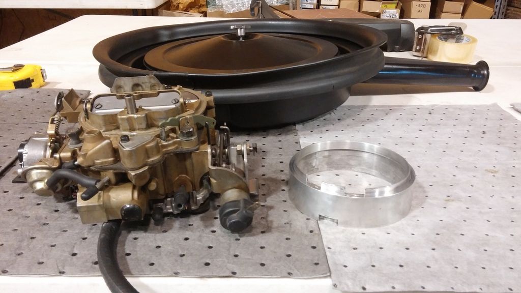

SSLance 01-18-2016 08:43 AM
Thanks Ben!
The air cleaner is a knock off of the old 70s Chevelle cowl induction setups, the spacer raises the housing up so that it just touches the bottom surface of the cowl induction hood.
Here are all 3
http://img.photobucket.com/albums/v3...psljtpwpkf.jpg
http://img.photobucket.com/albums/v3...ps5pojbsli.jpg
http://img.photobucket.com/albums/v3...ps5rhjhw3d.jpg
http://img.photobucket.com/albums/v3...ps8af12ayo.jpg
My friend John must have 30 hours of machining in building that spacer, but it turned out pretty sweet. Never thought it would be the horsepower adder that it is though.
