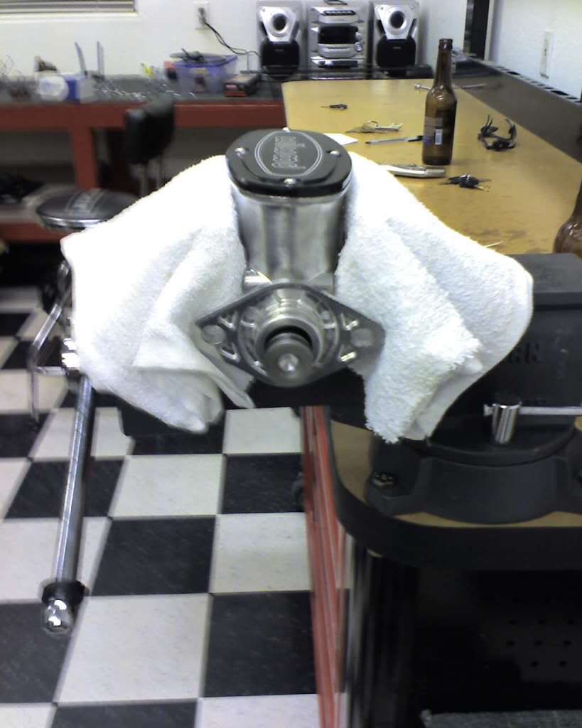

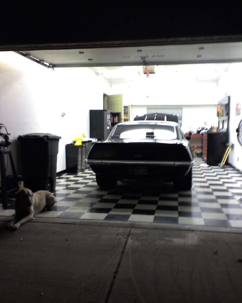

Today I moved my shop over to the new house. I now have a 950 sqft main garage and 600sqft shop. I set the shop up the best I could and tore down the master cylinder. I found that the interference fit between the pushrod bevel and master cylinder piston insert was to tight. I ground down the insert .150 and shimmed it to fit after some measurments. Without the insert I only have .025-.030 interference fit which won't make me feel to good sailing it inot turn one at 80mph.
http://i200.photobucket.com/albums/a...30-10_2130.jpg
http://i200.photobucket.com/albums/a...30-10_2128.jpg

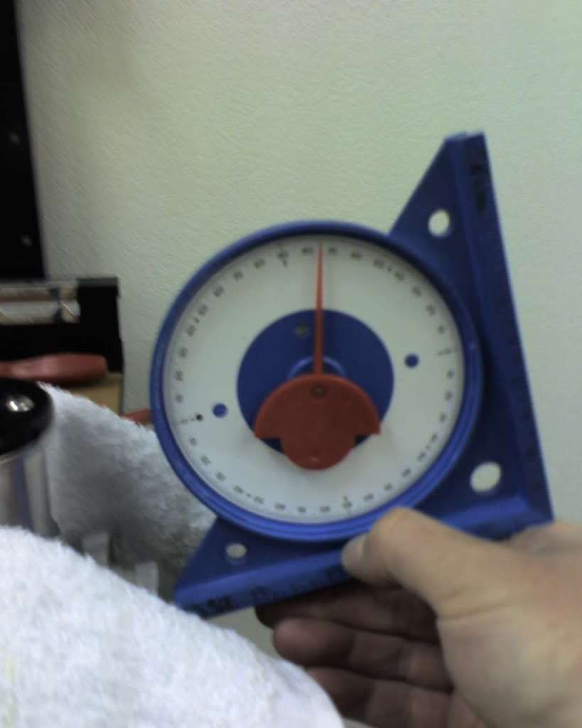

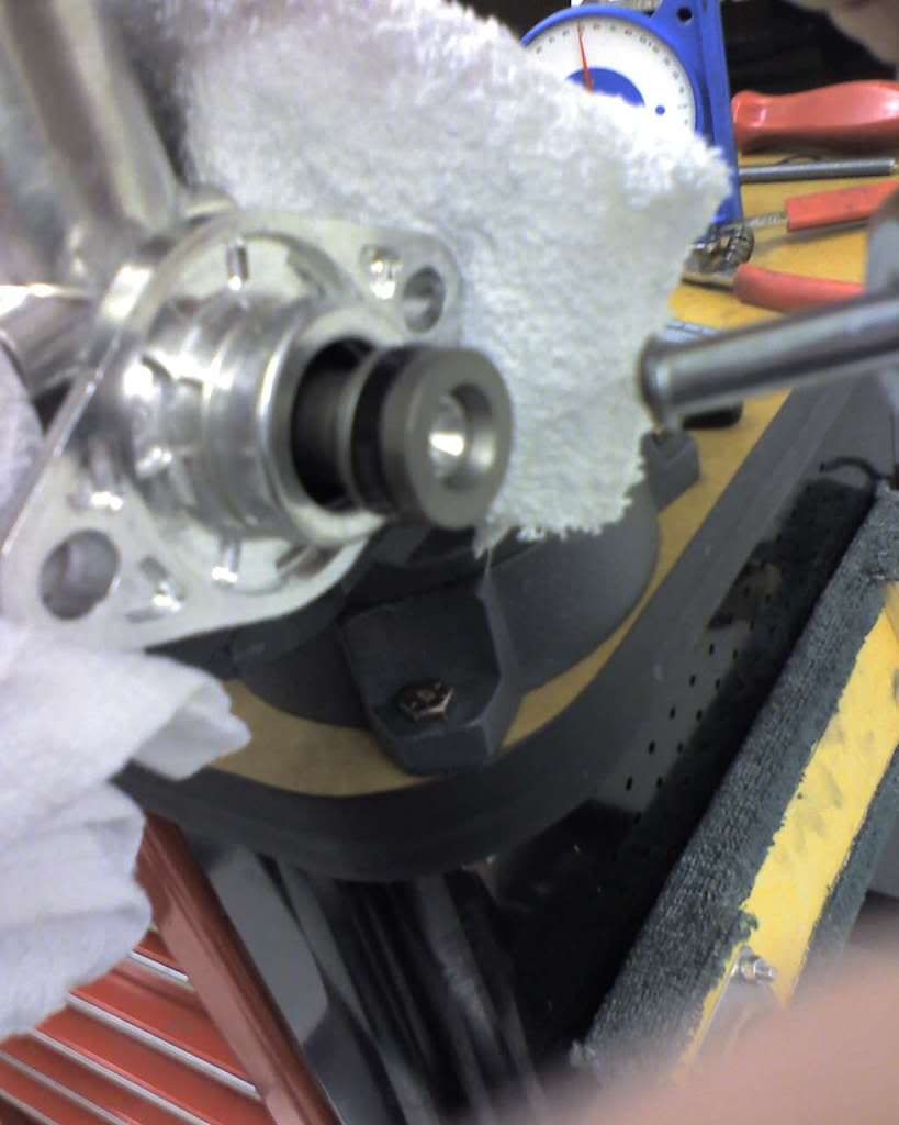

I measured the angle available before depressing the piston and it was only 6 degrees. After making my adjustment it's roughly triple at 18 degrees. I'm estimating I only need 8 degrees to eliminate the problem. I think it's time for a new angle finder.

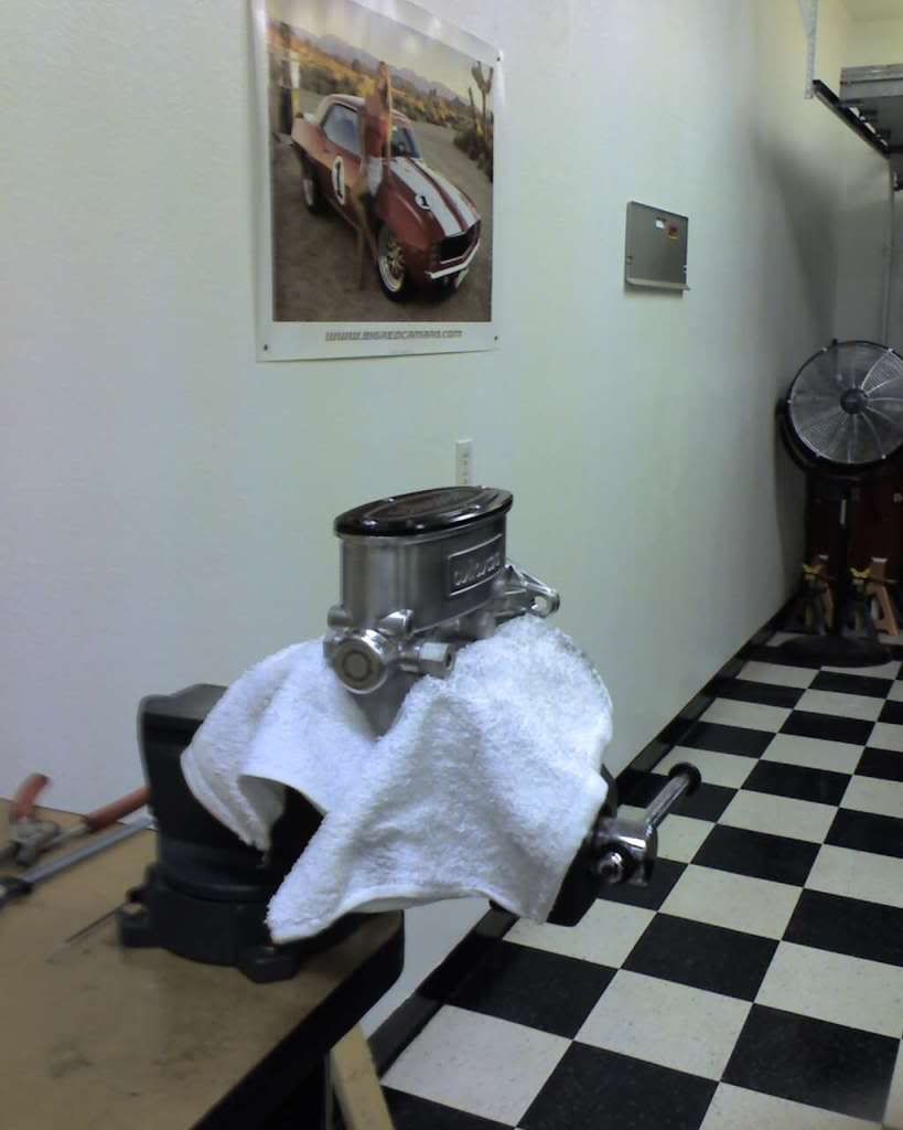

Only I would scratch up a polished master cylinder. :D Don't mind big red and the stripper in the back ground.

This picture sucks but it's my new shop. I don't know which camera is in my new office, old house, or new house, or a box. :willy: Man it's nice to have nearly a half acre to roam.

I don't understand why you'd have so much angle on the rod... is that what you had to do to get a 6:1 pedal ratio?
Also - most of the push rods I've seen already are ground with a slight taper...

Thanks man, I'm excited about my new shop! I'm using the factory manual pedal hole. I don't need the 18 degrees, it's only around 6-8 degrees. The pushrod is actually ground beveled. The insert was just to long and not allowing enough wiggle room for my application. Should have her back on the road today. I just need to find a leg. Still seems to work the best when starting from scratch. I need to buy an air bleeder.
