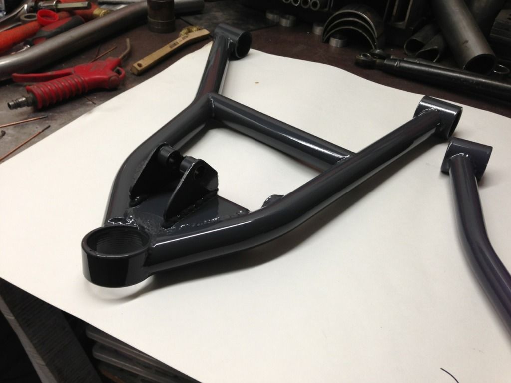

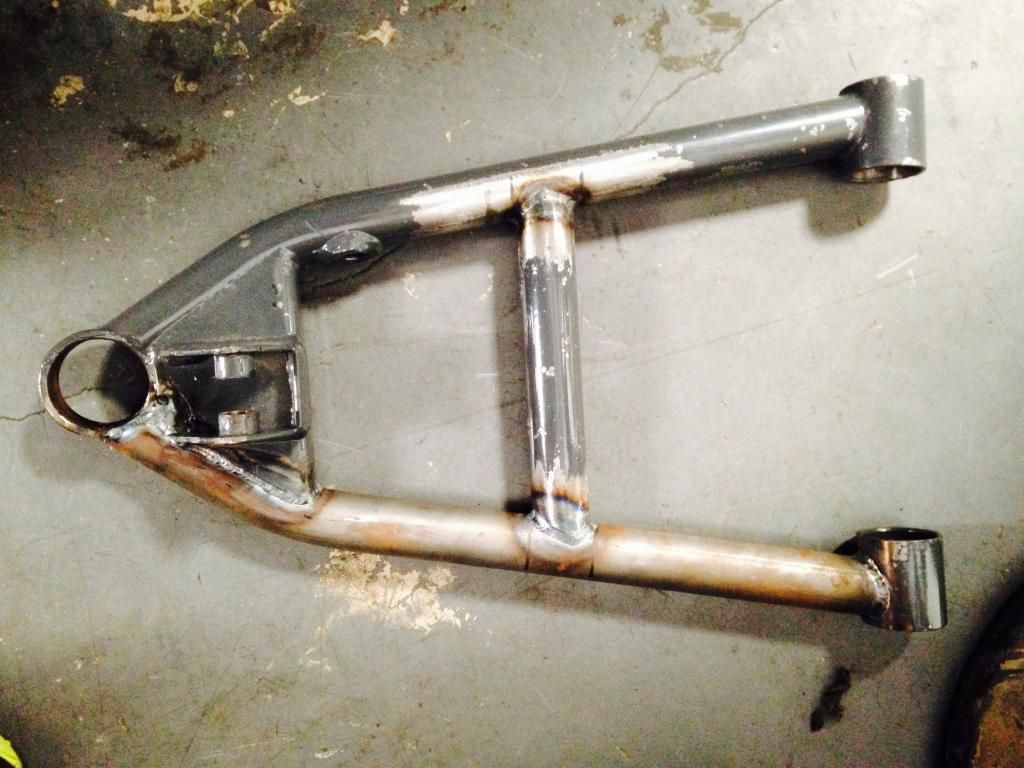

Cortex is working on a few things right now but nothing was really picture worthy. Rear end is getting provisions for the diff cooler I picked up at Roush and it is being sent out for powdercoating.
Headers are cut and waiting for LCA's to be installed so some tubing cab be bought to bridge the gap of 2-3" that each primary needs. Probably will get those pieces from SPD in Sac.
Crick (fab guy) has started making the remaining transitions needed for the 5" x 2" flat bottom exhaust to connect to the 3.5" collectors at front and the 90*'s at the rear.
They have modified my LCA's for about 3" of back side clearance for the headers which they will be fitting next.
Before:
http://i236.photobucket.com/albums/f...ps8b785ba7.jpg
http://i236.photobucket.com/albums/f...A023FDCB62.jpg
After:
http://i236.photobucket.com/albums/f...pswiazfssk.jpg
