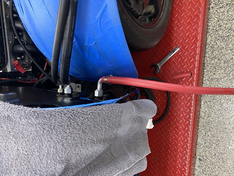

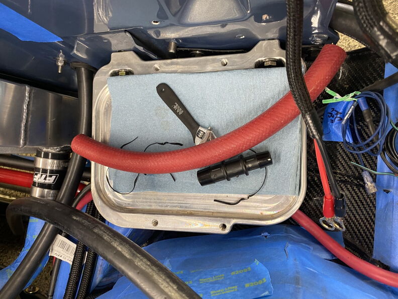

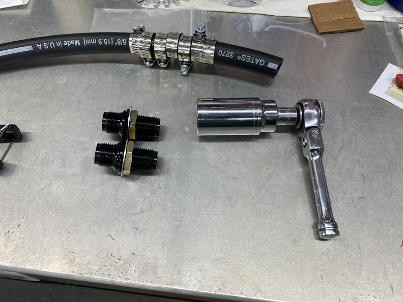

Vintage Air Coolant Lines (( 03-14-21 ))
Finally finishing up the Vintage Air heat lines.
http://www.garagescene.net/_data/i/u...8a1dd30-me.jpg
Yes something is really really wrong with me
http://www.garagescene.net/_data/i/u...e0b1cf0-me.jpg
For mock up I am using this plastic reducer.
http://www.garagescene.net/_data/i/u...a7b88f3-me.jpg
I can't wait till I don't have to touch this valve again.
http://www.garagescene.net/_data/i/u...dd720f2-me.jpg

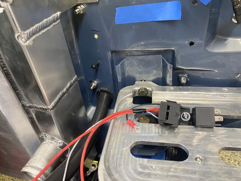

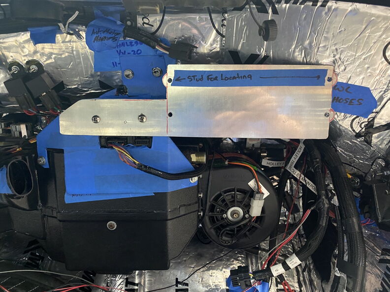

syborg tt 10-03-2021 12:53 PM

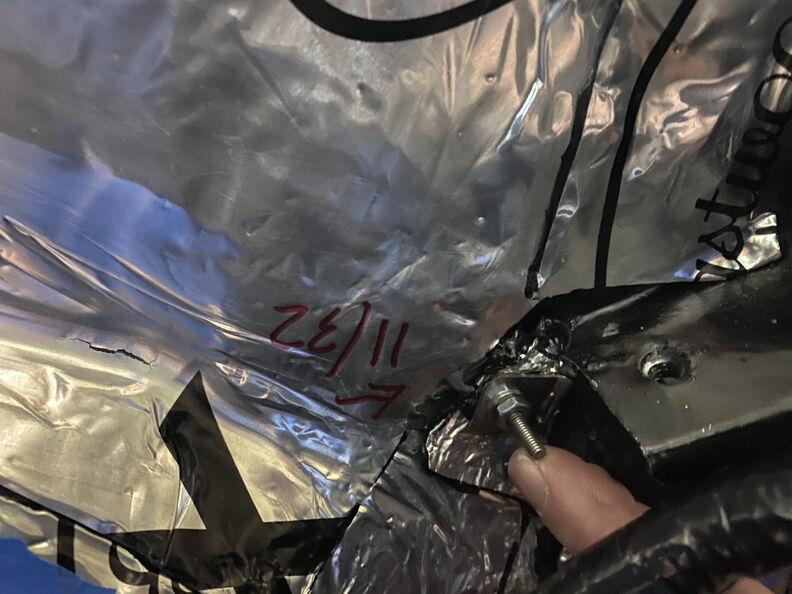

Vintage Air Firewall Fitting (03-13-21)
I missed this one so I am going back to it.

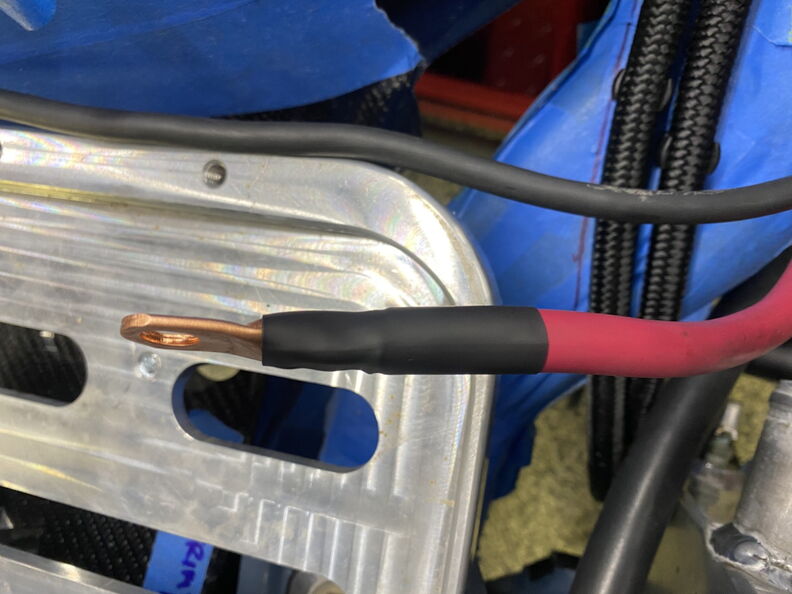

Here is the ground stud that I will be using on the passenger side of the car. It goes directly to the battery and it will be also be a brass bolt.
http://www.garagescene.net/_data/i/u...34aa7cc-me.jpg
Firewall fitting test fitted it one last time before I permatex it to the firewall.
http://www.garagescene.net/_data/i/u...5cd270f-me.jpg
http://www.garagescene.net/_data/i/u...4ae8558-me.jpg
Way back somewhere in this thread I put the part number for the machine washers that I am using on the inside of the firewall.
http://www.garagescene.net/_data/i/u...0d1d300-me.jpg
All glued in and nice and tight.
http://www.garagescene.net/_data/i/u...d806b0f-me.jpg
http://www.garagescene.net/_data/i/u...046969b-me.jpg

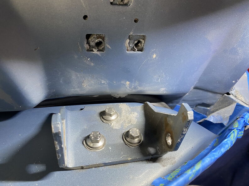

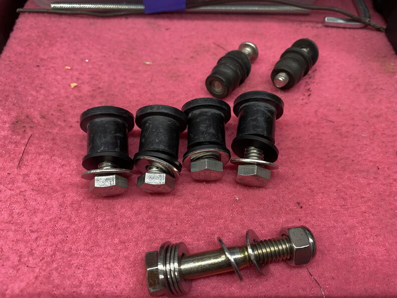

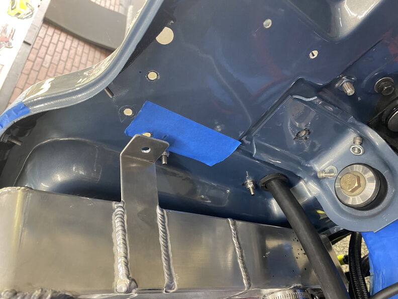

Upper Radiator Mounting Hardware (03-15-21 )
Headed back to Ace Hardware for the tenth time this week.
http://www.garagescene.net/_data/i/u...fe595ad-me.jpg
http://www.garagescene.net/_data/i/u...7a87524-me.jpg
http://www.garagescene.net/_data/i/u...ddfedde-me.jpg
http://www.garagescene.net/_data/i/u...80b4583-me.jpg

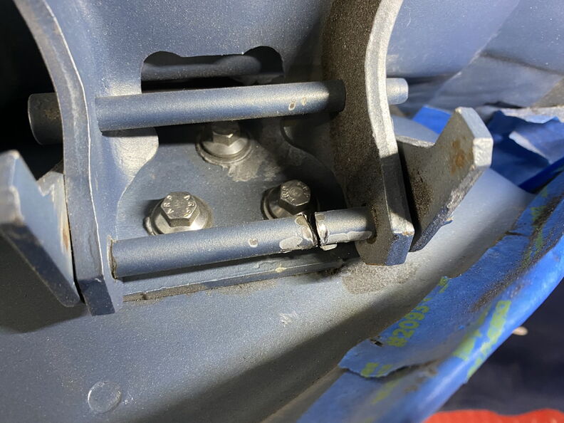

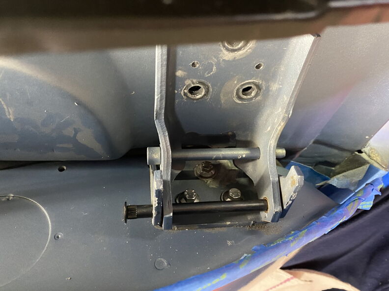

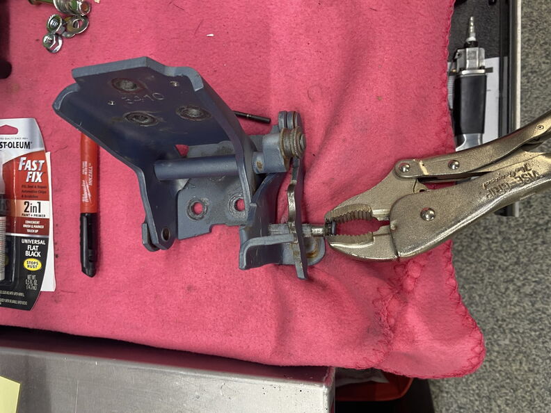

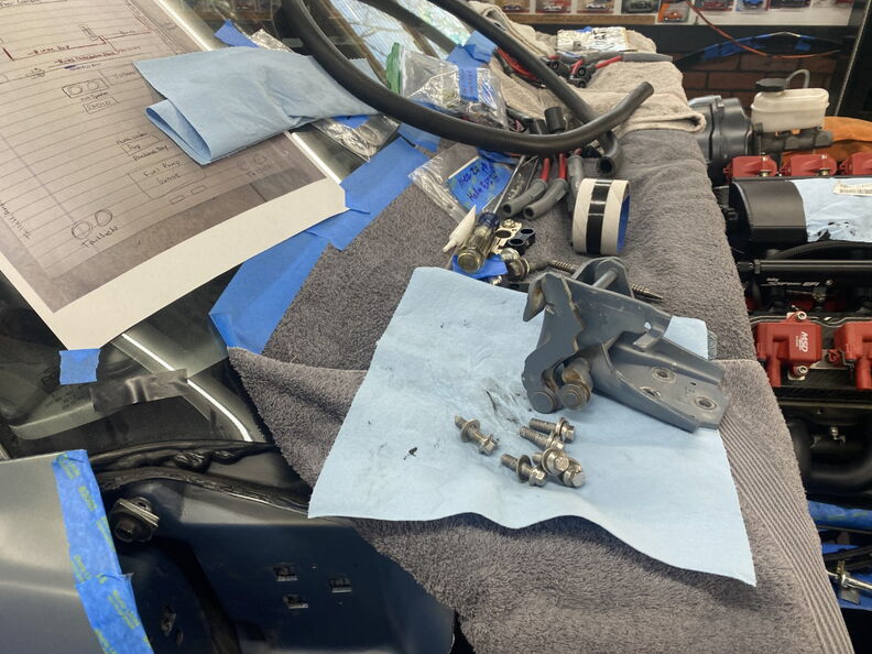

Passenger Door Hinge Bushings, Yes I hate my life. (03-19-21)
This is those while I am here moments.
If you know what these are you now how much this project sucks.
http://www.garagescene.net/_data/i/u...b9e3111-me.jpg
I made the right decision by buying the correct tool to remove the spring which made this a much easier task.
http://www.garagescene.net/_data/i/u...b07baa0-me.jpg
http://www.garagescene.net/_data/i/u...ddb9c6a-me.jpg
http://www.garagescene.net/_data/i/u...a820fce-me.jpg
I also made sure I drilled reference holes so I could the hinges back in the same place once I removed them.
http://www.garagescene.net/_data/i/u...6bc7dbd-me.jpg
New bushings installed and on to the next hinge.
http://www.garagescene.net/_data/i/u...5a5254a-me.jpg
http://www.garagescene.net/_data/i/u...a493f4c-me.jpg
http://www.garagescene.net/_data/i/u...7cd3060-me.jpg
Upper hinge should be much easier.

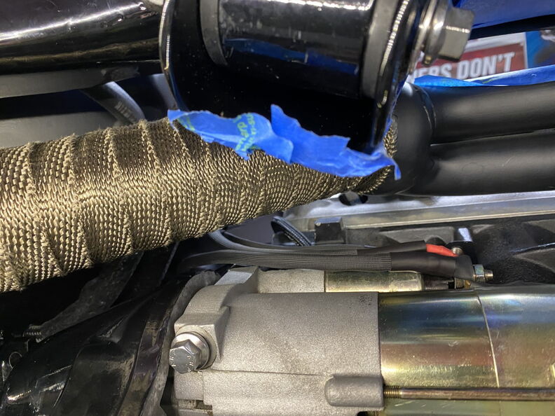

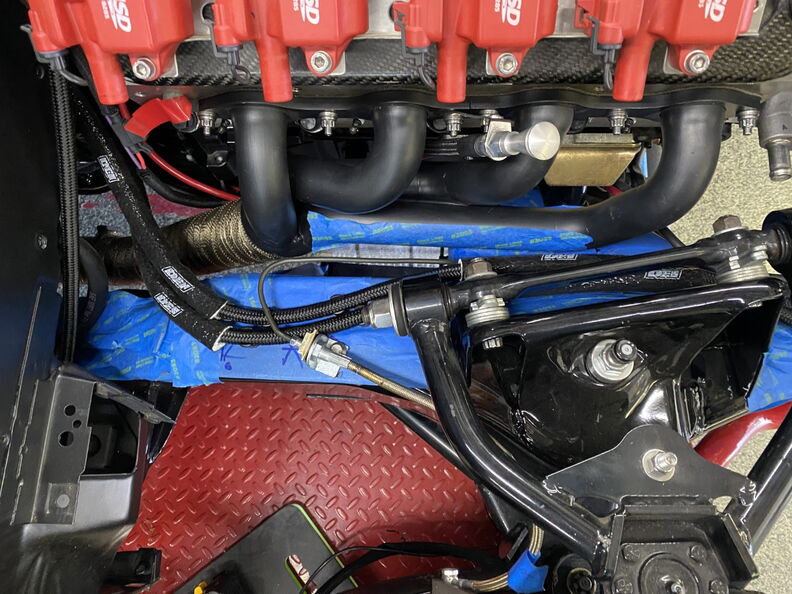

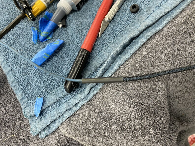

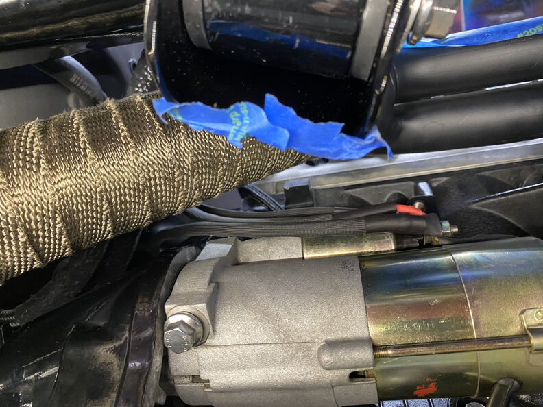

DEI Heat Sleeve on Transmission Lines ( 03-20-21 )
Since the transmission lines are close to the downpipe on the header I decided to wrap the lines in DEI Heat Sleeve.
http://www.garagescene.net/_data/i/u...6d27ba6-me.jpg
http://www.garagescene.net/_data/i/u...c59c017-me.jpg
http://www.garagescene.net/_data/i/u...99f986c-me.jpg
http://www.garagescene.net/_data/i/u...c805a42-me.jpg
http://www.garagescene.net/_data/i/u...dc1ec78-me.jpg

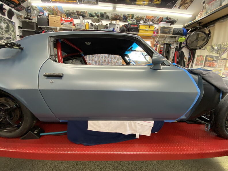

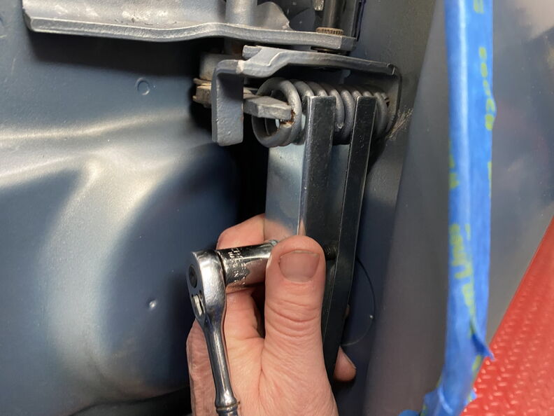

Drivers Side Hinge - Ugh (03-21-21)
So this side didn't go as smoothly as the passenger side.
This tool is a life saver.
http://www.garagescene.net/_data/i/u...fa6ec6d-me.png
Hinge is off and reference marks are set.
http://www.garagescene.net/_data/i/u...dd7c2da-me.jpg
http://www.garagescene.net/_data/i/u...ce8cbb0-me.jpg
This side was not fun.
http://www.garagescene.net/_data/i/u...46643ba-me.jpg
http://www.garagescene.net/_data/i/u...432a0f9-me.jpg
Both hinges are installed and lets just say the door is way off and I needed a break.

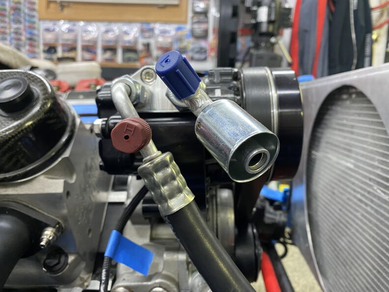

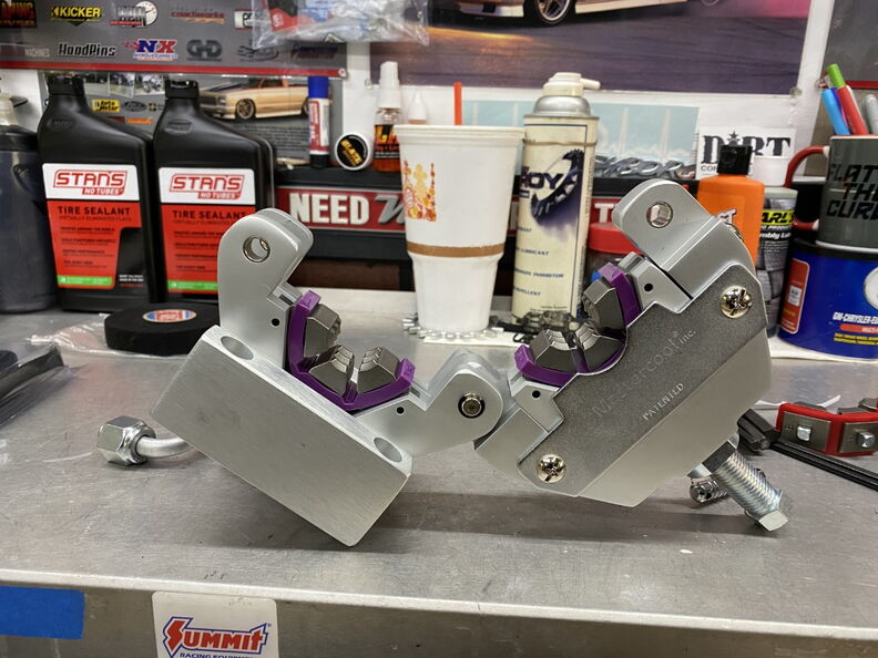

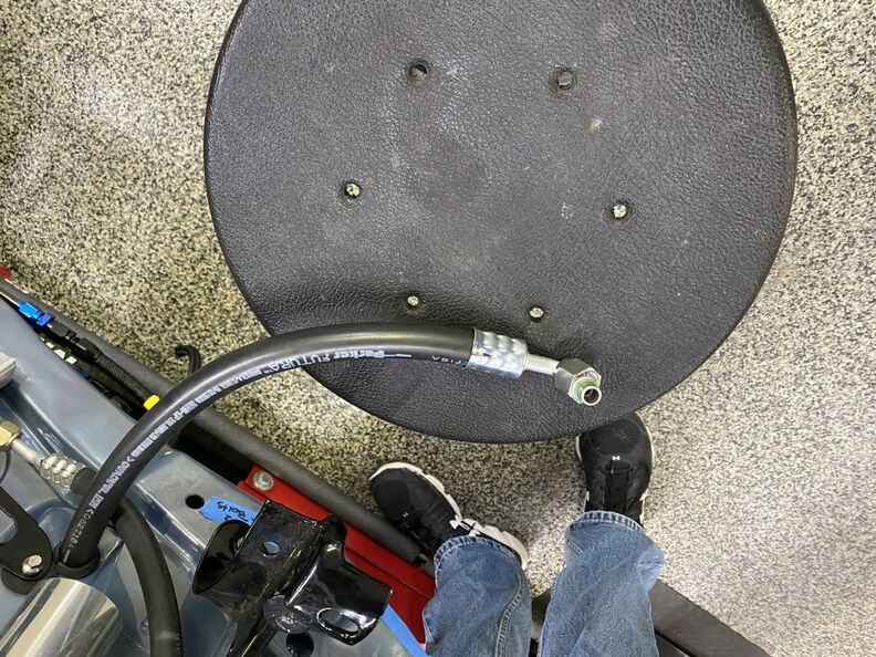

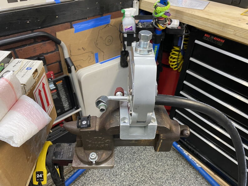

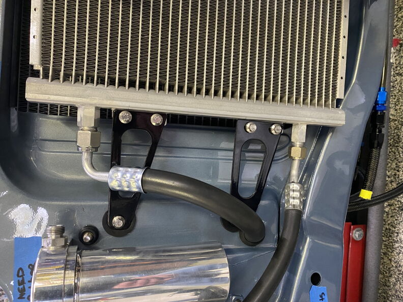

I needed something easy to do I made an AC line. (03-22-21)
Since yesterday didn't go so well I decided to make an AC Line.
http://www.garagescene.net/_data/i/u...798e97e-me.jpg
I plan to crimp the fitting in the engine bay once I have all of the lines in the car.

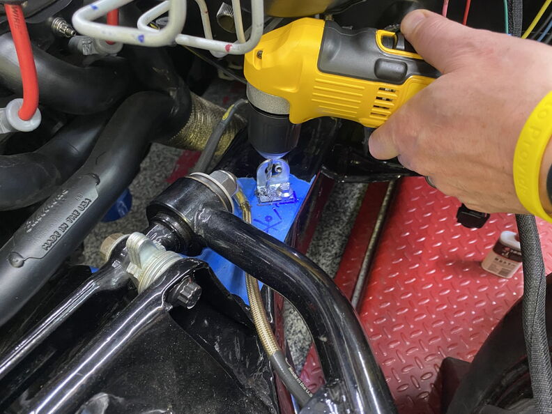

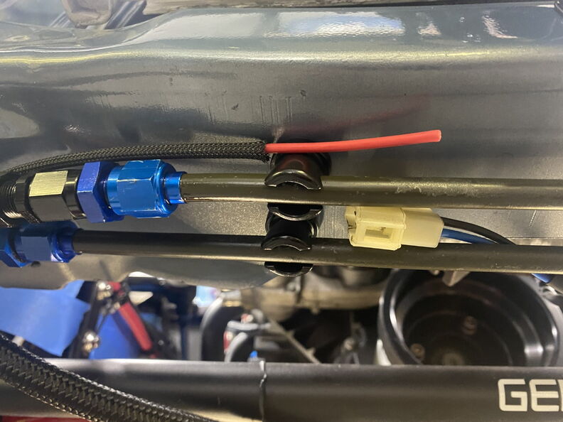

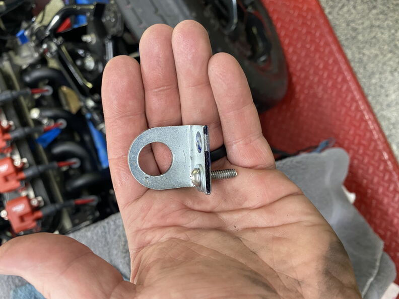

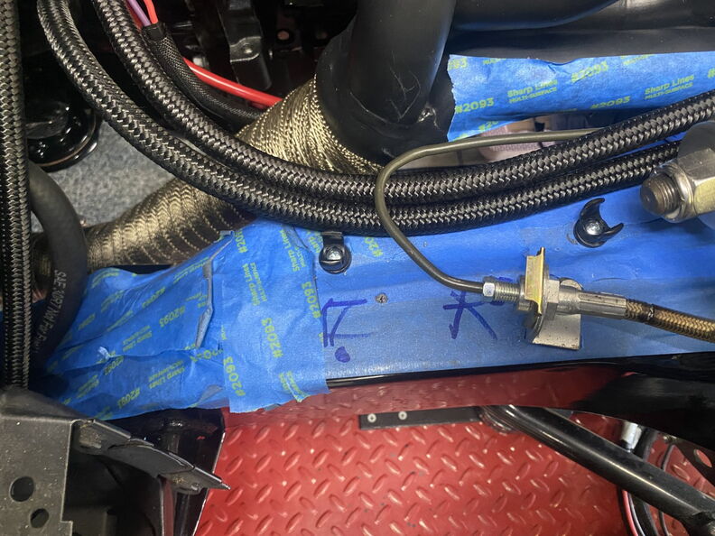

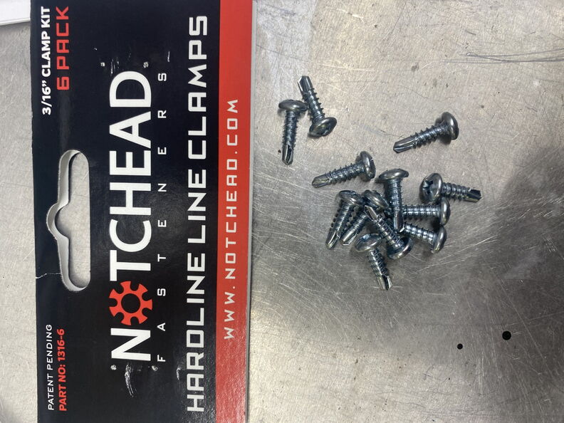

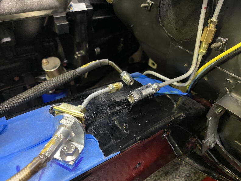

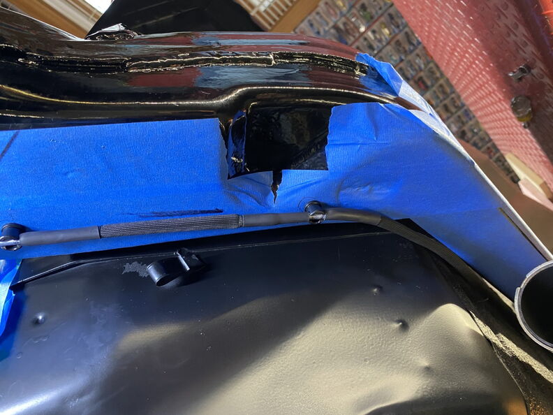

Notch-Head Brake Line Clips (03-31-21)

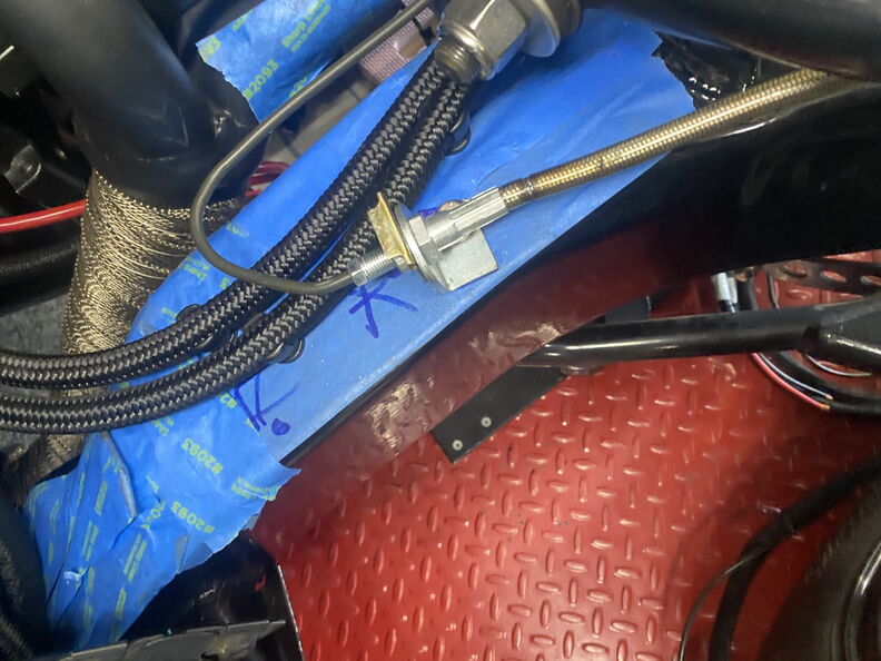

Time to installed the Notch-Head line clamps. Drilling the hole in the frame with the itty-bitty drill bit is very very scary.
http://www.garagescene.net/_data/i/u...f414296-me.jpg
http://www.garagescene.net/_data/i/u...b592118-me.jpg
http://www.garagescene.net/_data/i/u...dc5ac50-me.jpg
http://www.garagescene.net/_data/i/u...21d9d16-me.jpg
http://www.garagescene.net/_data/i/u...b0f4acf-me.jpg

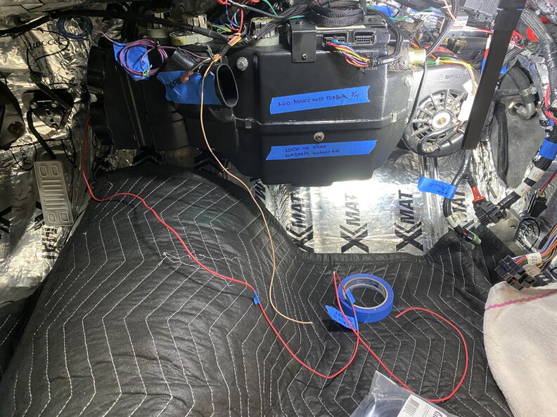

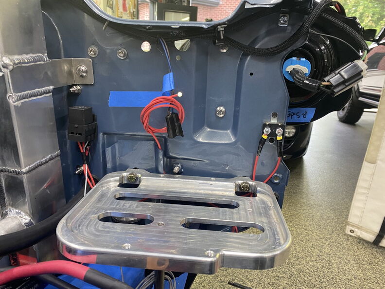

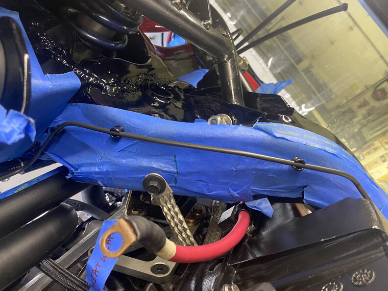

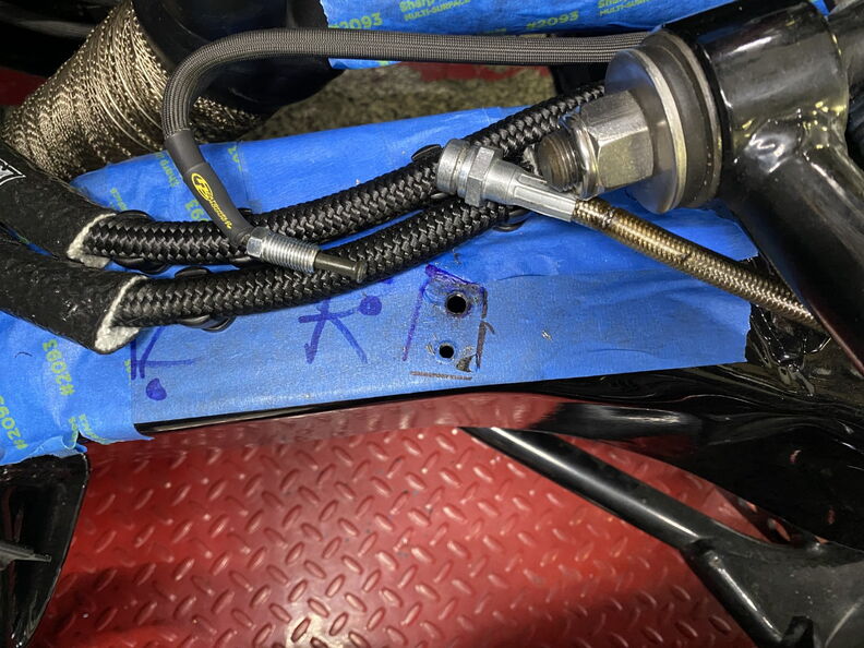

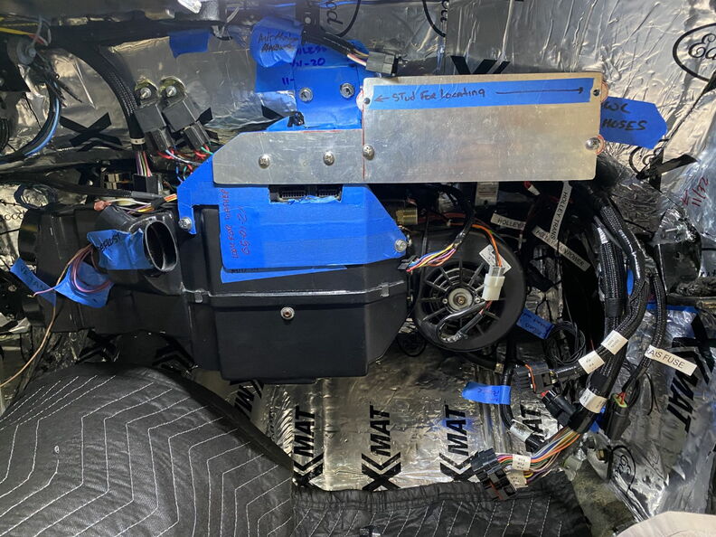

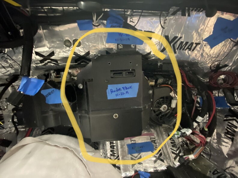

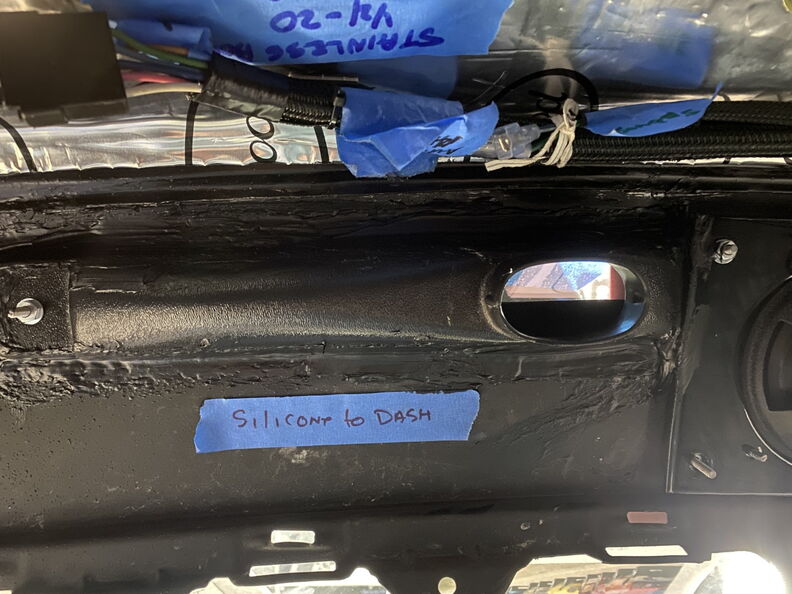

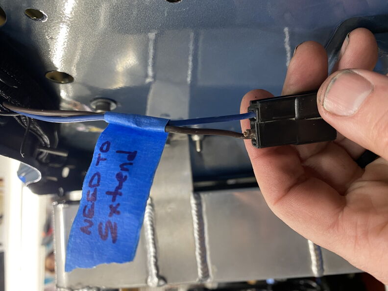

Misc Blue Tape Notes

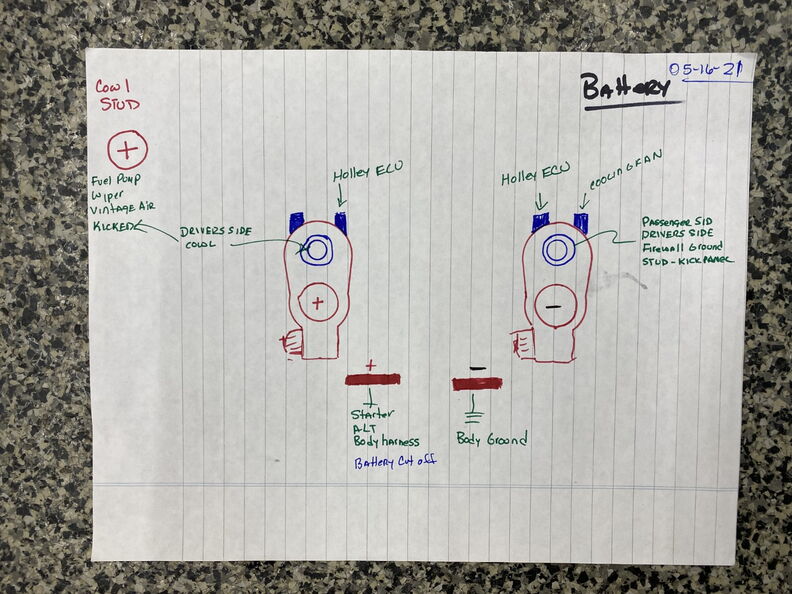

So I started making notes on the car for things I need to address.
http://www.garagescene.net/_data/i/u...053409b-me.jpg

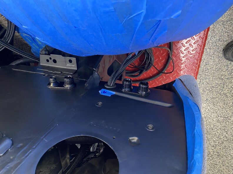

I also need to plug this holes since I am planning on using the Wildwood electric parking brake calipers.
http://www.garagescene.net/_data/i/u...293a8c8-me.jpg
I will be using this wire when I install the Fessler RS light in the RS modified upper valance.
http://www.garagescene.net/_data/i/u...25b8320-me.jpg
I also need to extend the line as my goal is to hide/clean up as much as of the wiring I can behind the grill.
http://www.garagescene.net/_data/i/u...97afc2b-me.jpg

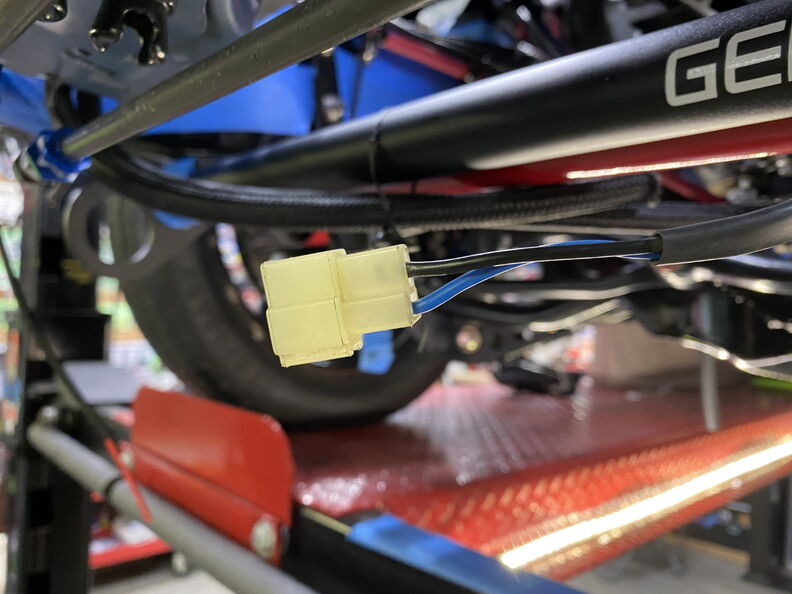

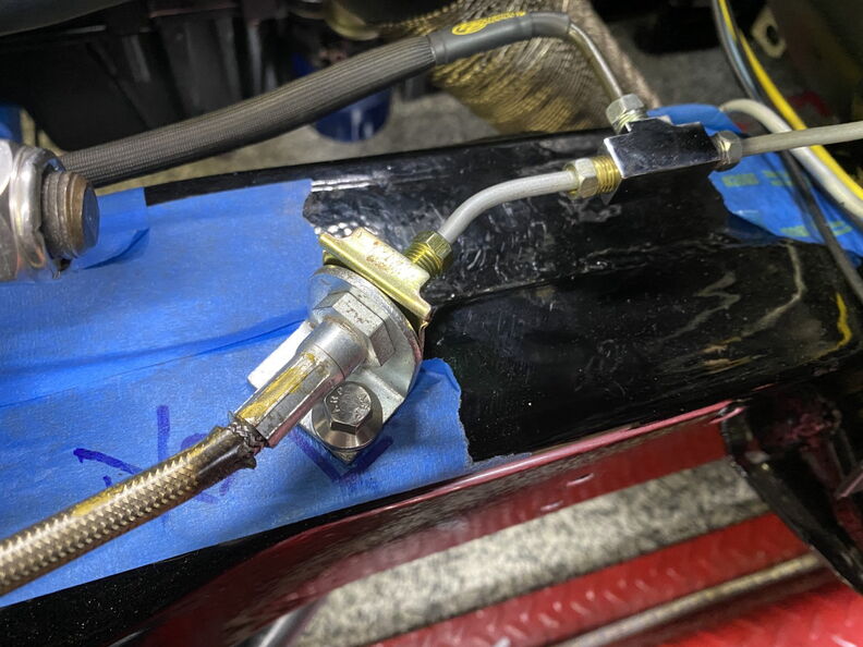

syborg tt 10-03-2021 03:19 PM

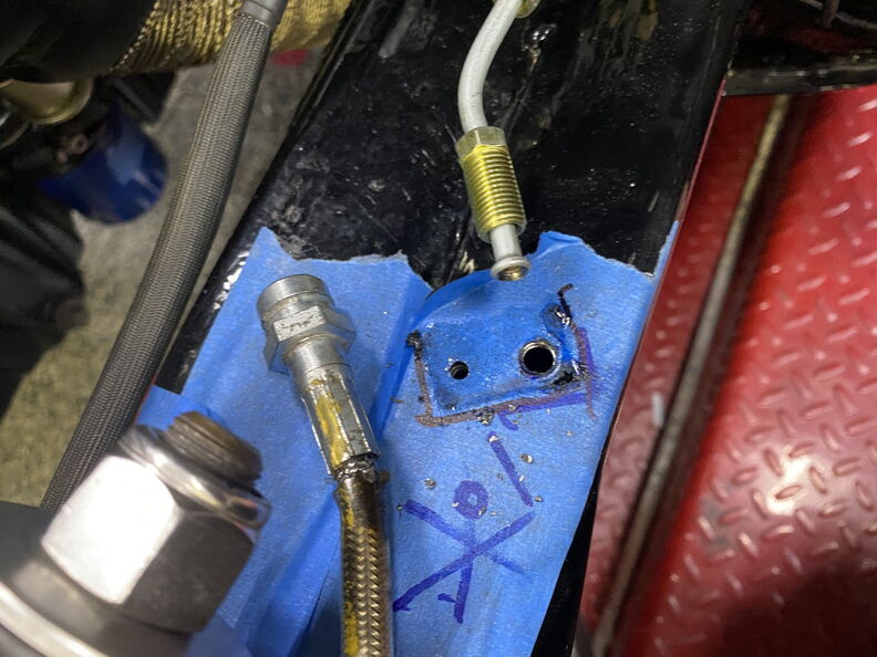

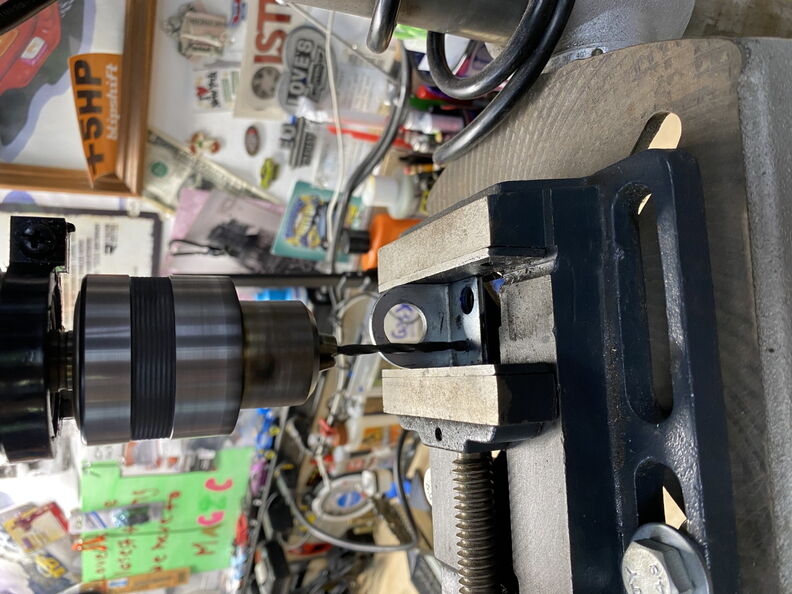

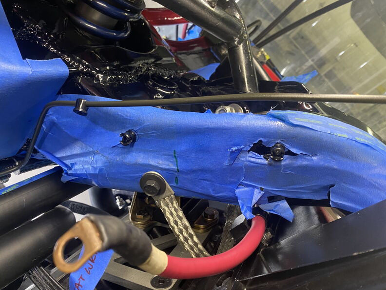

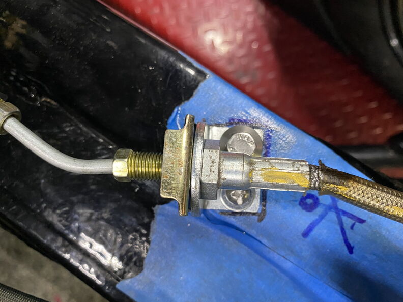

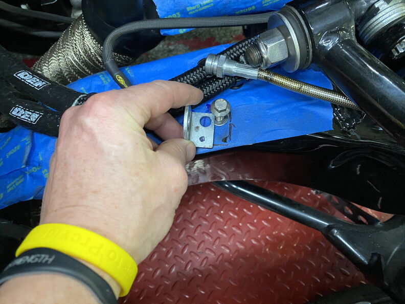

Finishing Up the Notchead installation (04-04-21 )

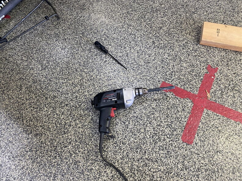

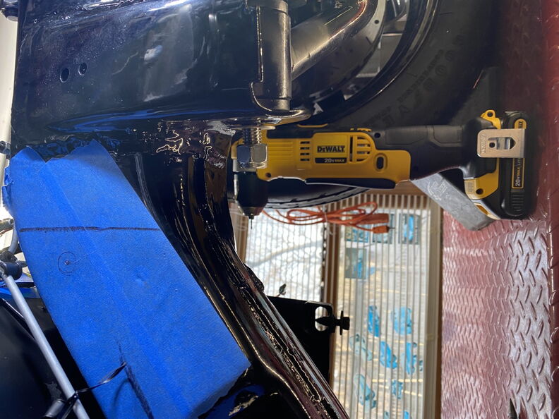

In order for me to finish the last couple holes I need a right hand drive drill and it is also nice to have an excuse to buy new tools.
http://www.garagescene.net/_data/i/u...0c615aa-me.jpg

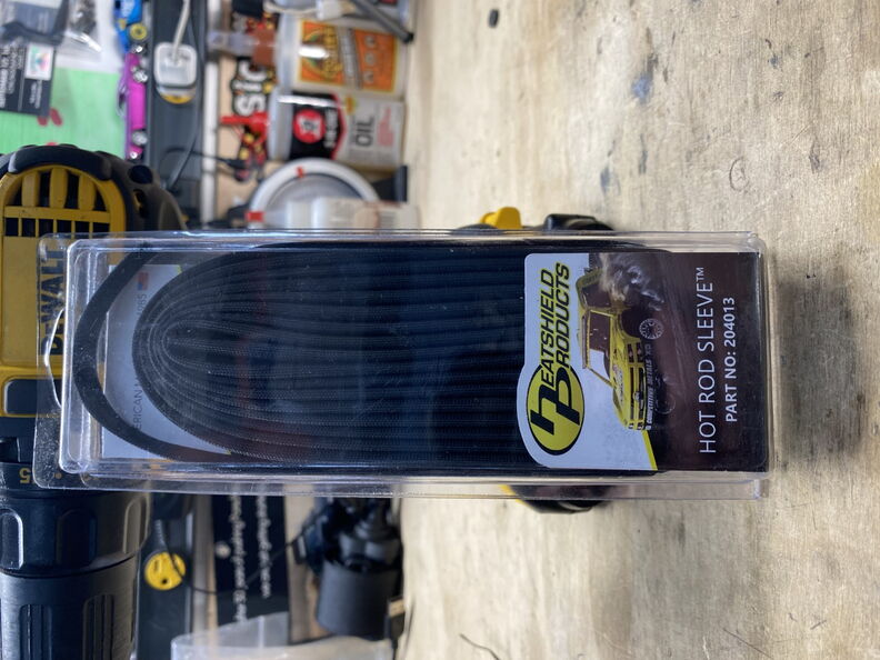

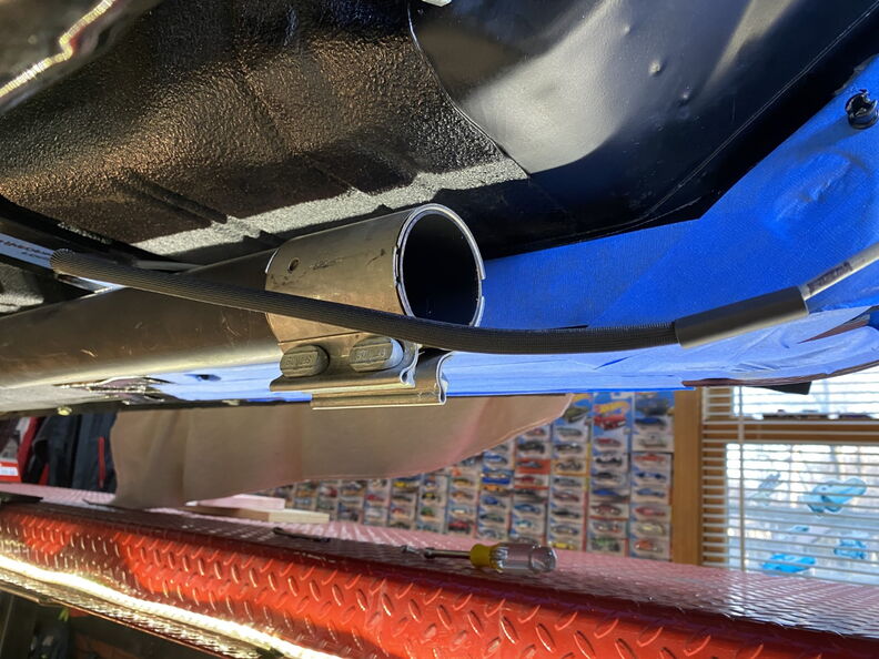

I decided to install "Hot Rod Sleeve" on the drivers side brake line.
http://www.garagescene.net/_data/i/u...0dc6037-me.jpg
http://www.garagescene.net/_data/i/u...e8810f8-me.jpg
http://www.garagescene.net/_data/i/u...3cbb5ff-me.jpg
http://www.garagescene.net/_data/i/u...0d4a772-me.jpg
http://www.garagescene.net/_data/i/u...c8993d9-me.jpg

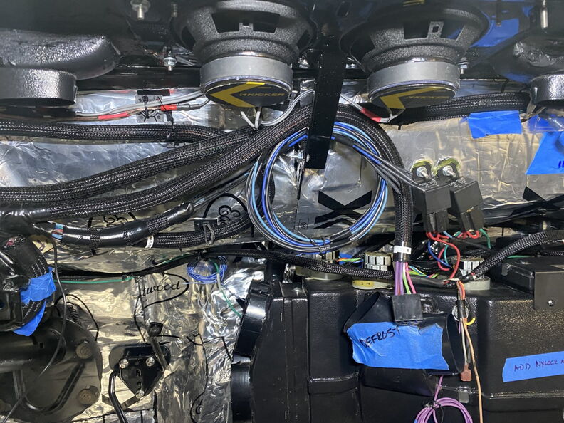

syborg tt 10-03-2021 03:57 PM

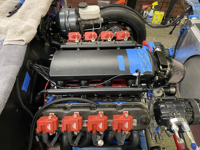

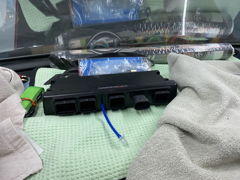

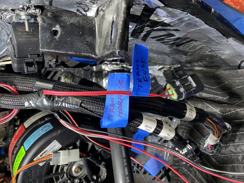

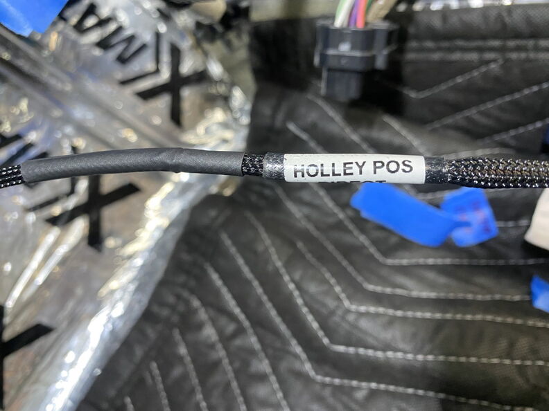

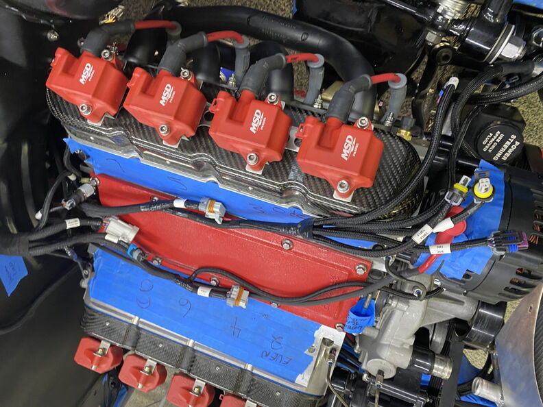

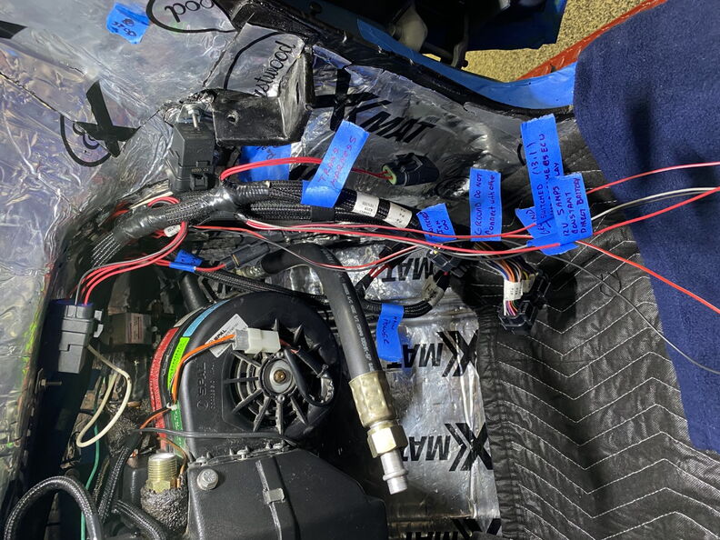

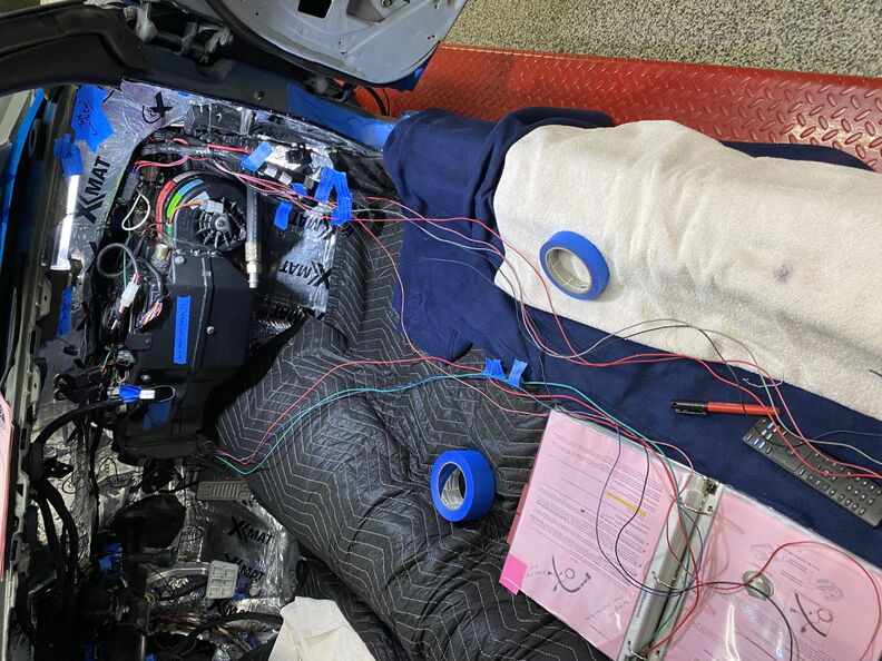

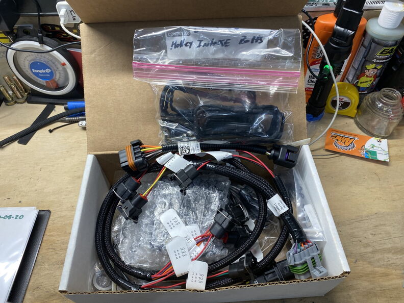

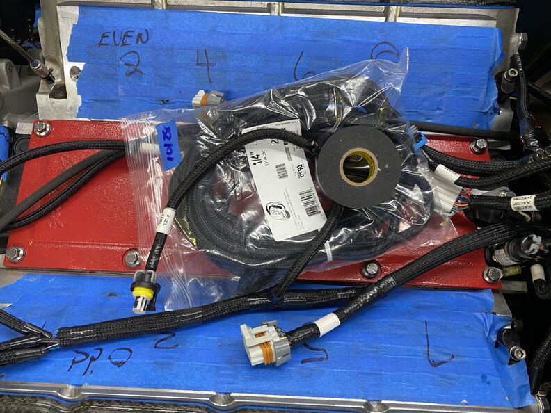

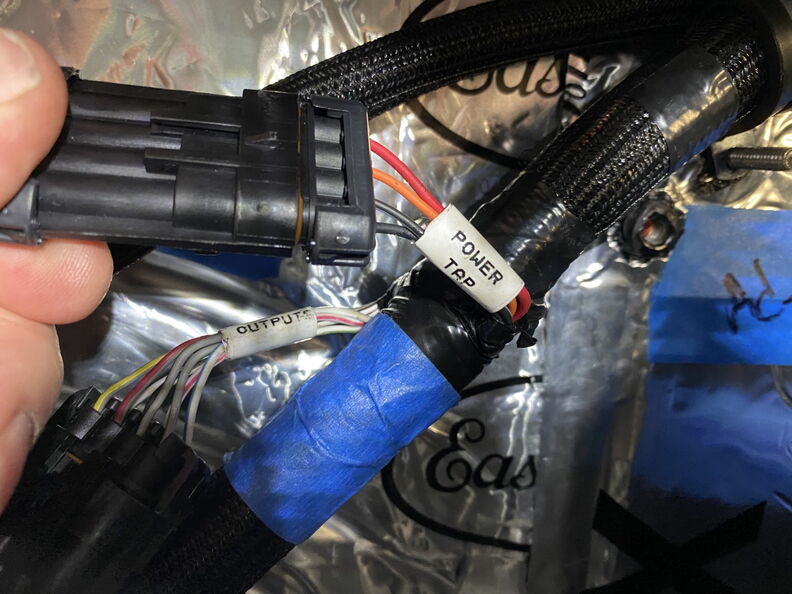

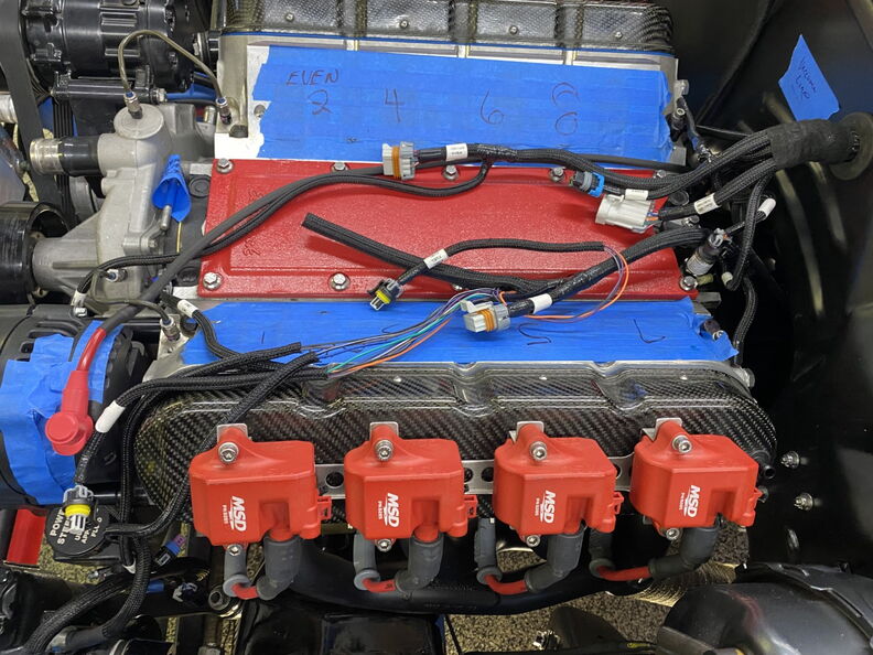

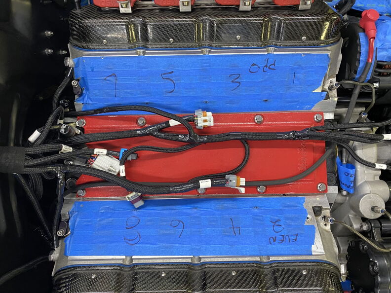

Holley EFI Wiring (04-07-21)
Jumping back on the Holley EFI Wiring.
What is that song ???
https://www.youtube.com/watch?v=c9lh7lqZojc
Wire Wire Everywhere a Wire, Messing up the scenery, losing my mind.

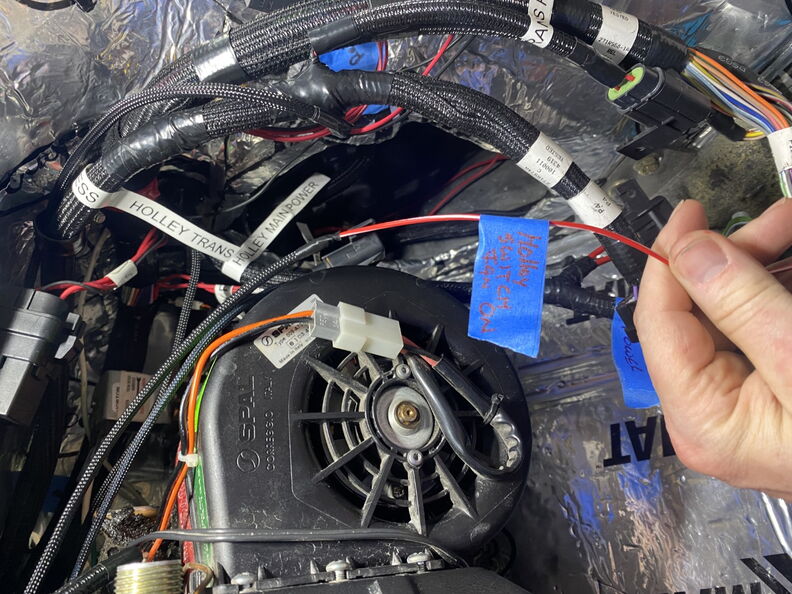

So my goal is to make all of this look as clean as possible and work.
http://www.garagescene.net/_data/i/u...4d78944-me.jpg
http://www.garagescene.net/_data/i/u...8a87b71-me.jpg
More notes
http://www.garagescene.net/_data/i/u...847296f-me.jpg

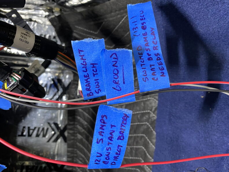

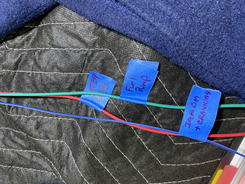

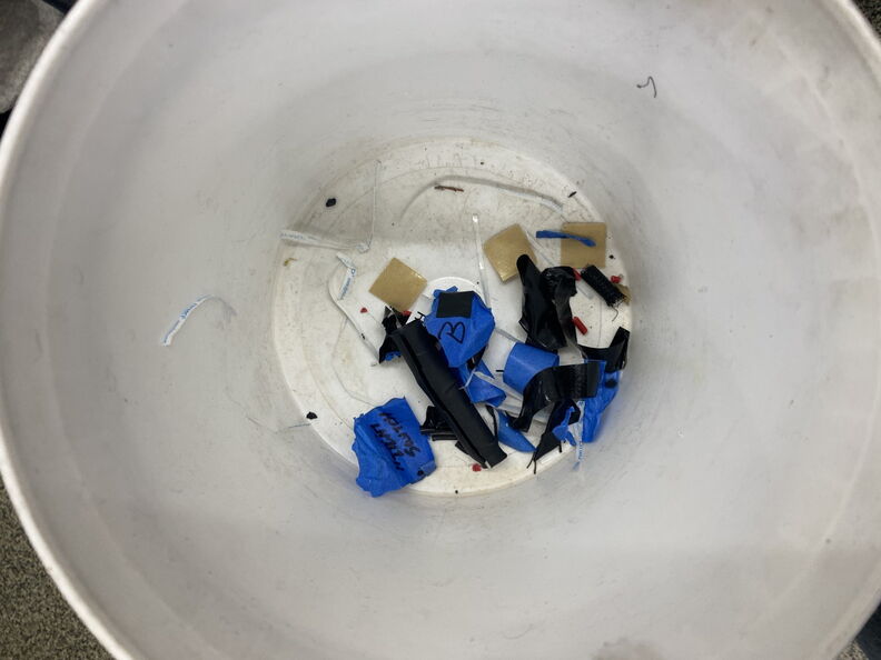

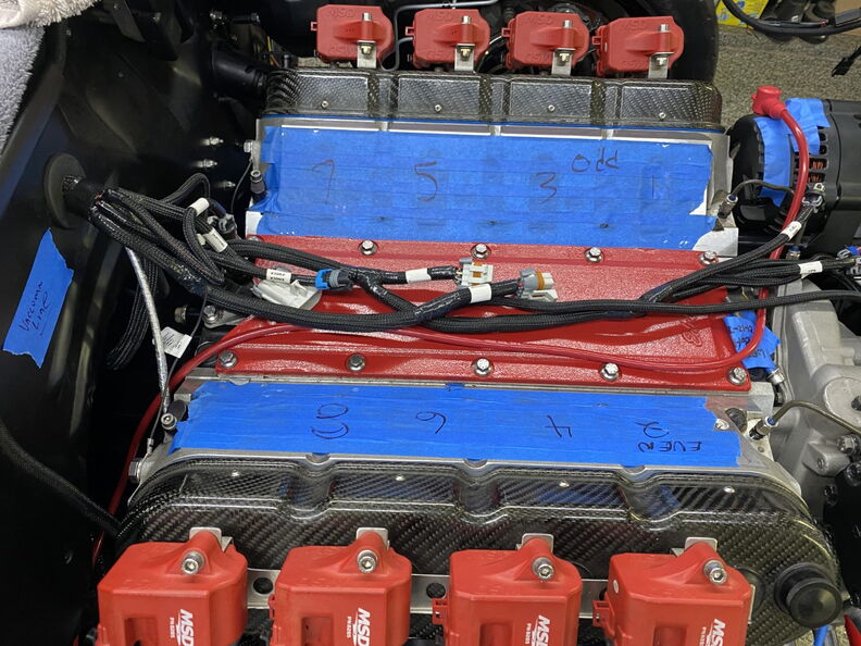

As you all know I am fairly organized and since my memory sucks (chemo-brain) I have a binder for instructions and another for all of my To Do Lists.
http://www.garagescene.net/_data/i/u...0694c2d-me.jpg
I love my blue tape.
http://www.garagescene.net/_data/i/u...858098f-me.jpg
http://www.garagescene.net/_data/i/u...9429705-me.jpg
http://www.garagescene.net/_data/i/u...af526c1-me.jpg
http://www.garagescene.net/_data/i/u...aa608b7-me.jpg
http://www.garagescene.net/_data/i/u...11dddcf-me.jpg
http://www.garagescene.net/_data/i/u...2d7bb52-me.jpg
http://www.garagescene.net/_data/i/u...a0db027-me.jpg
http://www.garagescene.net/_data/i/u...aa46ddd-me.jpg

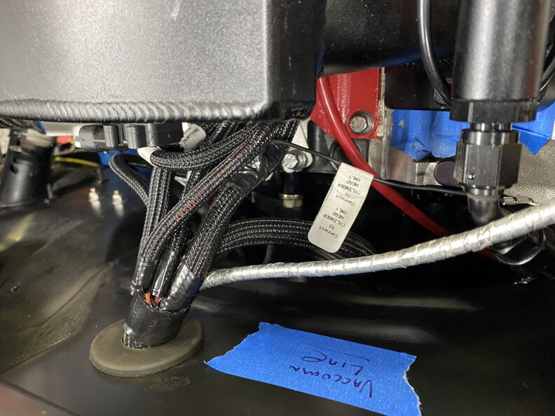

I've learned that is you write the not immediately and put it in the place that it needs to be there is a good chance you won't forget the task and get burned later.
http://www.garagescene.net/_data/i/u...73d6bdc-me.jpg

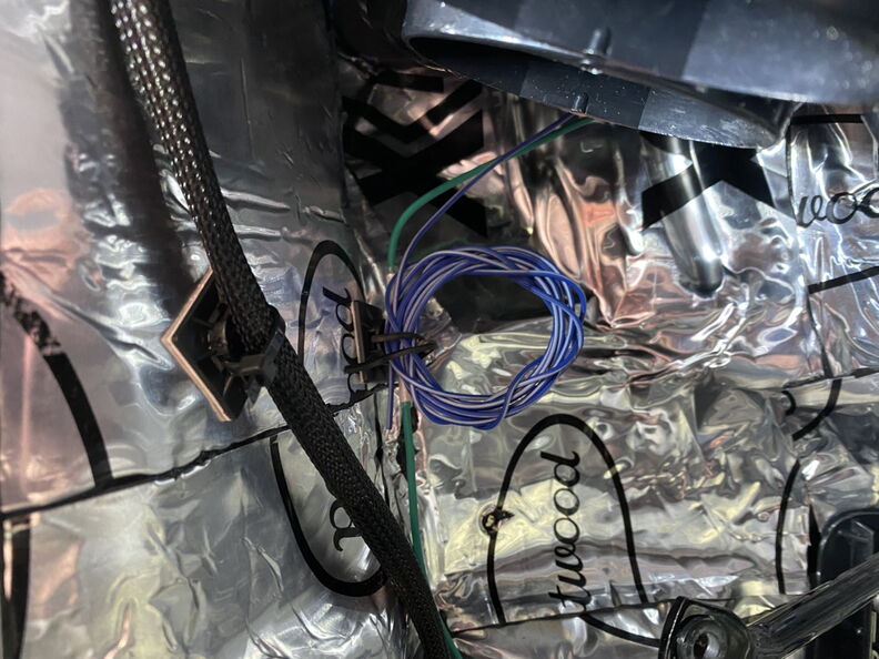

I will be installing Tessa tape on both sides of this line clamp to stabilize the line so it doesn't move back and forth and pinch the fuel pump fuse. The Holley ECU has a direct power for the fuel pump which is very nice.
http://www.garagescene.net/_data/i/u...71abef5-me.jpg

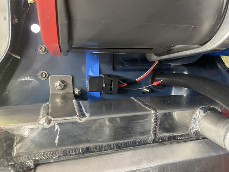

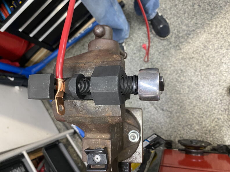

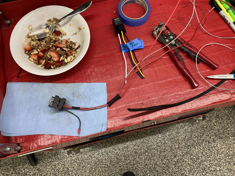

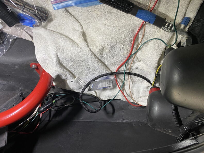

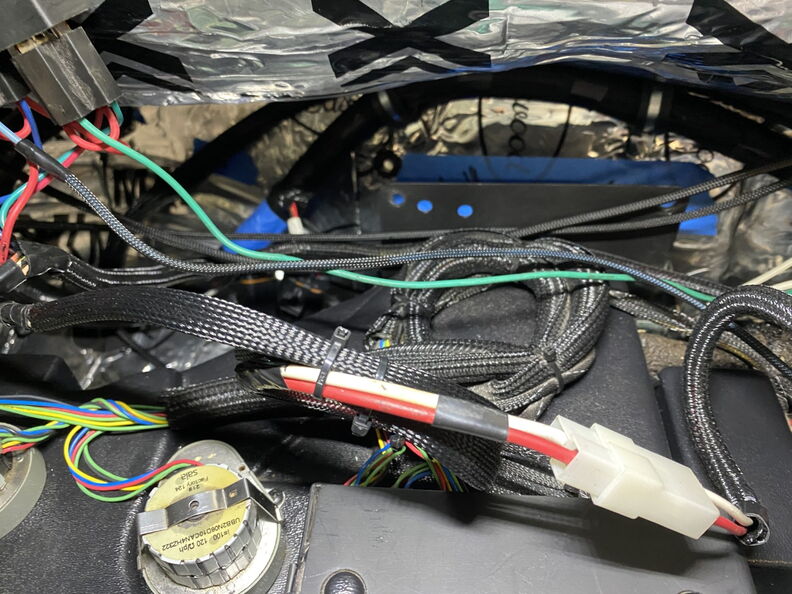

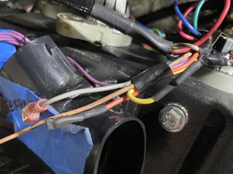

It's a cute little wire.
http://www.garagescene.net/_data/i/u...5b49358-me.jpg

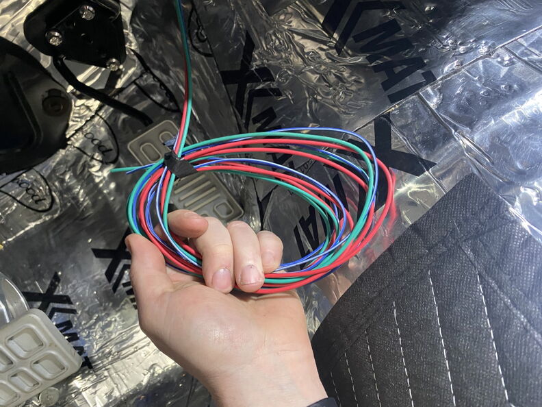

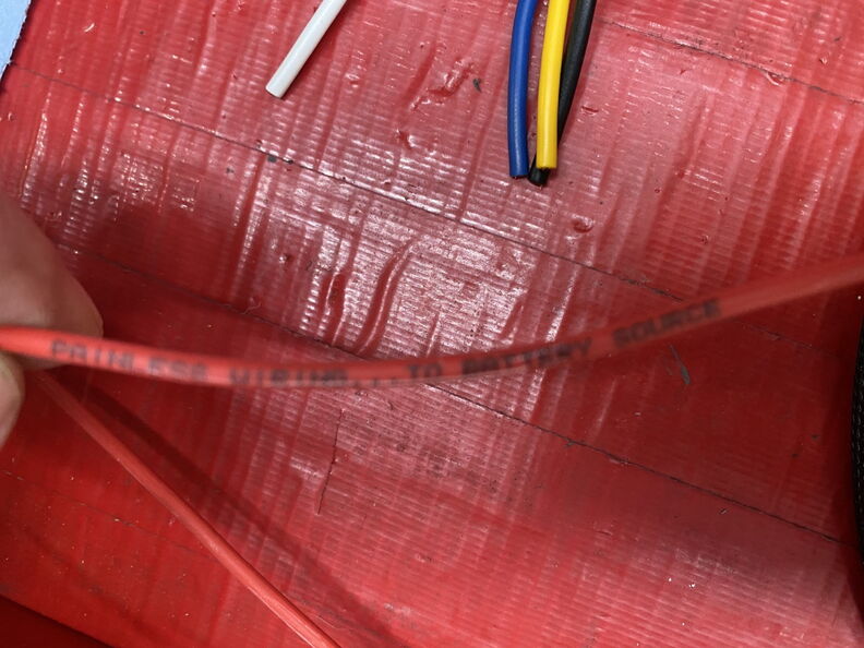

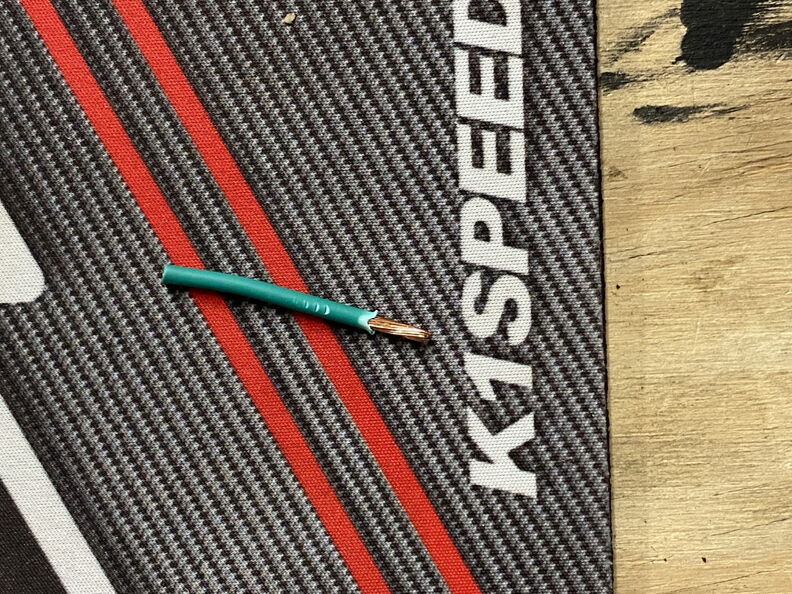

Good news I just so happen to have a green 14 gauge wire in my box. (Note this wire was not to spec and I ended up using this wire to trigger a relay.)
http://www.garagescene.net/_data/i/u...8179310-me.jpg
http://www.garagescene.net/_data/i/u...0178ed8-me.jpg
http://www.garagescene.net/_data/i/u...ee62c85-me.jpg

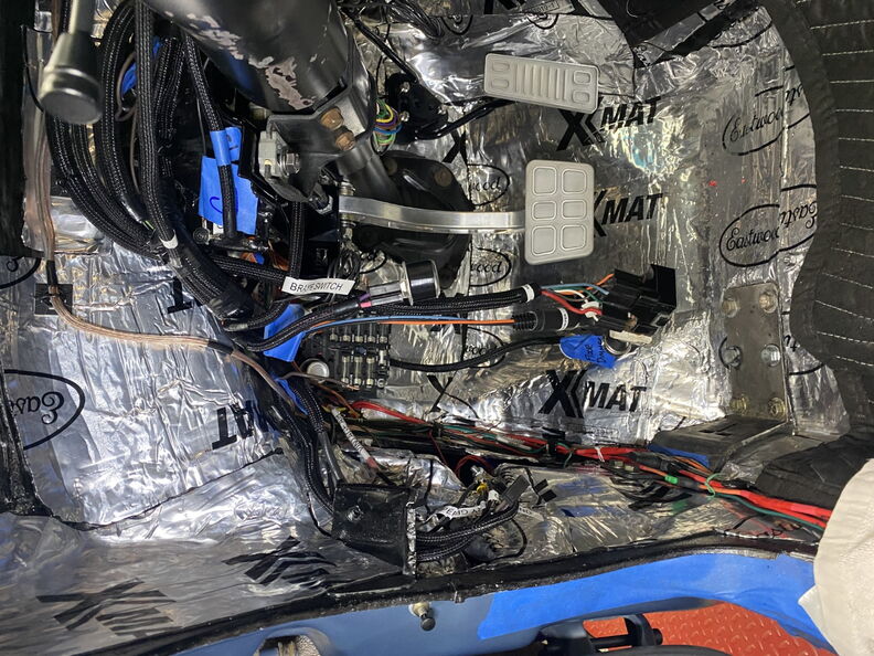

Of course I labeled it under the dash and in the trunk.
http://www.garagescene.net/_data/i/u...c9f8914-me.jpg
http://www.garagescene.net/_data/i/u...66ad228-me.jpg
http://www.garagescene.net/_data/i/u...357c7ad-me.jpg

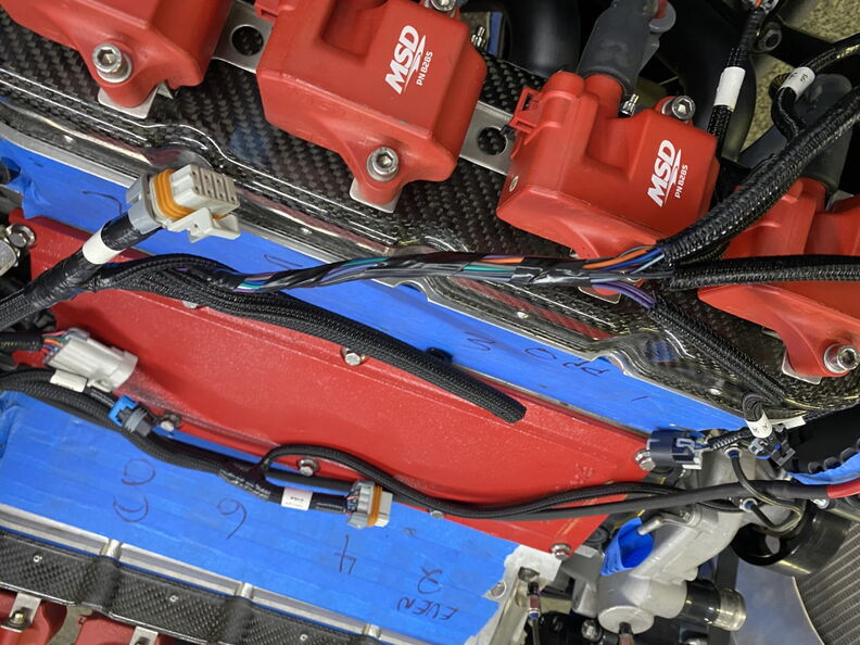

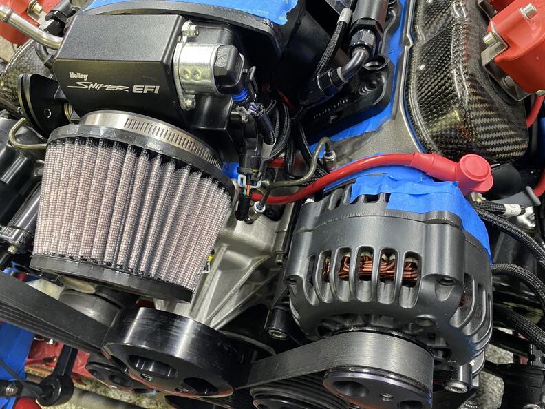

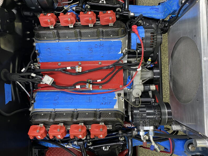

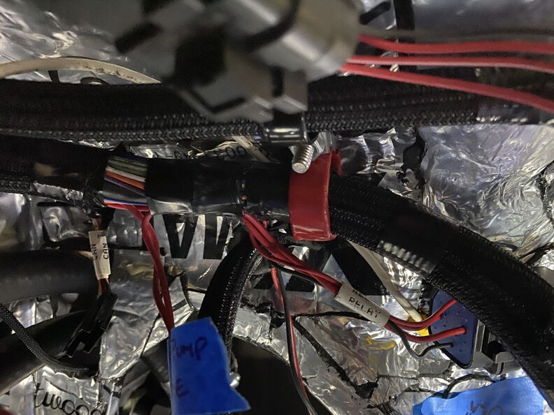

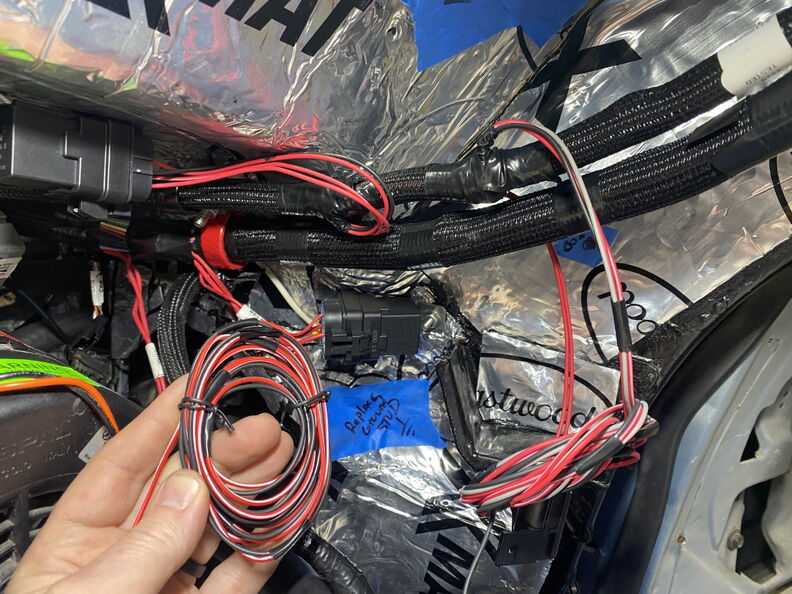

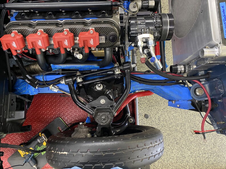

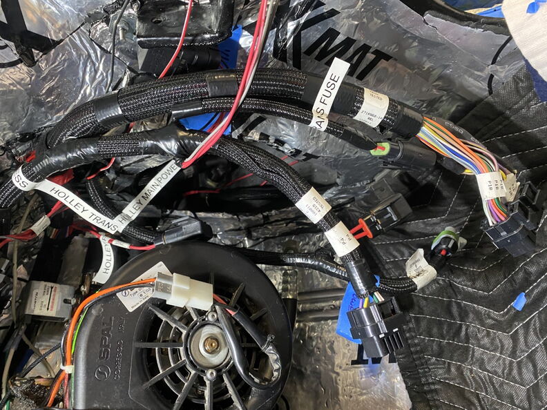

Holley EFI Wiring Underhood Wiring (04-10-21)

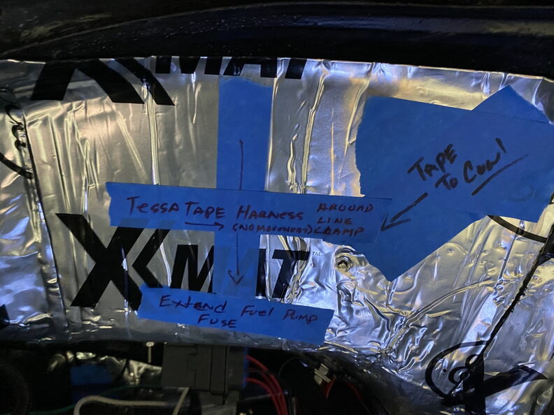

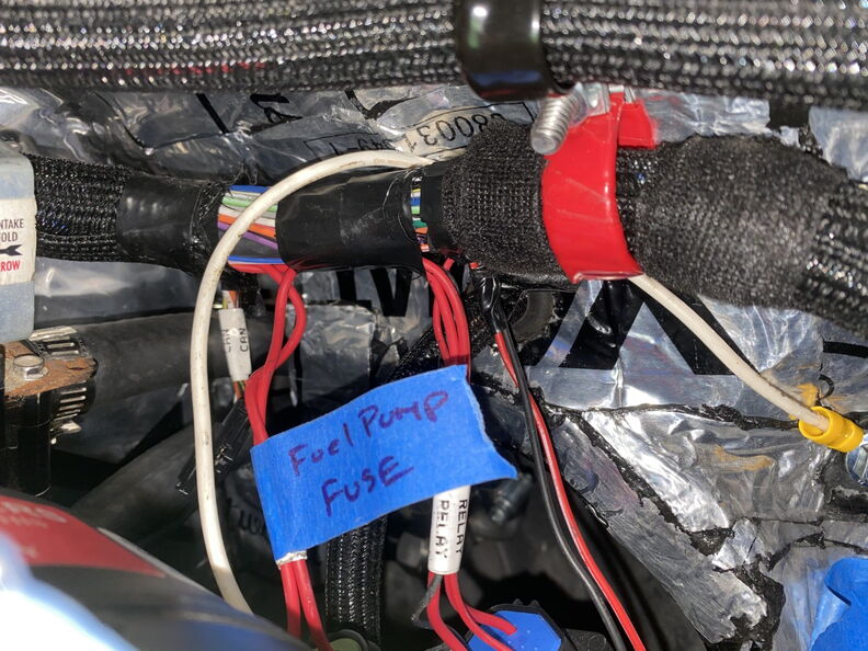

My goal is to make everything look as factory as possible. However, I want it to look clean and easy-ish to service.
http://www.garagescene.net/_data/i/u...054bd22-me.jpg
http://www.garagescene.net/_data/i/u...2a9fb44-me.jpg
I just don't like the look this area of the Holley Harness.
http://www.garagescene.net/_data/i/u...47ba0cd-me.jpg

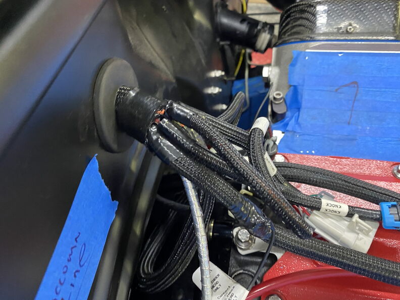

One more note on the firewall to remind me drill yet another hole in the firewall.
http://www.garagescene.net/_data/i/u...740f599-me.jpg
I rewrapped the harness with tessa tape near the firewall.
http://www.garagescene.net/_data/i/u...cc31b44-me.jpg
I started running the wires to all the proper locations.
http://www.garagescene.net/_data/i/u...f10dc70-me.jpg
Moving on to the starter.
http://www.garagescene.net/_data/i/u...5f3d483-me.jpg
http://www.garagescene.net/_data/i/u...e3ca9b5-me.jpg
http://www.garagescene.net/_data/i/u...88abab2-me.jpg
syborg tt 10-03-2021 04:22 PM
Still not happy with the Intake wiring. (04-11-21)
Yep, I just don't like it.
http://www.garagescene.net/_data/i/u...e91cd27-me.jpg
Yep, the loom is coming apart again.
http://www.garagescene.net/_data/i/u...93302ad-me.jpg
http://www.garagescene.net/_data/i/u...4b51ece-me.jpg
http://www.garagescene.net/_data/i/u...521ff56-me.jpg
I think it looks a little better.
http://www.garagescene.net/_data/i/u...f4c30ab-me.jpg

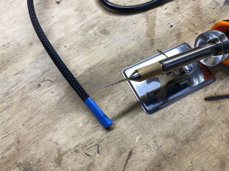

So if you are using the Tech-Flex wire loom this is the best tool for cutting it without it fraying.
http://www.garagescene.net/_data/i/u...fc7d2c2-me.png
http://www.garagescene.net/_data/i/u...2989f60-me.jpg

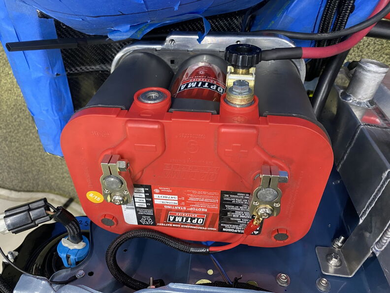

Battery Kill Switch (04-11-21)
Mike came over to help with battery kill switch.
http://www.garagescene.net/_data/i/u...2015646-me.jpg

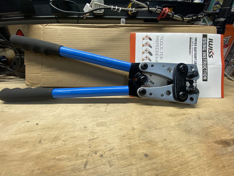

Mike has this really cool crimping tool for the battery wire.
http://www.garagescene.net/_data/i/u...ab2e013-me.jpg
http://www.garagescene.net/_data/i/u...ad8fa71-me.jpg
http://www.garagescene.net/_data/i/u...80eb175-me.jpg
http://www.garagescene.net/_data/i/u...4bc37a4-me.jpg

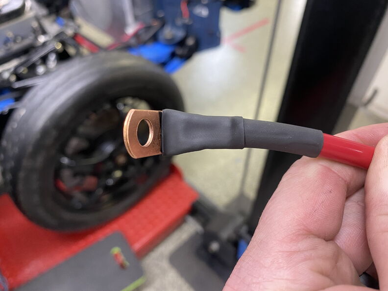

We also made the alternator charge wire.
http://www.garagescene.net/_data/i/u...cb9b739-me.jpg
http://www.garagescene.net/_data/i/u...c736066-me.jpg
http://www.garagescene.net/_data/i/u...bca2698-me.jpg
I put a little bit of Heat Sleeve on the wire.
http://www.garagescene.net/_data/i/u...9bda8d5-me.jpg
http://www.garagescene.net/_data/i/u...2c2847a-me.jpg
syborg tt 10-03-2021 04:58 PM
Back on the Holley EFI Wiring (04-18-21)
Ugh
http://www.garagescene.net/_data/i/u...0ea3974-me.jpg
I started pulling the wire out that need to go their final home.
http://www.garagescene.net/_data/i/u...b9024f7-me.jpg
Installed the tech flex sleeve over the wire and ran it over to it's new home.
http://www.garagescene.net/_data/i/u...ba57c19-me.jpg
http://www.garagescene.net/_data/i/u...b0c5a9f-me.jpg
I also just put a label tag on the wire looms which I plan to leave since they are under the dash.
http://www.garagescene.net/_data/i/u...0ed28d6-me.jpg
Yet another reference pictures
http://www.garagescene.net/_data/i/u...2dfe857-me.jpg
Remember the Tessa Tape note well I finally applied the tape.
http://www.garagescene.net/_data/i/u...b05e6b5-me.jpg

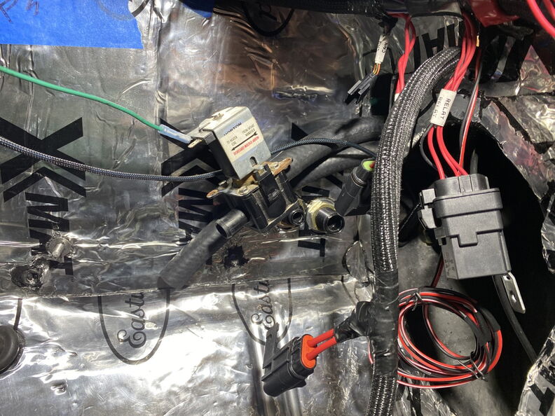

Well, It looks like I have to find the manual for the vintage air unit as I have no clue where the Gray wire goes.
http://www.garagescene.net/_data/i/u...96b856f-me.jpg

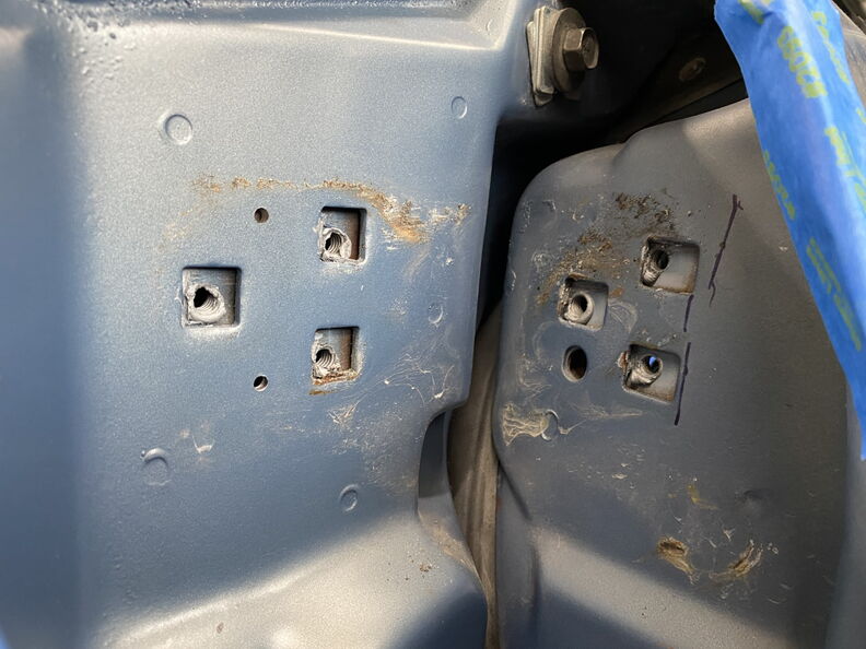

I am going to incorporate the door handles into my interior.
https://uploads.tapatalk-cdn.com/202...7e60ae7957.jpg
https://uploads.tapatalk-cdn.com/202...3cd996a3cb.jpg
https://uploads.tapatalk-cdn.com/202...6c11233a05.jpg

DWC 10-04-2021 07:22 AM
http://www.garagescene.net/_data/i/u...96b856f-me.jpg[/QUOTE]
Double check behind me, but I believe the gray wire with red connector is the program wire for calibrating the control panel/levers.
Daniel

jarhead 10-04-2021 03:56 PM
Looks like you are hitting it hard Marty.:gitrdun:
I'm about to do my Torino hinges and not looking forward to it.
syborg tt 10-04-2021 04:58 PM
Thank you and I am been trying to get out to the car every chance I can even if it's only for an hour. I think it Mr Steilow that said an hour here or there is still progress.
On a side note make sure you do the top hinge first. I learned that the hard way when I went over to the drivers side. What I should have done was replace the bushing on the top and check the door alignment and I needed to re-adjust this is when you do it. I did the bottom first on the drivers side and well it went south really fast or closer to the earth. So far south I couldn't even shut the door. I eventually walked away and called Larry (Body Guy) and he laughed at me and said well son you screwed up. Replace the top, gently try to close the door and if doesn't line up lift up or lower the door and try to get it the top hinge set. Then you do the bottom hinge and it will be much easier.
Lesson Learned !!!!

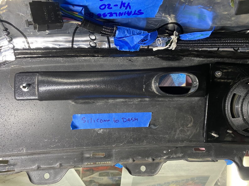

Mindless projects are sometimes needed (04-18-21)
I wanted and needed something mindless so I decided I would silicone the defrost vents to the underside of the dash. Hopefully I won't regret this.
http://www.garagescene.net/_data/i/u...0581932-me.jpg
I think my note told me to do it.
http://www.garagescene.net/_data/i/u...342ed0e-me.jpg

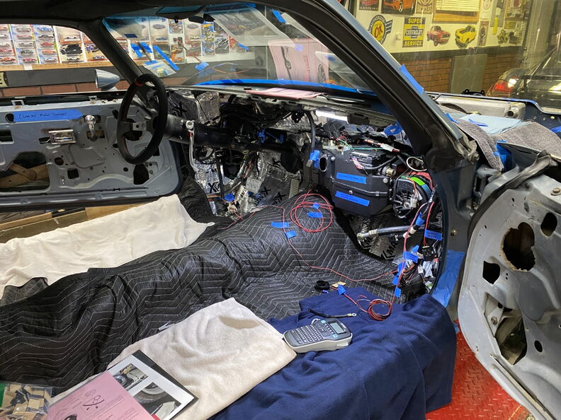

Still wiring things (04-25-21)
Back to the inside of the car I started working on the DSE Wiper wiring.
http://www.garagescene.net/_data/i/u...7ae772b-me.jpg
Instead of removing some of the original wire from the factory harness I heat shrink'd the ends and gave them a new home. You just never know when you might need extra wires.
http://www.garagescene.net/_data/i/u...5c769d8-me.jpg
http://www.garagescene.net/_data/i/u...cc39287-me.jpg

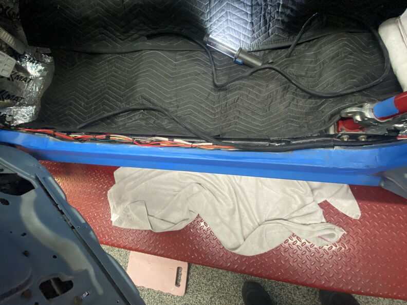

I finally feel like I won't be running anymore wires down the drivers side so I wrapped the wires in tech-flex wrap.
http://www.garagescene.net/_data/i/u...e44c2b3-me.jpg
http://www.garagescene.net/_data/i/u...da76a8d-me.jpg

I also started a Re-Do bucket just to see how much tape I take off and of various stuff.
http://www.garagescene.net/_data/i/u...a990a4c-me.jpg
syborg tt 10-04-2021 06:40 PM

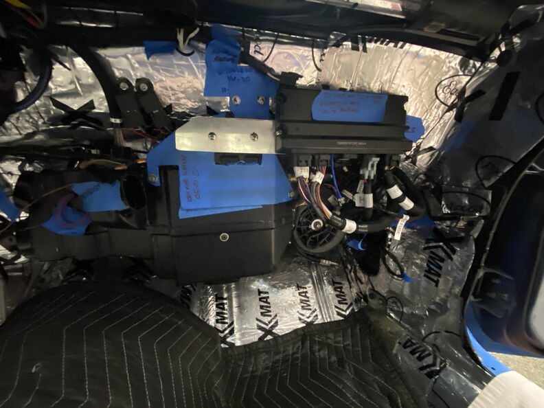

ECU mounting & Holley Dash (05-01-21)
Getting closer to final mock up of the ECU wiring

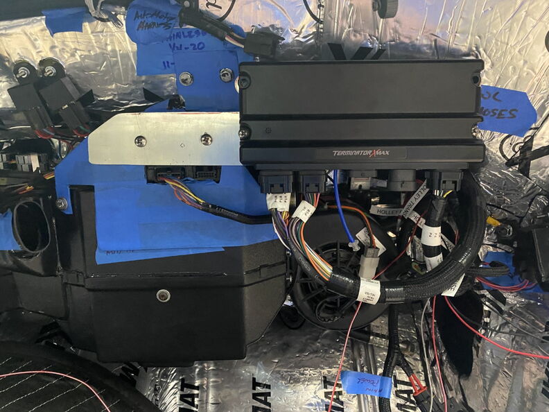

http://www.garagescene.net/_data/i/u...be6f297-me.jpg
I started searching for the bracket that hangs the vintage air unit and I can't seem to find it. I called my Powder Coater to see if he
remembers powder coating the bracket and he laughed as he powders so much stuff that there is now way he could remember.
http://www.garagescene.net/_data/i/u...a2ce7f3-me.jpg
After 90 minutes of searching I finally found the bracket as it was right where I put it last. (insert sarcasm here).
http://www.garagescene.net/_data/i/u...375cb8b-me.jpg
Installed it and mounted the ECU bracket which I made a long time ago.
http://www.garagescene.net/_data/i/u...4146269-me.jpg

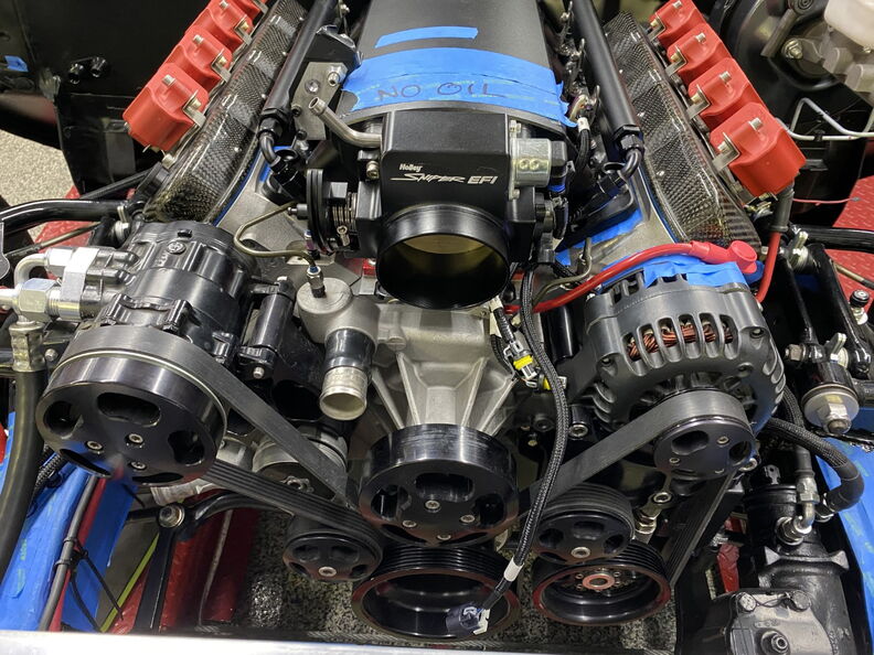

I mounted the ECU and started plugging everything in so I could start routing the wires for the digital dash.
http://www.garagescene.net/_data/i/u...31ba1a6-me.jpg

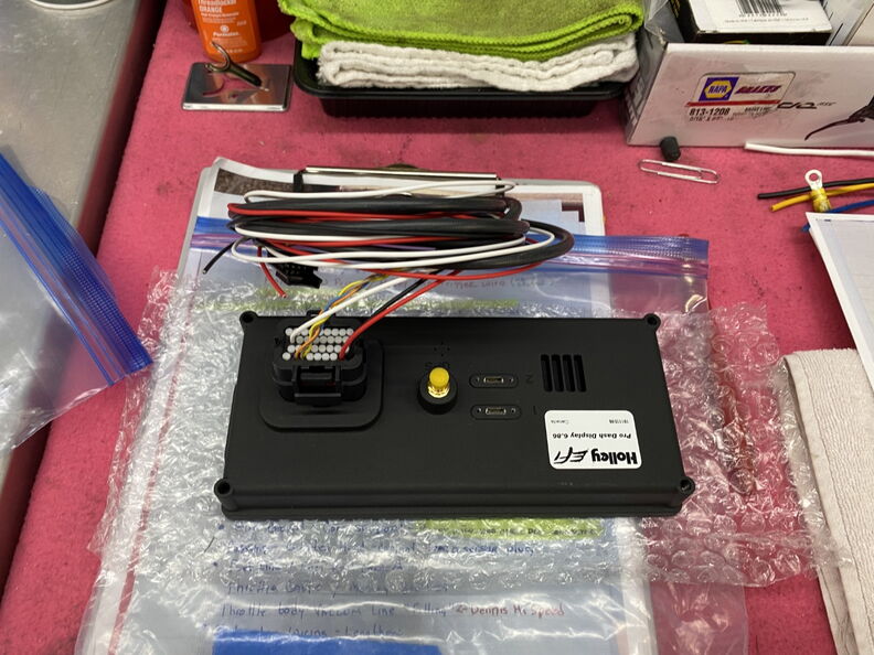

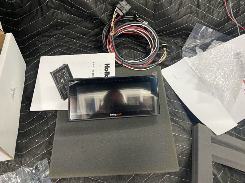

As much as I love the Autometer dash that was in the car I really really wanted the Holley digital dash. So I pulled trigger and bought the dash.
http://www.garagescene.net/_data/i/u...4f07f94-me.jpg

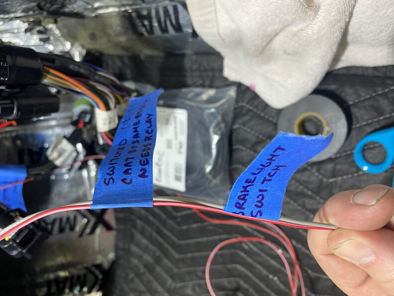

More notes.
Apparently the trans ''Trigger" can't be connected to the same trigger as the ECU.
http://www.garagescene.net/_data/i/u...73e4252-me.jpg
http://www.garagescene.net/_data/i/u...b0e7094-me.jpg

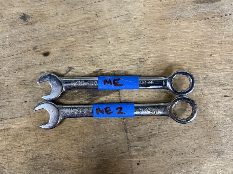

I also made a perm-a-note that the nuts on the small weld studs are 11/32 of an inch.
http://www.garagescene.net/_data/i/u...257de2b-me.jpg
Since I use these so much in the car I put tape on them so I can find them quickly in my toolbox.
http://www.garagescene.net/_data/i/u...3675e05-me.jpg

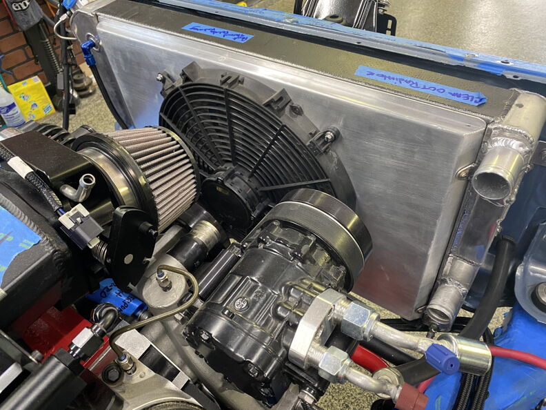

Mounted the Fan & Fan Shroud ( 05-02-21 )
My goal was to work on the fan relay and well at least installed the radiator, shroud and fan. At some point I need to bring the radiator and the shroud over to Mario to have him paint it.
http://www.garagescene.net/_data/i/u...dad5311-me.jpg

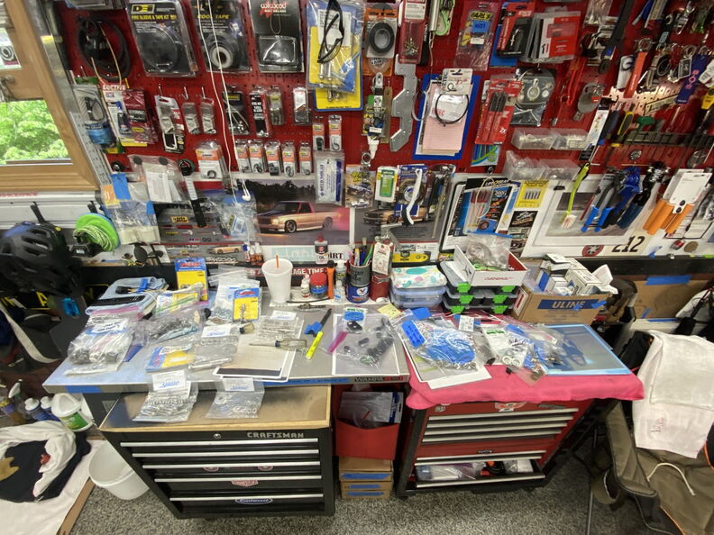

As some of you know I try to be organized and sometimes thing get out of control. So i stopped what I was doing and spent the next couple hours organizing everything.
http://www.garagescene.net/_data/i/u...22500bb-me.jpg

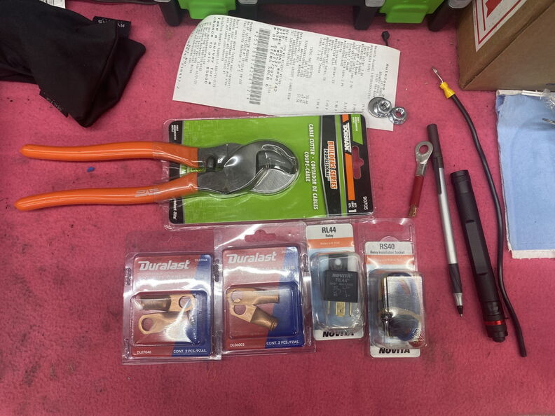

I saw these wire crimpers on-line and wow do they work great.
http://www.garagescene.net/_data/i/u...539ac84-me.jpg
http://www.garagescene.net/_data/i/u...8415a8e-me.jpg

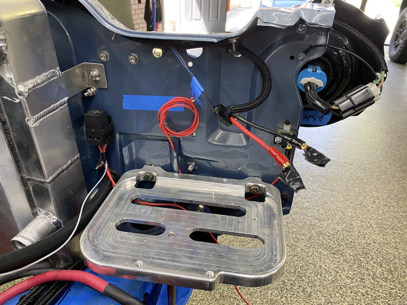

Fan Relay 05-15-21
I removed the old wiring for the fan and installed a painless relay set up. Eventually this will come out and I will install the PWM setup.
http://www.garagescene.net/_data/i/u...5f0e5b8-me.jpg
http://www.garagescene.net/_data/i/u...4a62d64-me.jpg
I need to figure out the location for the relay.
http://www.garagescene.net/_data/i/u...d91c3fe-me.jpg
This looks like the perfect location.
http://www.garagescene.net/_data/i/u...abe2efb-me.jpg
http://www.garagescene.net/_data/i/u...4cf72e4-me.jpg
The black screw is the ground stud.
http://www.garagescene.net/_data/i/u...2fab0ac-me.jpg
http://www.garagescene.net/_data/i/u...44602a6-me.jpg
Wiring is all hidden nicely behind the battery
http://www.garagescene.net/_data/i/u...171d55e-me.jpg
Remy Picture
http://www.garagescene.net/_data/i/u...065faad-me.jpg

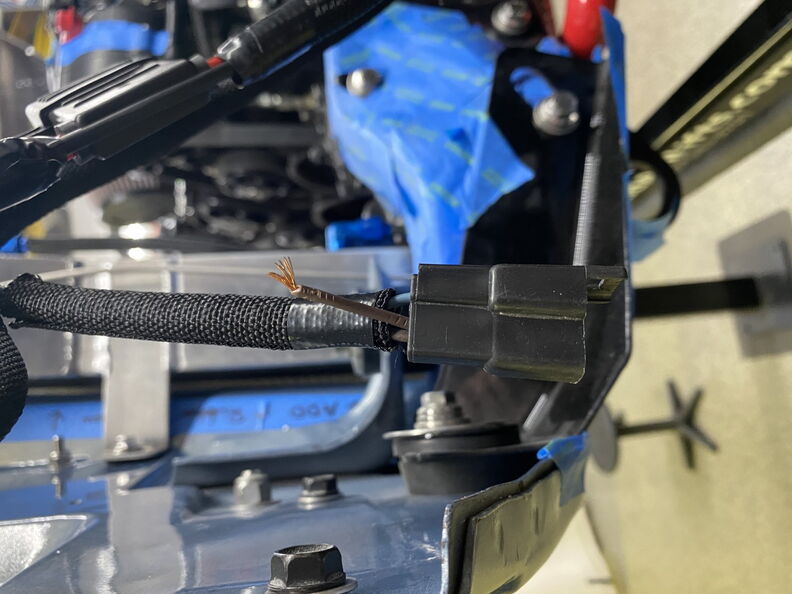

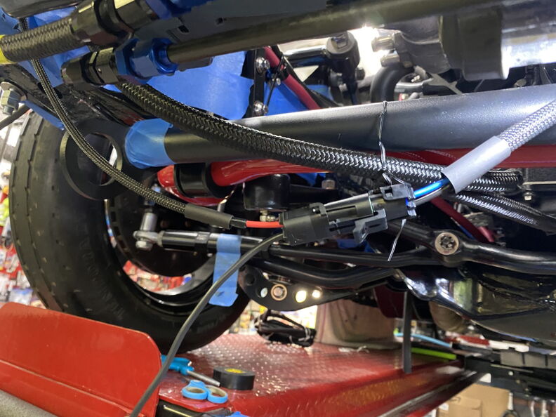

Routing the wires over to the fan where I will install a weather pack connector.

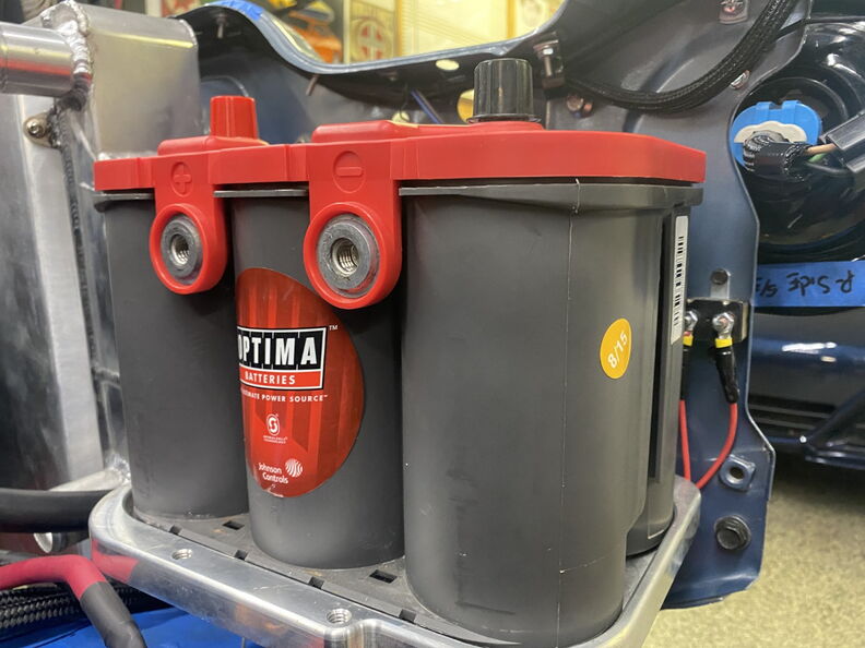

While I here I sketched out my wiring plan/diagram.
http://www.garagescene.net/_data/i/u...d0d2732-me.jpg

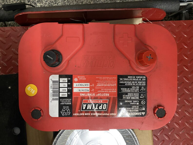

Of Course I will be using an Optima battery since the billet battery tray Ron & I designed for the 2nd Gen Camaro's.
http://www.garagescene.net/_data/i/u...f1ebfd5-me.jpg
more stuff !!!
http://www.garagescene.net/_data/i/u...82871a8-me.jpg

http://www.garagescene.net/_data/i/u...7dc4516-me.jpg
Jumping back on the brakes or should I say "Circling Back".

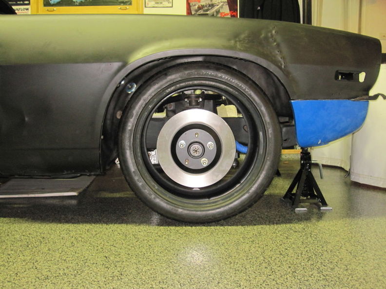

I needed to stop this bracket from twisting when I turn the wheel
http://www.garagescene.net/_data/i/u...6593733-me.jpg
Step One - Dill second hole in the bracket.
http://www.garagescene.net/_data/i/u...f2832a8-me.jpg
Step Two - Tap said hole.
http://www.garagescene.net/_data/i/u...49fc8e7-me.jpg
Step Three - Drill second hole in frame.
http://www.garagescene.net/_data/i/u...b4d6590-me.jpg
Step Four - Mount bracket using the ARP bolt and then thread in the smaller bolt so it acts like a stud in the bracket. That way if the small bolt
breaks all I have to do is replace it. I also don't have to worry about breaking a small tap in the frame as I have done that some many times in
the past that I no longer trust myself.
http://www.garagescene.net/_data/i/u...170e170-me.jpg
Step Five - Rinse and Repeat on the Drivers Side
http://www.garagescene.net/_data/i/u...af2fdb4-me.jpg
http://www.garagescene.net/_data/i/u...8f47f3b-me.jpg
Yahoo I get to use my Right Hand Drill
http://www.garagescene.net/_data/i/u...fdc2d60-me.jpg
http://www.garagescene.net/_data/i/u...b0752ad-me.jpg
http://www.garagescene.net/_data/i/u...b6e2bf4-me.jpg
http://www.garagescene.net/_data/i/u...f8e0750-me.jpg
http://www.garagescene.net/_data/i/u...f42e596-me.jpg

Upgrading the wire connectors to a weather-pack connector.
http://www.garagescene.net/_data/i/u...2436912-me.jpg
http://www.garagescene.net/_data/i/u...f3efe44-me.jpg
I started using a X-Acto hot knife to cut the Tech-Flex wire sleeve. It works good and if you accidently cut yourself it also singes
your skin so you don't have to worry about bleeding or needing a band-aid.
http://www.garagescene.net/_data/i/u...94641b0-me.jpg
http://www.garagescene.net/_data/i/u...9f3586d-me.jpg

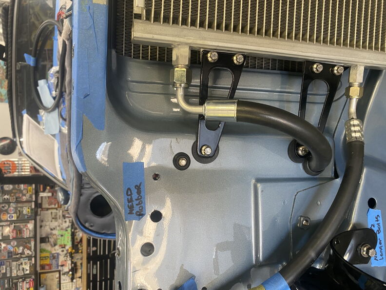

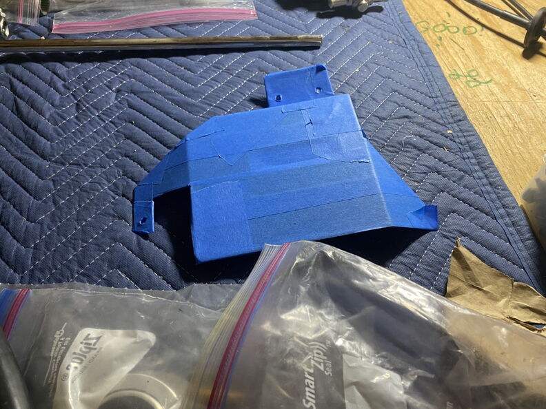

camcojb 10-07-2021 05:31 PM
2 Attachment(s)
That will definitely work. :thumbsup: I've fallen in love with nutserts (rivet nuts) in cases like that, easy to install and work great for mounting brackets/etc. to frames, firewalls, fenderwells, sheet metal...
syborg tt 10-08-2021 08:43 AM
That's a great idea and what really sucks is I have the tool.
Da !!!!
F'in mine 10-08-2021 09:00 AM
2 Attachment(s)
I've followed along at times and used some of your wiring techniques which has helped me, thanks for that. For my fan relays I decided to put them into a enclosure to protect from the elements just in case. One like this that fits both.
https://secure.sayal.com/STORE2/View_SHOP.php?SKU=14898
Then decided to grab this one of which I'll alter to fit down the road.
https://www.amazon.ca/gp/product/B07...0?ie=UTF8&th=1
Also fabbed up a panel into the front fender area so that I wouldn't clutter up the battery area with a bunch of wires. Also used 2 battery terminal blocks as extended power points. Rivnut tool came in handy here!
syborg tt 10-09-2021 05:27 AM
1 Attachment(s)
Hi Simon,
Thank you Thank you
Looking back I should have used the waterproof relay, which means I will most likely order the waterproof relay kit and redo this next week unless Amazon can get it to me tomorrow.
https://www.summitracing.com/parts/prf-30130
syborg tt 10-09-2021 06:37 AM
Holley EFI Wiring, does it ever end (05-30-21)
Yep, more wiring

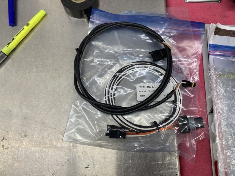

So way back on the 13th of May I wrote myself a note to look for this harness
http://www.garagescene.net/_data/i/u...36940eb-me.jpg
found it
http://www.garagescene.net/_data/i/u...298da7a-me.jpg
more notes
http://www.garagescene.net/_data/i/u...b001e91-me.jpg
http://www.garagescene.net/_data/i/u...38cb203-me.jpg
Holley Injector Harness ( 05-30-21)
http://www.garagescene.net/_data/i/u...cec802c-me.jpg
Okay so I was hungry and I went inside and made myself some oatmeal and well I never realized how nice it looked.
http://www.garagescene.net/_data/i/u...e8fd3bd-me.jpg
http://www.garagescene.net/_data/i/u...d621cd5-me.jpg
In order to plug in the harness I will once again need to remove the Vintage Air unit.
http://www.garagescene.net/_data/i/u...db20c07-me.jpg
http://www.garagescene.net/_data/i/u...d203e53-me.jpg
Found it
http://www.garagescene.net/_data/i/u...ef25a90-me.jpg
http://www.garagescene.net/_data/i/u...96271d4-me.jpg
He's getting bigger.
http://www.garagescene.net/_data/i/u...c148c22-me.jpg
syborg tt 10-09-2021 06:57 AM
Holley Dash Wiring, Yes there is more (05-30-21)
Moving on to the Holley Digital Dash
http://www.garagescene.net/_data/i/u...5971cc5-me.jpg
http://www.garagescene.net/_data/i/u...c0ce7c8-me.jpg
http://www.garagescene.net/_data/i/u...23b0756-me.jpg
Connected and routed the wires so the Vintage Air unit it once again will go back in.
http://www.garagescene.net/_data/i/u...fbe9cdd-me.jpg
