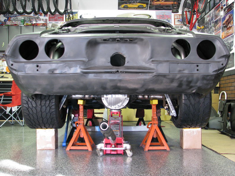

Evening all,
There has been a lot of progress on the car and I am playing catch up on the posts.
So here are the two tires side by side. 335 on the left and 295 on the right.
Since the goal it actually drive this car I am pretty sure I am going to be using the one on the right. However I will still make sure the bigger 335 fits under the car.
http://garagescene.net/_data/i/uploa...0fd5c9f-me.jpg
We did however find another use for this tire. Yep it makes kid smile !!!
http://garagescene.net/_data/i/uploa...6e3f732-me.jpg
Pictures hosted by www.garagescene.net

Either tire will look killer on there.
srh3trinity 09-25-2012 07:37 AM
I like the idea of having the option of running either. I am glad you put a picture up of a 295 because I was planning on staying around that size with my Firebird. It gives me some perspective.
