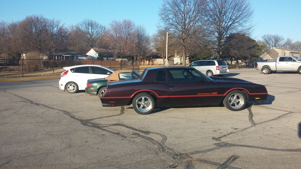

SSLance 03-02-2016 05:22 AM
http://img.photobucket.com/albums/v3...ps33rp1tfa.jpg
I've been driving Barney around quite a bit last few days, even drove it 40 minutes across KC to the SCCA meeting last night. I'm having a blast driving it, it's much the same...but oh so different at the same time. It looks the same, it sounds the same, and it drives the same, until you press on the loud pedal. Before it pulled real hard out of the hole, then kind of slacked off the rest of the way up the RPMs. Now it pulls hard out of the hole...and keeps on pulling just as hard all the way up.
I'm really happy with the new Mcleod Street Extreme clutch. It is smooth as silk upon engagement, no chatter whatsoever. I'm still taking it easy on it breaking it in right, but so far I like it.
I've been working on the AFRs, tune a bit, drive a bit, tune a bit, drive a bit and I've discovered that as it heat soaks, the vacuum gets erratic and the AFRs lean out...signs of a vacuum leak. I reused the old carb to manifold insulator so I have a new one on the way, hopefully that is it. If not I have a few other things to check. Once that is ironed out I'll nail down the carb tuning.
It is already much better than I had it last year after the carb swap. While at cruise, it used to stumble or shudder just a bit as it got fat if throttle was applied below 1800 RPM. I drove it home last night in 6th gear mostly around 1500-1600 RPM and it stayed around 15:1 AFR and smooth. Off idle is good as well. It is pretty hard for me to watch AFRs while on WOT for now, need a passenger to do this safely, but I know it feels pretty good with the butt dyno.
A header is leaking again, it gets worse as it gets hotter and is almost quiet on cold start up. I'm not worried about that now. I'm formulating a plan to fix it right but for now I'm working on everything else.
