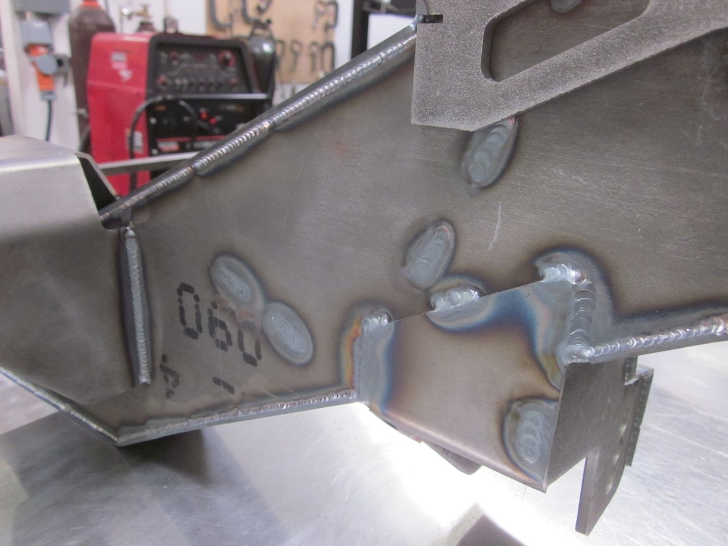

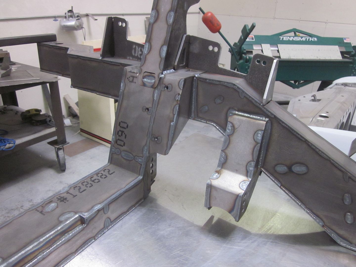

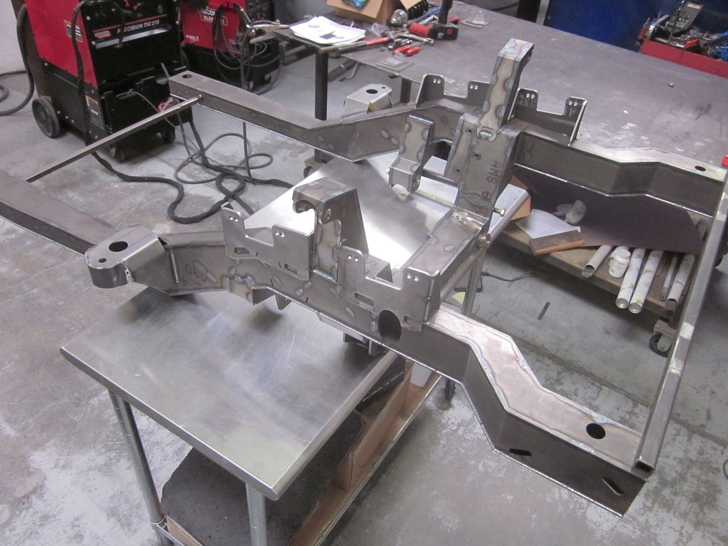

I have customer that has requested something different from us.. A chrome moly Camaro sub-frame.. The goal is weight reduction which we have accomplished not only by using the thinner lighter material but by optimizing the design with less components.. This chassis has the same suspension geometry as the Challenger which we have proofed the prototype with many road course & Auto-x events.. Plus the Challenger has over 3000 street miles on it.. The install will happen soon & will share it then..
