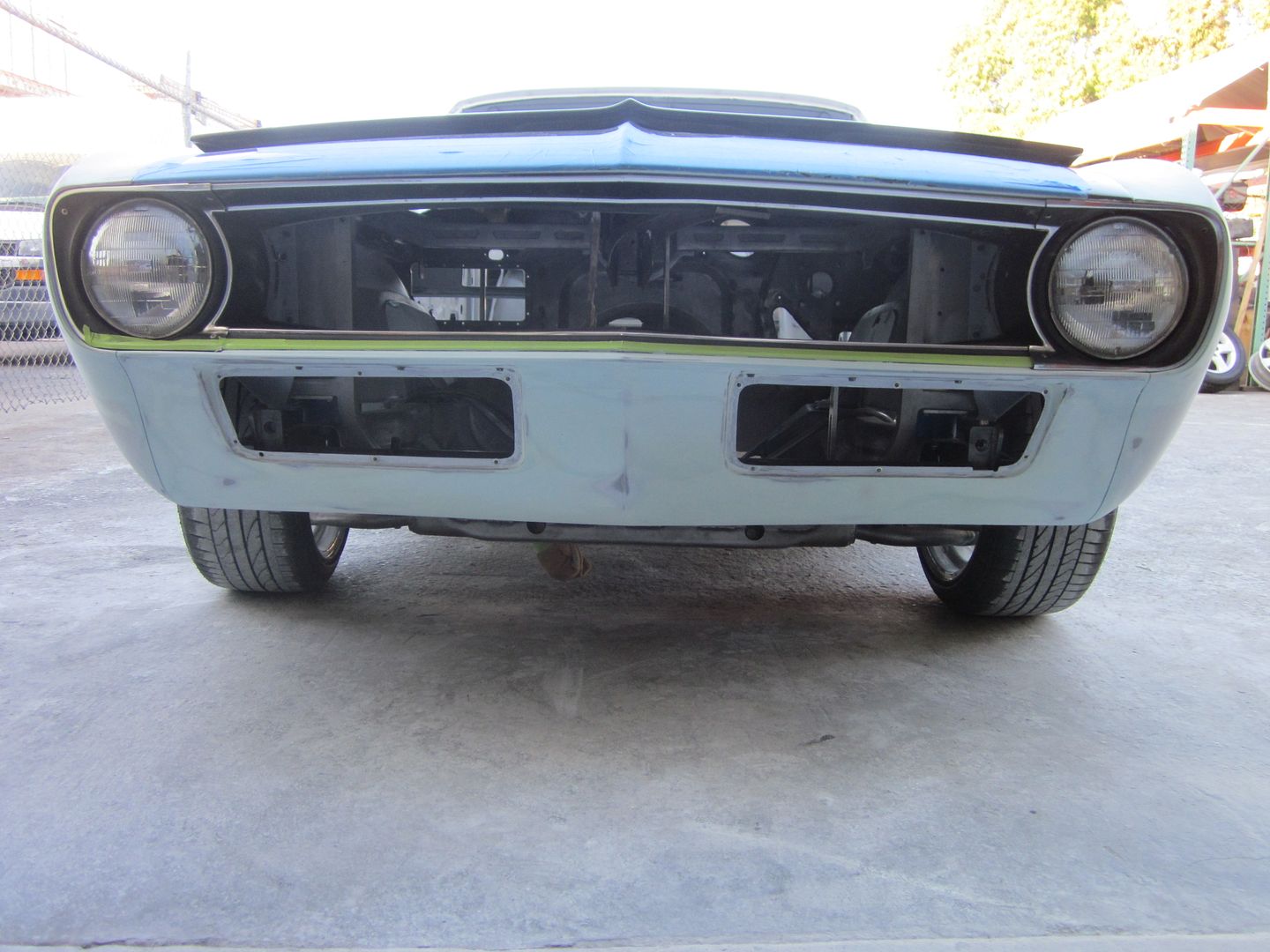

The owner has been asking me.. When the hell you gonna paint the damm car! It is a "Race Car"... It doesn't need to be perfect... My answer.. is the car will only be as perfect as I can get it only once in its life time.. After that you can thrash on it all you want.. I gotta thank the owner for letting me go above & beyond from what the project started as..
The car will be painted late next week.. My crew has been on 12 hr shifts & have agreed to come in & work this Labor Day weekend.. will be BBQ for them all weekend!!
http://i1015.photobucket.com/albums/...n/IMG_1480.jpg
It has been a pain in the ass to get the grill to fit the I want it cause of all the components not fitting that great.. then I remembered that it didn't even fit this nice from the factory.. We had to cut & splice the head light buckets for the headlights to fit centered on the trim.. I got the headlights from Headwinds.. Thanks Eric!
http://i1015.photobucket.com/albums/...n/IMG_1483.jpg
