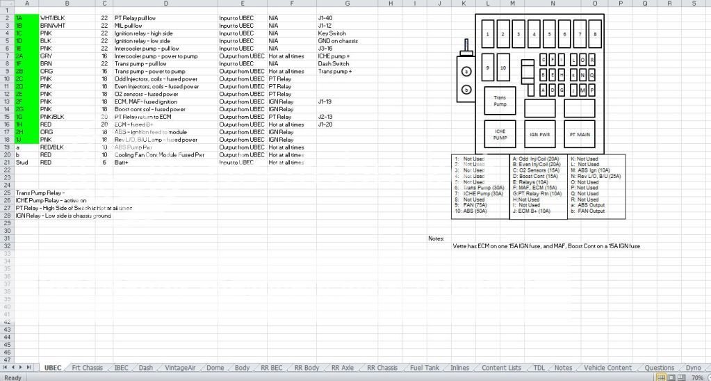

We are cranking away on it still. We are in the disillusionment stage or the program. Working real hard and it looks like nothing is happining. If you want to see more geek squad stuff check out Ryan Kuhlenbeck's Excel Spreed Sheet for the wiring. This is from the learings on 3 LS9 projects and other projects he has worked on. The biggest problem is he lives in San Fran http://i439.photobucket.com/albums/q..._silver_05.jpg That is one page of 10+ with every wire, connector called out. It actually saves time if you need to trouble shoot the car. It is great to work with a bunch of Engineers like Mikels, Kuhlenbeck, Rojewski, Gardner and Thomson :lateral: Mark |

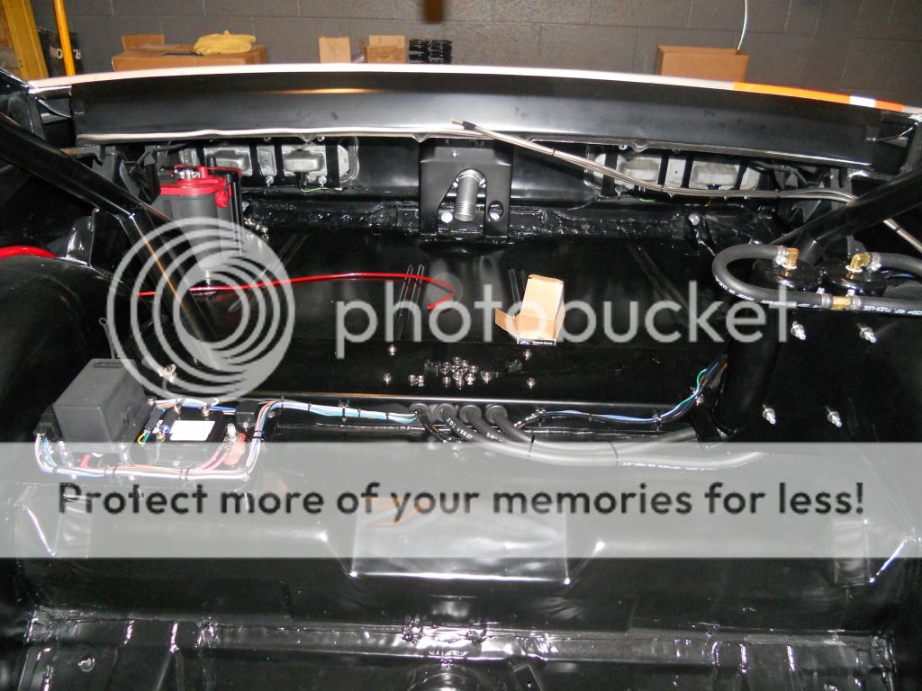

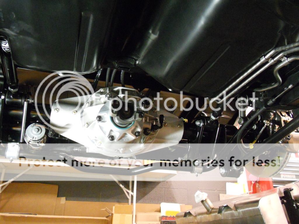

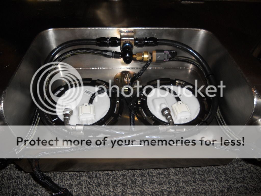

We have had the car back for 3 weeks and 2 days. Matt at Sled Alley is doing a great job getting the car ready to test. All of the engine bay is almost done. A few small things left to do http://i439.photobucket.com/albums/q...I/DSCN0001.jpg The fuel pump contoller from Vapor Works. Diff over flow tank and fuel tank over flow tank. http://i439.photobucket.com/albums/q...I/DSCN0014.jpg http://i439.photobucket.com/albums/q...I/DSCN0029.jpg http://i439.photobucket.com/albums/q...I/DSCN0021.jpg http://i439.photobucket.com/albums/q...I/DSCN0016.jpg http://i439.photobucket.com/albums/q...I/DSCN0006.jpg Twin ZL-1 fuel pumps in a Ricks tank http://i439.photobucket.com/albums/q...I/DSCN0015.jpg http://i439.photobucket.com/albums/q...I/DSCN0030.jpg |
