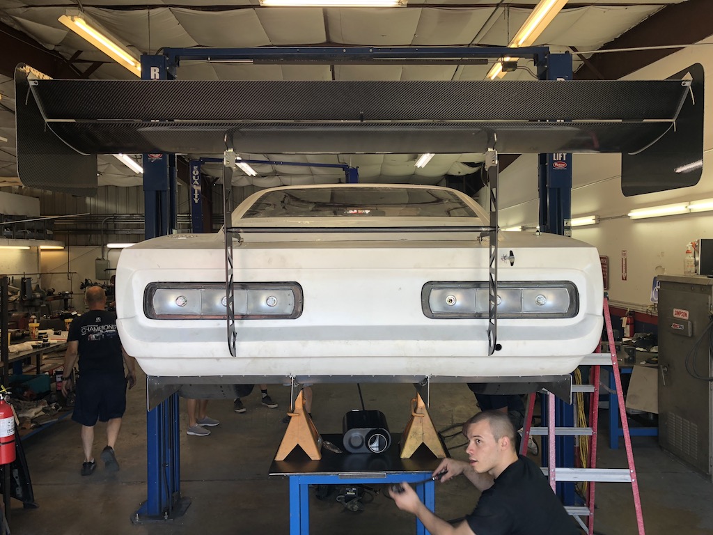

DBasher 07-18-2018 06:34 PM
Ron-I went back through and saw pictures of the exhaust being routed through the tunnel, curious where and how it’s exiting. If I recall you’ve installed a mostly flat bottom with naca ducts for the rear brakes...any pictures on a lift with the full pan and what nots in place?
:flag2:
GregWeld 07-19-2018 08:18 AM
1 Attachment(s)
:flag2:
We're not spilling our guts here...... LOL
Exhaust exits with dumps
Tunnel bottom closure/coverage is optional.... we'll be watching temps etc this coming NASA event now that it's coated with the 2000* stuff inside and out.
Remember the goal here --- was originally just for "me" -- so the fact that I might run 1 whole second slower average because of weight or aero not being IMSA LMP perfect..... yeah - big whoop.
Now --- having said that --- if a guy want to beat a track record -- or run with TrackMuscle..... then maybe all that has to be spot on.
See where Dylan is? See the muffler on the table --- that's going right above his head and then turndowns.... all of it beautifully TIG welded......
Attachment 66411
DBasher 07-19-2018 09:18 AM
Ahhh, I see...kinda. If I’m seeing and understanding correctly, exhaust runs through the tunnel, which can be closed off, past the rear axle (over or under) and dumps into the diffuser? If so, BRILLIANT!
Ron Sutton 07-19-2018 09:38 AM
Haha. Not brilliant. Just common sense. But yes, the exhaust dumps in front of the diffuser so it can be extracted with the under car airflow coming out the rear of the car through the diffuser.
