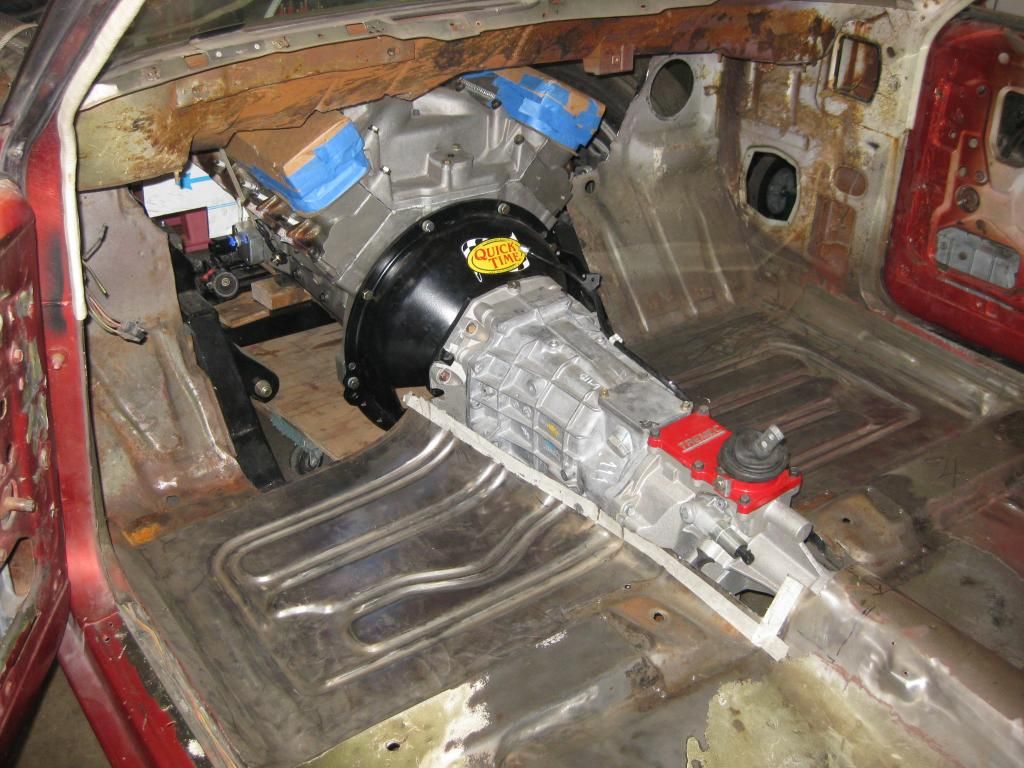

So I did get a chance to clean up my tunnel cutting and remove all the dash and wiring. Even with the motor set this far back you can see I have plenty of room for the new footwells. There is also a bunch of room up under the dash.
This will make building the cage way easier. More so for Brett than me since he will be doing al the welding on the cage.
It may not look a lot different than the previous photo but it is progress.

Bob We moved the motor back 7.5" from where RS had it. Since I wanted to fit myself in the car, as part of the exercise in determining where to place the motor, I just asked RS to mount the motor without cutting the firewall. CA to IL isn't a trip I have time or $$ to be making on a regular basis. My bellhousing nip also let me put the motor lower than they did. They did a really nice job with the parameters I left them with.
Good eye on the VCs. Right now they are too close to the cowl. But after looking it over from the inside yesterday I have a plan to gain enough clearance to remove the covers in the car and still have enough grade to drain any water that would make it into the cowl in a rain storm.
I have a 22 gal ATL Fuel cell. On E85 I should get a cruising range of about 75 mi :( Oh well it's all about compromise. :D
I'm sure I'll get even more range out of the duals.:lmao:

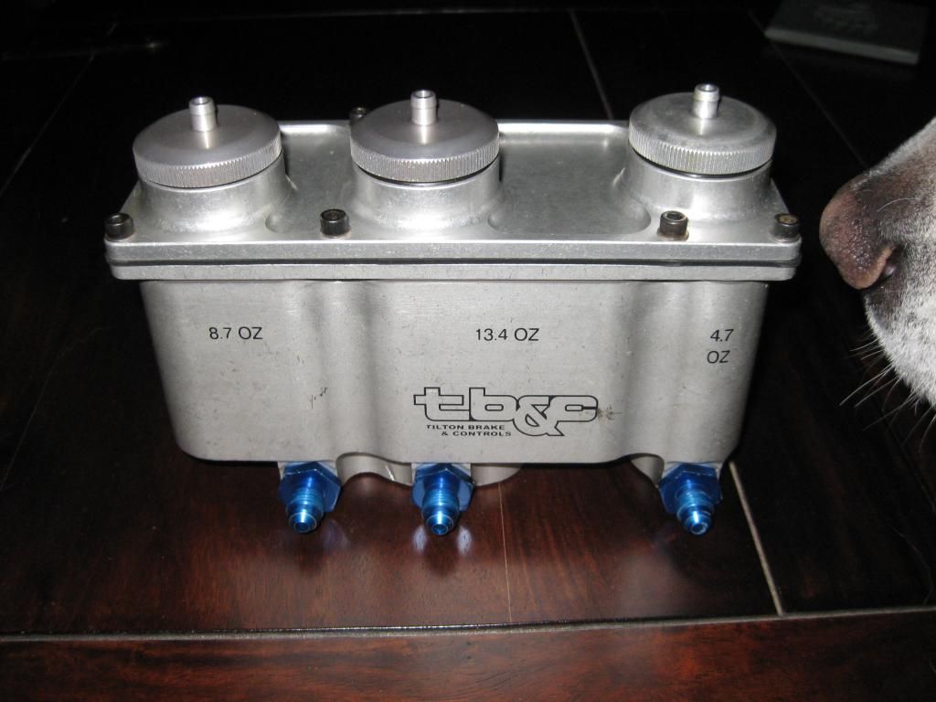

I got some more parts into inventory tonight. They all look good and passed the sniff test.
http://i291.photobucket.com/albums/l...ps0d9c2a0e.jpg

Hey Rob, good to see some progress pics. I pushed my motor back through the firewall also, but just 5 inches. I am still able to use the stock cowl panel but the firewall will be under the cowl panel a little ways. I did 67 nova with a big block pushed back a few inches and made the cowl a removable piece to access the dist.. Is that kinda what your planning or is the cowl going to become the rear of the hood?
Panteracer 12-12-2013 09:27 AM
1969 Torino
Except the dizzy is in the front on a Ford
so that access is good unless you have a
Pantera and the damn thing is on the wrong end:superhack:
But a Chebby motor is just not right in a Ford
but my buddy has a Cleveland in his Camero
dry lakes car doing 187 plus. now that is ok
Panteracer Norcal Bob
Sieg 12-12-2013 09:32 AM
Good chassis, good engine.......put the shell of your choice over it and drive it!
:D
intocarss 12-12-2013 04:13 PM
:D
SO when is the 5.4L DOHC MOD MOTOR going in your wreck :hello: :bigun2:
TAC 12-12-2013 10:17 PM
I'm a firm believer in ford car ford engine...Gm car Gm engine and Chrysler car Chrysler engine.....Every other car....Who cares.....
FETorino 12-12-2013 10:58 PM
I'm 7.5" back from where the motor was but that actually puts the back of the motor about 4-5" behind the old firewall so probably the same as where yours sits.
We will rebuild the bottom of the cowl panel to allow for clearance of the valve covers but no need for access through the cowl panel.
The firewall itself will have an access panel to get to the bellhousing bolts so I can get the out without removing the engine.
