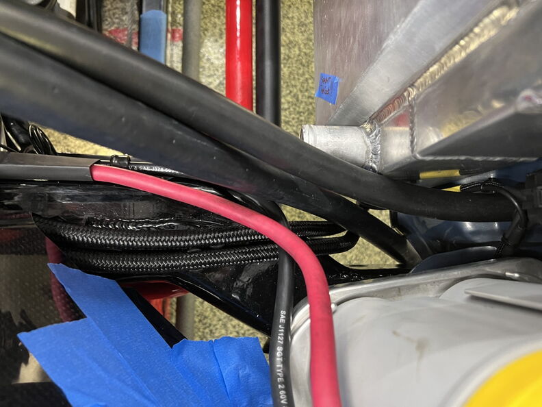

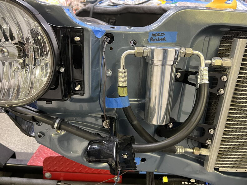

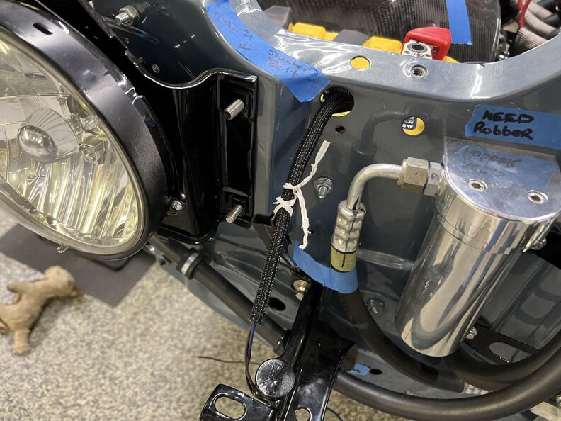

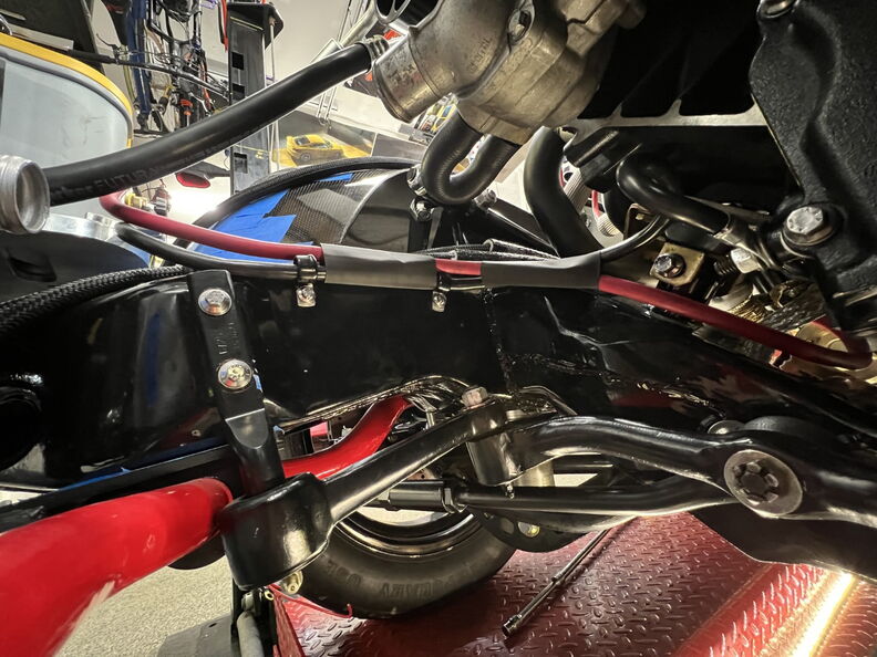

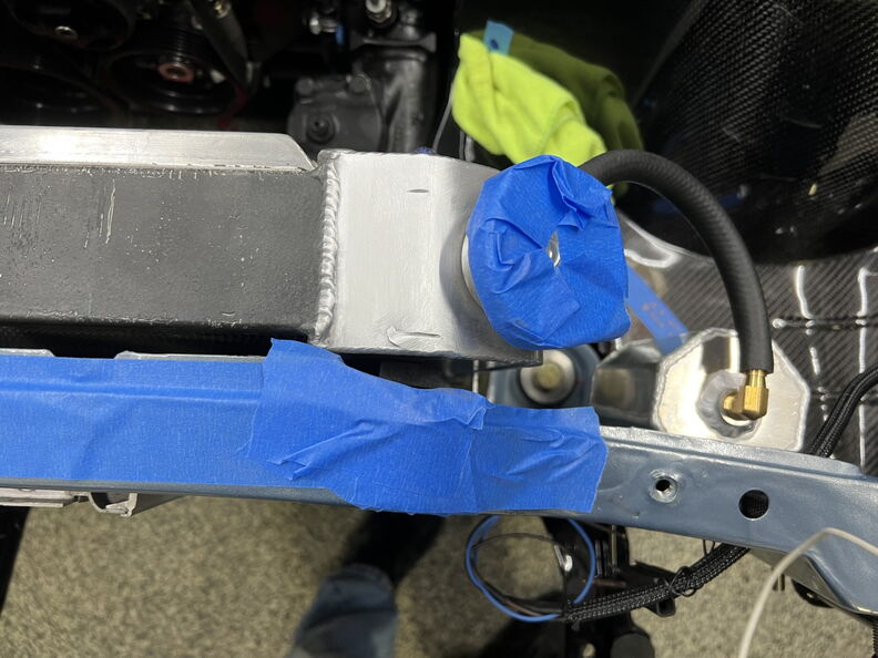

Vintage Air Hose Routing ( 03-06-22 )
It's getting closer day by day by day.
Today's project is to figure out how I plan to run the coolant and AC lines.
http://garagescene.net/_data/i/uploa...f58f9dd-me.jpg
http://garagescene.net/_data/i/uploa...6b59a13-me.jpg
Training this line so it lays better in the inner fender.
http://garagescene.net/_data/i/uploa...96920fb-me.jpg
Hiding the switch behind the battery.
http://garagescene.net/_data/i/uploa...eae6e76-me.jpg
http://garagescene.net/_data/i/uploa...c723b80-me.jpg
http://garagescene.net/_data/i/uploa...ac583f9-me.jpg
http://garagescene.net/_data/i/uploa...6924a60-me.jpg
Plenty of clearance
http://garagescene.net/_data/i/uploa...fd6a680-me.jpg

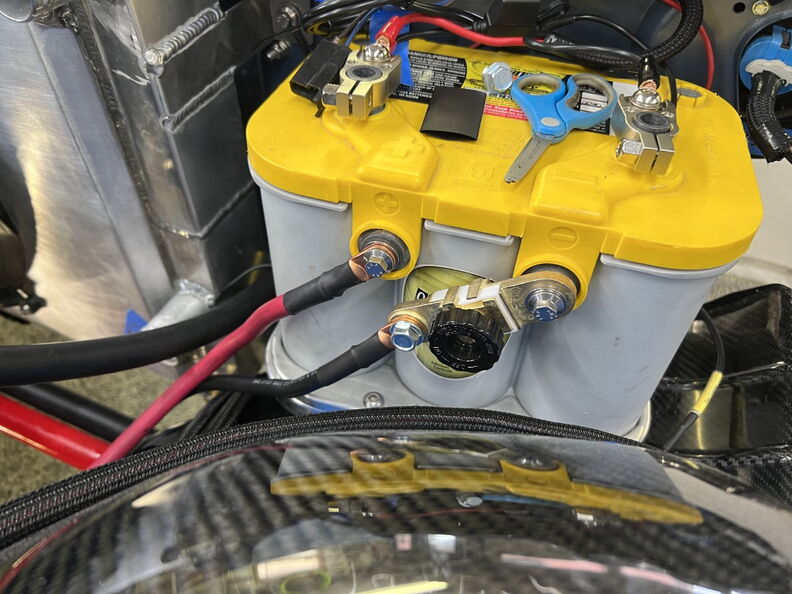

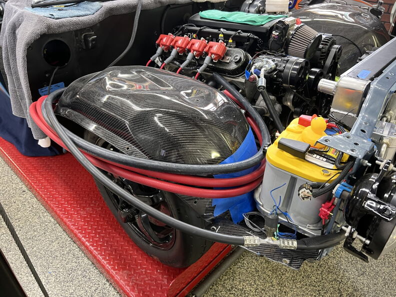

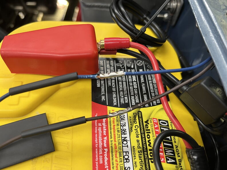

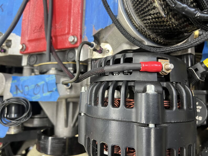

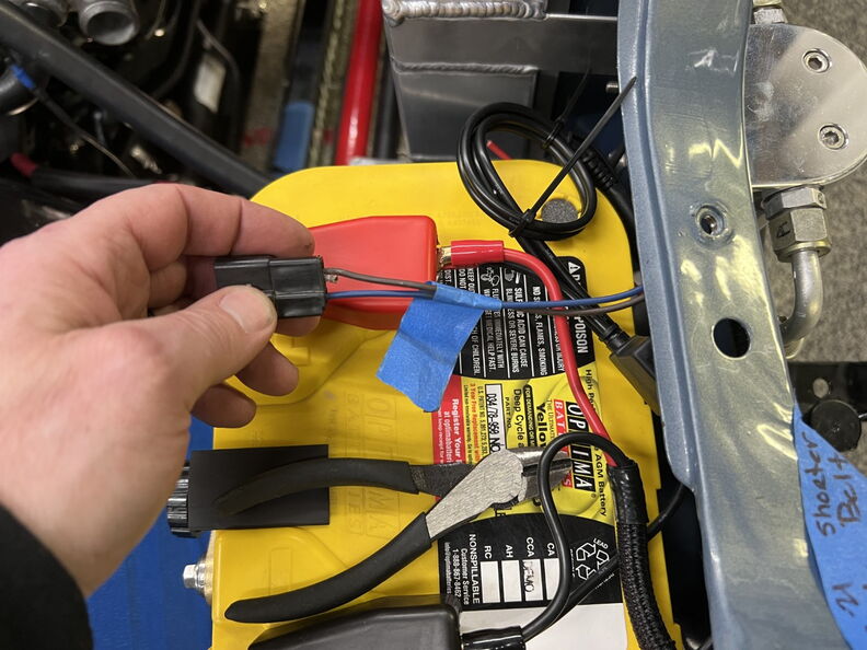

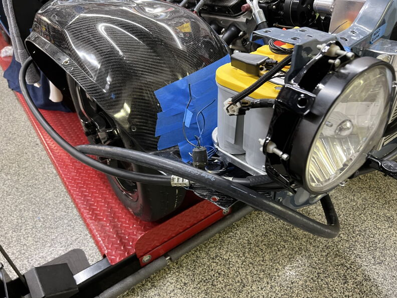

Battery Wiring Clean Up ( 03-06-22 )
Seriously I am getting really good at taking this car apart. Once again I am taking the positive off the mock up battery.
http://garagescene.net/_data/i/uploa...1f39258-me.jpg
I slipped over some heat shrink that I will eventually heat up once every thing is complete in this area. If all works out like I plan it may look really cool or it will be a total disaster.
http://garagescene.net/_data/i/uploa...7629750-me.jpg
http://garagescene.net/_data/i/uploa...7081817-me.jpg
I need to lengthen the indicator wiring as I am routing them so they can't be seen through the grill. The good news I have extra wire so this will be a simple task.
http://garagescene.net/_data/i/uploa...5505db1-me.jpg
Animal crackers just because I was hungry and I found them in the cabinet.
http://garagescene.net/_data/i/uploa...f5f50d2-me.jpg
http://garagescene.net/_data/i/uploa...df8a5fa-me.jpg
http://garagescene.net/_data/i/uploa...6e94d9b-me.jpg
http://garagescene.net/_data/i/uploa...9b081c8-me.jpg
http://garagescene.net/_data/i/uploa...5721b91-me.jpg
http://garagescene.net/_data/i/uploa...79ff0ab-me.jpg

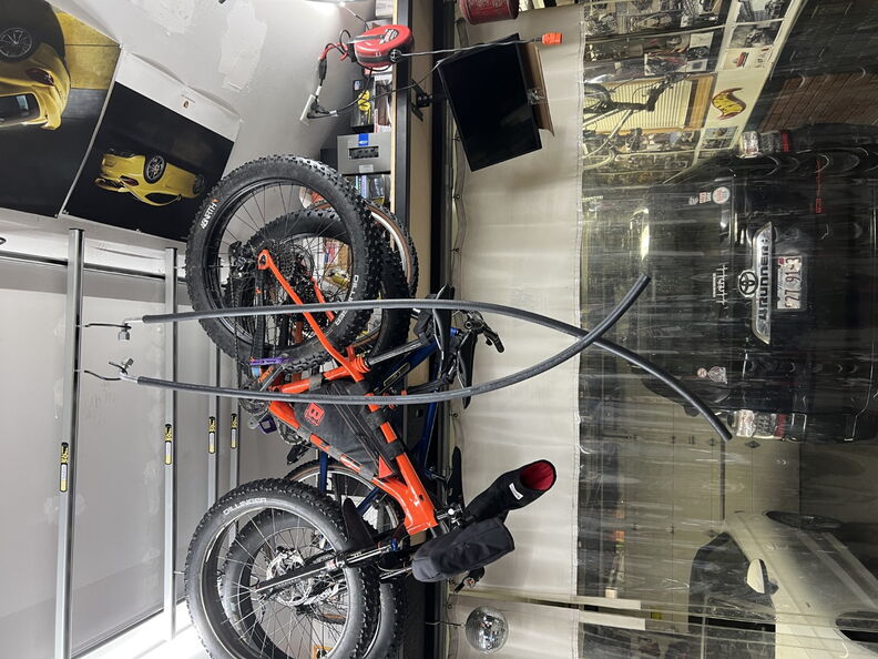

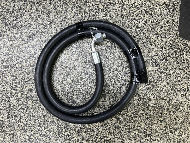

Cooking my Heater Hoses ( 03-07-22 )
Since they were wound up in a tight circle and I was tired of fighting them. I hung them and turned up my Forced Air Heater and warmed them up for a couple hours. The good news it worked and they un-curled quite nice.
http://garagescene.net/_data/i/uploa...c89fb90-me.jpg
Since I am not painting the radiator for this version of the car. I decided I was going to smooth out these scratches.
http://garagescene.net/_data/i/uploa...4ac7c70-me.jpg
couples minutes later. Success !
http://garagescene.net/_data/i/uploa...6c3e472-me.jpg

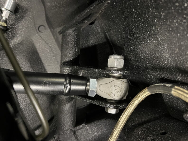

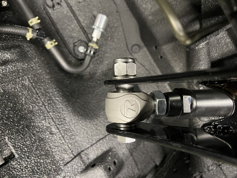

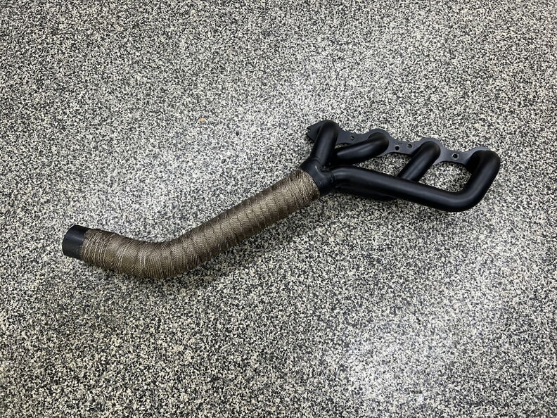

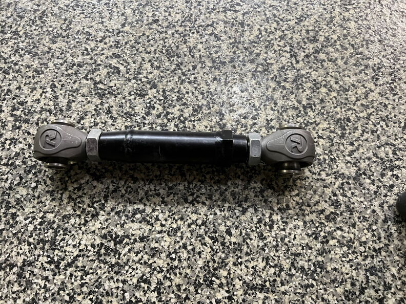

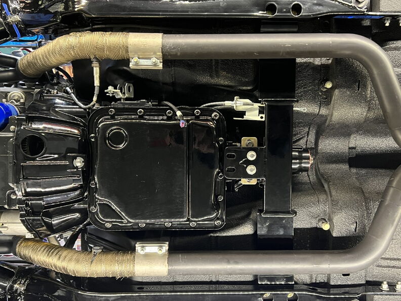

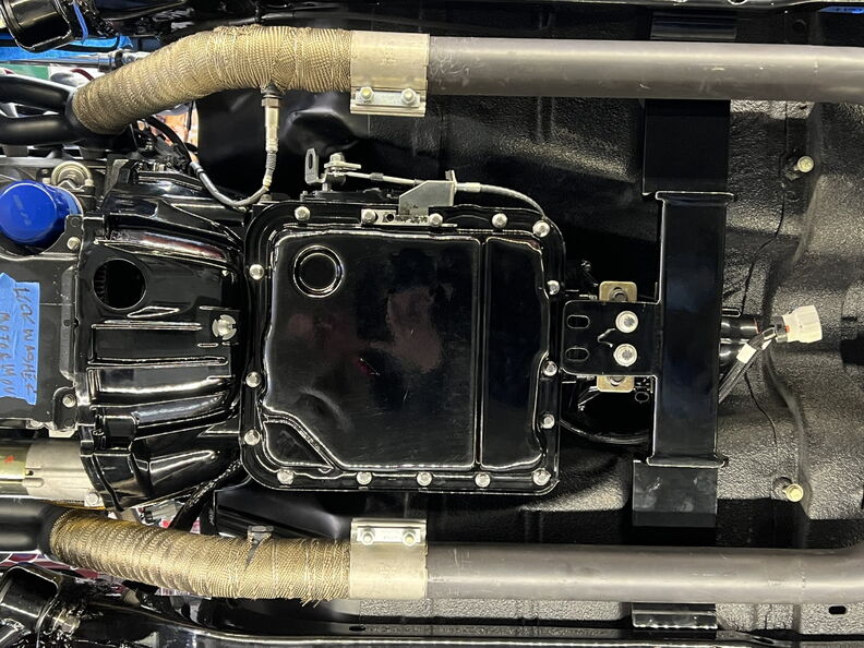

Final install of the custom Edelbrock Exhaust ( 03-13-22 )
Yet another while I am here task. Somehow and I don't know how the rod ends where not aligned so off they have to come to align them. I of course thought this was going to be an easy project. Well it was not and it was not even fun !!
http://garagescene.net/_data/i/uploa...6807d53-me.jpg
http://garagescene.net/_data/i/uploa...3b40384-me.jpg
http://garagescene.net/_data/i/uploa...7762ed5-me.jpg
http://garagescene.net/_data/i/uploa...a5cc6ac-me.jpg
http://garagescene.net/_data/i/uploa...95a5380-me.jpg
http://garagescene.net/_data/i/uploa...9020c6a-me.jpg
So remember if you are ever putting these in make sure the are parallel.
Hopefully this will be the last time I have to remove and install the exhaust.
http://garagescene.net/_data/i/uploa...4559162-me.jpg
http://garagescene.net/_data/i/uploa...6e21a1f-me.jpg

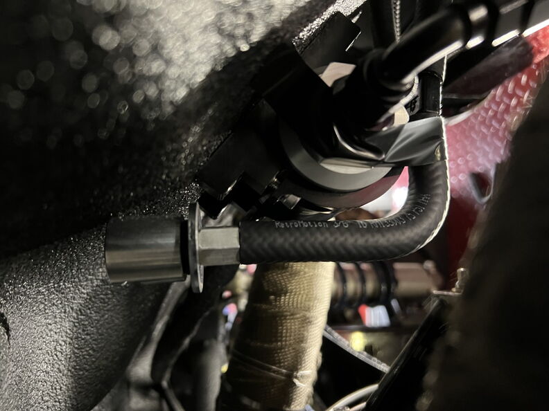

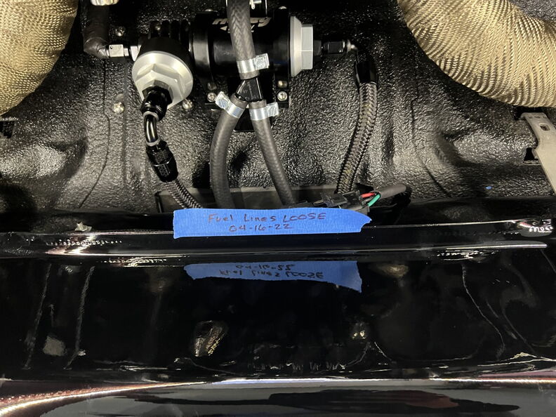

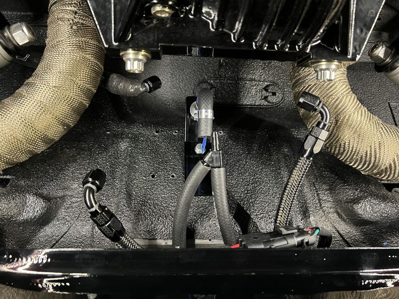

Redoing the Fuel Vent.
http://garagescene.net/_data/i/uploa...7ebc412-me.jpg
http://garagescene.net/_data/i/uploa...95f5e7f-me.jpg

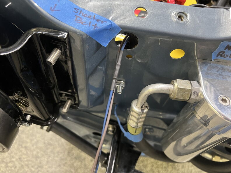

Anvil Inner Fenders ( 03-18-22 )
I need to install the Anvil Inner fenders to make sure the vintage air lines wouldn't be in the way of the battery cables.
http://garagescene.net/_data/i/uploa...fd6a930-me.jpg
http://garagescene.net/_data/i/uploa...f2a1f12-me.jpg
Yep, they are.
http://garagescene.net/_data/i/uploa...2f4e54e-me.jpg
I forgot who suggest this but I did ground the radiator
http://garagescene.net/_data/i/uploa...78211af-me.jpg
Working on the last Vintage Air line.
http://garagescene.net/_data/i/uploa...9edc638-me.jpg
This is me trying to get the some of the memory out of the line.
http://garagescene.net/_data/i/uploa...7a7873e-me.jpg
I hope this is the last fitting I buy.
http://garagescene.net/_data/i/uploa...5d33b57-me.jpg
http://garagescene.net/_data/i/uploa...2b809d9-me.jpg
I need to install a small strip of cork behind this as it bounces off the core support while I am driving.
http://garagescene.net/_data/i/uploa...bc5c02b-me.jpg
http://garagescene.net/_data/i/uploa...4c172f9-me.jpg
http://garagescene.net/_data/i/uploa...092d303-me.jpg
All better
http://garagescene.net/_data/i/uploa...4d75fd1-me.jpg

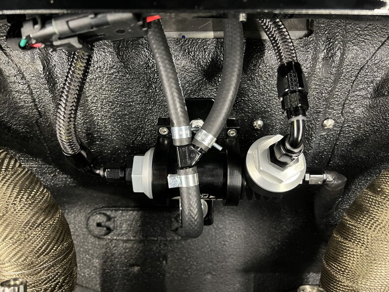

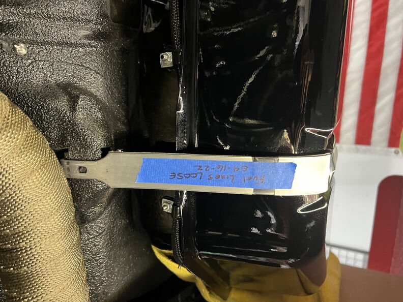

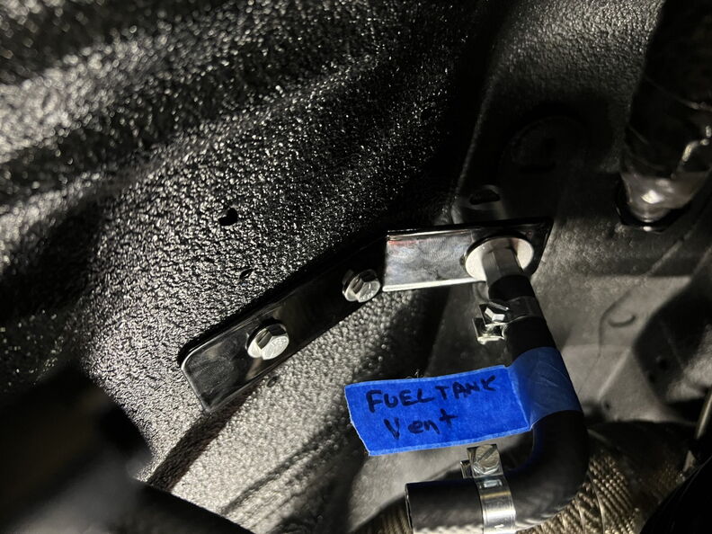

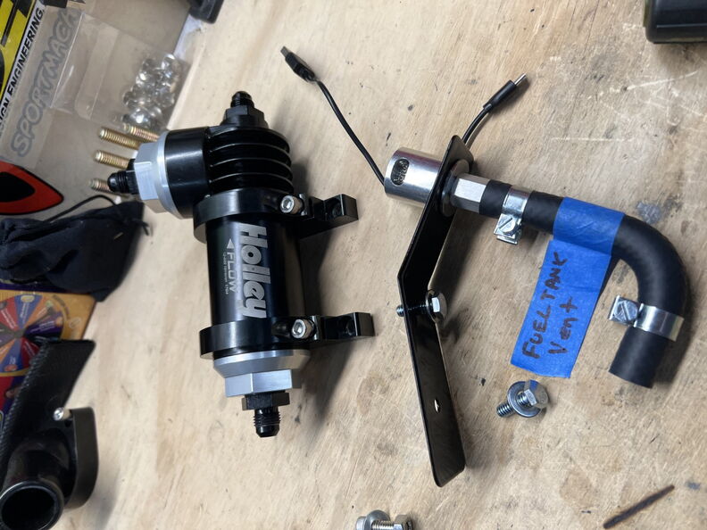

Fuel Vent Bracket (03-20-22)
The bend looks perfect
http://garagescene.net/_data/i/uploa...66266bc-me.jpg
I originally made the fuel vent bracket using some cheap thin steel.
http://garagescene.net/_data/i/uploa...0dca240-me.jpg
Test fitting to make sure it works.
http://garagescene.net/_data/i/uploa...7182326-me.jpg
http://garagescene.net/_data/i/uploa...a3b8119-me.jpg
http://garagescene.net/_data/i/uploa...d7e46a4-me.jpg
http://garagescene.net/_data/i/uploa...7bca14b-me.jpg
Time to make it out of thicker Steel
http://garagescene.net/_data/i/uploa...fa394f8-me.jpg
http://garagescene.net/_data/i/uploa...58d2ffe-me.jpg
Just a little bit more.
http://garagescene.net/_data/i/uploa...e8948d5-me.jpg
Comparing it to the mock up.
http://garagescene.net/_data/i/uploa...441f34a-me.jpg

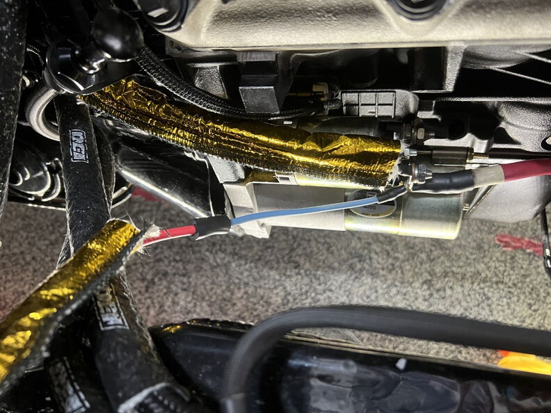

DEI Fuel Line Wrap (03-23-22)
Since I am content as to where I ran the fuel line it's time for me to install the DEI Fuel Line Wrap and tape off the ends with there really strechy tape. Yes, I know stretch isn't a word.
http://garagescene.net/_data/i/uploa...f3f57e4-me.jpg
You can barely see that the right side is taped.
http://garagescene.net/_data/i/uploa...54fa873-me.jpg
http://garagescene.net/_data/i/uploa...b89cd98-me.jpg
http://garagescene.net/_data/i/uploa...1cb804d-me.jpg

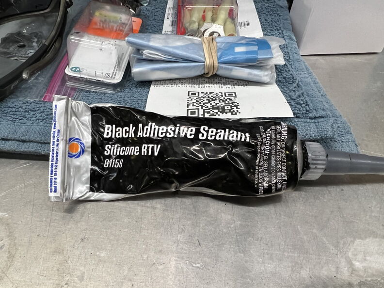

Ron Wilson was kind enough to send me this firewall plug so I can block off the E-brake cable hole.
http://garagescene.net/_data/i/uploa...68b8ff3-me.jpg
http://garagescene.net/_data/i/uploa...965428d-me.jpg
http://garagescene.net/_data/i/uploa...93cad0c-me.jpg
I filled the back with sealant which allowed me to install this by myself.
http://garagescene.net/_data/i/uploa...253173a-me.jpg
http://garagescene.net/_data/i/uploa...b401d14-me.jpg

Vintage Air Mag Daddy Magnets (04-02-22)
Moving on to the next project.
http://garagescene.net/_data/i/uploa...c2e9ad9-me.jpg
Because of my day job I learned about the Mag Daddy Magnets and how useful they can be.
http://garagescene.net/_data/i/uploa...fc367f3-me.jpg
You can barely see them in the picture but they are holding up the wires and you can still move them around till you figure out the final layout.
http://garagescene.net/_data/i/uploa...f642f48-me.jpg
http://garagescene.net/_data/i/uploa...61b4bd8-me.jpg
http://garagescene.net/_data/i/uploa...4cf78ab-me.jpg
http://garagescene.net/_data/i/uploa...c0be3cc-me.jpg
http://garagescene.net/_data/i/uploa...afb7aa5-me.jpg

Battery wiring (04-10-22)
Before I started working on the battery terminal wiring I need to run to the auto parts store.
http://garagescene.net/_data/i/uploa...6948da6-me.jpg
On my way home I stopped at McDonalds for a McFlurry.
http://garagescene.net/_data/i/uploa...4ff7e72-me.jpg
http://garagescene.net/_data/i/uploa...d2c367d-me.jpg
Since wires tend to have strong memory so I made sure the ring terminal was on in the correct orientation.
http://garagescene.net/_data/i/uploa...16514bd-me.jpg
http://garagescene.net/_data/i/uploa...0ffd665-me.jpg
I am still amazed at the amount of tools used on every project.
http://garagescene.net/_data/i/uploa...9d20c16-me.jpg

zz430droptop67rs 06-21-2022 02:20 PM
Awesome progress Marty, but as an old cyclist I'm wondering about all those forks!
https://www.lateral-g.net/forums/cac...8d06ea7-me.jpg
syborg tt 06-21-2022 02:27 PM
So each one of those forks came off of a Fat bike build that was either mine or someone else's bike I built during covid. However, there are
forks on that wall and another wall that date all the way back to the early 90's.
So basically they are garage art.

Final Install of the EFI Tank Vent ( 04-15-22 )
So everything from here forward should be final install which is awesome as I really want to start this car.
http://garagescene.net/_data/i/uploa...3a1865c-me.jpg
Jay at Pro-Tek Powder coating does such an incredible job powder coating yet I am still amazed at how nice stuff looks when it comes back from him.
http://garagescene.net/_data/i/uploa...d82236f-me.jpg
http://garagescene.net/_data/i/uploa...3b2542d-me.jpg
http://garagescene.net/_data/i/uploa...3461eb3-me.jpg
http://garagescene.net/_data/i/uploa...42aa3e6-me.jpg
Of course the I had to write myself another reminder note.
http://garagescene.net/_data/i/uploa...f7d42ee-me.jpg
http://garagescene.net/_data/i/uploa...164bbce-me.jpg
I did at a tiny bit of RTV on the bolts holes just to prevent and water seepage.
http://garagescene.net/_data/i/uploa...67be35a-me.jpg

AAW 500875 Hi Amp Alternator Charge Wire ( 04-16-22 )
Well this finally came in and now it's time to change the alternator charge wire.
http://garagescene.net/_data/i/uploa...7e624f6-me.jpg
Remy is out for the count and not much company today.
http://garagescene.net/_data/i/uploa...5ba3b37-me.jpg
http://garagescene.net/_data/i/uploa...166300c-me.jpg
Screw it I am hungry and it's been a long day so I am off to get some taco's.
http://garagescene.net/_data/i/uploa...beb1fd0-me.jpg

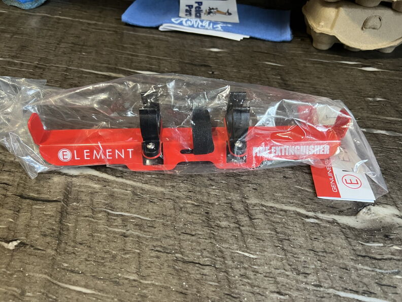

I also picked up the Element Fire Extinguisher.
http://garagescene.net/_data/i/uploa...c2006a7-me.jpg

ARP Trans Pan Hardware ( 05-05-22 )
I was in need of a couple simple projects as work has been really busy lately.
http://garagescene.net/_data/i/uploa...deb63af-me.jpg
http://garagescene.net/_data/i/uploa...08e7ffc-me.jpg
http://garagescene.net/_data/i/uploa...0b3a225-me.jpg
I also tracked down a roll cage bracket for the Element Fire Extinguisher.
http://garagescene.net/_data/i/uploa...836daa7-me.jpg
http://garagescene.net/_data/i/uploa...c12d0d8-me.jpg
syborg tt 06-21-2022 06:41 PM

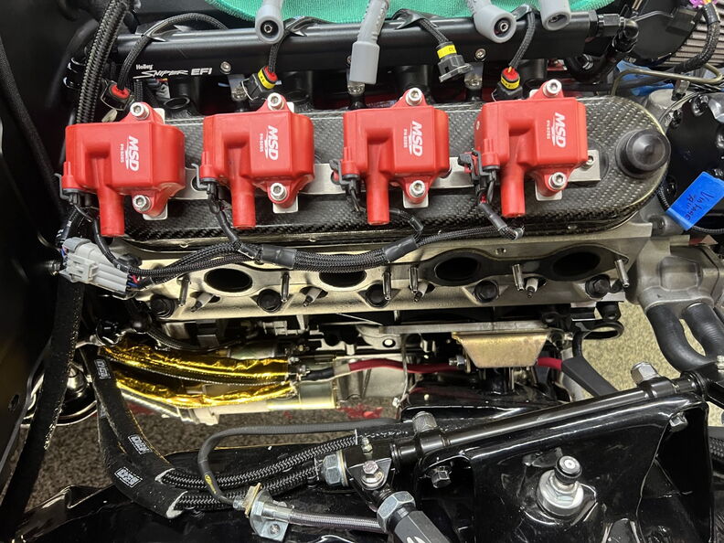

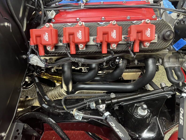

AAW 500875 Hi Amp Alternator Charge Wire Install ( 05-07-22 )
http://garagescene.net/_data/i/uploa...0779bfa-me.jpg
Out comes the passenger side header
http://garagescene.net/_data/i/uploa...2ffc332-me.jpg
http://garagescene.net/_data/i/uploa...b0022f0-me.jpg
http://garagescene.net/_data/i/uploa...6bd605f-me.jpg
Out with the old.
http://garagescene.net/_data/i/uploa...d3081cf-me.jpg
http://garagescene.net/_data/i/uploa...c76b172-me.jpg
http://garagescene.net/_data/i/uploa...97884bb-me.jpg
http://garagescene.net/_data/i/uploa...8142849-me.jpg
http://garagescene.net/_data/i/uploa...0d1a685-me.jpg
http://garagescene.net/_data/i/uploa...eac90bb-me.jpg

Final Install of the Vintage Air Valve Relocation ( 05-08-22 )
Next up is the installation of the Vintage Air unit and relocating the valve to the inner fender so it will be easier to service if needed.
So up to the garage attic I go and it's starting to empty.
http://garagescene.net/_data/i/uploa...a00e5db-me.jpg
This is the valve I will be relocating.
http://garagescene.net/_data/i/uploa...7a37799-me.jpg
Since the valve was located in the interior I need to extend the wires out to the inner fender.
I need to enlarge the middle hole to 1/2" so somehow I was able to make a close to perfect circle with a dremel tool.
http://garagescene.net/_data/i/uploa...2170fce-me.jpg
My buddy Jimmy stopped by to check on the progress and show me the new exhaust he built.
http://garagescene.net/_data/i/uploa...f5d9d1f-me.jpg
Mocking things up.
http://garagescene.net/_data/i/uploa...22efa76-me.jpg
http://garagescene.net/_data/i/uploa...7b0c101-me.jpg
Making things pretty.
http://garagescene.net/_data/i/uploa...1fd0437-me.jpg
http://garagescene.net/_data/i/uploa...f4e06a6-me.jpg
