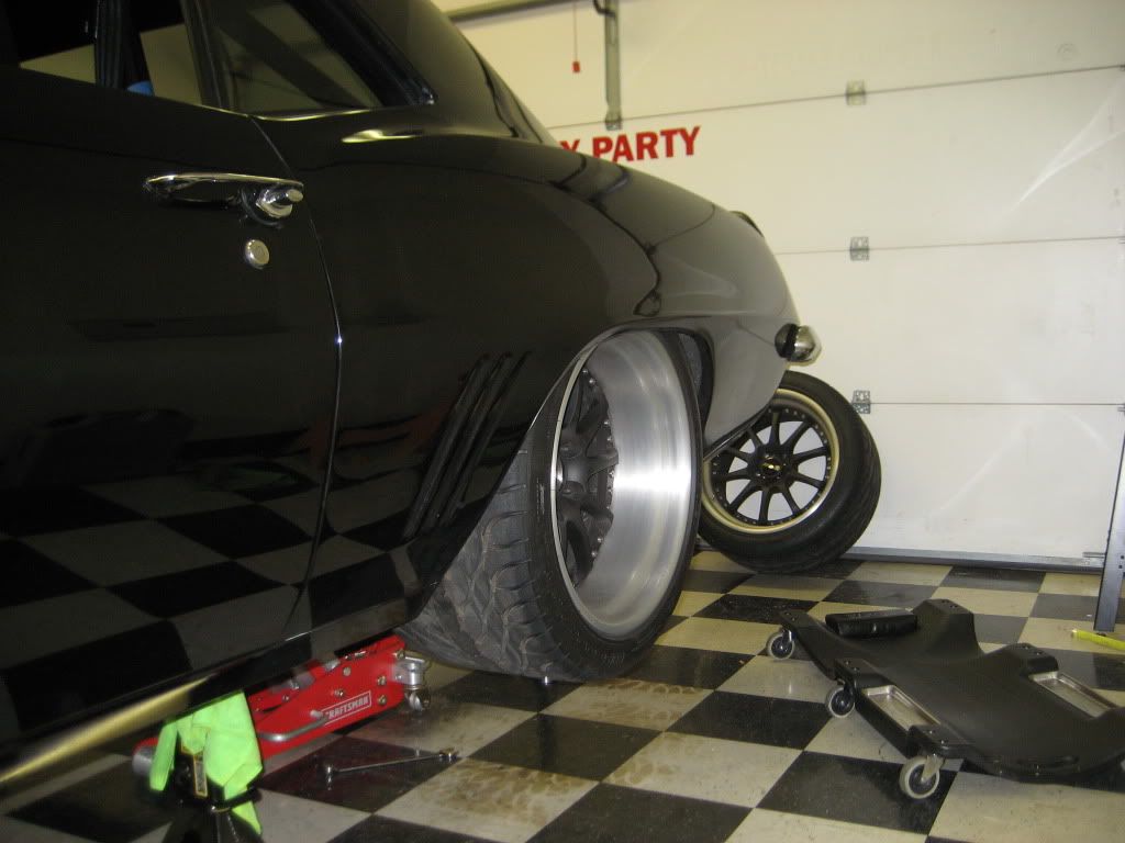

Look at that weight transfer.....
It would be great if this was drag racing and I had the travel available. Since the Optima Challenge, I know the driver and car need help to get where I want to be. My first obstacle is that I've found that my rear shocks are bottoming out big time. I don't know if removing the rear sway bar made it that much worse or I've just been to dense to notice. :D I did know the RR was but the LR always had a little left until recently.
I decided to start from scratch and design a new bracket to increase my shock travel by 5/8". Any more and I will run into rear differential cover to crooss member contact or tunnel to pinion housing contact. The brackets are being cut now. Number two is the spring rate is clearly to soft. So I started from scratch and did a base spring rate calculation. To do that, you loosen the spring adjuster collar until the spring is at full length with just a hint of tension. You take that measurment and then drop the car on the ground to see how far the spring is compressed.

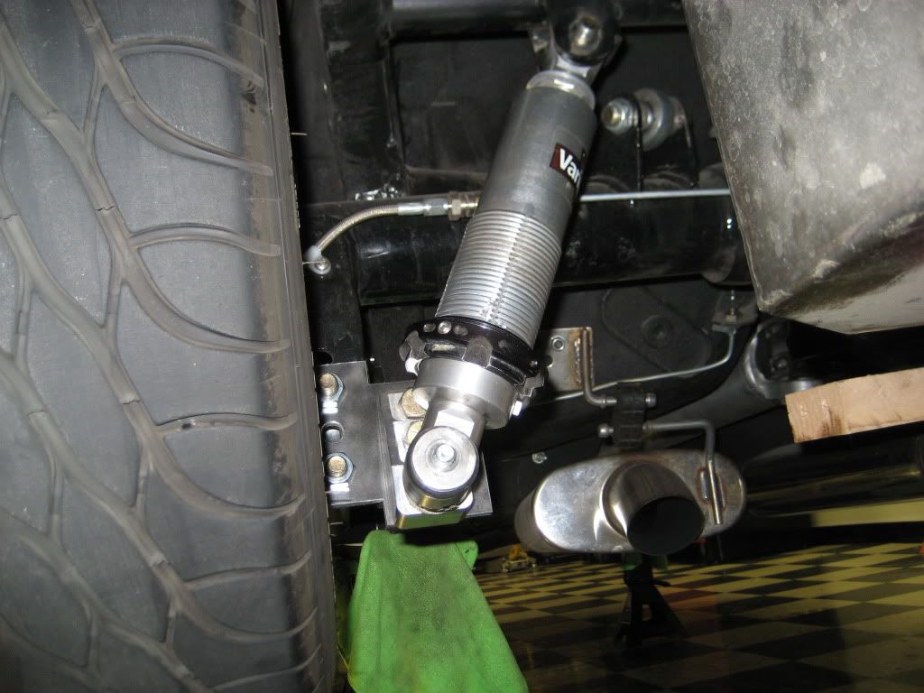

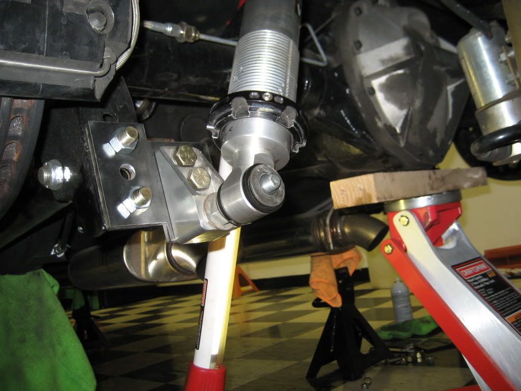

Does it ever end?:D Tonight I pulled my front and rear coil overs in anticipation of the new hypercoils coming pony express.

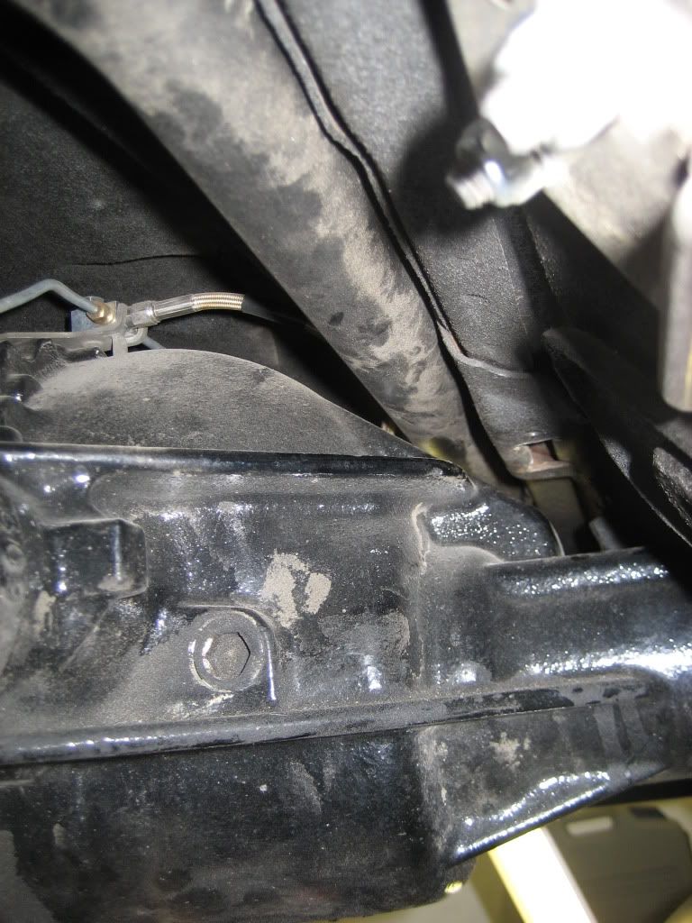

I designed some new shock mounting plates to give me an additional 1/2" of rear shock travel at ride height. After removing the springs I bolted on the new shock plates and simulated max shock travel. My measurements are right on the money. The chassis and body won't accept any more shock travel. The pinion housing is about a pinkie away from the crossmember and the rear pumpkin cover is fairly close. The aluminun shock mount was originally designed to be bolted to the rear end housing without a bracket. I had to move it due to wheel to shock contact due to wheel flex under load way back.
I now realize that the original design with my pinioin angle at the time would've caused rear end to cross member contact. I used to run equal and opposite U joint angles. Now I run the car with the smallest u joint angles possible. That changed the shock angle and now they aren't in an alignment with the bracket that suits me. I'm going to change to a ball bearing mounting to eliminate any bind while it's apart.

The front springs show sings of coil bind. As you can see, the collars are farther up the housing than I realized. I think it's a combination of a soft front spring and a way to soft rear spring. The moral of the story is the rear shocks were bottoming out and the front springs were coil binding. :D :rolleyes: I may as well have been racing a hay wagon. :rofl:
is this with both wheels compressed the same? if so, you may want to leave a little more travel so that you can have a little more bump travel in turns.
ex. your pinion could touch when both wheels are fully compressed, but you can then move one wheel up and one down without moving the pinion location (same as a turn). if you set the max when the center of your housing touches the crossmember or trunk floor and your axle tubes, tires, brackets etc. dont, youre giving up a little bump travel.
you probably already took this into consideration though.

That's an interesting point and I didn't think of it. I did measure it with both shocks bottomed. If there is one thing I've learned building this car, it's to leave yourself more room than you think! I really hope the extra .5" of travel and the new spring rate keep it from bottoming out under accel!

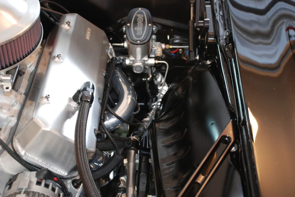

I really like how you did your breather set up and I would like to do some thing like this to my Dad's car. What type of hose did you use and what size? Is it -12?

John, I used -12 and the low profile fitting on the valve cover is an Earls piece. The hose and 45 is a jegs brand. Don't mix brands in pressure applications. Make sure the valve cover fittings are shrouded and not at the front or back of the cover. I've seen to many guys make that mistake. Where is your oil under accel and braking? This set up has worked fantastic.

I also have a question about your valve cover/breather system. I also have fabricated valve covers with no holes in them, how do you fill the oil? And what brand breather.catch can are you using?

Mike, I just unscrew one of the AN fittings and I have a long funnel that fits in the opening perfectly. They are Moroso tanks.
