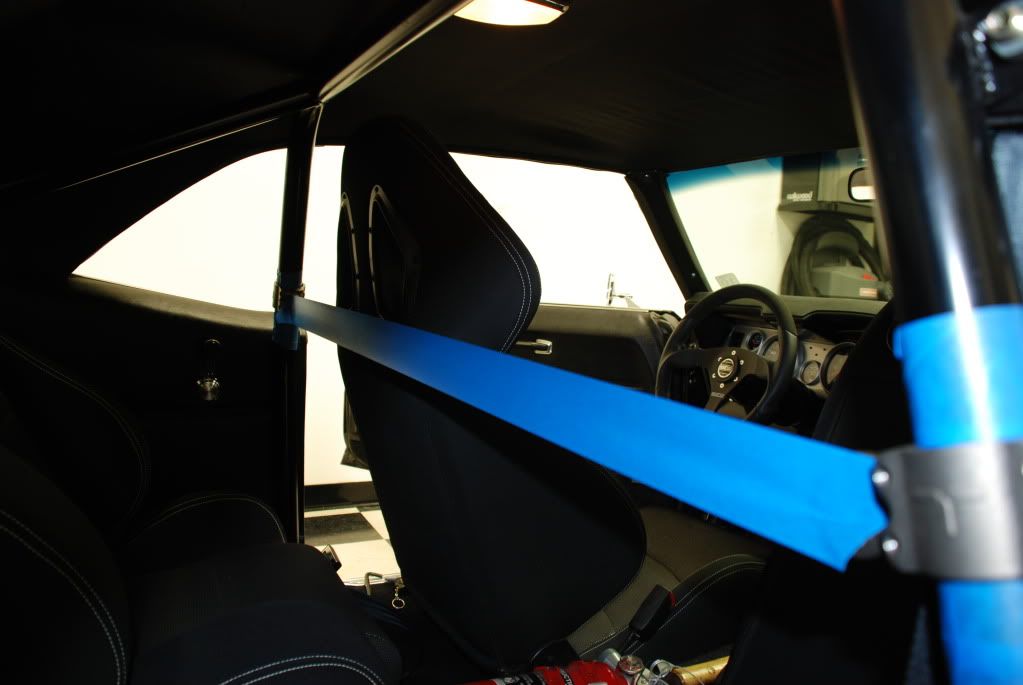

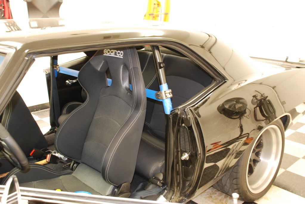

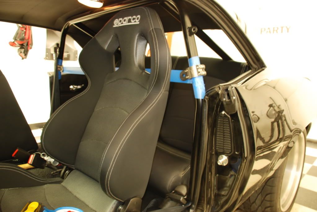

After the Optima Challenge and reviewing the video I realized how bad I needed a harness. My seats fit me well but I needed to reposition myself mide corner. There is enough to think about with 650 hp under the hood. I called up Ridetech and Rodney and I came up with a plan to get a harness bar in my car. We decided to have him send me the clamps and I could position them and take an eye to eye measurement. Rodney will then weld me up a harness bar and I'll likely paint the center section and leave the ends stainless. I haven't decided if I'll remove the 3 point belts at this point. Or simply use the same anchors and use the race belts only at events. Anyway, after doing some reading I've seen many different maximum belt angles and came across this article and it really makes sense.
http://www.circletrack.com/safety/ct...uidelines.html
The angle of the shoulder harness should be 90 degrees in comparison to your spine angle. I found what I feel is a comfortable driving position. I just need to verify it's approx. 90 degrees. Anybody disagree??
http://i200.photobucket.com/albums/a...nessBar009.jpg
http://i200.photobucket.com/albums/a...nessBar004.jpg
http://i200.photobucket.com/albums/a...nessBar003.jpg
68protouring454 01-12-2011 06:17 AM
around there, but generally from where it goes thru the seat to the cross bar should be no more then 20 degree angle, but you want at least 10 degrees down angle on the harness's.
Vegas69 01-12-2011 08:22 AM
I was expecting a told you so from you Jake. :unibrow: It should be right in the sweet spot where it's mounted now. What belts do you reccomend? Should I bolt them on or wrap?
Matt@BOS 01-12-2011 08:56 AM
I would bolt them in. I've also got pretty much the exact same setup that you have. Strangely enough, I ended up with a DSE cage with Tiger Cage cross bar mounts. It looks like you've got it all figured out, but if you need pictures, let me know.
Oh, and it's just my personal preference, but I would run a 3pt belt on the street. I always end up driving with only the lap belts for the 4pts connected because you can't move around if enough if you're just out cruising.
Matt
Vegas69 01-12-2011 09:07 AM
That is exactly why I put 3 points in the car originally. I'm definitely leaning towards bolting in the shoulder belts(For quick removal between events) and using the same anchor points for the lap belts and just laying them in the rear floor board. I would like to see a picture of your set up. Thanks Matt..:thumbsup:
skatinjay27 01-12-2011 11:18 AM
Matt
yep very true... i had a harness bar in my 4th gen for a year and a half and the majority of the time i would just wear the lap belt...(not to safe) you gotta strain your self just to reach the radio controls lol.
yeah todd I've always planed to do just that (run 3 points on a regular basis and just leave the laps on the ground when not in use) if i ever get the camaro running again! you better measure that right!!! haha
CarlC 01-12-2011 11:24 AM
I'm with Matt. I hate harnesses on the street. Having an inertia reel three-point shoulder belt is a lot more practical.
I leave the floor-pan bolted harnesses in the car when it's not on the track. The side belts tuck in well between the seat and the side of the floorpan, and the sub goes under the seat.

Vegas69 01-12-2011 09:00 PM
I've already got 3 points. I decided to go the route I did originally due to the fact I didn't like the belts hanging from the ceiling as well. I'm going to order a set of simpson belts and call it a day.
