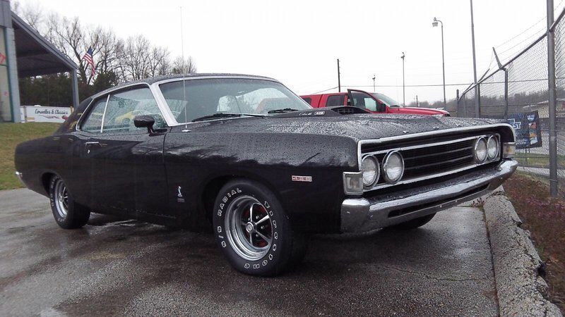

It was raining. It actually is in really good shape. 69 Cobra. 1198 built. 1 of 2 console cars. And the only one with AM radio with previous mentioned console. 428 cobra jet with 4 speed. The guy has documentation with certificate signed by director of Ford in 2013. I'm still pessimistic. But it may be the real thing. I'd leave it alone if I bought it. :D

That is pretty much the holy grail of stock 69 fairlanes right there. It has all th right trim pieces and black is a great color. All it needs is some poverty caps. :trophy-1302:

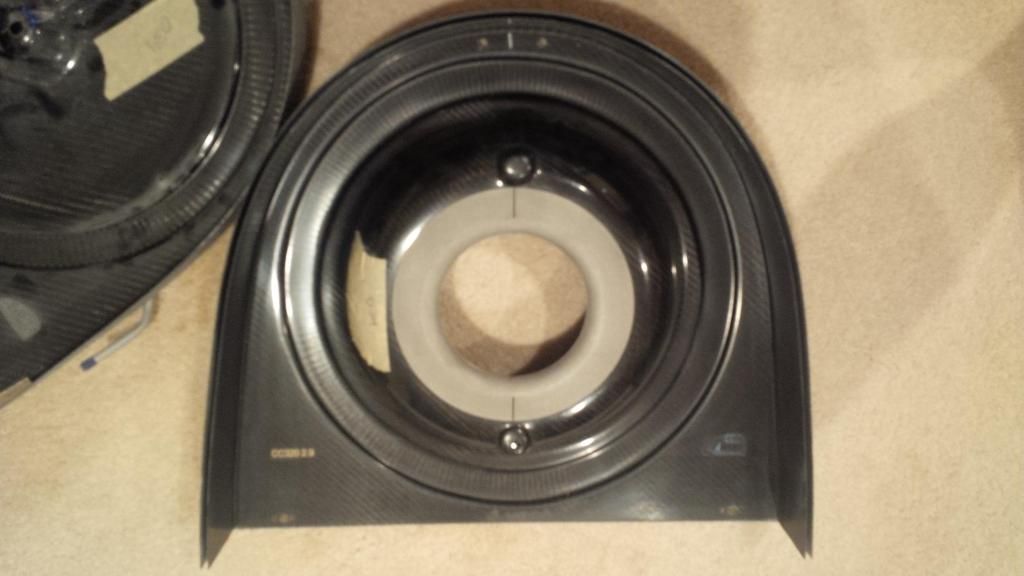

When I was there I couldn't resist purchasing a better air box than the one I had. I paid to much for it but it was new, natural carbon, light as hell and well a NASCAr part. I was like a moth flying into a light just couldn't stop myself.:rolleyes:

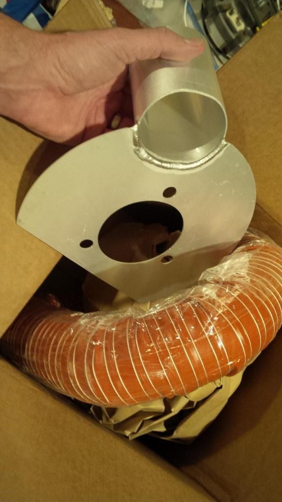

This week another couple parts showed up. Nothing special just some brake ducts from LG. But they will be cool.

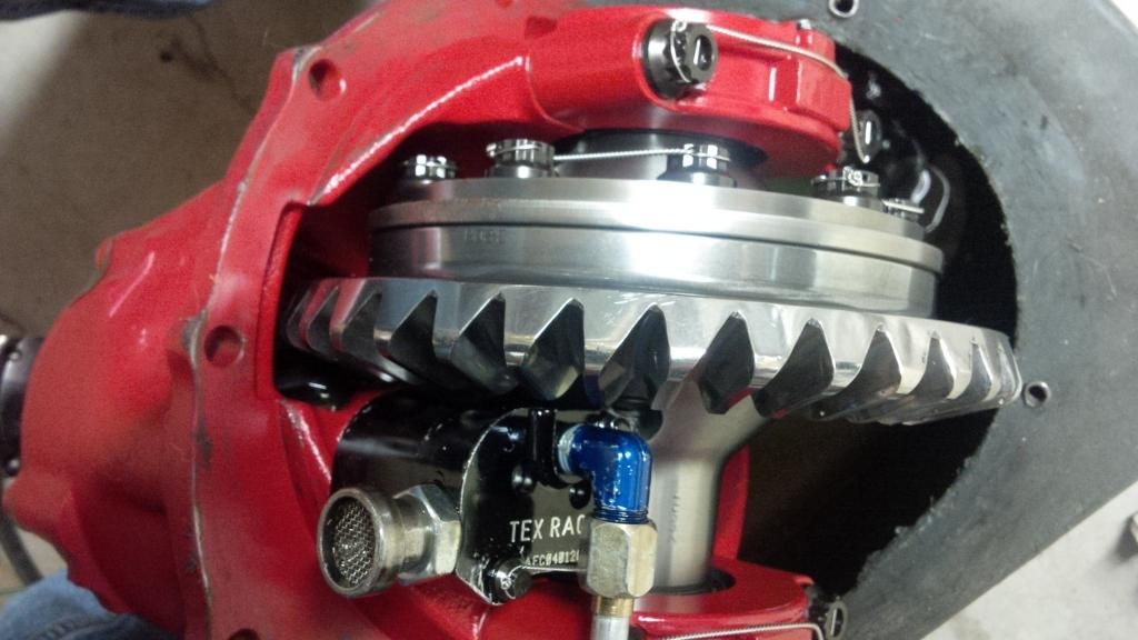

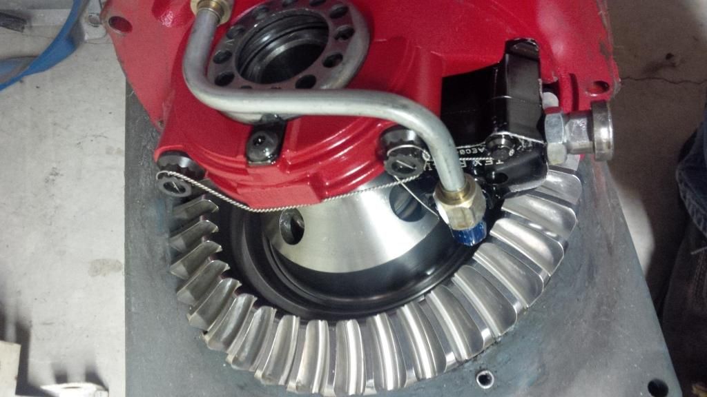

I've been down at the shop a couple days a week last month. I pulled the rear housing and suspension out and trimmed up the rear wheel lips. My inner wheelwell and my quarter, unlike a camaro, opens up and has more clearance above the wheelwell lip. So the lip is the closest point of contact.

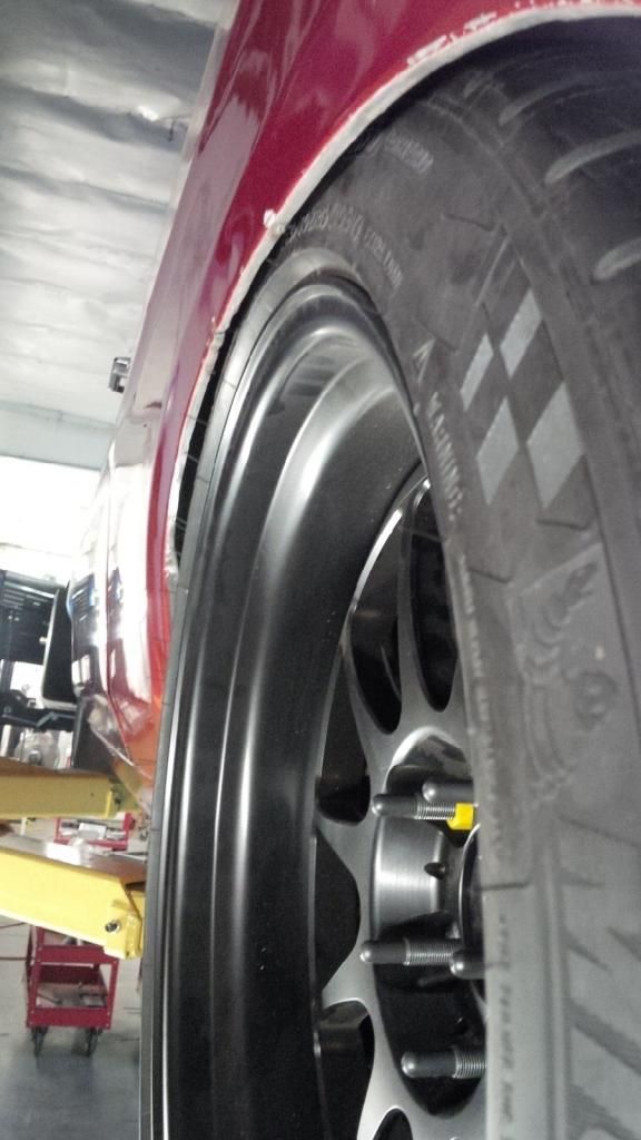

I trimmed it back to .25" thick. Then it mates with the inner wheelhouse going vertical from the remaining lip. I'll get a couple of decent pictures of it next week. But the tire has nothing but a flat wall to rub against.
Today I put all the suspension and my wheels back in and cycled the suspension through full compression and full compression on one side with the other side at varying heights. Here is a picture of the closest the tire gets. This is about ride height on the drivers side with the passengers side fully compressed. At this point the top of the tire is tipped out and the widest part of the tire is right at the closest point of contact to the body.
Matt A likes to call this the Hell fit clearance.:lol:

I didn't want to let Matt down. He counts on me to represent the hellaflush movement on Lat G.:D

I used that exact same pile of parts on my Mustang. That third member looks exactly the same, pump and all. My only advise I would give, is to take that soft locker out before you install it, there is NOTHING soft about it. Its action was so violent in the turns when it engaged and disengaged that it upset the car. A few times when I was on the ragged edge it started to spin the car. Just my experience, and I was running street tires, replaced it with a Waveloc which worked great. Sucked, had to resaftey wire all those ARP bolts.
I can show how to fix those tire clearance issues, it only requires sawzall and a welder. LOL

I have the same center section with pump. For now I'm leaving the pump off but I'll post up when I get running to see how violent mine is. I'm hoping I got lucky and have the softer springs but assume they will need to be changed
You're lucky you have straight panel on those qtr's and not a small flare to hang things up. What's going to be your next car...a Toyota, Nissan or Honda?????

I learned on my recent road trip ---- that a locker rear end wants to push the car STRAIGHT when you get on the gas and lock it up. Brian Hobaugh was having to be patient and WAIT to get back into the throttle after doing those crazy U turns in the Auto X....
While we know that we're not supposed to be back on throttle until we are "straight"... Another guy we all know -- Danny Popp -- has a funny motto -- "never straight - but always forward". BOTH of these guys are about as fast as a guy can get. Completely different driving styles.
Funny the little things you learn when hanging out at the right places. The Mustang has a locker -- and I never knew about the "pushing straight".... now that I know -- I can either make it work for me -- or at least understand what is going on and become more patient coming out of a turn.

I have plenty of experience with safety wire pliers. I even got a new set last year.
I bought a set of Ron Sutton's 40lb springs. I'll give the locker a try as is and then probably swap in Rons no so secret ingiedient to obtain the desired results.
I know I can count on you for extreme body mods executed in a Shinoda style so I'll keep that in mind:lmao:

It is tight no doubt. I am looking to maximize the stuffed look. :lmao: Remember that picture is two things.
1. Showing the tire at its widest point with the axle tipped at the most extreme angle bringing the top of the tire out twords th quarter.
2. Purposely taken from a "shock value" perspective.

TAC 04-03-2014 06:14 PM
Been waiting for some updates Rob. Looking good, the rear tire is right where it should be.
I run Detroits front and rear in my Bronco and there is nothing like......
"Steering by Detroit"
Is that pump in the 9" just for the cooler?
On some of the race cars I used to work on we used an external pump and dry sumped the diff and trans similar to an engine setup.
