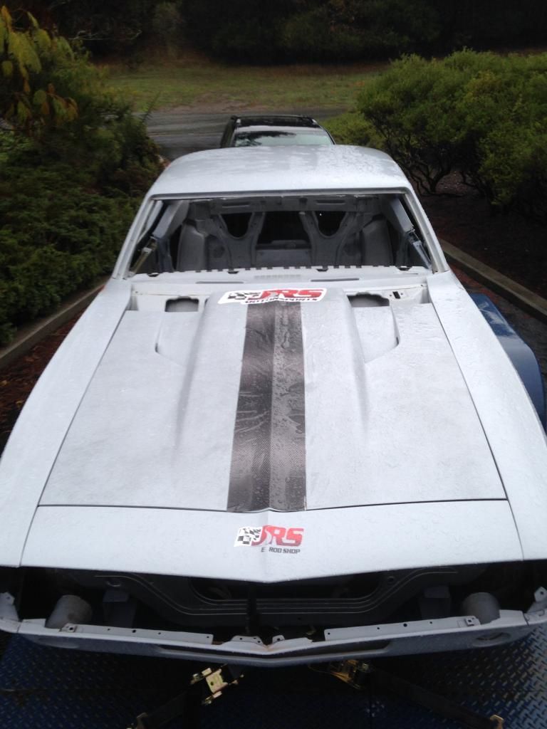

So you're saying you won't be running the JRS decal package then? :sieg:
http://i236.photobucket.com/albums/f...ps6sjuswiw.jpg
http://i236.photobucket.com/albums/f...psf1wrfcr3.jpg

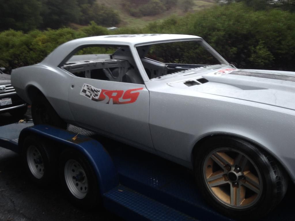

Payton King 11-24-2014 06:47 AM
That stuff makes me laugh!
Pettigrew has been in NASCAR forever. His last stint was in Hendrick's hot rod shop. He is now at home working out of his shop on my car and a gasser Chevy II. Cars were almost twins until I fixed my wheel base.

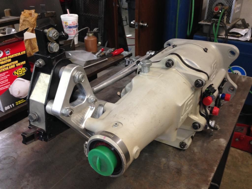

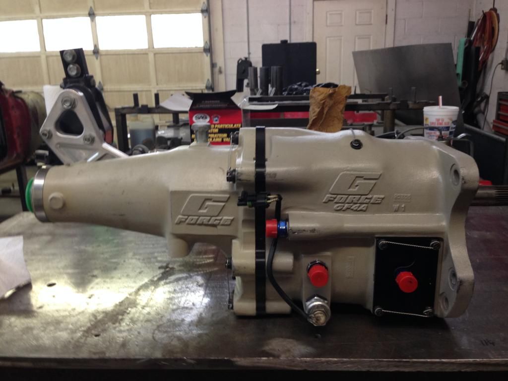

Continuing on the thrift shop theme, picked up a GF4A from a local race team.
http://i1138.photobucket.com/albums/...psmnpzmtl1.jpg
http://i1138.photobucket.com/albums/...psbsqt4n2g.jpg

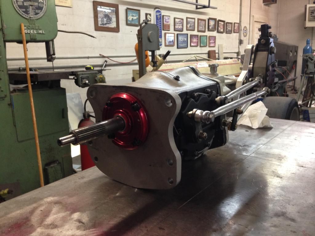

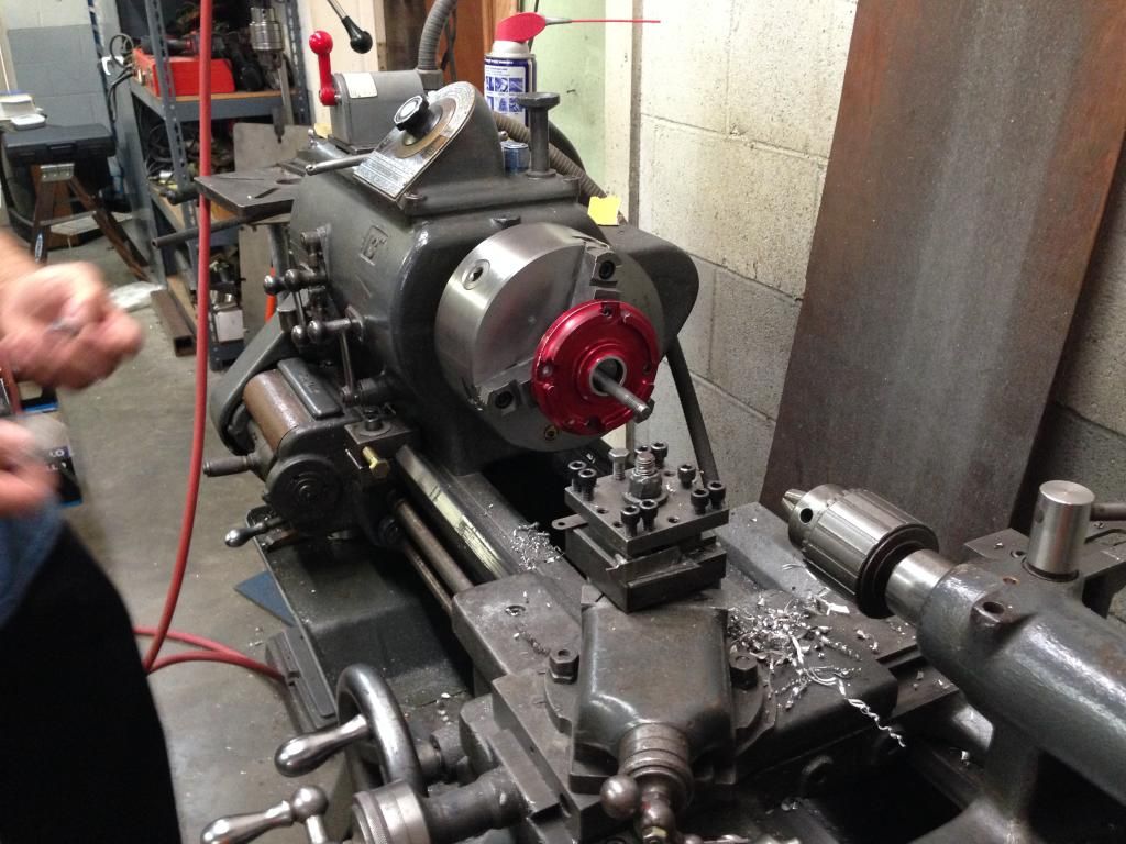

Here is a little piece of information that I did not realize. The bearing retainer on these boxes are indexed for either a Ford or Chevy. The Chevy one is smaller. Guess which one was on my trans?
http://i1138.photobucket.com/albums/...psyitsdd4p.jpg
So we had to remove it and Jim turned it down to fit my Chevy/RCR bellhouse
http://i1138.photobucket.com/albums/...psblg4afda.jpg
