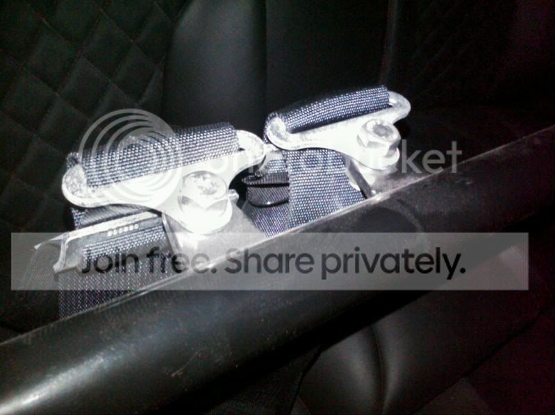

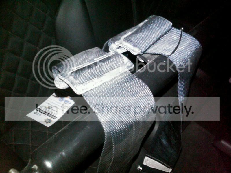

Matt@BOS 01-18-2011 10:07 PM
Todd, I remembered to snap a couple shots of the cross bar harness attachments. Be warned though, my camera died, so these are some of those dreaded Blackberry pics.
http://i366.photobucket.com/albums/o...115-1549-1.jpg
http://i366.photobucket.com/albums/o...10115-1548.jpg
Matt
