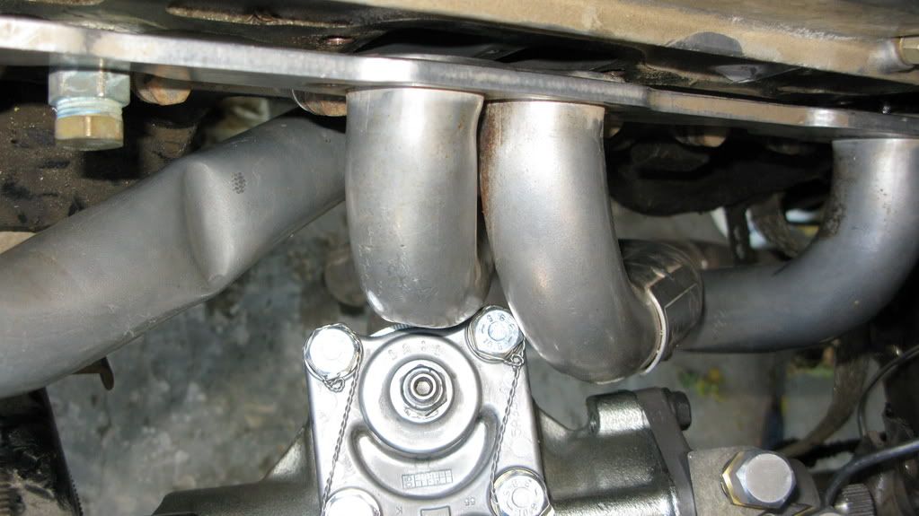

For my mockup install, I had the car on jackstands front and rear, and the steering box was not in. I put the header in from the top. Then I covered the primaries with a rag, and could actually put the steering box in from the top and completely bolt it in. The clearance isn't enormous, but it could be enough since the motor torques to the other side and I am running solid body bushings. Here are some pictures of the clearance:
http://i207.photobucket.com/albums/b...o/IMG_0660.jpg
http://i207.photobucket.com/albums/b...o/IMG_0663.jpg
sik68 09-14-2008 10:39 PM
http://i207.photobucket.com/albums/b...o/IMG_0662.jpg
The clearance is actually a bit more everywhere than these photos show, it's just hard to get a photo that shows the true gap between them. Finding headers that fit is a true victory. :thankyou:I didn't try the passenger side header yet.

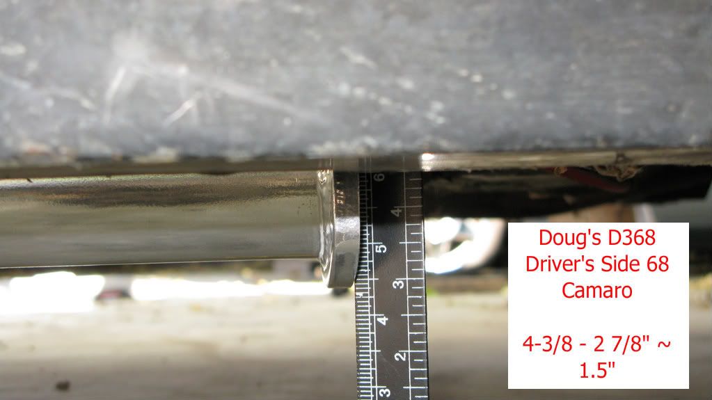

Oh, and for the record, here is a photo of the driver's header and how far it hangs below the subframe: Roughly 1.5"
http://i207.photobucket.com/albums/b...o/IMG_0668.jpg
