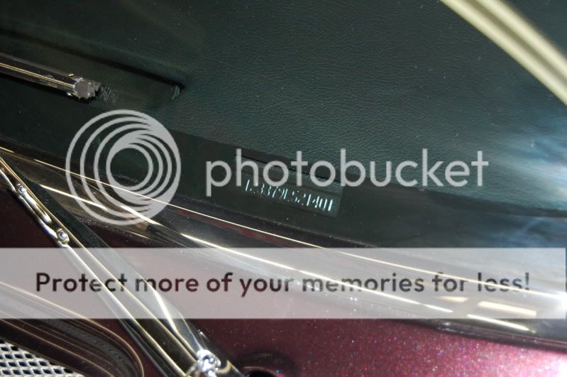

Also, any reason you don't want to mount the vin close to the where it originally was? I know some states like California, for example, are really picky about this, and technically I don't think you're supposed to tamper with, or remove the vin from its original location. This is what we did, and it doesn't look bad:
http://i366.photobucket.com/albums/o...A/DSC_0257.jpg
Matt
We have the flush fit glass and it is painted around the edges,,so where you have the vin will be covered. We are fixing to install the glass so I will check it out.
It looks like you did move it closer to the window edge.

Yes, we moved the vin up so that it is right by the window. I think the guys at the shop just used a razor blade to remove the paint on the back of the windshield to make the window for the vin tag.
