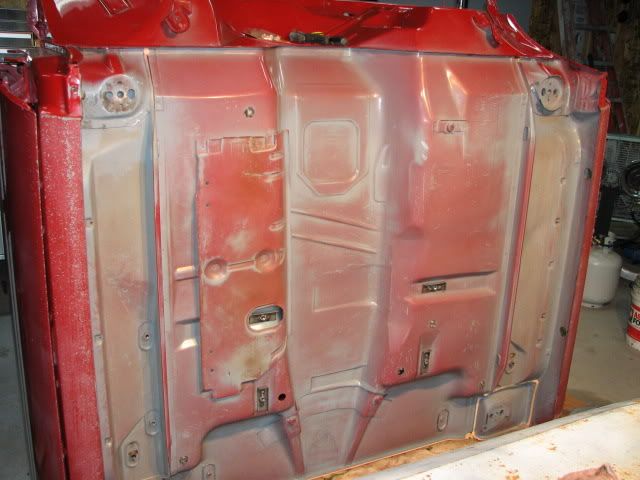

I started cleaning the underside of the cab last night, in preparation for paint.

Before & After @ 8hrs
Here's a before & after, took about 8 hours off and on after work. Does anyone know if any OBS cabs came with a heat shield for the drivers side under cab. I plan on running long tube headers with cats right at the collectors. Should be easy to fab one also.

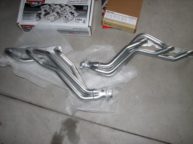

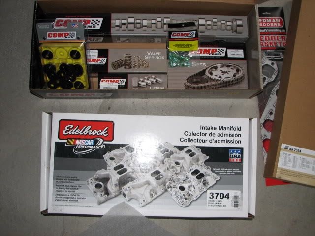

Courtesy of the big brown truck & Summit Racing. I am starting to put the motor back together. I bought a small cam Extreme Energy 249, I want the truck to be reliable and tame. I also went with a set of Headman Elite long tubes, 14ga tubes, 3/8" flanges. These things weigh as much or more than the stock manifolds.
