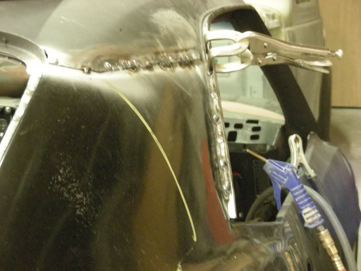

Everything looks really good with the panels. Quality and metal thickness is top notch. Only thing that I noticed was along the gutter rail on the roof line. On the factory roof panel, there is a slight ridge just inside of the drip rail. That is not there on the AMD replacment quarter panel. Just a little detail that some people may not like. You can see it in the photo below right beside the clamp where the ridge ends and does not continue on the quarter.

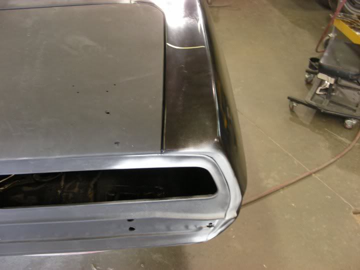

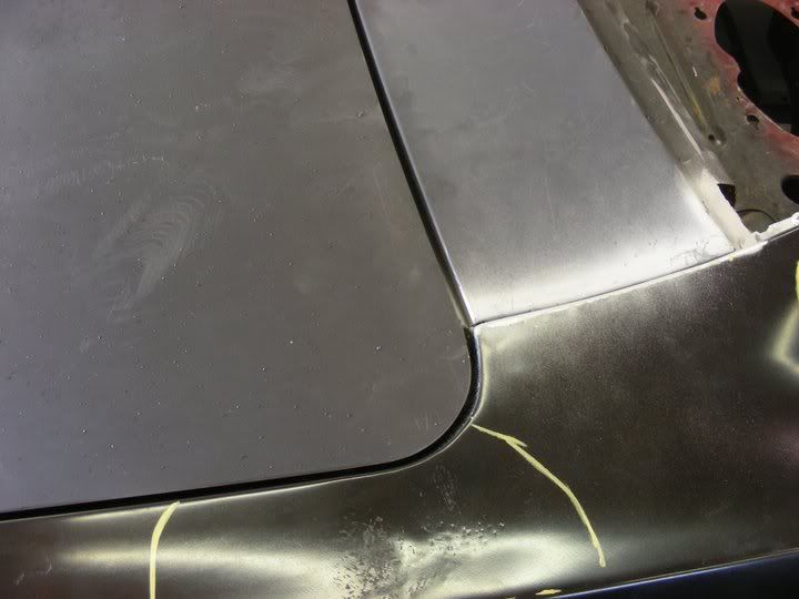

Other than that, with a little hammer and dolly work the gaps are near perfect.:thumbsup:
