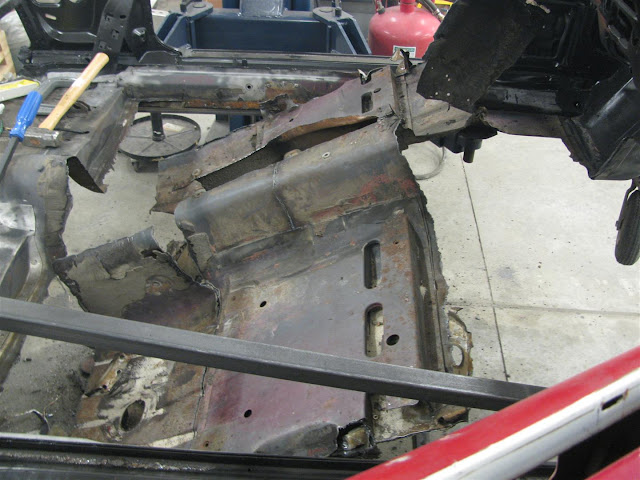

Between using the plasma cutter to make room and the air hammer to help seperate those spot welds... OUT comes the old.
https://lh3.googleusercontent.com/-_...Large%2529.JPG
https://lh4.googleusercontent.com/-L...Large%2529.JPG

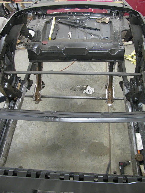

I will be removing the rear section... just spit it into two for ease of removal.
Firebird-Geek 07-24-2012 03:03 PM

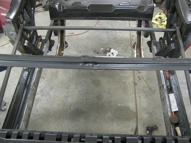

To keep the frame rails from moving when removing the floor... I already had 1" square tubing welded to the 2" tubing that runs along the rockers and then to the frame rails themselves. This should not allow any movement of the rails.
https://lh6.googleusercontent.com/-D...Large%2529.JPG

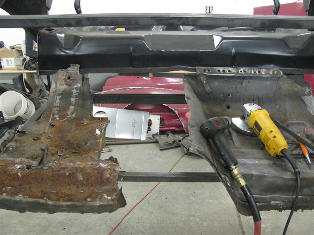

Firebird-Geek 07-24-2012 03:09 PM
Plasma + Air Hammer + Grinder... damn it was NO FUN removing this part. I broke off 2 air hammer chisels with this section. There are LAYERS of metal that make this part of the floor up.
FINALLY it is OUT!

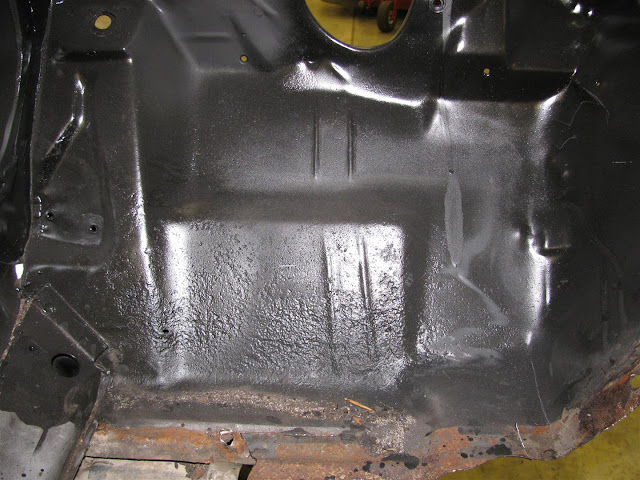

The front toeboards had a bit of pitting on them... the drivers side was worse than the passenger. But, being that I have gone this far, leaving pitted metal didn't seem right.
https://lh3.googleusercontent.com/-w...Large%2529.JPG
Oddly the floor pan was not rusted bad at all on the drivers side of the main floor. Carpet must have held more moisture on the toeboard, for it sure did have some good pitting.

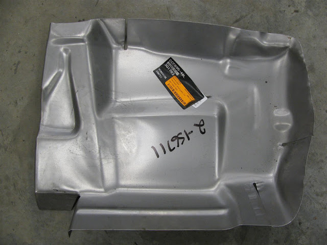

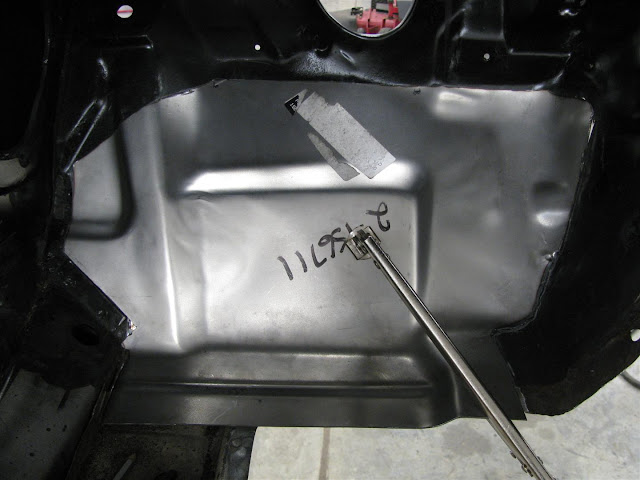

New "show quality" drivers side toe board patch panel... not really sure if it is "show quality". :)
https://lh4.googleusercontent.com/-x...Large%2529.JPG
Trimmed patch panel to the contour that best worked.
https://lh5.googleusercontent.com/-N...Large%2529.JPG
Clamped and marked area to cut...
https://lh6.googleusercontent.com/-b...Large%2529.JPG

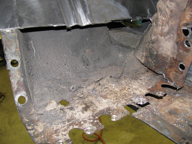

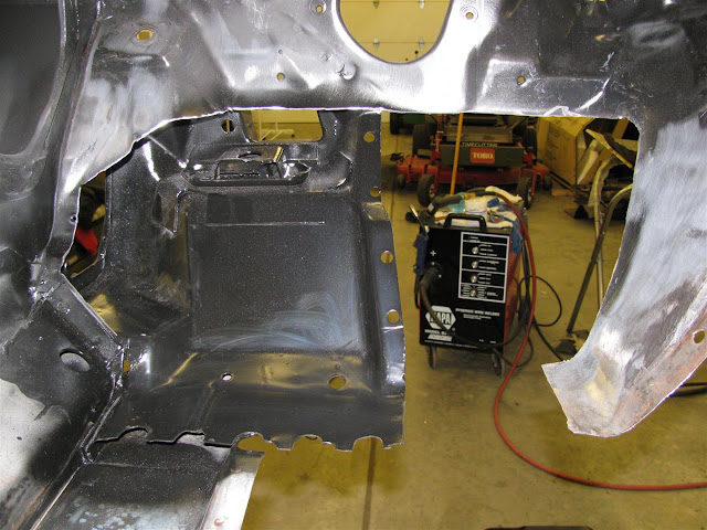

Did the same with the passenger toeboard. Look at the junk under the toeboard. So even though the area almost didn't need to be cutout, I felt better that i was able to get in here and clean it up.
https://lh6.googleusercontent.com/-W...Large%2529.JPG
https://lh5.googleusercontent.com/-V...Large%2529.JPG

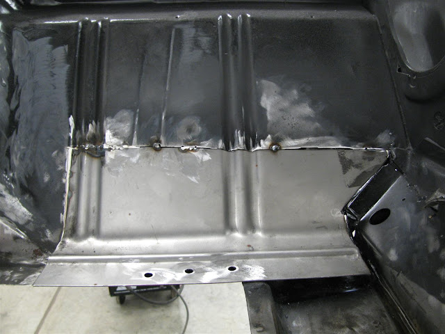

Started to tack everything back together. But welding this thin stuff can be lots of fun. A tip my dad (who taught me to weld at a very young age) gave me... if you have a large gap that is to much for your mig to easily fill, take a metal cloths hanger and feed it into the welding pool (almost like a tig welder) and it will easily fill the gap.
https://lh5.googleusercontent.com/-L...Large%2529.JPG
https://lh3.googleusercontent.com/-j...Large%2529.JPG
Welded in... just need to dress the welds a bit and hit it with primer.

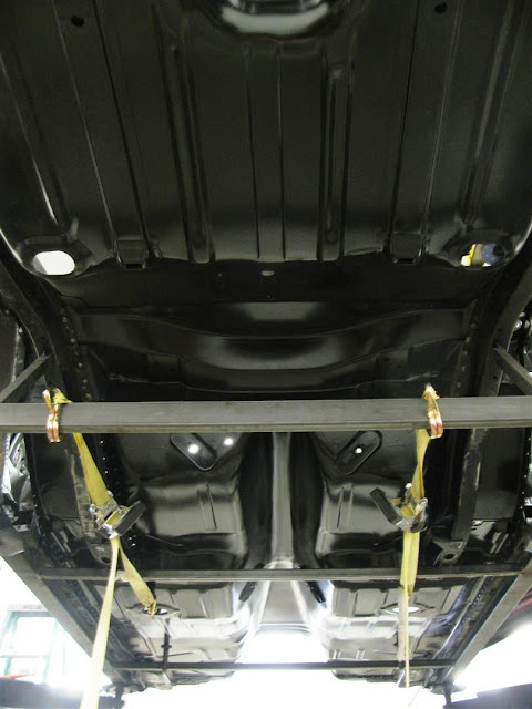

In goes the main floor for a test fit. It did fit pretty good... just needed to be pulled back into the frame rails (there was about a 1/4 inch gap). To remedy this, I used rachet straps and attached them to the square tubing I have attached to the car acting as a temporary jig for the body. It worked great!
https://lh6.googleusercontent.com/-E...Large%2529.JPG
https://lh4.googleusercontent.com/-B...Large%2529.JPG

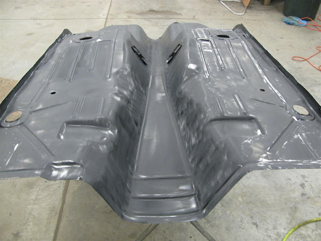

Firebird-Geek 08-16-2012 02:39 PM
After numerous times of taking the floor in and out to check fit... I finally was able to scuff the e-coat (checking for rust) and apply a few good coats of epoxy primer before it gets put into place. I know I will have to do this again after welding the floor in, but it is so much easier doing the initial scuffing with the floor out, and not attached to the car.
https://lh3.googleusercontent.com/-9...Large%2529.JPG
https://lh5.googleusercontent.com/-t...Large%2529.JPG

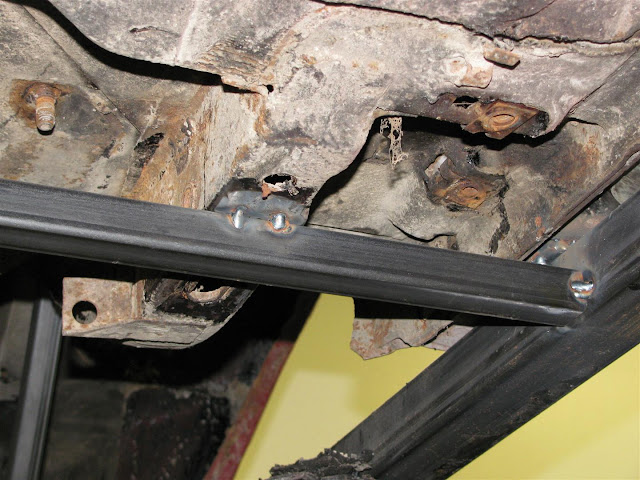

Firebird-Geek 08-16-2012 02:44 PM

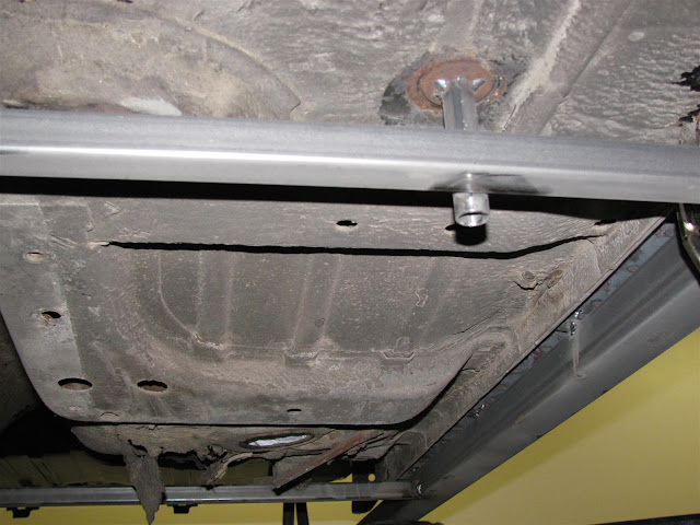

The "subframe locators" I installed worked GREAT.
I used some tubing and a flat washer and centered the subframe bolts into the existing floor location then welded 1" tubing to attach these to the 2" side tubing... this way I should be able to lay the new floor in and if I can thread the bolts... It should be in the exact same location as the old floor.
https://lh3.googleusercontent.com/-M...Large%2529.JPG
https://lh5.googleusercontent.com/-A...Large%2529.JPG

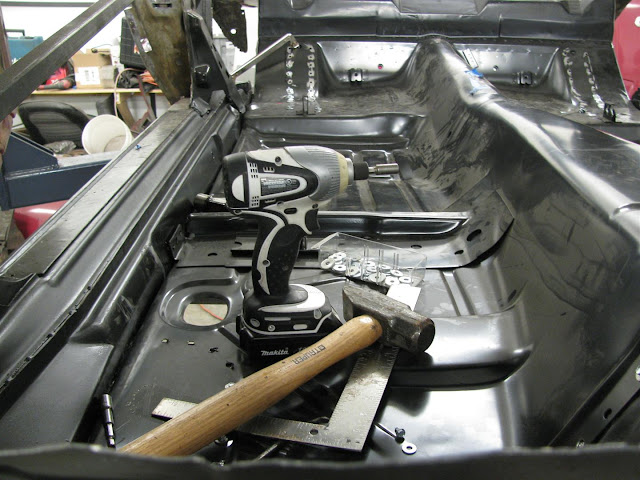

Firebird-Geek 08-16-2012 02:52 PM
Tools of the trade you need for this... Hammer, screws. clamps and lots of patience! :)
