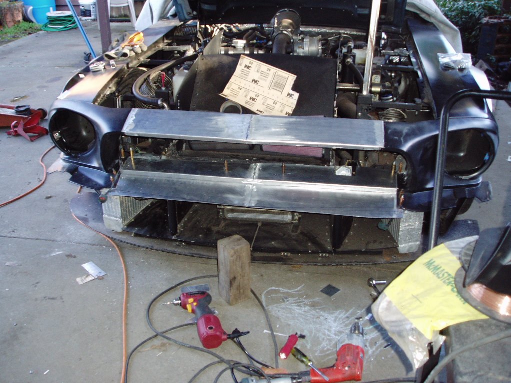

Anyway I got shelby headlights from NPD and built my own nose piecees using my new Harbor Freight english
wheel. These came out nice too, the "curvature" on myh nose piece matches the original fiberglass piece perfectly.
http://www.carter-engineering.com/pr...nosebuild1.jpg
You'll notice the early mustang valence is several inches above teh ground place. Most "racy" builds fill this
space with an air dam or one of those cow catcher style front pieces. I did not like either of these solutions,
so I custom built a lower valnce from aluminum. Now I have obviously shaped a lot of metal but its all been
"rolled", or bent or manipulated in straightforward ways. I haven't done a lot of shot bag work but I finally
picked up an English wheel and so this was my first "compound curve" metal shaping but I was very happy with
the way it came out. You may notice a little wiggle in the upper "bar" of the valence but this is okay
as it will be covered by a bumper (vintage !). I will continue to run a splitter tray underneath the valence
but it matches the ground place exactly. I tried to cover as much front tire as I could but like I said
I had to curve it in to make it look factory.
http://www.carter-engineering.com/pr...encebuild3.jpg
http://www.carter-engineering.com/pr...encebuild2.jpg
http://www.carter-engineering.com/pr...nishednose.jpg
So that's where I'm at now, I'm getting ready to send th front fenders to the sandblaster,but I'm messing
around with some louver vents in the tops of the fenders (right above the turbos). They would match the style
of the hood vents on the '68 Shelby hood, so they're not totally out of line, but they would take me a step back
to "race car" rather than fool your eye performance vintage muscle. But they would be very functional, the heat
off the turbos will almost blister the paint otherwise I'm afraid. Also, the hood will be louver vented
(think Mach '69 style) so its not like I'm gonna look too pedestrian. This is another issue, not sure
how to use the '68 shelby hood with its big aggressive nostriles and also implenment a cowl rise and
big radiator vents out the top. it might be too much. Can't decide whether to be sane and buy a nice quality
FG hood and widen or build one from scratch out of aluminum. Lots of work either way.

looking great preston.

Payton King 03-31-2014 07:43 AM
Love the new direction. Great job on the fab work.
MSTSFabbed 03-31-2014 09:46 AM
Dang man! 180 degree turn from previous!
But I gotta say the new look is a 1000 times better! The previous flares just never flowed with the car well enough. You could always see a stock 67 sitting in a ring of flares. (That's probably also because I DD a 67 coupe!)
I'm pumped for you and excited to see this move along! Keep us posted!
67zo6Camaro 03-31-2014 09:50 AM
Agreed, great body mods. Looks cool.
