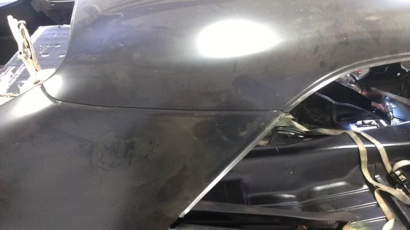

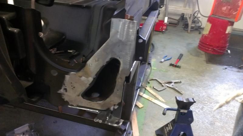

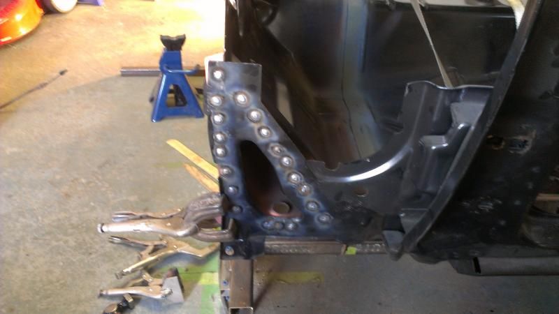

streetbird 12-23-2013 02:51 PM

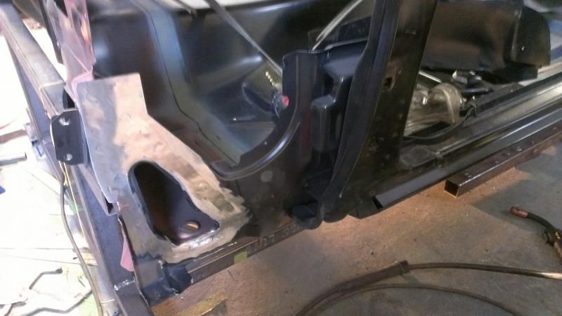

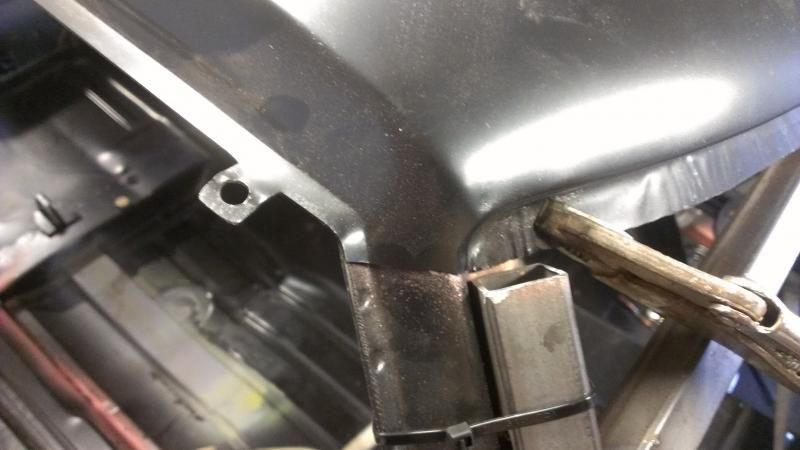

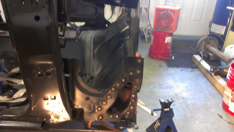

Start to weld some part. I suck in welding = hours of grinding
http://i9.photobucket.com/albums/a56...ps4d4f7310.jpg
http://i9.photobucket.com/albums/a56...pscaef6684.jpg
http://i9.photobucket.com/albums/a56...ps50377160.jpg
http://i9.photobucket.com/albums/a56...psad96df87.jpg
http://i9.photobucket.com/albums/a56...ps3f087721.jpg
http://i9.photobucket.com/albums/a56...psa04af241.jpg

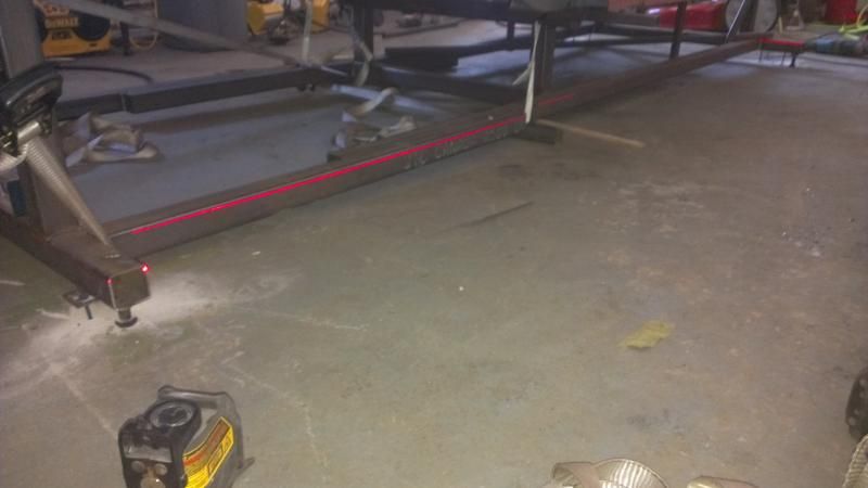

streetbird 12-31-2013 09:43 AM

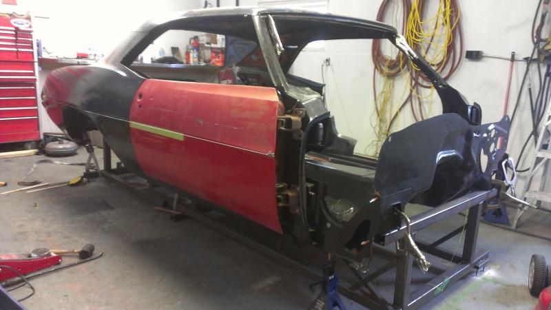

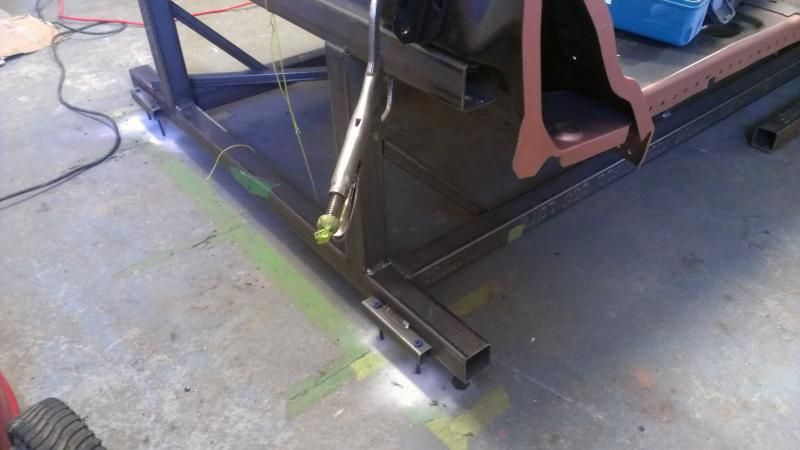

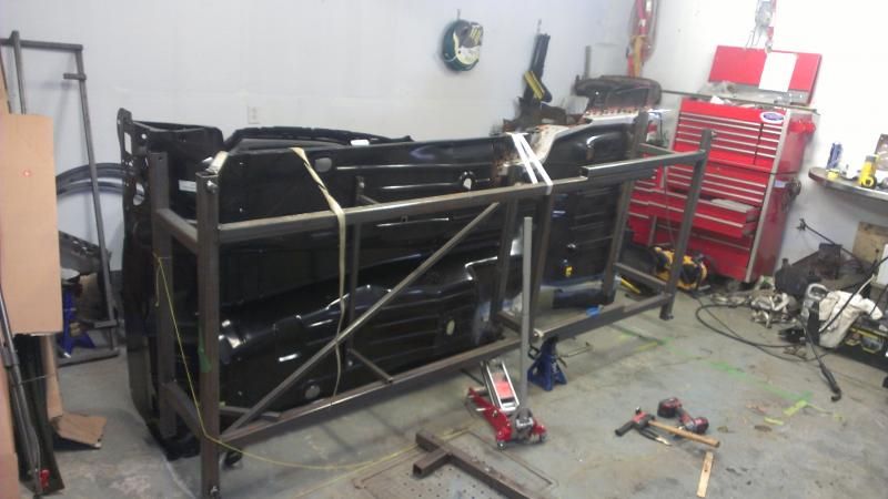

Sit back the jig to ground but its warped.
So I screwed it to the garage floor to make it straith.
I reinstalled the structure and quarter to realign.
I didnt receive driver side quarter so I did it on pass side only and the structure is ready to weld on the floor pan.
http://i9.photobucket.com/albums/a56...ps744703b8.jpg
http://i9.photobucket.com/albums/a56...psddefd510.jpg
http://i9.photobucket.com/albums/a56...ps298bba1a.jpg

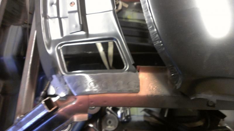

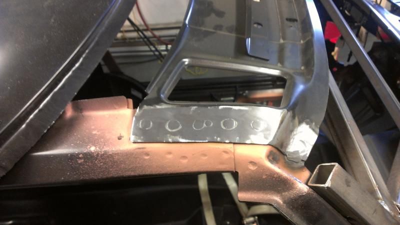

streetbird 01-17-2014 12:59 PM

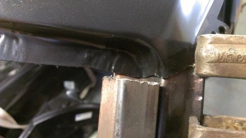

http://i9.photobucket.com/albums/a56...psfc74a344.jpg
http://i9.photobucket.com/albums/a56...psa3532082.jpg
http://i9.photobucket.com/albums/a56...psc93ce459.jpg
http://i9.photobucket.com/albums/a56...ps4cbd7905.jpg
http://i9.photobucket.com/albums/a56...ps05248d50.jpg
http://i9.photobucket.com/albums/a56...pse1065953.jpg
http://i9.photobucket.com/albums/a56...ps4262fb41.jpg
http://i9.photobucket.com/albums/a56...psb1e1ce3a.jpg

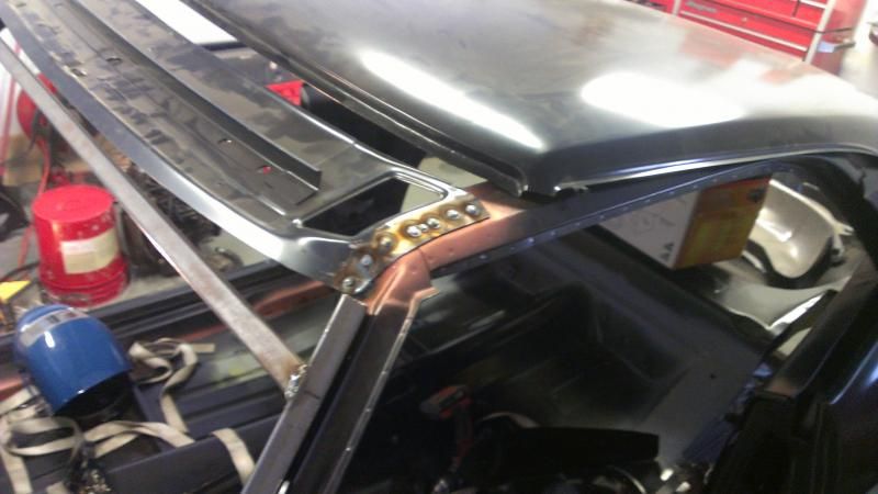

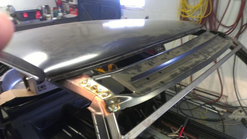

Test fit the roof panel
http://i9.photobucket.com/albums/a56...ps391758ca.jpg
http://i9.photobucket.com/albums/a56...ps653a24e7.jpg
http://i9.photobucket.com/albums/a56...psce549efb.jpg
http://i9.photobucket.com/albums/a56...ps469ce7c5.jpg

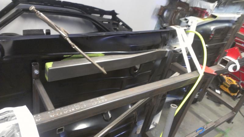

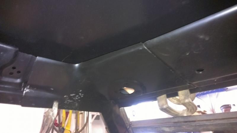

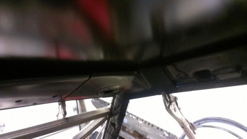

Inner roof brace
http://i9.photobucket.com/albums/a56...ps590ebb58.jpg
http://i9.photobucket.com/albums/a56...ps2905a0d8.jpg
makoshark 01-17-2014 11:04 PM
Your welds look pretty darn good to me:thumbsup:
You are doing an amazing job on your build. Keep it up:thumbsup:

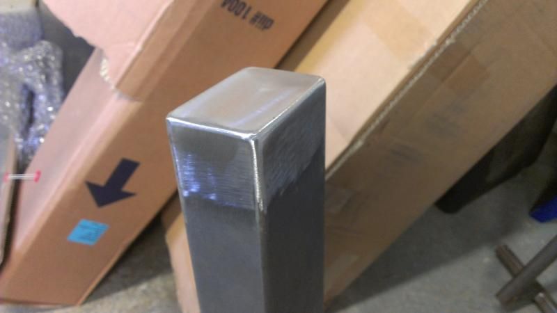

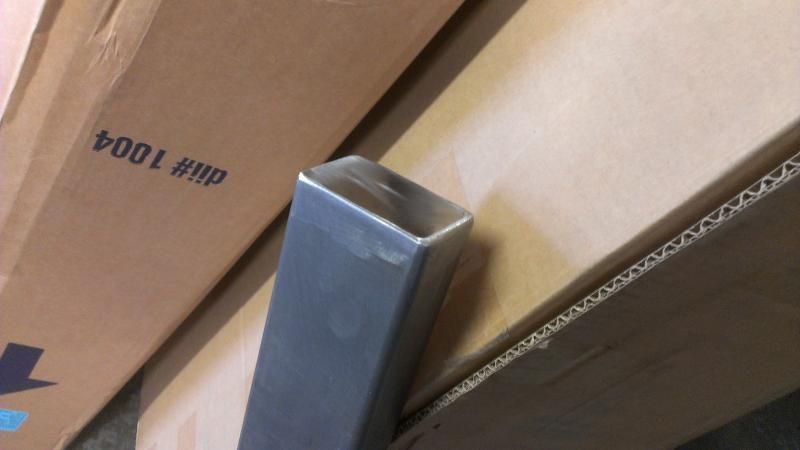

I noticed something though. One of the reasons why DSE leaves the end of their subframe connectors open for you to weld, is you may have to cut the length of them to properly fit to the subframe itself. I was wondering if you had fitted the subframe to make sure there's no interference between the connector and the subframe?
streetbird 01-17-2014 11:09 PM
thanks for the advice. I didnt test fit my subframe but with the connectors already welded, if it dont fit I will chop the end of the subframe. Ive got 2 inch between the center of the bolt and the connectors end
makoshark 01-17-2014 11:28 PM
Measuring from the center hole of the rear mount on the subframe is an aspect I never considered:sieg:
