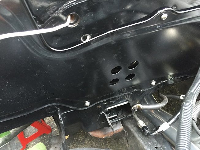

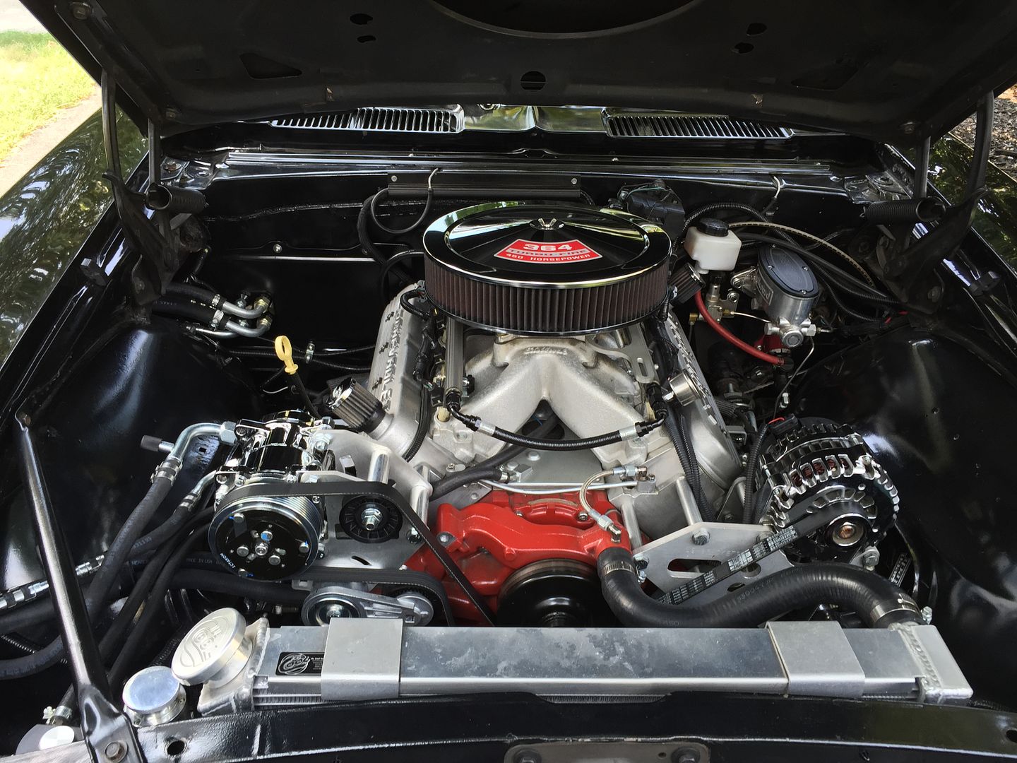

I ended up going with the Vintage Air Gen IV setup for my LS engine (old school LQ9). I installed it myself, over a couple of weekends. It would have been pretty straight forward, but I ended up tweaking a bunch of things.
I relocated my ECU to my glove box. I used a DSE firewall heater delete plate, and a 4 way bulkhead fitting from VA, with the EZ clip hoses. Ran the hoses behind the passenger side fender to keep it clean. Had to modify one of the evap lines because I had already relocated my coil packs to the same spot the line wanted to pass through, etc...
The AC blows at 38 degrees on a 90 degree day, couldn't be happier!

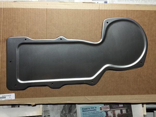

This is the DSE heater delete plate which I painted gloss black to match the firewall:
http://i228.photobucket.com/albums/e...pslgxlh5sa.jpg

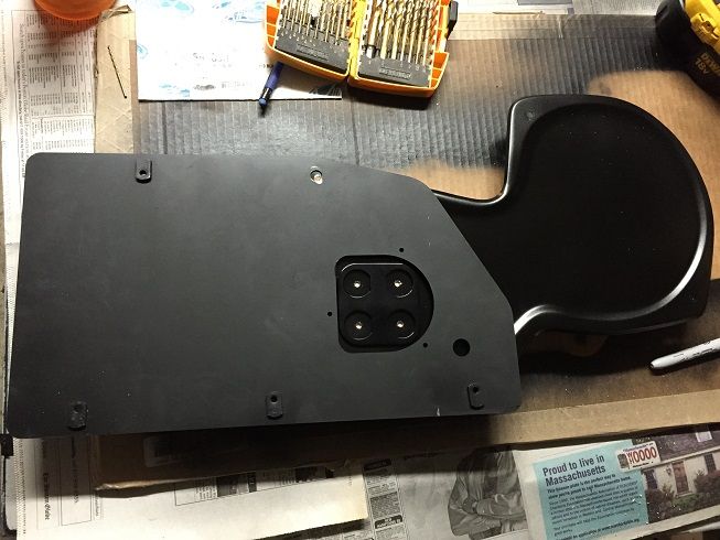

This is the VA firewall block off plate that goes on the inside. I used them both, and cut holes for the VA bulkhead fittings. This is the interior side of the panel:
http://i228.photobucket.com/albums/e...psolamav6e.jpg
Here's the DSE Heater Delete plate mounted and sealed with black silicone:
http://i228.photobucket.com/albums/e...ps64xdqkg4.jpg

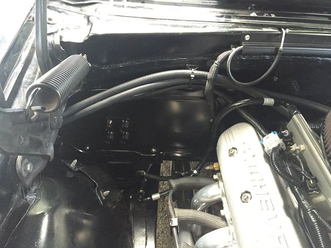

Bulkhead fittings added, the hoses will turn 90 degree towards the passenger fender and pass behind the fender:
http://i228.photobucket.com/albums/e...pselm70ksi.jpg

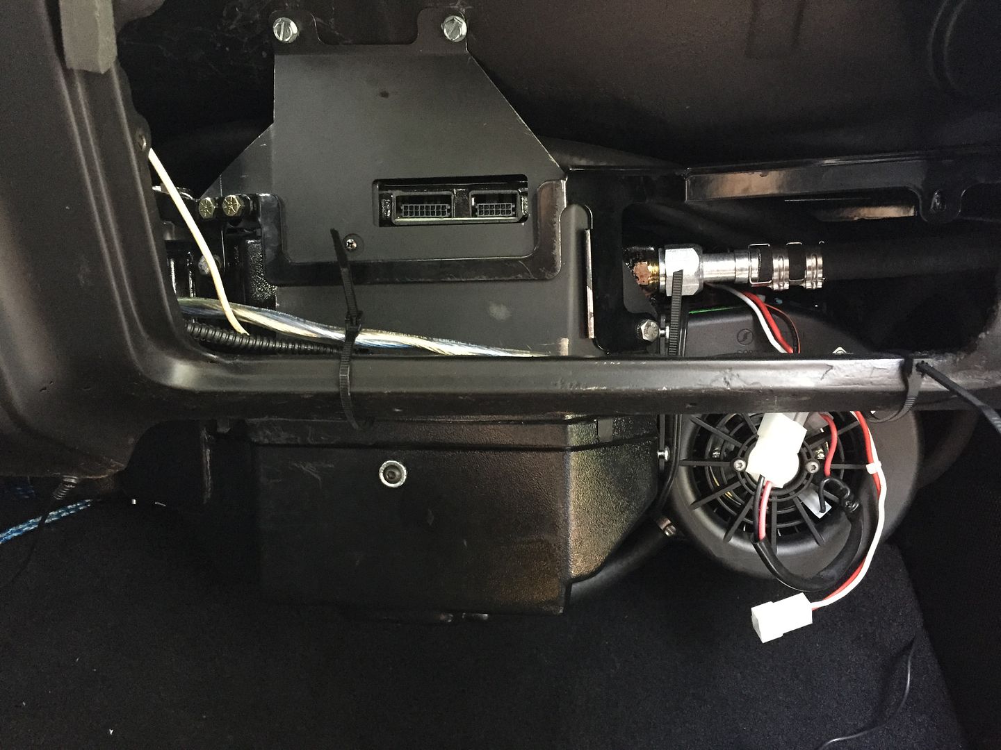

Here's the Evalorator unit plumbed and mounted:
http://i228.photobucket.com/albums/e...psh1ikncr5.jpg

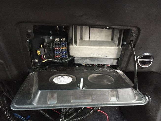

ECU in the glove box, I had to modify the latch on the right after this photo:
http://i228.photobucket.com/albums/e...pscwcbqzy2.jpg
I clocked the AC compressor 90 degrees towards the passenger fender for a lower profile look:
http://i228.photobucket.com/albums/e...pswssdrfud.jpg

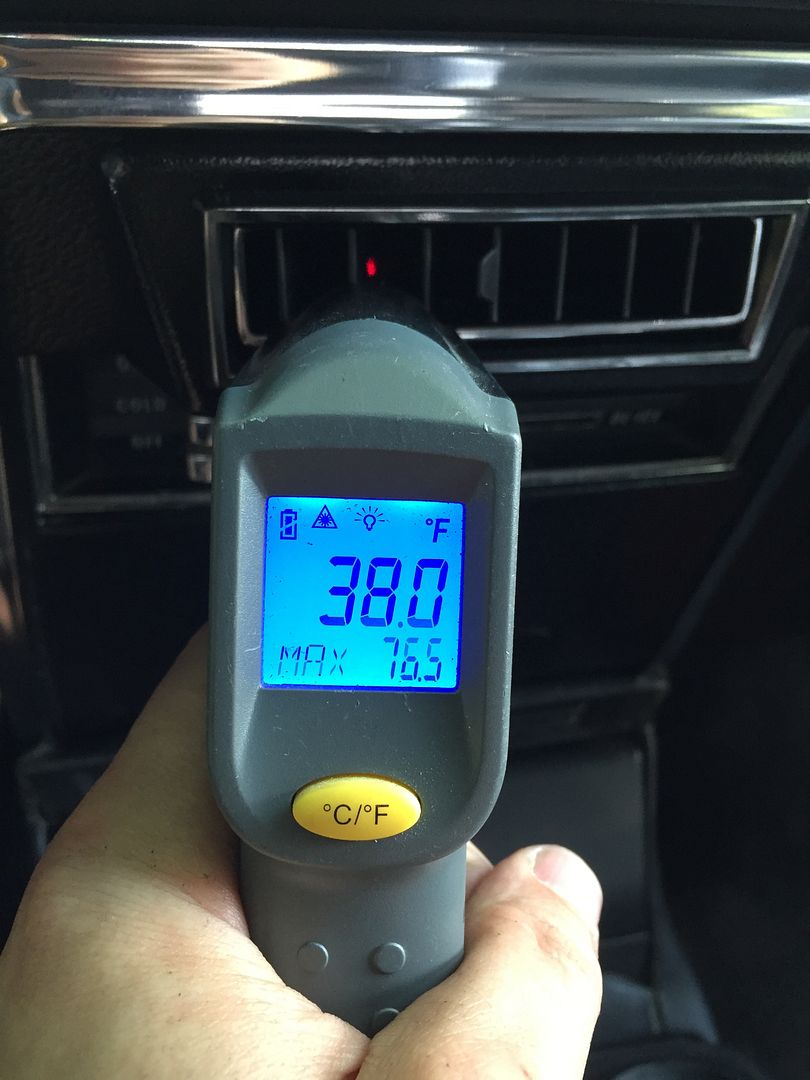

Charged the AC myself, and here's the results on a 90 degree day:
http://i228.photobucket.com/albums/e...psvwqsppin.jpg
