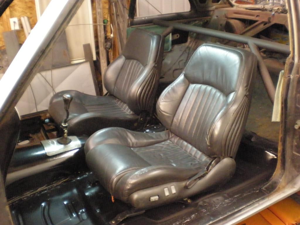

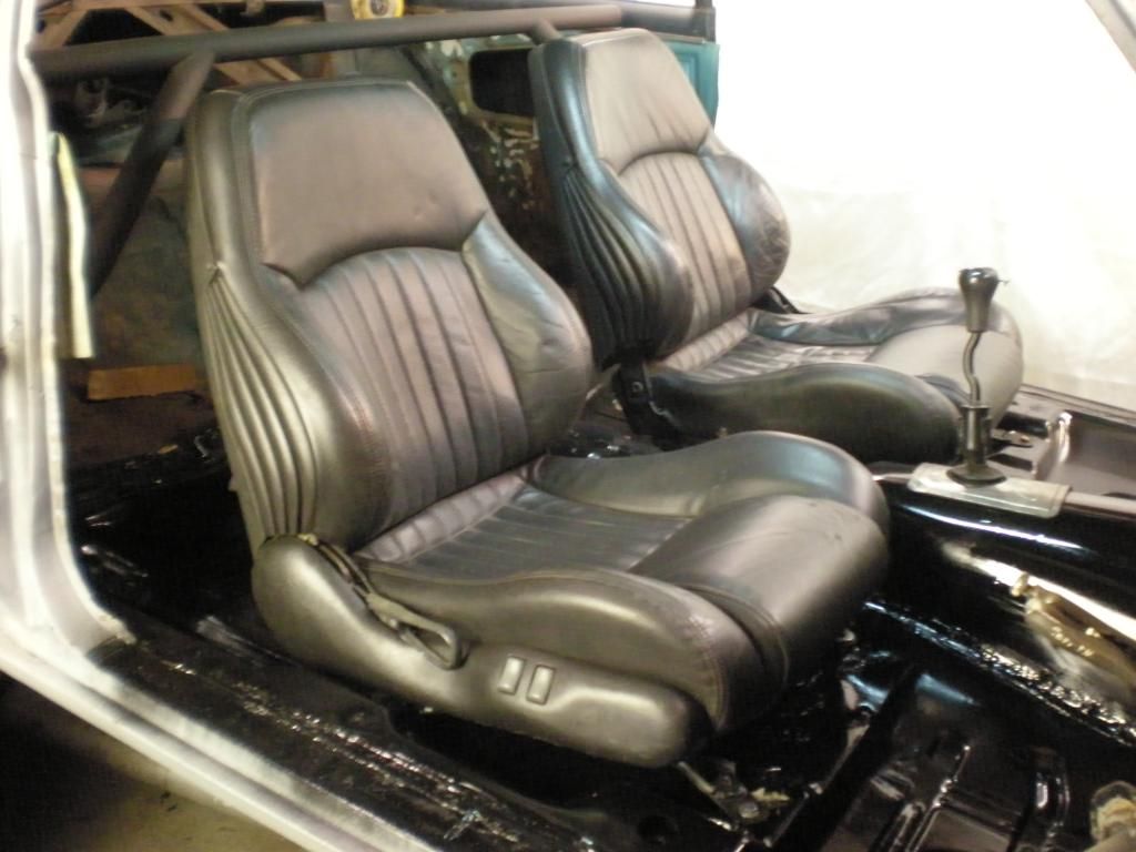

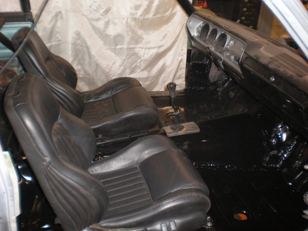

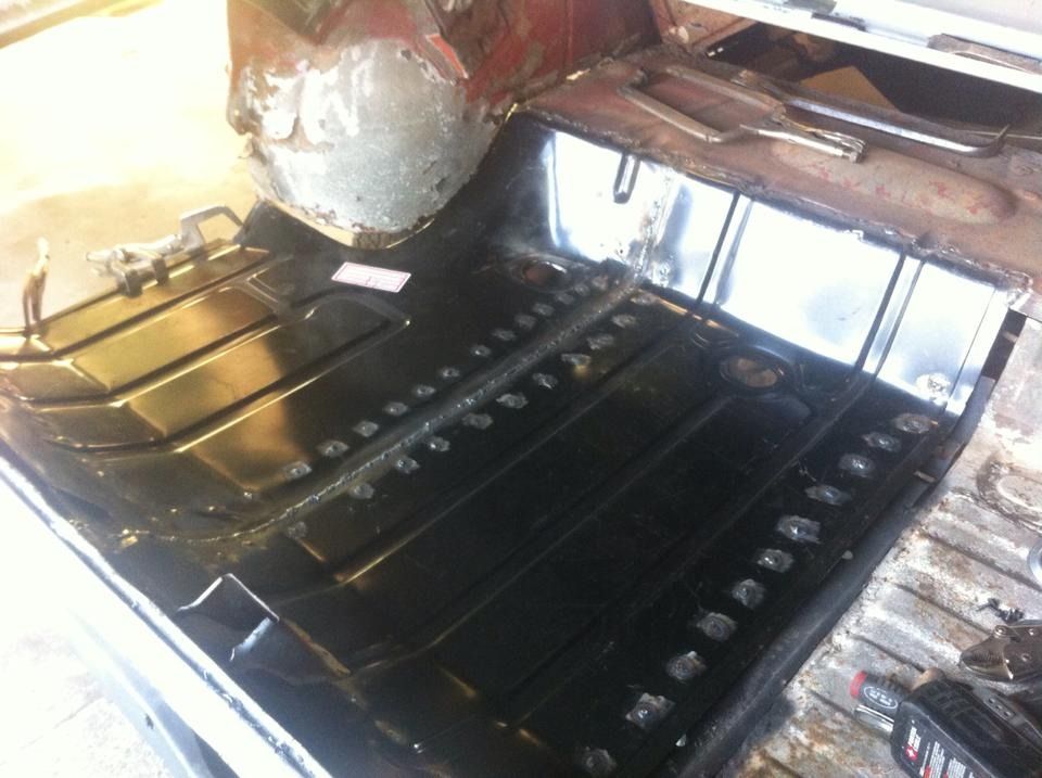

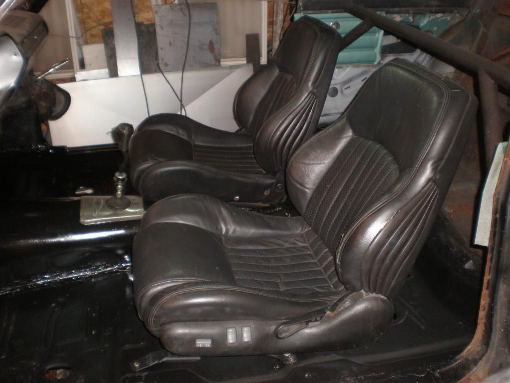

2-11-15... I was able to find a replacement seat to rob the tracks and recline mechanism. I got the passenger seat tracks modified and seat mounted into place. I also finished the floorboards by grinding the welds, applying seam sealer and a little paint.
