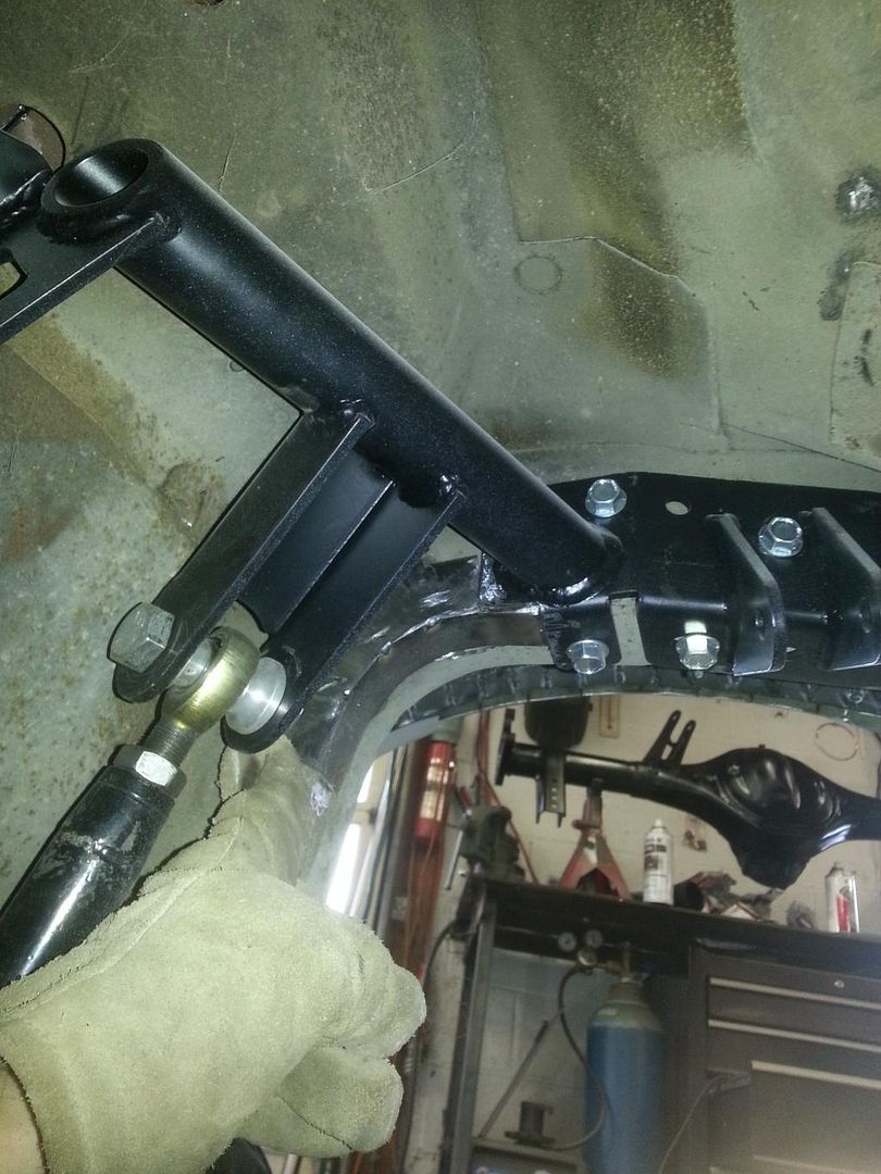

I finished installing the 4 link and 9". I decided to keep my frame rails since they are in great shape and thicker replacements were offer $500.
I tried to strengthen the frame and 4 link bracket to prevent cracking. It looks like the other cars frame cracked in front of the 4 link cradle/bracket. This is where the frames are thinnest from being bent.
I took a piece of 1/8 angle iron to strengthen this area. I welded it to the ridetech bracket hoping it would help distribute the load. I also welded the ridetech bracket in a few spots to help secure it.

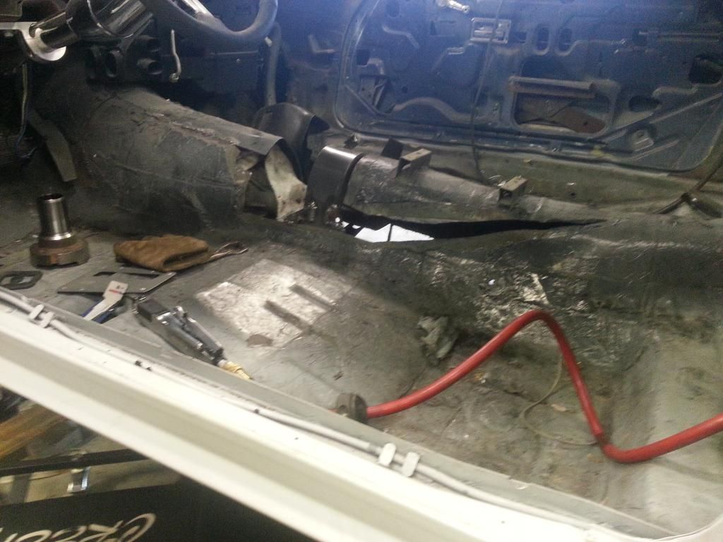

Now that the rear suspension and axle have been installed i can finish up the trans and driveshaft tunnel. The 6l90 is huge and requires the trans tunnel to be widened and raised. The yoke is also very high compared to other trans and required the cross brace to be replaced and the driveshaft tunnel raised.

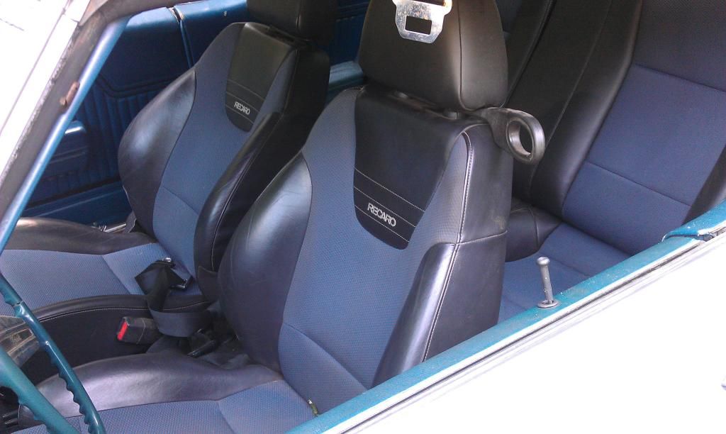

The interior has been installed. I mounted the seats as low aspossible. Im only 5'9" and have 4" of clearance above my head which should be plenty of room.

Love this thing, especially the recaros
WSSix 03-26-2015 10:47 AM
Nice work. Tell me more about them there Recaros , would ya. Thanks

I got the seats from a Saturn ion redline. They should be tha same as the chevy cobalt ss seats. I really like them and they fit me well. They are taller than regular recaros and are not a good fit for most muscle cars.
