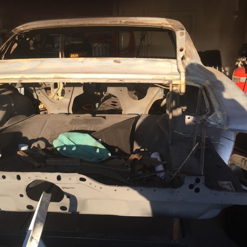

JDODDS187 04-25-2016 06:18 AM
Had a decent weekend, was able to get a few things going. I started off with removing the rest of the quarter panels,and removed the roof
http://i1368.photobucket.com/albums/...ps3mmpikya.jpg
http://i1368.photobucket.com/albums/...pspnj96zgy.jpg
I also had the trunk weather strip channel and hinges braced up so I went ahead and removed the package tray shelf
http://i1368.photobucket.com/albums/...pserf6lpin.jpg
