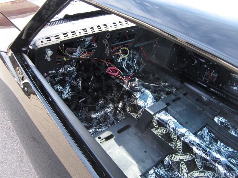

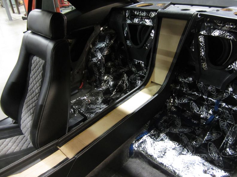

More interior pics.
http://i1299.photobucket.com/albums/...ps2hutglgf.jpg
http://i1299.photobucket.com/albums/...psvca8t2p3.jpg
http://i1299.photobucket.com/albums/...ps05vsiucg.jpg

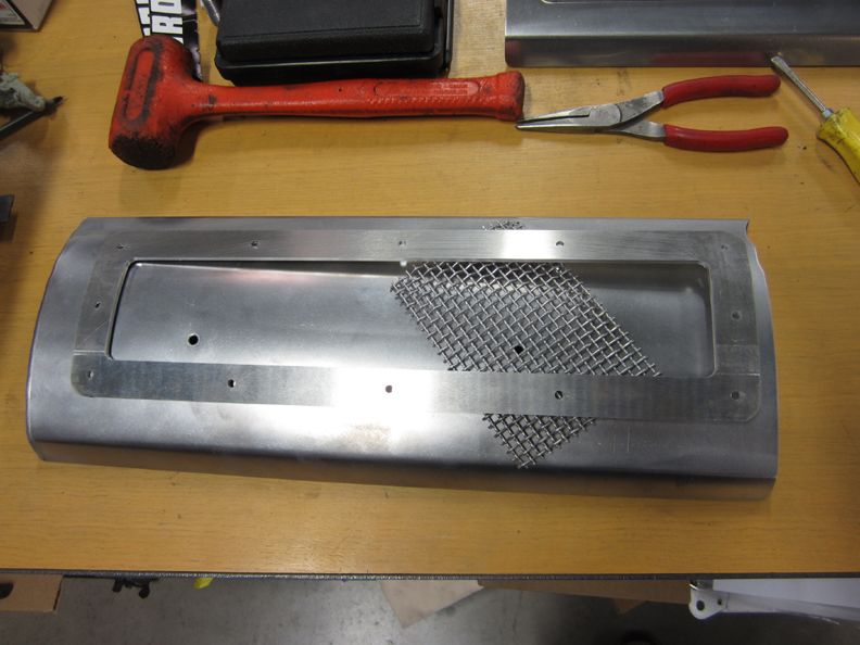

Thanks guys! That valance is by Anvil, and we picked up a sheet of that mesh separately and used it throughout the car.

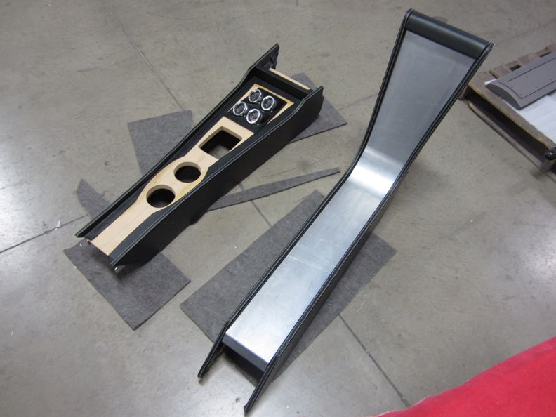

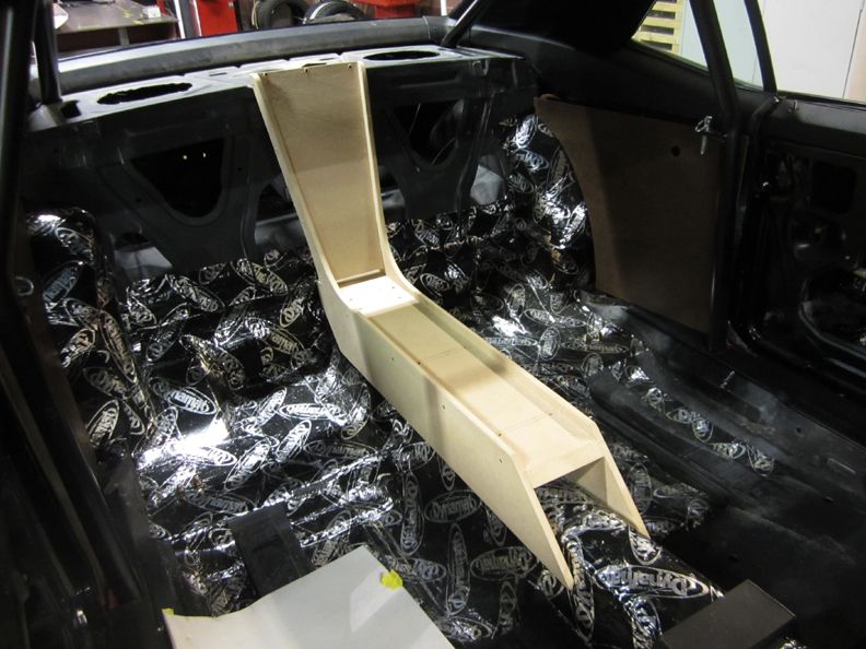

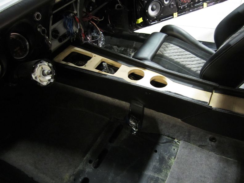

Center console work, for convenience reasons we split the console in two pieces.

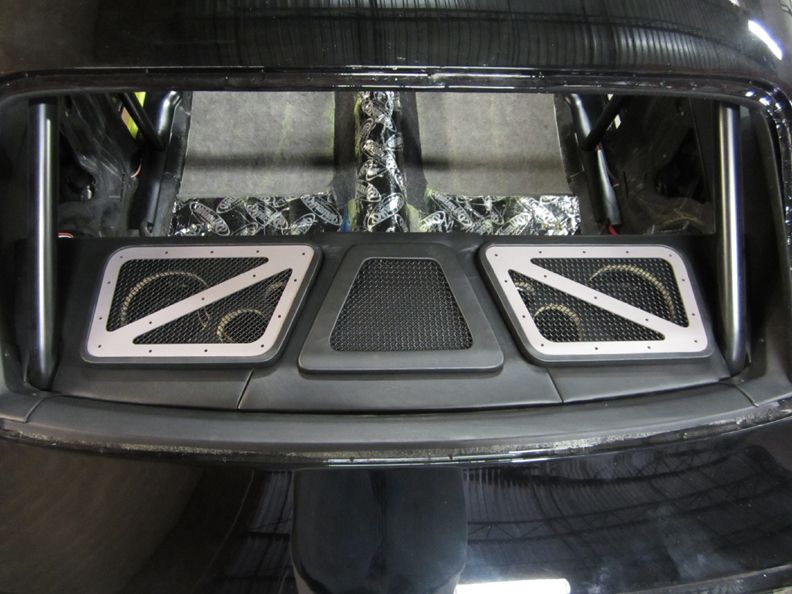

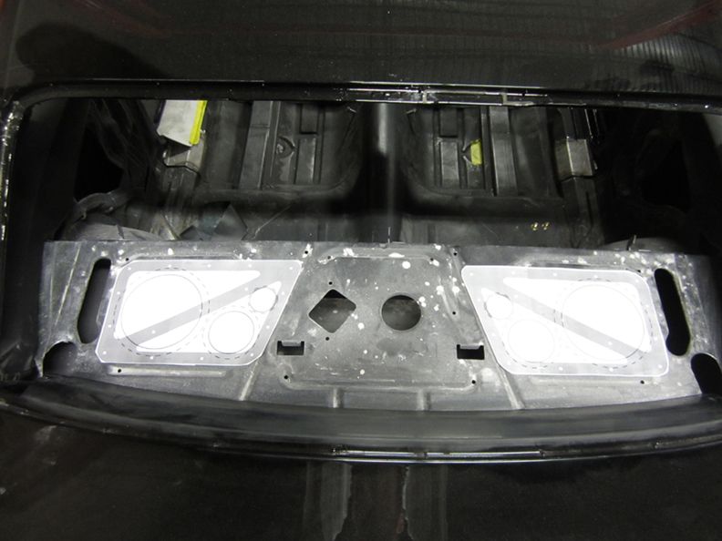

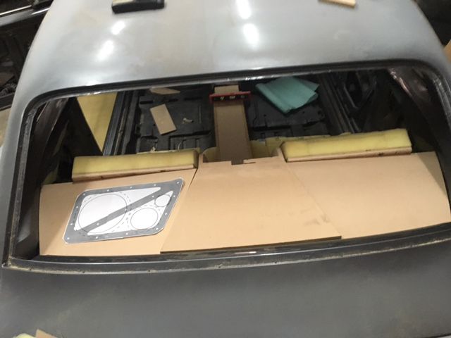

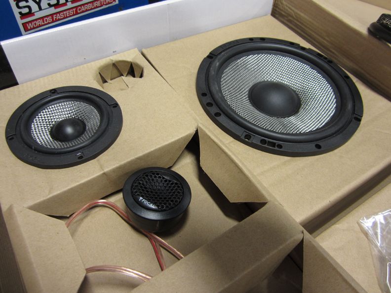

Continuing our theme through the interior we next addressed the rear package shelf. Mock ups for speaket layout were created digitally, test fit and then cut from wood and wrapped or laser cut from sheet metal and powdercoated. We chose Focal speakers for a great sound and they've got a really cool woven texture.

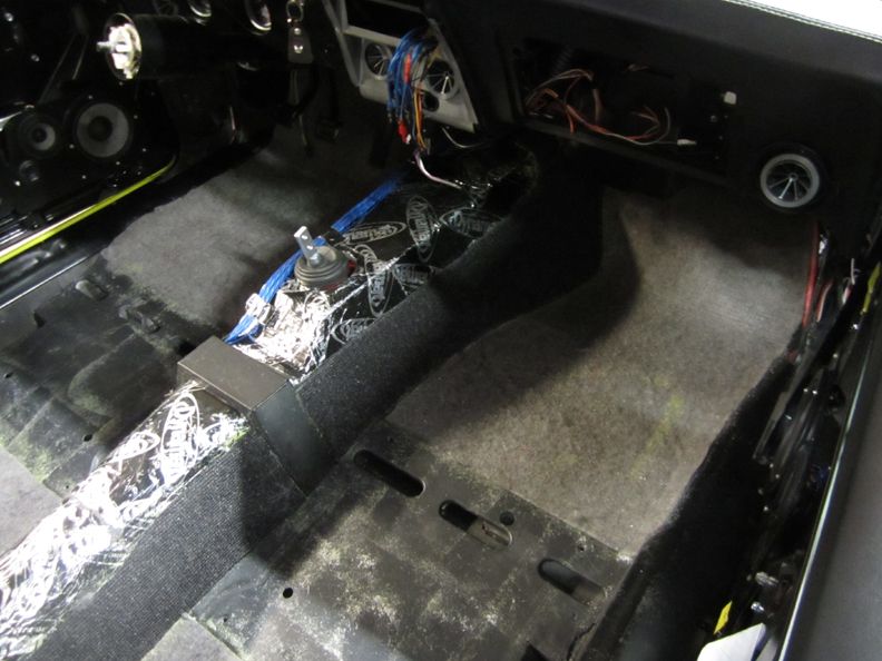

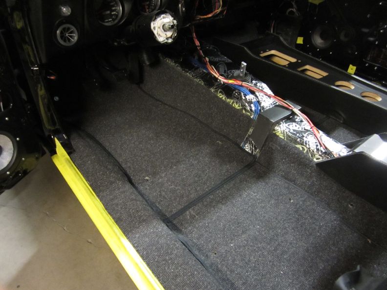

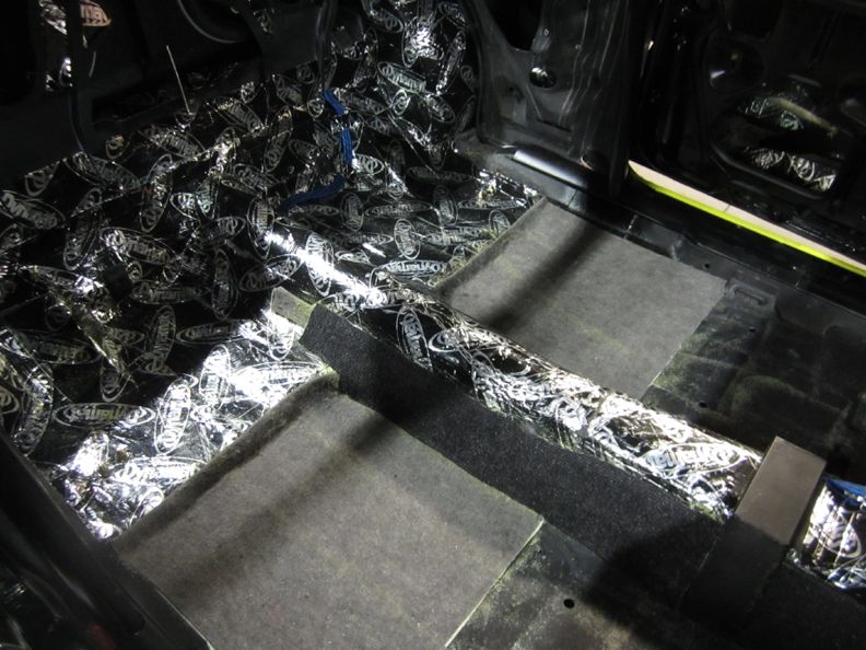

Rather than a replacement factory style carpet we chose to have a smoother look and opted for a custom carpet install. Note how jute padding was used to flatten the floorboards by filling in the bumps and valleys for a super clean look. More coming soon...
http://i1299.photobucket.com/albums/...psipoypk5k.jpg
http://i1299.photobucket.com/albums/...pssuytn6ew.jpg
http://i1299.photobucket.com/albums/...pss7eaboo9.jpg

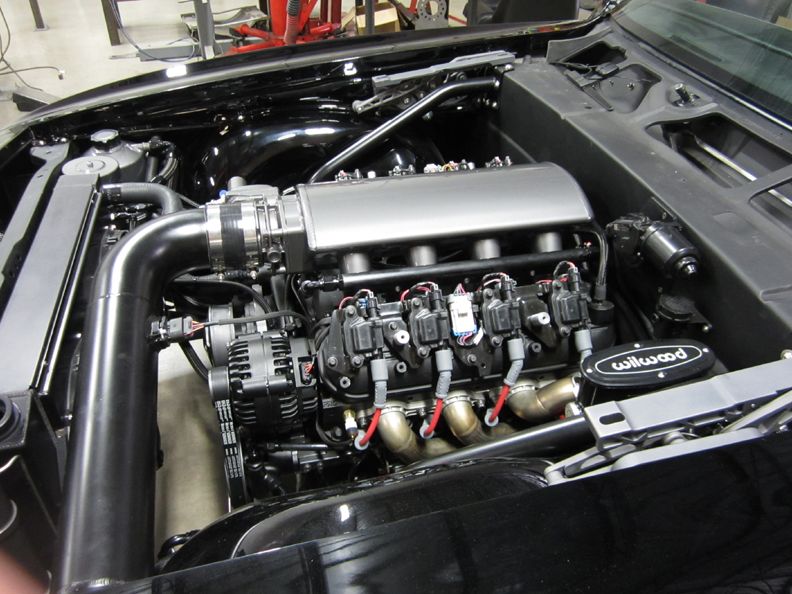

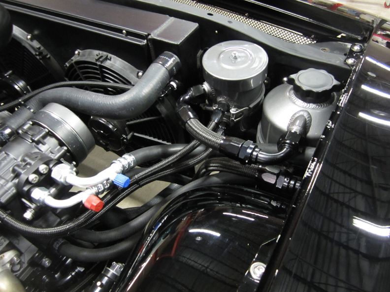

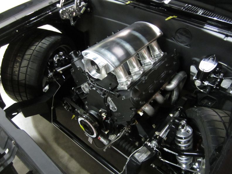

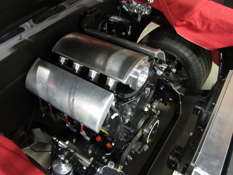

On with the engine bay. Our custom build 720 hp LS3 based Texas Speed engine came to us in a raw finish so a bit of flat black engine paint got it looking the way we wanted. Carrying the outside theme to the engine included a custom set of coilcovers, while all the accessories along with some interior parts were painted to match the exterior stripe. More coming soon...
http://i1299.photobucket.com/albums/...psnqzw5ktr.jpg
http://i1299.photobucket.com/albums/...pstkajf7l6.jpg
http://i1299.photobucket.com/albums/...psdwphodjp.jpg
http://i1299.photobucket.com/albums/...psatkedw5m.jpg
http://i1299.photobucket.com/albums/...psustu1vmz.jpg
http://i1299.photobucket.com/albums/...psixuxllac.jpg
