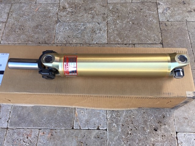

4 Attachment(s)

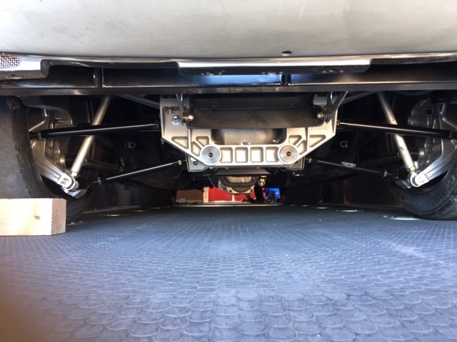

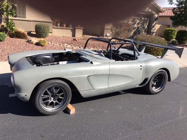

New drive shaft from Mark Williams, new AP racing brakes, and car getting ready to load in the trailer enroute to Ryan Linder for custom stainless steel headers. Motor is now 19 inches behind front axle centerline - that opened a whole can of worms that required a lot of fabrication and slowed me up a little. LOL
Attachment 71555
Attachment 71556
Attachment 71557
Pappy
Edit: Here is a shot of the Decalink Suspension
Attachment 71558
RdHuggr68 03-11-2020 06:34 PM
Which driveshaft did you purchase?
mfain 03-11-2020 07:19 PM
7075 aluminum. At the 18 inch length it was actually lighter than the carbon fiber shaft. As the length gets longer, the carbon fiber starts to have a weight advantage.

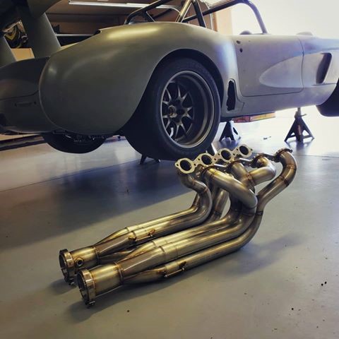

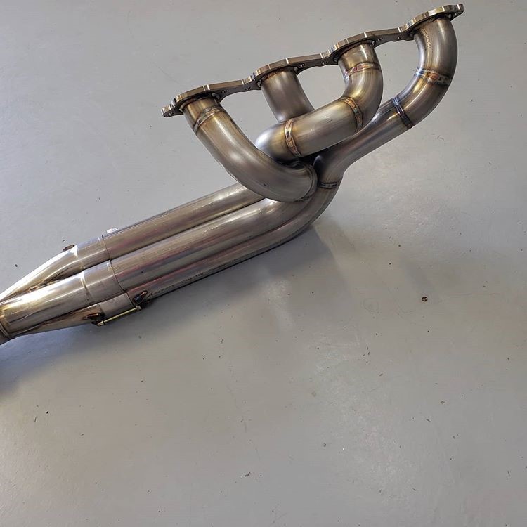

mfain 03-20-2020 08:37 PM
2 Attachment(s)
Ryan Linder (X-1 Race Cars) just finished my headers - awesome work. 2.25" SS tubes, SPD merge collectors.
Pappy
Attachment 71625
Attachment 71626

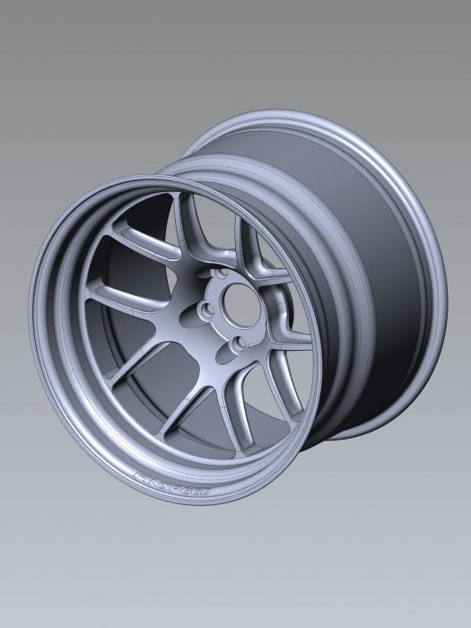

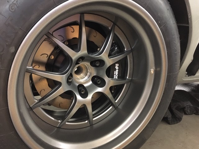

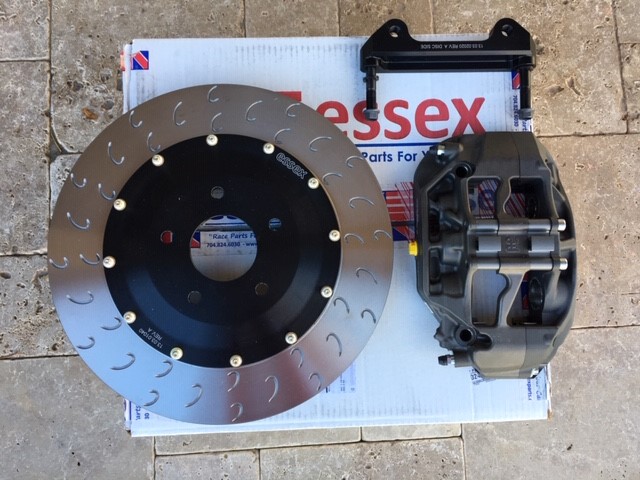

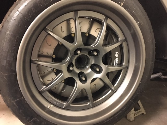

Hope these will stop it! Finspeed is building me a new set of wheels (18X12, 18X13). Had to go to a Corvette DP forging to get the rear backspacing I needed for the DSE Decalink.
