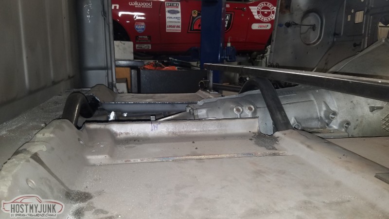

I had hinted at why the chassis cross bars were mounted above the frame rails earlier. The cab has two raised areas in the floor that the tubes line up with. This allows maximum exhaust clearance through the center section. Might even try to incorporate additional cab mounts and seat mounts into them. If you've been paying attention you've seen a couple different pics of engine set back options. I think "The Sweet Spot" has been found, see pic for measurement.

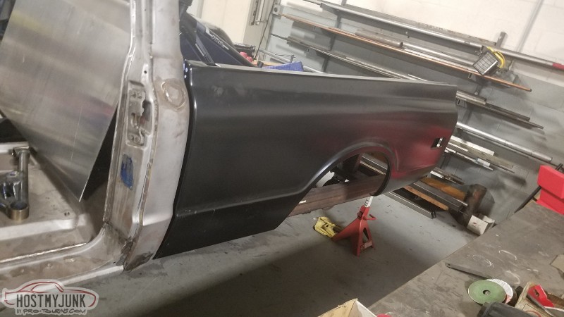

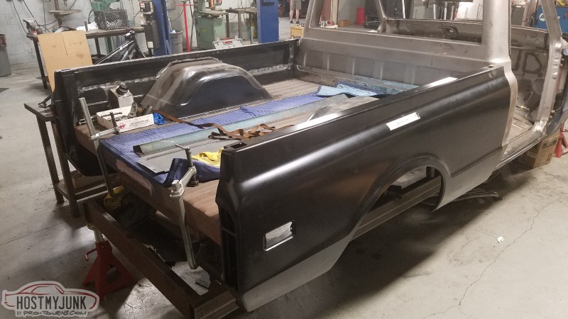

https://i.hmjimg.com/images/2017/12/..._080158.md.jpg Getting the cab and bed perfectly aligned has proven to be next to impossible without bedsides. Started cutting up these brand new bed sides so we can raise the bed floor. https://i.hmjimg.com/images/2017/12/..._073550.md.jpg It's kinda hard to see what's going on here. This is the piece that was cut and removed from the bed side. It is now mounted into position on the bed floor. The driver side will be the same except where the gas filler is currently mounted. https://i.hmjimg.com/images/2017/12/..._125606.md.jpg |

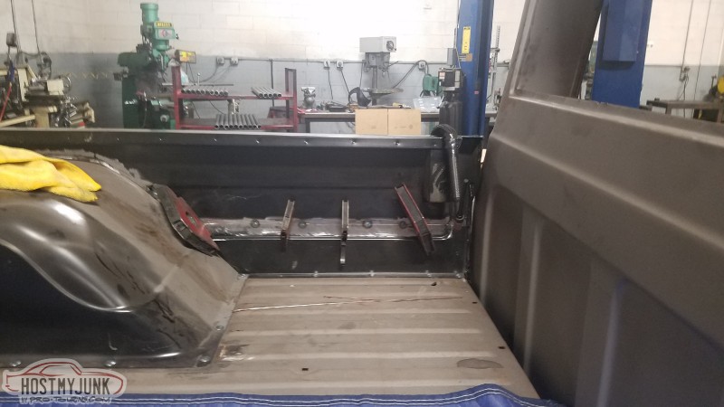

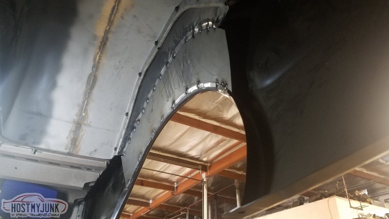

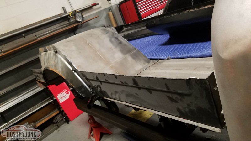

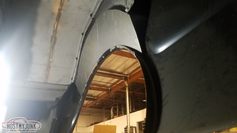

Slowly making progress on mounting the bed sides. I cut a fairly big strip out first and then just trimmed little by little in order not to cut too much. It is a long process but the fitment was perfect. The goal was to keep the factory internal bed body lines for looks and strength. Just kinda sandwiched them closer together. The inner panel will require a little more work once I get the main structure together.
https://i.hmjimg.com/images/2018/01/..._072810.md.jpg https://i.hmjimg.com/images/2018/01/..._125847.md.jpg https://i.hmjimg.com/images/2018/01/..._075716.md.jpg https://i.hmjimg.com/images/2018/01/..._125816.md.jpg |

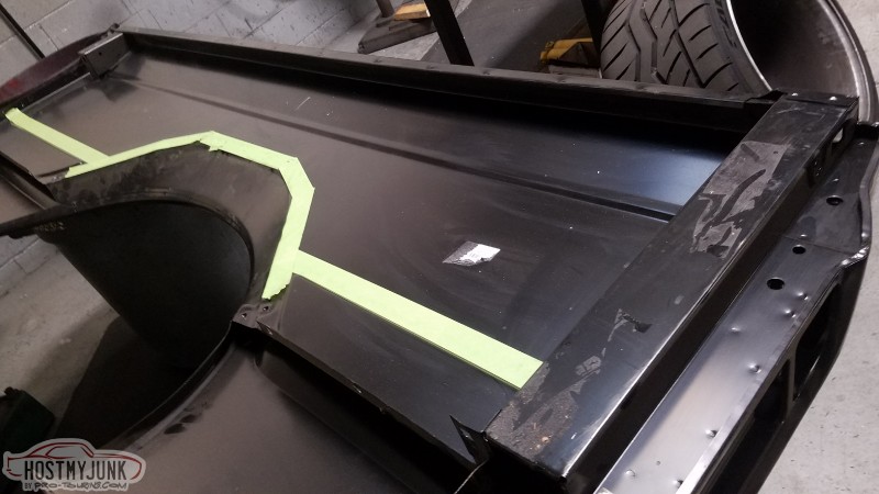

Working on the back panel of the bed.

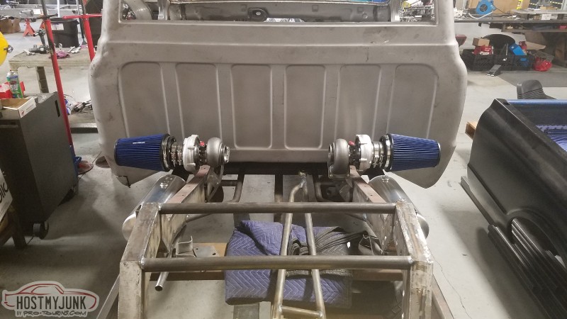

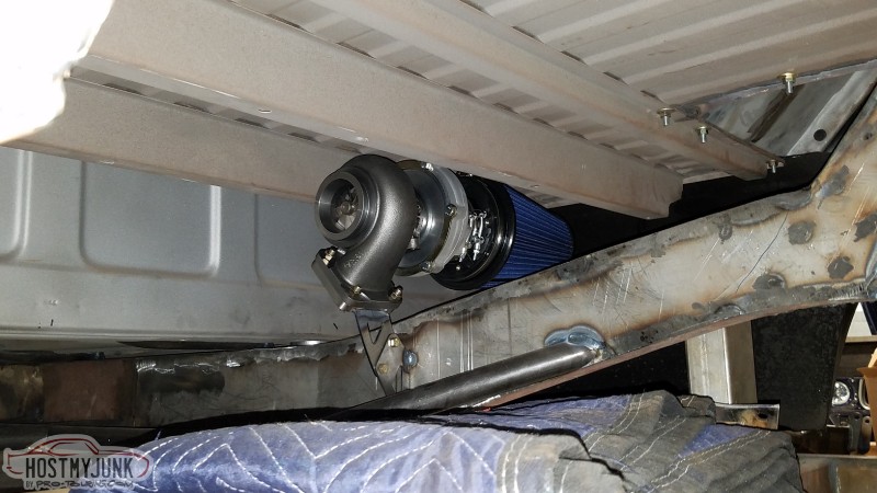

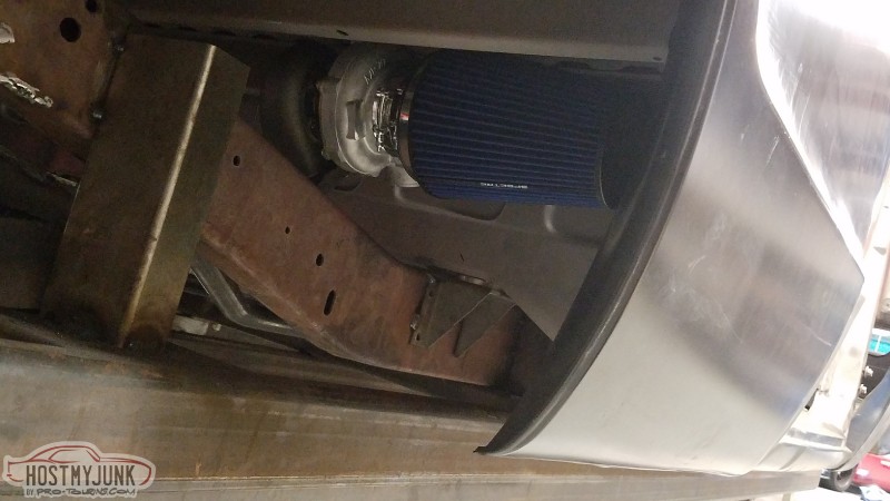

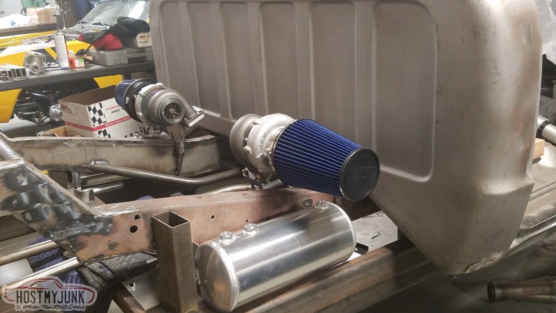

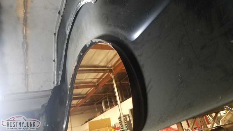

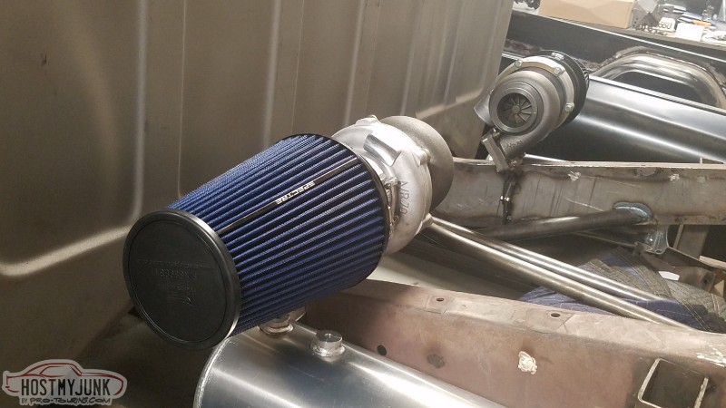

https://i.hmjimg.com/images/2018/02/..._162056.md.jpg Step one of turbo placement has begun. https://i.hmjimg.com/images/2018/02/..._095251.md.jpg https://i.hmjimg.com/images/2018/02/..._131223.md.jpg View from outside the fender. Definitely going to need a close out panel to keep tire debris off. https://i.hmjimg.com/images/2018/02/..._131201.md.jpg |
