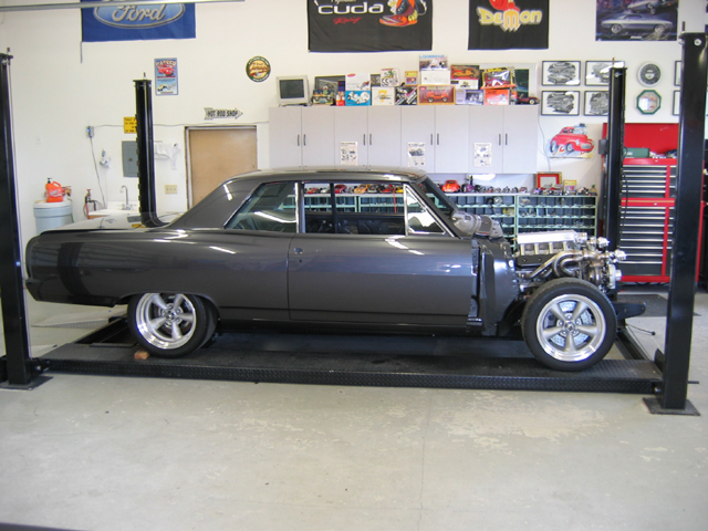

Sorry if I missed it, but what are the motor specs??
CI, heads, CR, turbo(s)??
Amazing looking car.
camcojb 03-24-2008 11:18 AM
402 LS2
Callies crank
Howards rods
Mahle pistons
8:1 compression
ET Performance 240cc CNC heads
Comp cam Smith restricted pushrods
twin Precision T67-76 ball-bearing water cooled turbos
Stang's Bane 03-24-2008 11:23 AM
Originally Posted by camcojb (Post 141985)
402 LS2
Callies crank
Howards rods
Mahle pistons
8:1 compression
Very sweet.
Should do 1K at the crank with no sweat:hail:

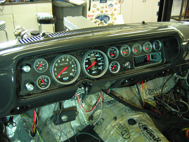

camcojb 03-28-2008 02:05 PM
got the dash in and wired as well as the rear of the car.
http://www.camcojb.com/temp/malitude 345.jpg
Tom.A 03-28-2008 02:28 PM
Lookin good :thumbsup:
GHOSTDANCER 03-28-2008 05:39 PM
:thumbsup:
dodge 03-28-2008 07:17 PM
Droollllll ...damn i like that dash.. well done:hail:

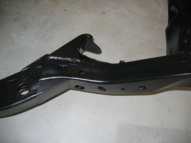

deuce_454 03-29-2008 12:08 PM

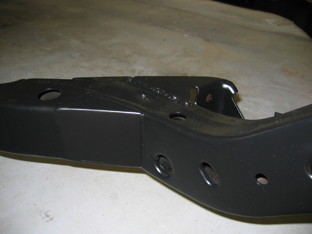

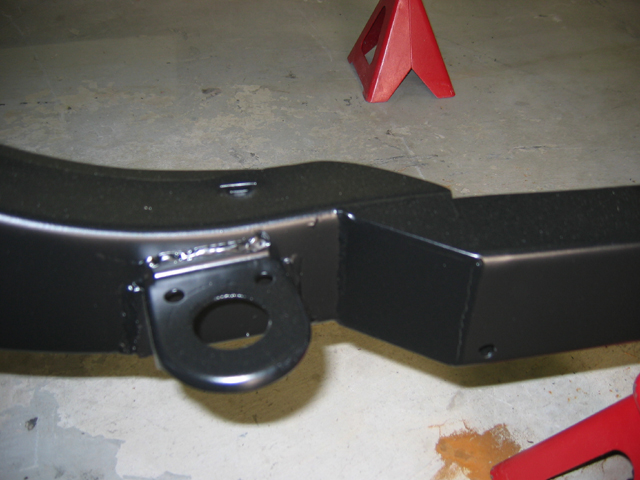

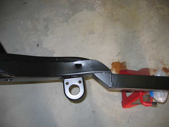

i just noticed your narrowed rear frame... that is somthing ill have to do to my malibu next tile the body is off.. could you post some pics of when you did this, id be interested in seing how the jig was configured..
camcojb 03-29-2008 01:48 PM
Mark Stielow did it when he first built the car.
http://www.camcojb.com/temp/malitude%20128.jpg
http://www.camcojb.com/temp/malitude%20129.jpg
http://www.camcojb.com/temp/malitude%20130.jpg
http://www.camcojb.com/temp/malitude%20131.jpg
http://www.camcojb.com/temp/malitude%20188.jpg
ZZ3ElCamino 03-29-2008 01:50 PM
Hey Jody, where did you get your CF dash insert?
deuce_454 03-29-2008 02:16 PM
Nice... it really seems like a dooable job... and so much more worth it than the regular g-body frame notch... ir feems like all one would need to do is weld a square frame under the rear frame and relocate the rails inwards..
I've got the Popular HotRodding issue where Mark narrowed the frame. I'll have to scan it in some time for all to see.
I know Jody get's asked about it a lot. ;)

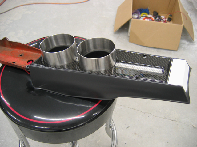

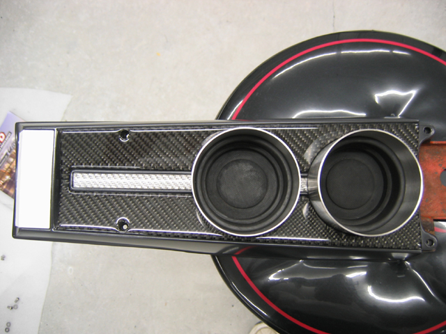

I had some carbon fiber stuff done from Wabbits
http://www.wabbitsww.com/
They did some custom inserts for my console. The consoles are originally chrome plated, and mine had been powdercoated silver like the header coating. I had it painted the dark gray of the dash and engine compartment and then added the carbon fiber. Here's a sneak peak of the rear section of the console, with Mark Stielows custom stainless cup holders added. I'll post up full pics when it's done.
http://www.camcojb.com/temp/malitude%20367.jpg
http://www.camcojb.com/temp/malitude%20368.jpg
http://www.camcojb.com/temp/malitude%20369.jpg
I also had them do my steering wheel ring in carbon fiber; I really like the way it looks with the Twist Machine paddle shifter.
