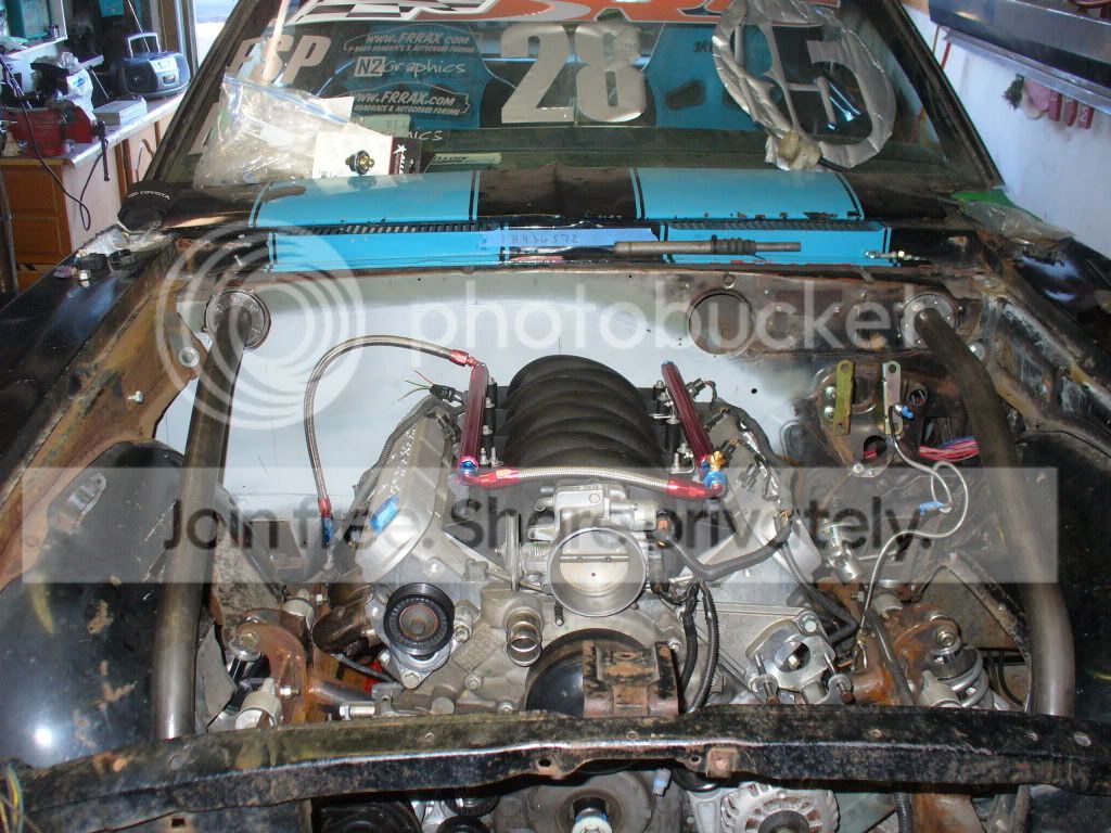

on a good note, I did get to change the brakes and get the ducts installed, maybe next time I'll be able to stop before I take out a manhole! I'm not happy.....
http://i539.photobucket.com/albums/f...psaac03114.jpg

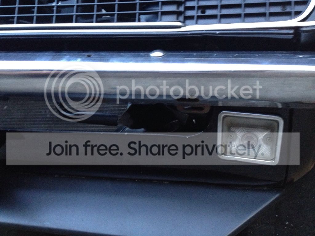

As you can see from the pics, it took a direct hit on that front corner. From what I can see so far it did twist the k-member. The rear mount on that arm is about 3/4 higher than the other side and there is a buckle in where the cross member ties into the main frame. I think it would pull out, I just don't have any way to do it. None of the shops I talked to want to touch it. My Buddy at Maaco Hampton said he would do it, but I got to get it over there to him, he's about an hour from here. I'm going to try and do that tomorrow. As if it couldn't get any worse, it slipped off the jack yesterday and broke the steering rack! Autozone is cool about it though and is swapping one out for me under warrenty, just waiting on it to get here.
At least it's sunny and my garage got a lot bigger!

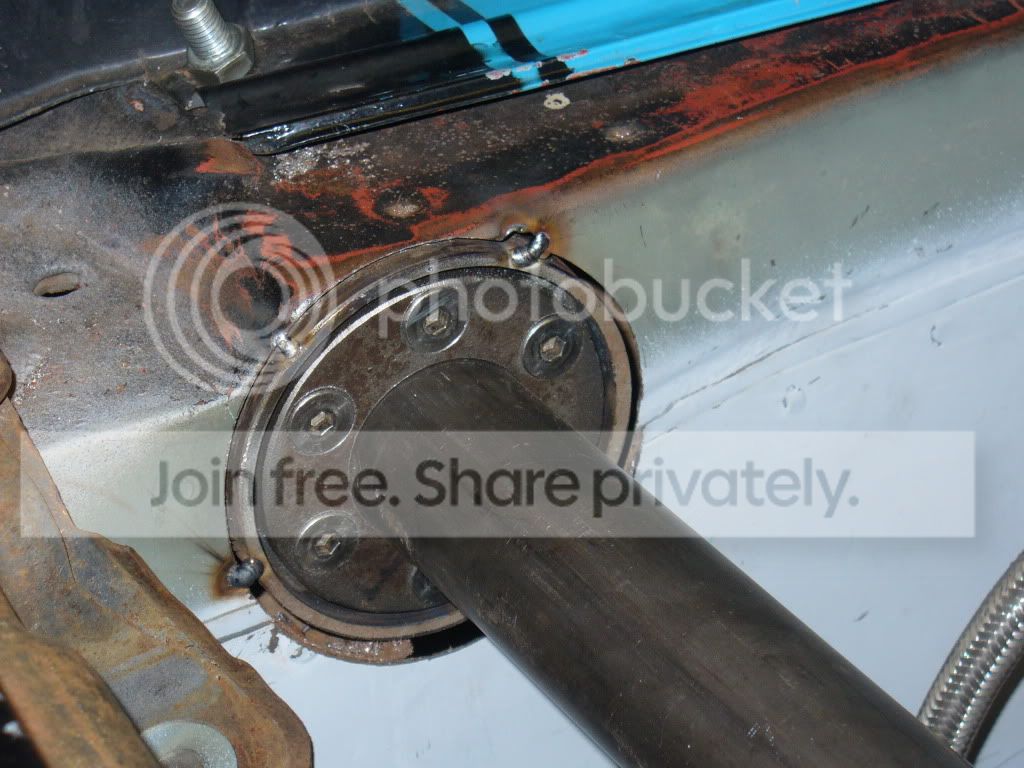

Here's some update from the last couple of months. I've done 3 more AutoX days since I came back from CMP. I've been slowly dialing the car in and it's getting faster and I'm learning how to drive a 2900# car with 407HP! I swapped out the front springs to a little beefier 550 pounders and the car was better. So I decided to soften up the rear some by changing out the sway bar. Most people told me to just take it off, but I wanted to see if making it softer made the changes in the right way first. Problem I'm having is that the car is very loose in the corner and corner exit is really hard to put down any power. I'm taking the car to VIR in July for its HPDE3 debut.

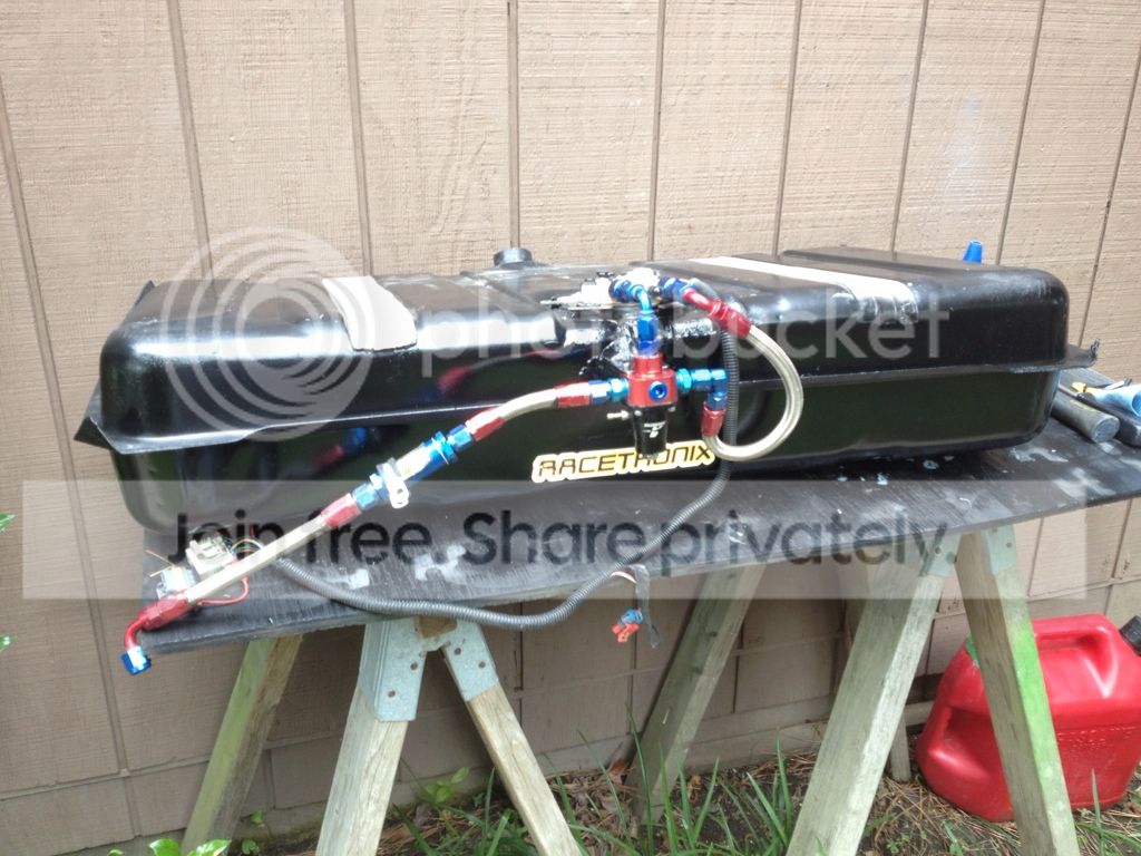

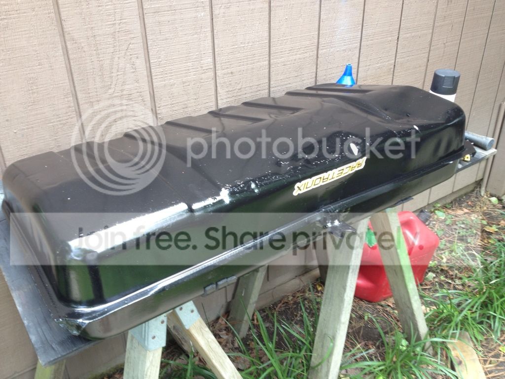

I'm softening up the rear sway bar with a smaller one. 26mm down to 21mm. Since I had to pull the gas tank to change the bar, I'm fixing a small pinhole leak by resealing the tank from the inside. Dropped it yesterday and pulled all the pump assembly out and poured in some Eastwood tank sealer. Just pour it in and rotate the tank around and it leaves a nice liner when it drys out. then I painted it before I reinstalled it. after all the paint drys I'll put it all back together.
http://i539.photobucket.com/albums/f...ps9f40a1c2.jpg
http://i539.photobucket.com/albums/f...ps53074848.jpg
Sway bar is in
http://i539.photobucket.com/albums/f...ps818642a2.jpg
Tank is back together and in
http://i539.photobucket.com/albums/f...ps740720fb.jpg

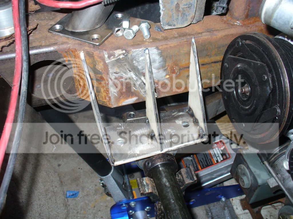

Beach Cruiser 07-22-2013 03:06 PM

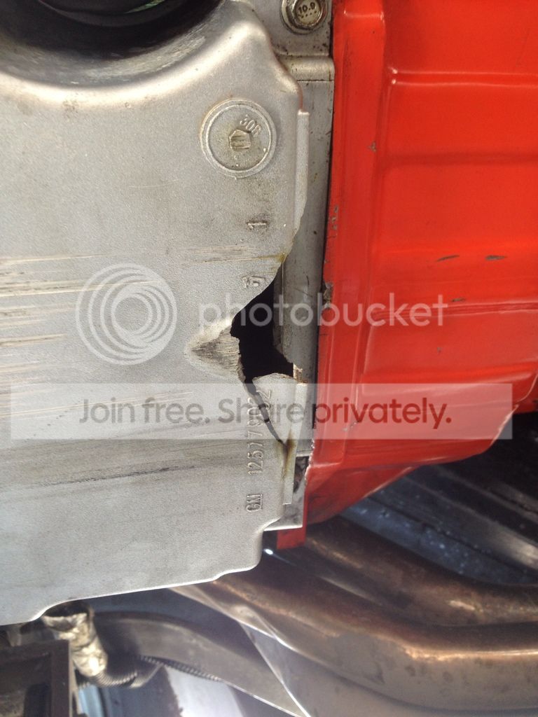

Well I'm back from a pretty bad weekend. On the first session the car was flying! It seems that I've finally got the suspension dialed it almost perfect. It keep getting faster and faster and I was passing people left and right. It really flys on the back strech too! So the gearing is just about right for VIR. (sucks for autoX though).
However... at the end of the first session I went into turn 10 about 120mph behind a Miata. He Breaked and so did I but the pedal went to the floor! Oh ****! I went to the left off the track to avoid hitting him, I tried to stay off track to the left because turn 10 is a left hand turn. Well turning in the grass at that speed with slicks doesn't work so well so I went back across the track in front of the Miata! (yeah, pass in the grass style) but I clipped his left front with the right rear of my car. No body damage to me though. I went off track on the other side and all the way down the hill to the Oak tree turn (Its a long ways) I finally stopped and still had no brakes. Smoke everywhere! started to hear the motor making valvetrain noises and I looked and had no oil pressure! Oh ****! So I get the motor turned off and gather my senses cause I was shaken pretty good. I'm not allowed to get out of the car until the track is cleared and the wrecker shows up. when I get out I look back and see about 200 yards of tire tracks with a nice oil slick in between all the way down to me! Oh **** number three!
After I got my Haul of Shame back the paddock on the wrecker and went through all the checks because there was contact I was able to figure out what happened to the car. I sheared a bolt on the upper swaybar link on the rear. The link fell forward and when the suspension compressed it Sheared the left rear brake line. Going across the track in front of the miata apparently got the Oil pan. My weekend was done at 10:30 on Sat AM. Oh well...
Heres the pan

Yes that was a Pucker moment for sure! Anyone that goes off left at VIR on turn 10 ends up in the tirewall, somehow I avoided it and no one got hurt. No warning at all, hard brake pedal at the last checkup spot, then nada! I was bouncing off the gators for the first time that session going up the up hill esses, that may have been what sheared the bolt because there is no braking from the 1st gator to turn 10. The fix is easy and cheap if the motor didn't get hurt while I was trying to gather my senses not realizing that there was no oil pressure or any oil in the motor and it was still running at the end when I finally came to a stop. I'm sure a picture or some video will surface within a week or two, if it's not to shaming, I'll post back up. no body or suspension damage to the car that I've seen so far so hopefully it's an easy fix. And the miata guy was cool, his car already had right front damage and he barely tagged me, not even hard enough to leave a scratch on mine, only some red miata "residue"
WSSix 07-22-2013 06:59 PM
I'm wondering if there's a way to safety wire/harness the sway bar so that it can't drop down should you shear another bolt? I'm guessing no since the end needs to pivot and I bet it didn't have to move far at all to cut the brake line but I'm just thinking out loud.
Beach Cruiser 07-22-2013 07:05 PM
Yeah, I'll look at that, but safty wire would not fix a sheared bolt. And no it didn't have to fall far things to go wrong. I'll take a picture of it when I put it back together. Parts are on order.
Gae, The sucky part is that I was in line for a TT checkoff ride on Sunday to move to the next level, but no car means no checkoff ride... :bang:

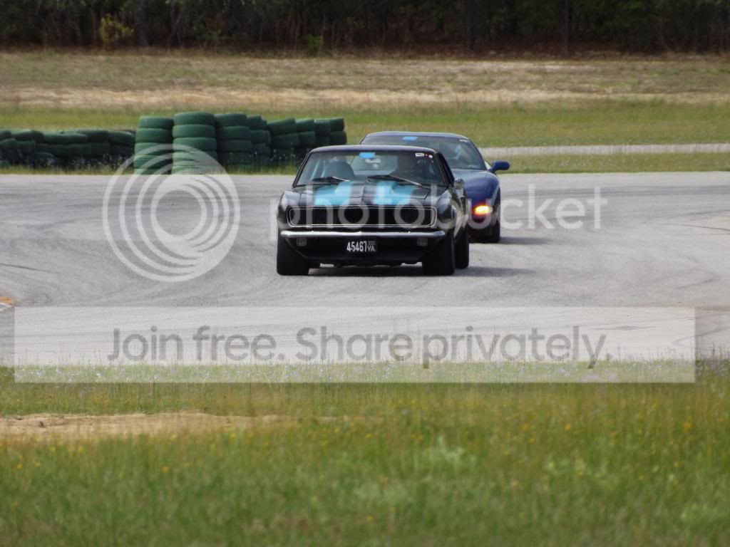

Beach Cruiser 07-28-2013 04:06 PM
Some Really good Pics before it went away!
Running down some Nissans!
http://i539.photobucket.com/albums/f...ps0153b141.jpg
Beat up by some Porshes!
http://i539.photobucket.com/albums/f...ps9326bdbe.jpg
Finaly some clear track!
http://i539.photobucket.com/albums/f...ps724e1313.jpg
Boogety Boogety!
http://i539.photobucket.com/albums/f...ps9debae5f.jpg

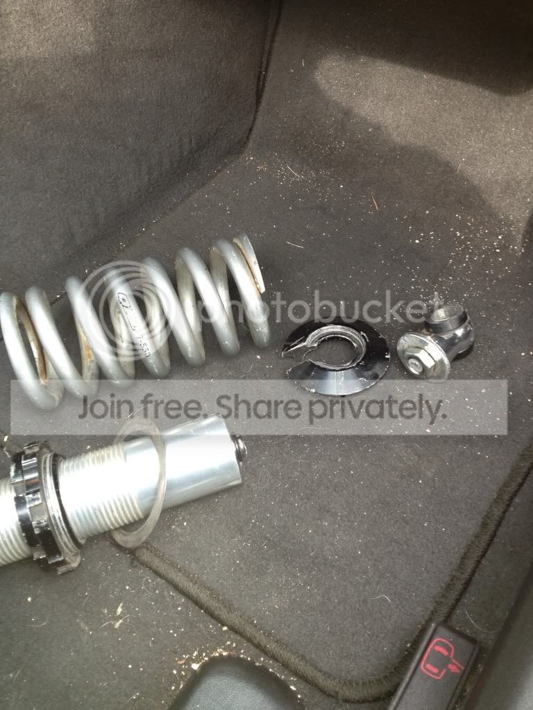

I may redo my coil over design over the winter, I'm working on something really cool!
Tell me what it is, tell me, tell me...... LOL
DETON8R 12-06-2013 07:35 AM
Was the shock failure from the sway-bar mount/brake failure and resulting off road driving incident? Looking at the photo, it looks like there was an impact mark on the frame rail adjacent to the shock. Normally that only happens with the extreme force of an impact.
Keep the pics of the redesign coming, every design can be improved.
Beach Cruiser 12-08-2013 06:14 AM
That impact may have contributed, but the shock actually broke about 4 months later. I think it was a result of the top cup being in a bind with that allen head bolt you see up top. I had it "Clocked" so the slot was in the interference area but it must have moved. I've now changed up the bolt and there's no way it can iterfere. Yeah that impact tore up a bunch of stuff! I keep finding them everyday! Car is in the garage for the winter, I'll comb through the whole thing before race season starts up.
