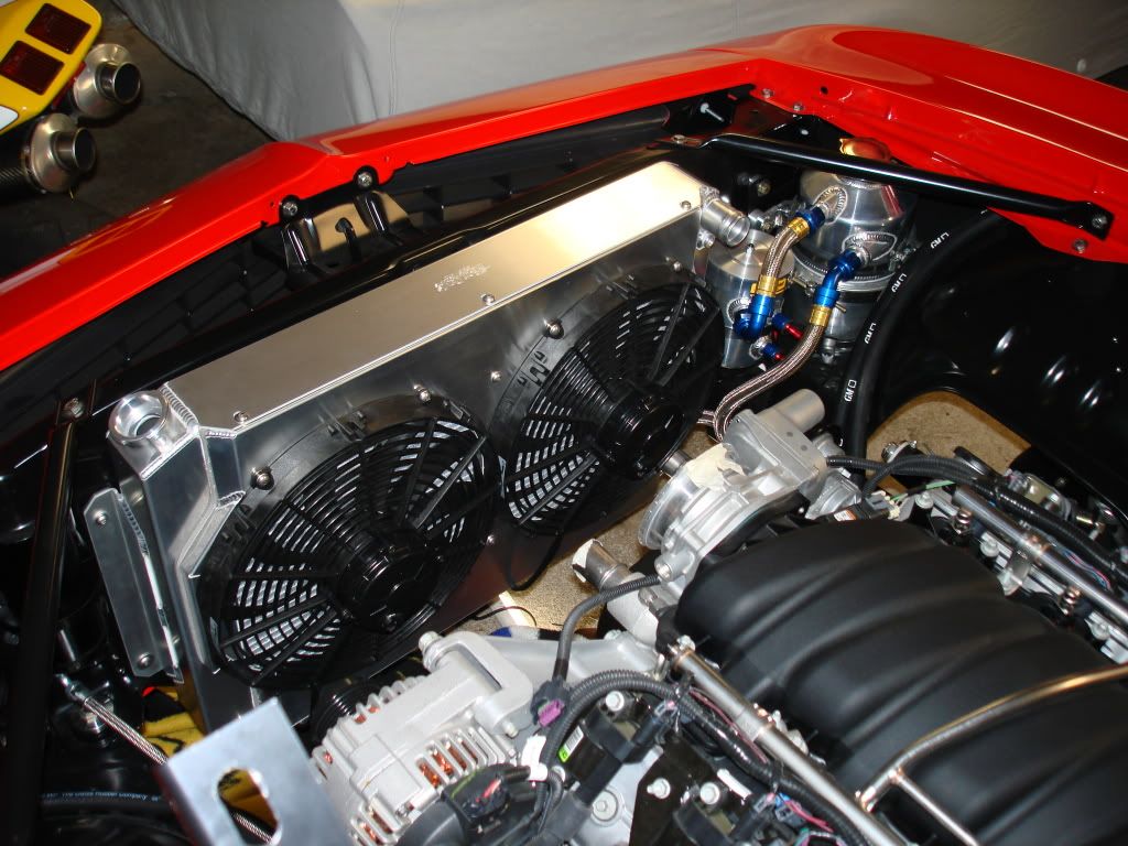

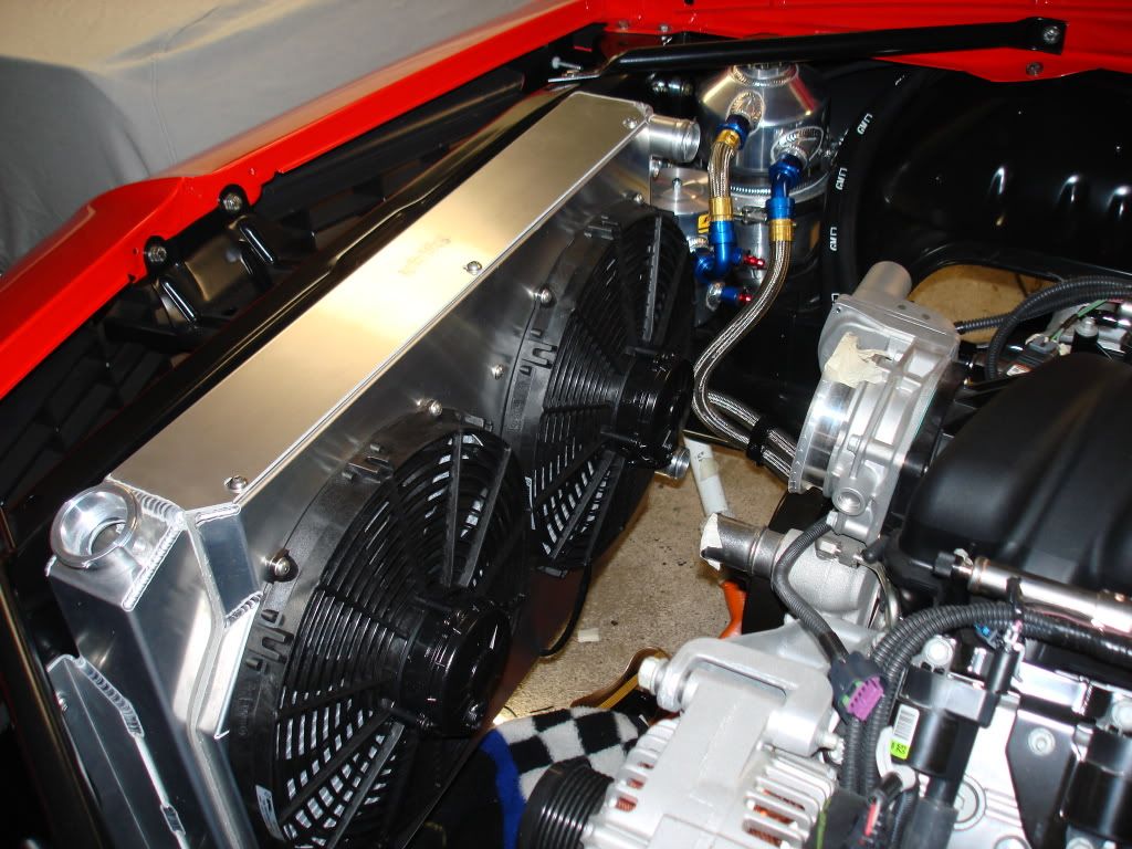

A little closer and almost done plumbing. Here's some Ron Davis porn and dont forget Mike's(MuscleRodz) tanks in the corner. I filled the core support from one end to the other.
http://i168.photobucket.com/albums/u...Picture031.jpg
http://i168.photobucket.com/albums/u...Picture032.jpg
http://i168.photobucket.com/albums/u...Picture033.jpg
Rich

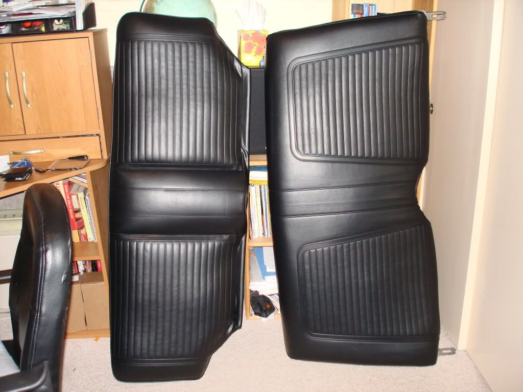

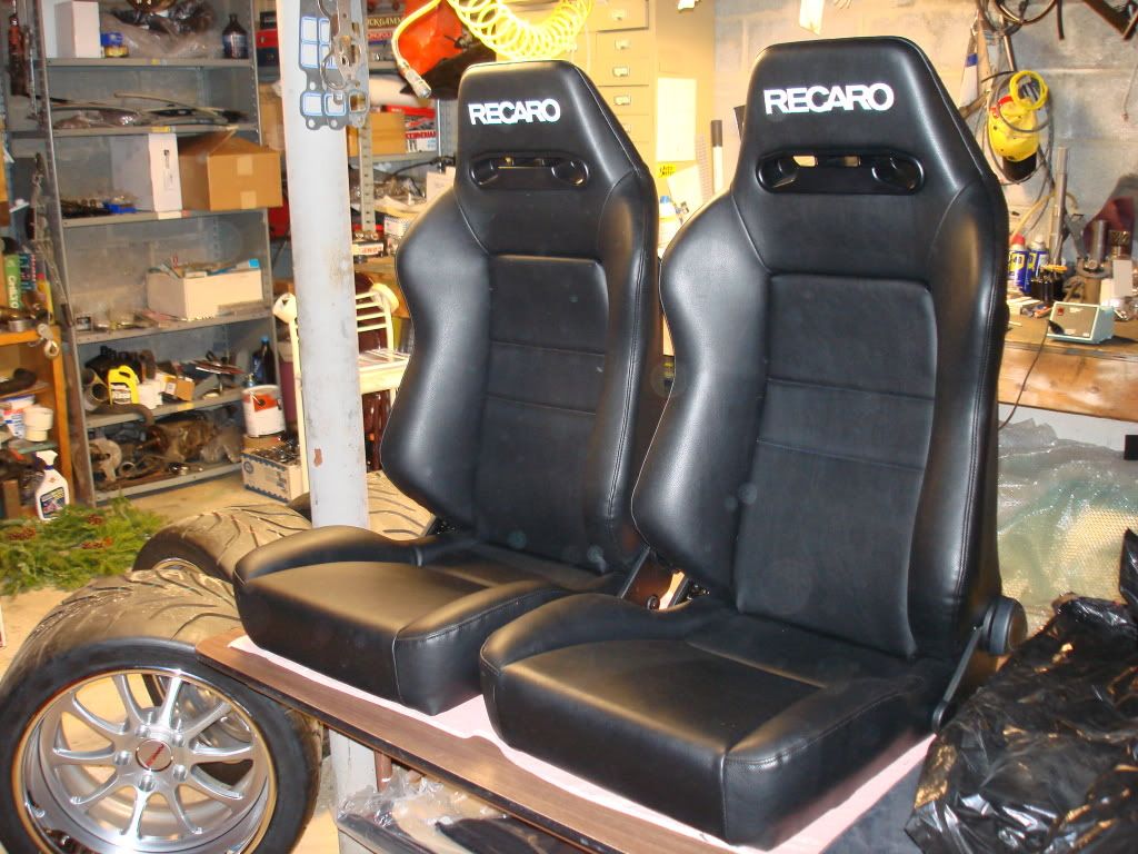

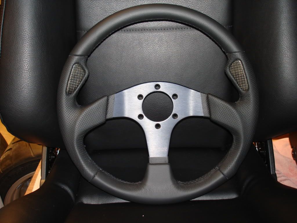

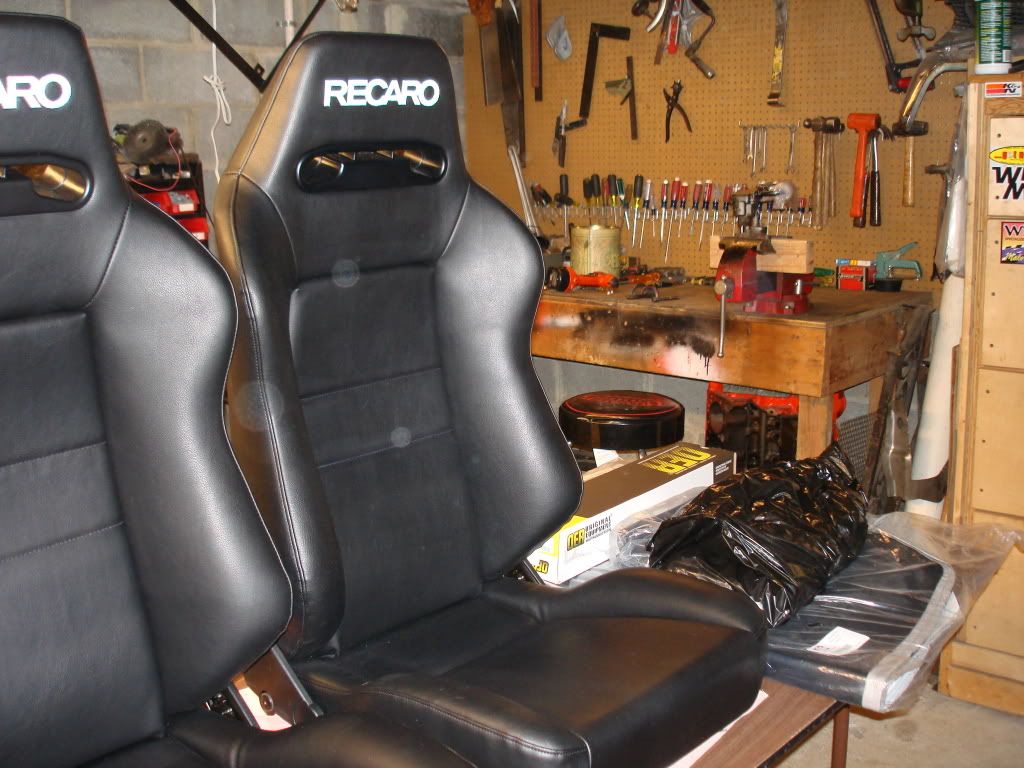

Thanks guys, Im feelin the auto porn so here's a few more. These are the seats and wheel going in the car, stock back seat, shifter through the floor and done.
http://i168.photobucket.com/albums/u...Picture035.jpg
http://i168.photobucket.com/albums/u...Picture036.jpg
http://i168.photobucket.com/albums/u...cture042-1.jpg

Awesome looking seats. Keep us posted.

the car is coming along very nicely. I just read the whole thread and am wondering about the steam vent mod, what is it? I have never heard of it.
Another piece I am wondering about is the dry sump tank, that is from muscle rodz?
67ragtp 11-27-2010 11:36 AM
Kevin, Thanks,
Im not an expert on LS engines, but I believe they vent off steam from both head water jackets and plumb it back to the radiator. Instead of bringing a hose all the way back to the radiator I dump it back in to the upper radiator hose at the water pump. It just makes for a cleaner install and not having hoses running all over.
The two small black cylindrical tanks on the drivers side of the core support were fabbed up by Mike(MuscleRodz) one is a power steering reservoir the other is a radiator overflow tank. These were his prototypes, he did a nice job on them and I like the black anodize. Dry sump oil tank in the passenger corner.
Hope this awnsers your questions- Rich

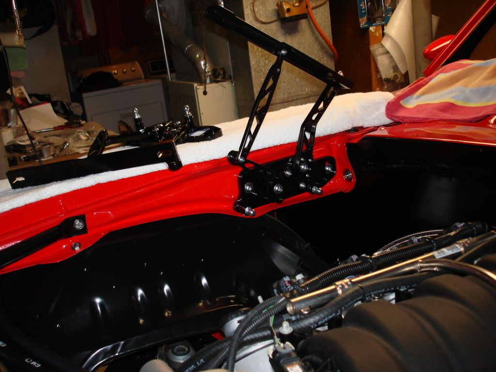

I tried to be strong, the hinges were just to sweet. Went for the black ano.

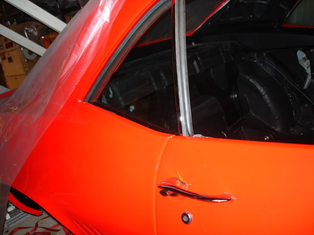

Made some progress, got the rear window regulators in and door handles/locks. Had to weld the seat back braces in and hopefully wont have to take the Mig torch out again, aint no fun welding with fully painted panels all around. Probably not smart but I covered myself and the welded area with a big blanket to prevent spatter from destroying my paint. After I modded the rear seat I had the guys at Creative auto interiors in Butler NJ cover the frames for me, they did a nice job. I decided Im going to do the headliner myself so I fitted the bows and all the little screws so I can find them once the headliner is hung. Also decided to get new window regulators for the front door glass, hope it helps tighten things up.

Very nice Rich. Good call on those hinges. They look awesome with that paint.:thumbsup:

Nice progress Rich, donated another pint of blood I see, Sweet. The seats came out nice. How was it adjusting the back windows?

Wayne- Those hinges are least 4 pints, The back windows are pretty easy, Im getting use to it now after doing the 67. I will do the final adjusting when I get the front window regulators and adjust the two pieces of glass together.

As nice as it looks under the hood with the hinges, hardware, and that motor are you really going to use those stock fender braces. Just a few pints more.:lol:

Jason - More than likely I will get different ones. Haven't found one that I like yet. Really not crazy about carbon and many of the alluminum billet look real bulky to me. Would be cool if Ring Bros had something classy to match the hinges. Probably end up with the DSE braces.

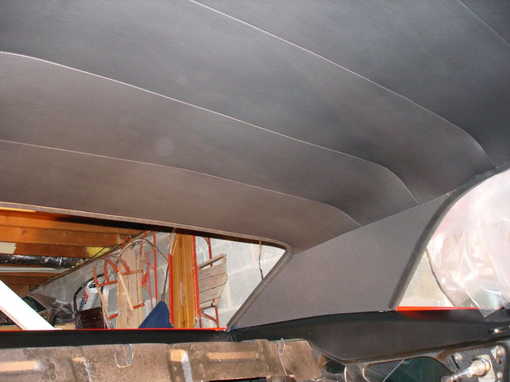

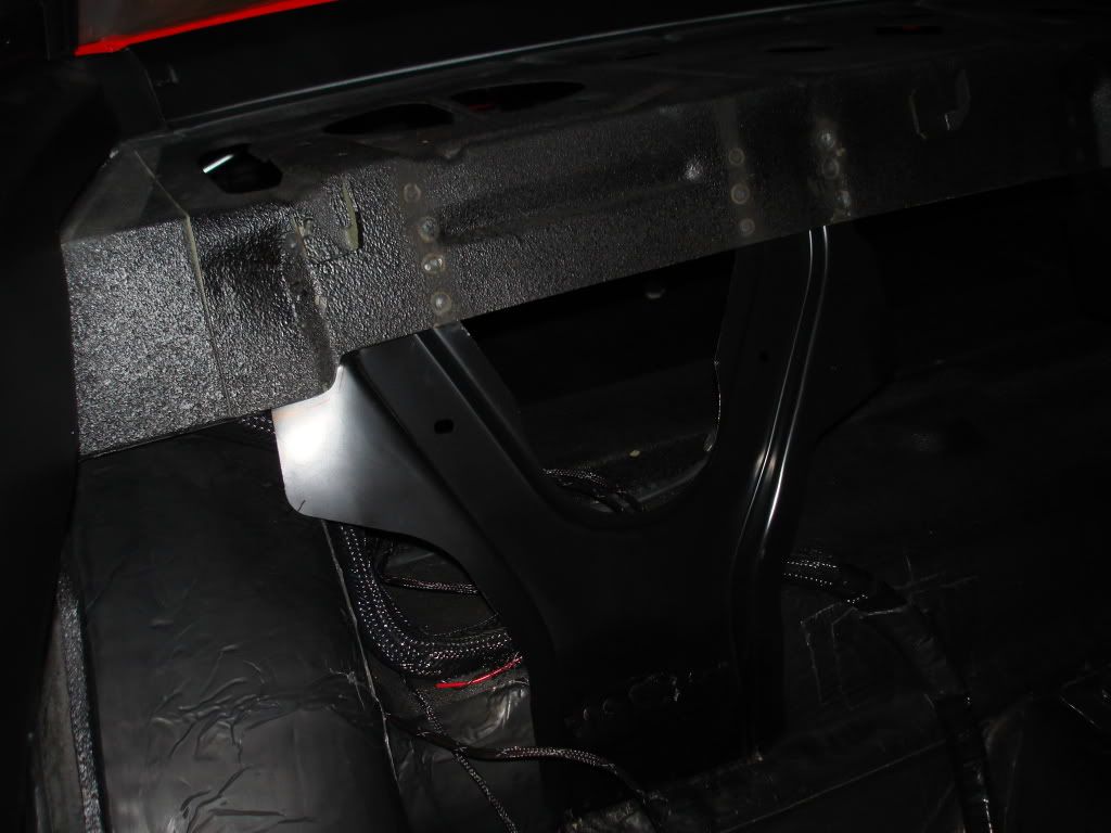

67ragtp 01-25-2011 07:43 PM

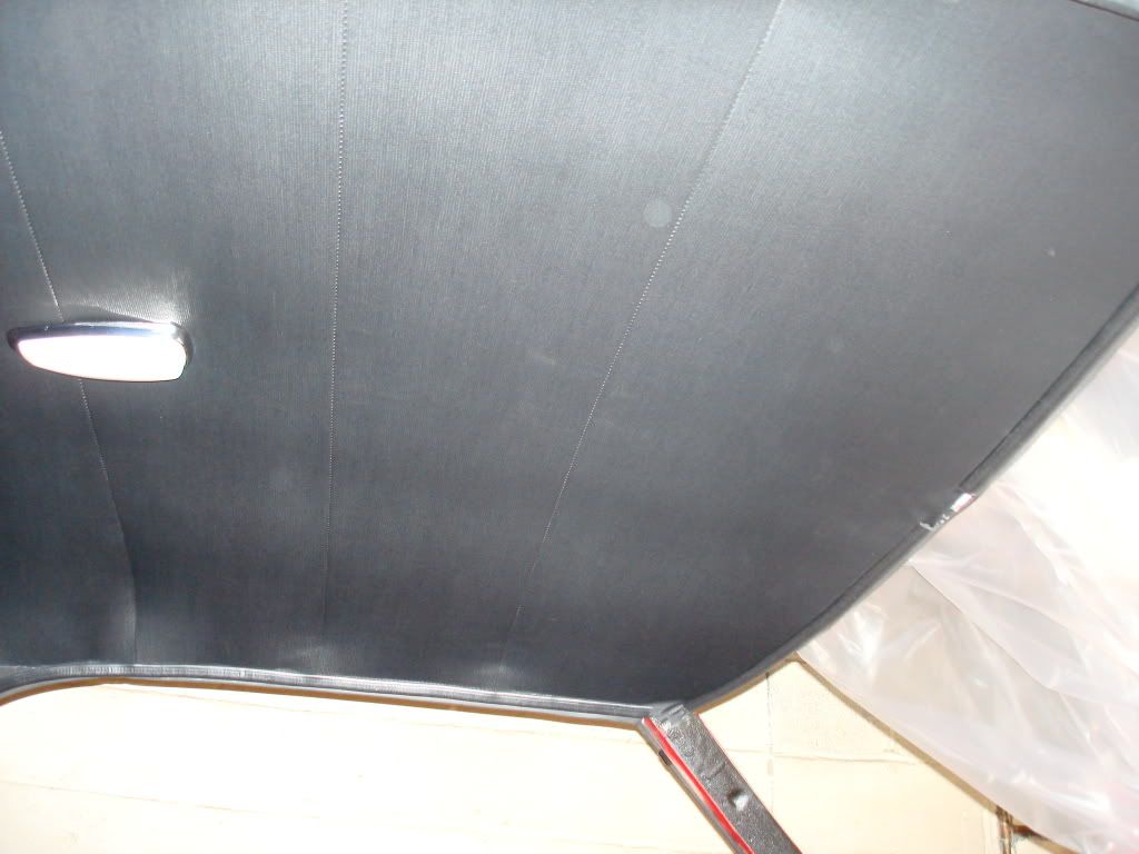

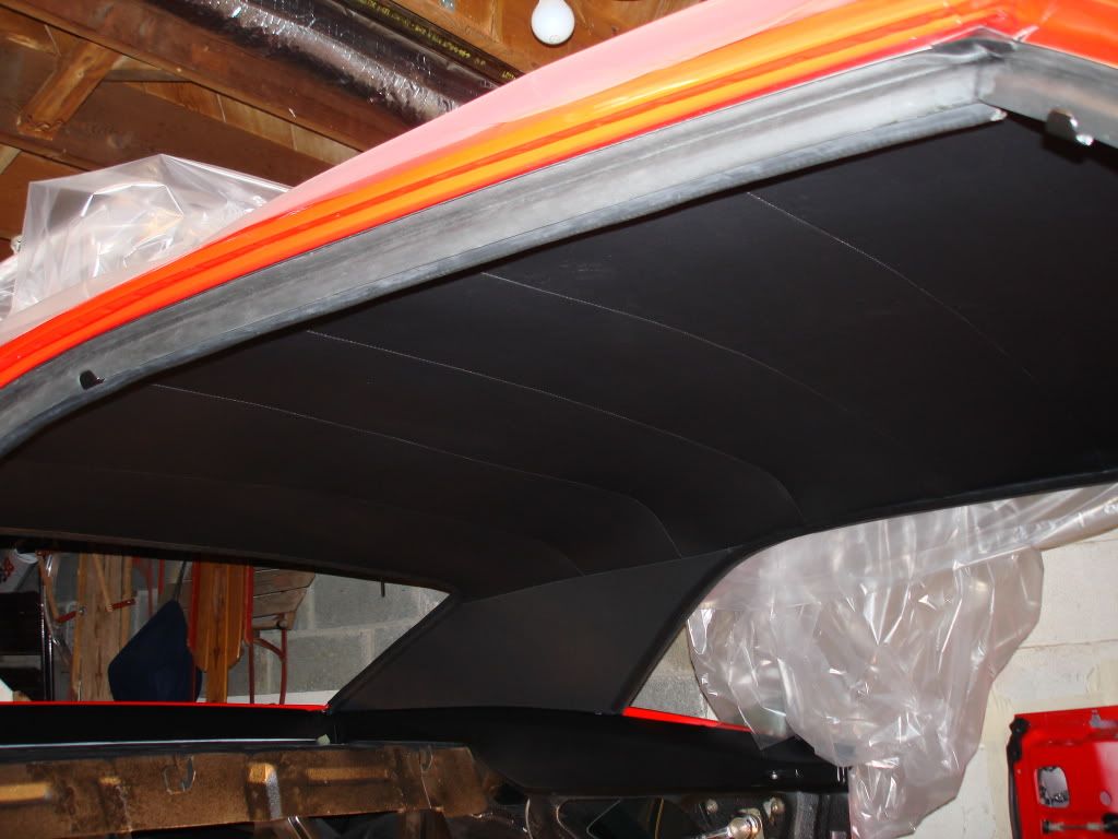

Tackled the headliner over the last couple days, thankful to have this job behind me its a big one. Im very happy with how it came out, its my second one. My wife really helps me with this stuff, Im a lucky guy, she has a great understanding of fabric/stiched stuff and very helpful. She would kill me if I posted a pic of her, so I told her I got one of her tugging on the headliner from the back. In my area of jersey they are getting a grand to do this, so Im extatic to have saved a bit. The dash pad will be the next hurdle , I had to get a OER repro since we started with nothing on this build, Im really thinking it aint gonna fit so good, keep my fingers crossed and ill let you know. - Rich
http://i168.photobucket.com/albums/u...cture084-1.jpg
http://i168.photobucket.com/albums/u...Picture103.jpg
http://i168.photobucket.com/albums/u...Picture100.jpg
http://i168.photobucket.com/albums/u...Picture097.jpg
