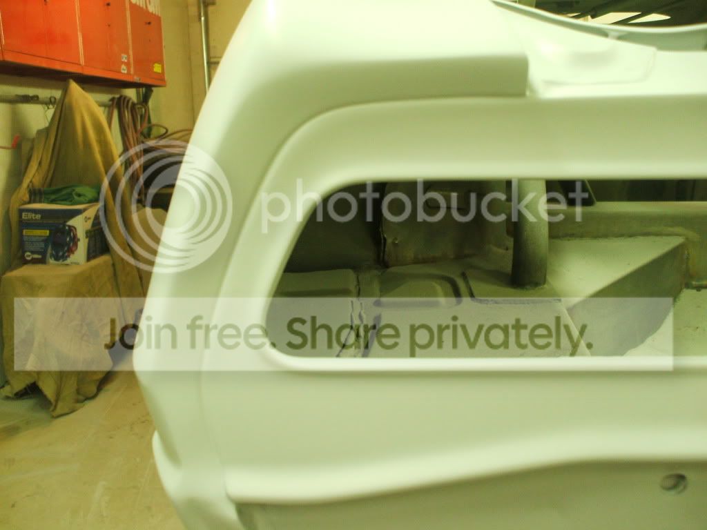

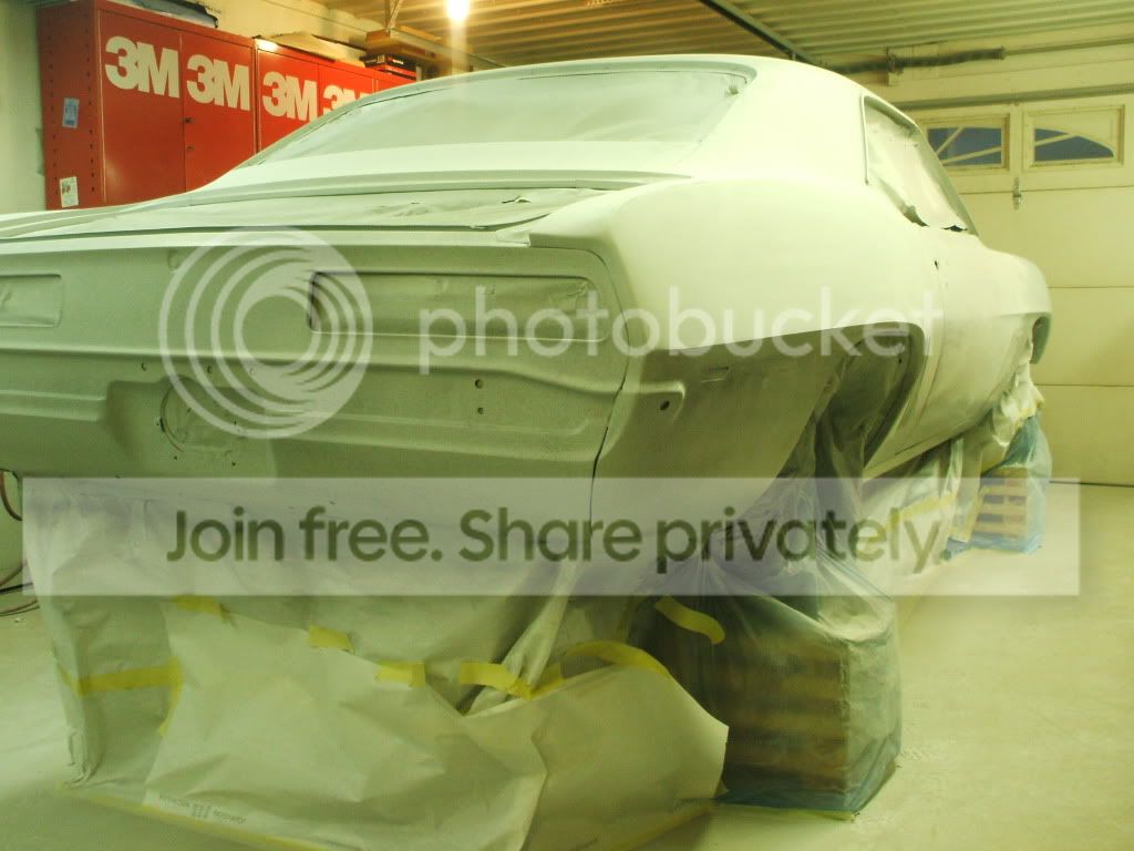

Stielow 10-26-2009 06:52 PM

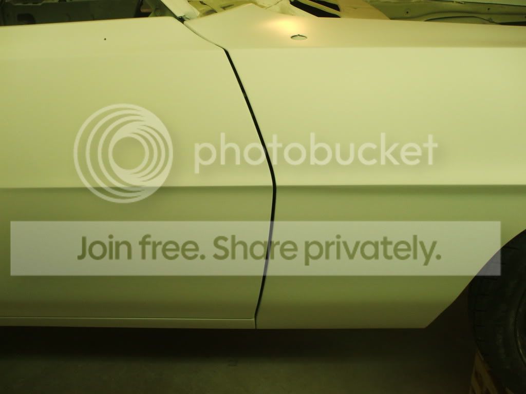

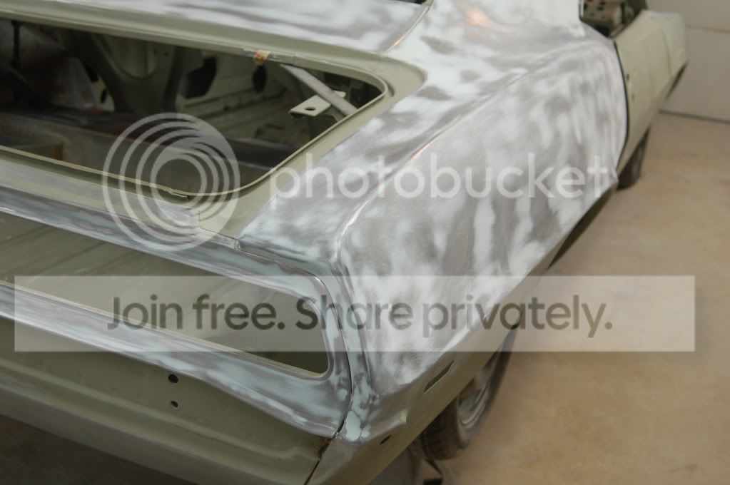

A little up date on the body work.
http://i439.photobucket.com/albums/q...5/DSC_2877.jpg
http://i439.photobucket.com/albums/q...5/DSC_2876.jpg
http://i439.photobucket.com/albums/q...5/DSC_2875.jpg
http://i439.photobucket.com/albums/q...5/DSC_2878.jpg
Paul and Joe are doing a great job. The car is looking very straight.
Mark

Thats what a proper skim coat should look like. Notice no built up edges or seams. Everything clean and sharp. Most do not notice the difference. Car should be killer when done!! Then again your cars always do!

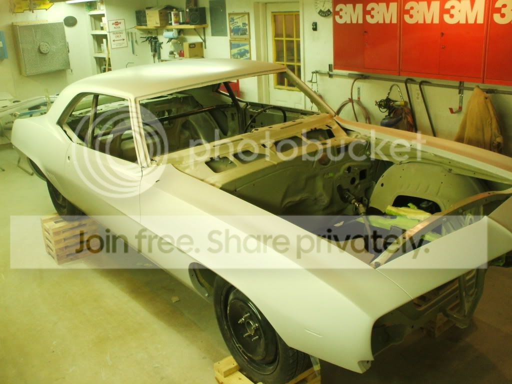

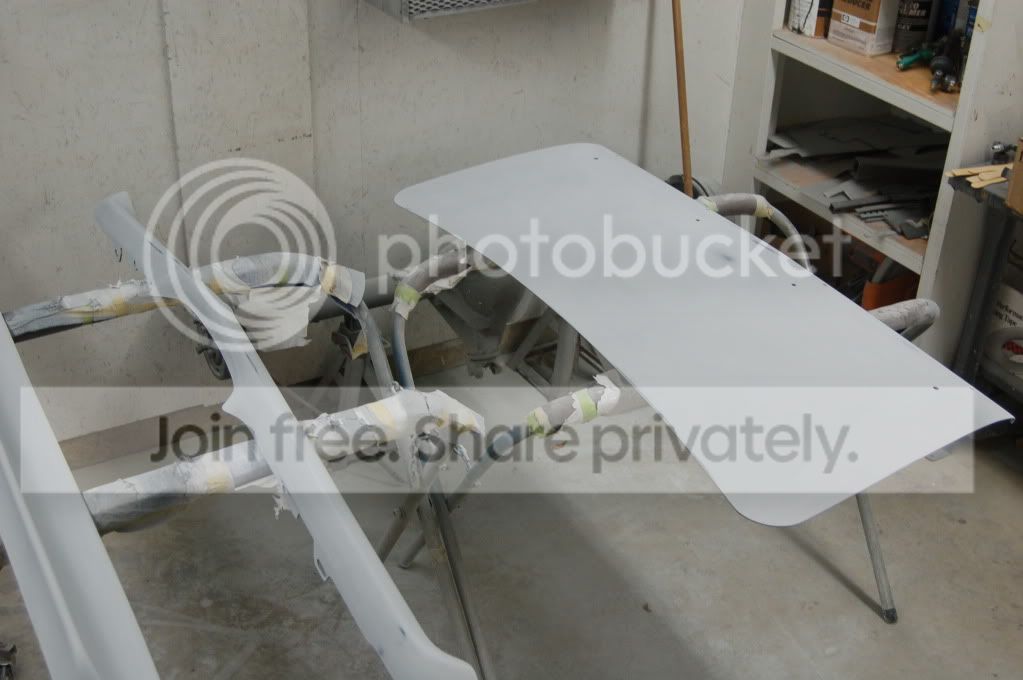

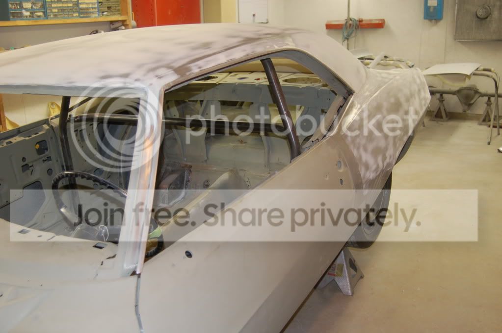

Paint update
Paul and Joe have been working away on my car. I think this will be the best paint job I have every had. They have been a blast to work with and have a great attention to detail. They just rented a building and should have their shop set up in Feb. If you want a top notch paint job get in touch with them to get on their waiting list. :thumbsup:
http://i784.photobucket.com/albums/y...s/DSCF2413.jpg
http://i784.photobucket.com/albums/y...s/DSCF2422.jpg
http://i784.photobucket.com/albums/y...s/DSCF2419.jpg
http://i784.photobucket.com/albums/y...s/DSCF2424.jpg

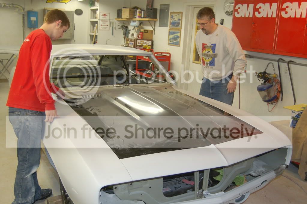

Trial fitting the aluminum hood
http://i439.photobucket.com/albums/q...5/DSC_2900.jpg

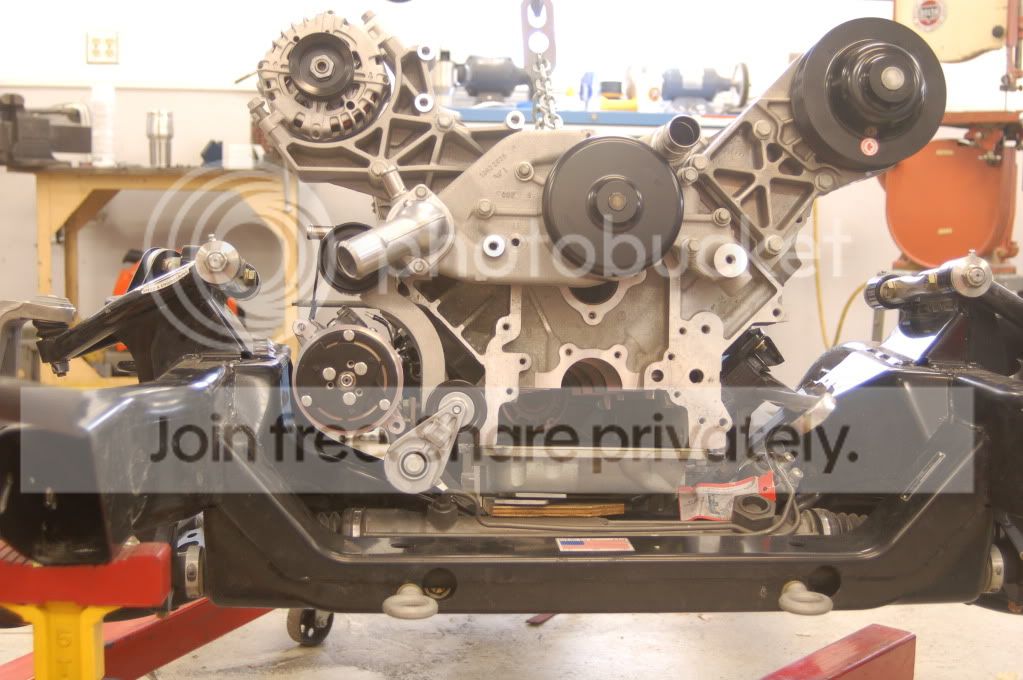

All I have to change on my car to go from the LS7 to the LS9.2 is:
Radiator
Fans
Front end accy drive
Clutch
Transmission
Drive shaft
Rear axle ratio
Fuel Pump(s)
Engine mounts
Notch DSE sub frame
And add:
Intercooler
Intercooler pump

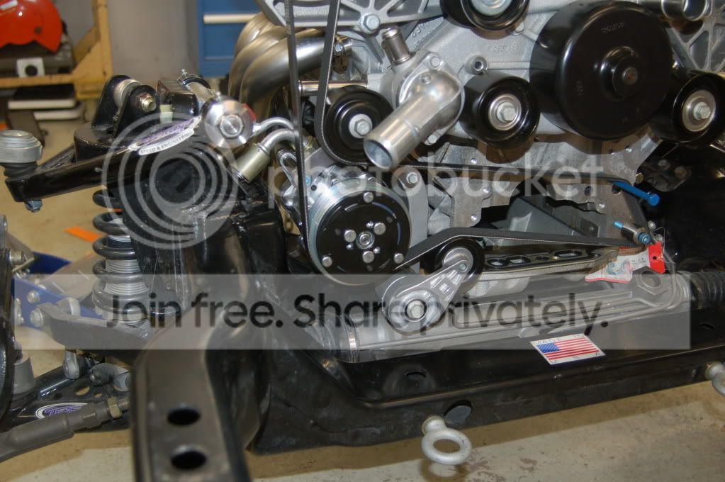

I got the LS9 accy drive to fit the DSE front clip.
http://i439.photobucket.com/albums/q...5/DSC_2906.jpg
http://i439.photobucket.com/albums/q...5/DSC_2925.jpg

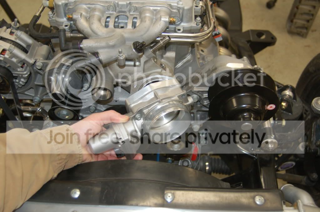

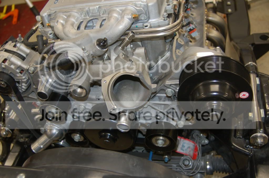

I'm cutting off the stock throttle body and angling it toward the driverside fender. The stock LS9 TB angles up and toward the center of the car. Cutting it off and aiming it toward the fender will make it flow better and make the inlet tube a better package.
http://i439.photobucket.com/albums/q...5/DSC_2921.jpg

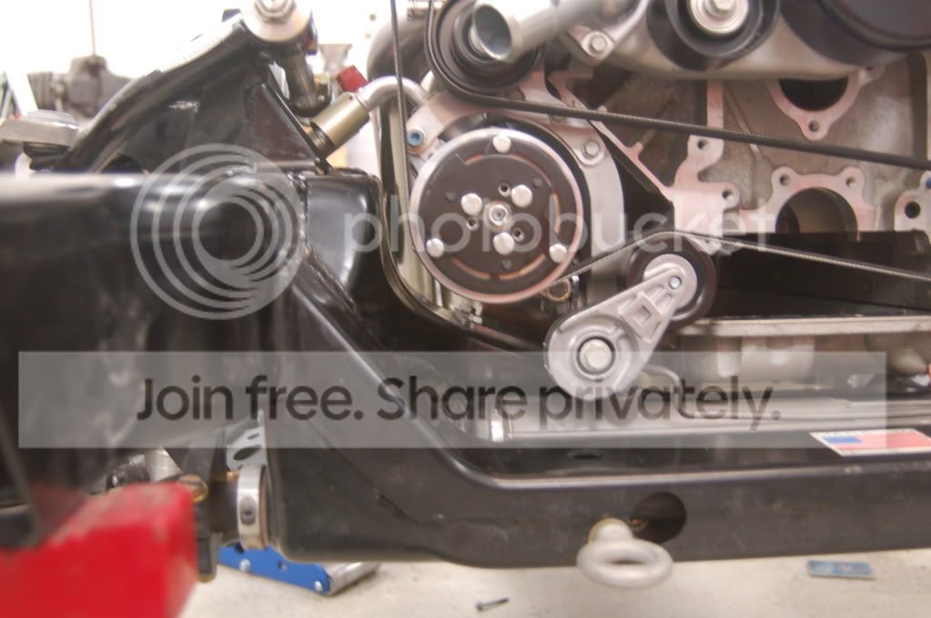

I've had the last week off for vacation and I've be able to modify the DSE sub-frame to clear the A/C comp. The GM A/C compressor would not fit so I mounted a Vintage Air unit. Also, to clear the A/C comp I need to swap to a 2002 F-car engine mount.
http://i439.photobucket.com/albums/q...5/DSC_2922.jpg
Last night I finished angeling the throttle body. My aluminum welding is OK but Joe's at Stenodes is great. So I'll take it to Joe tomorrow to weld it up.
http://i439.photobucket.com/albums/q...5/DSC_2918.jpg
