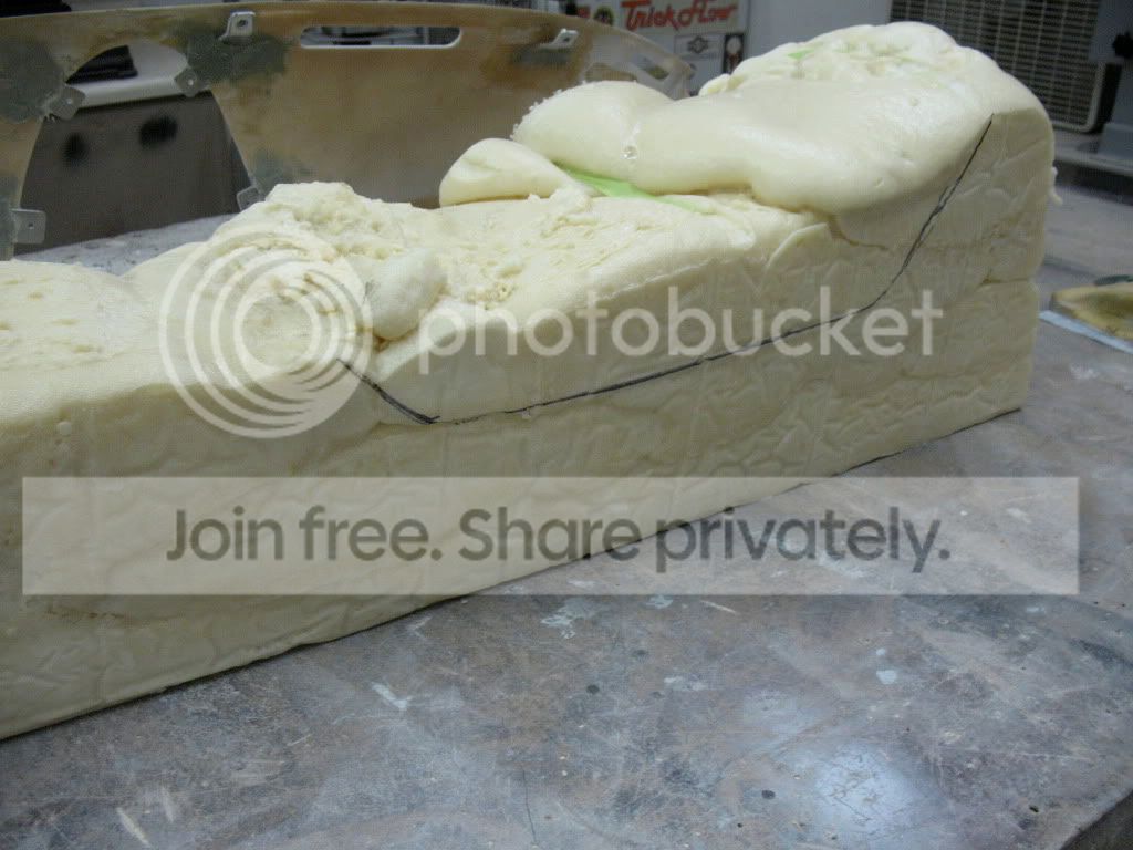

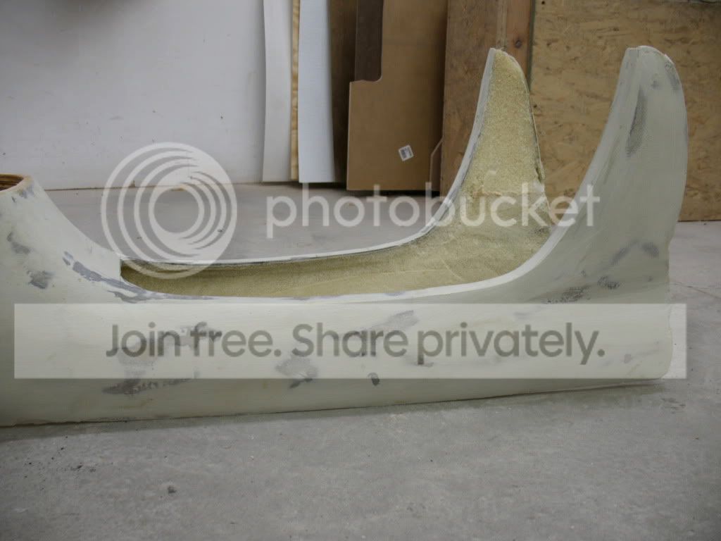

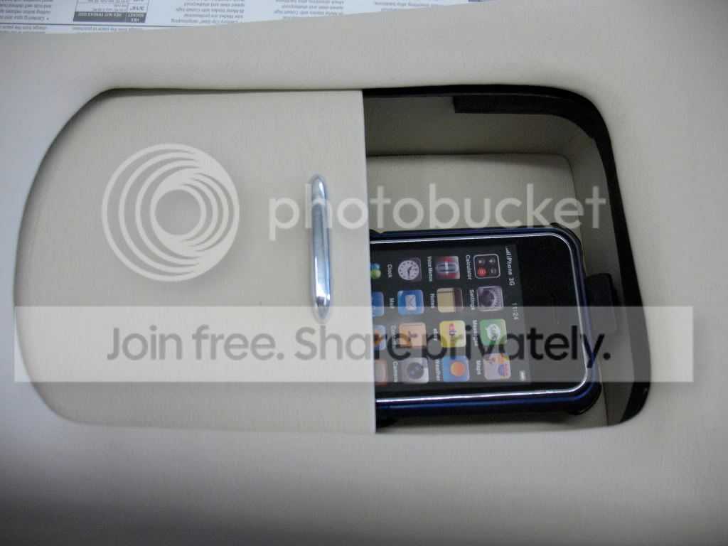

I got some P M's about details on console, It is made out of fiberglass and the door is for holding Marks pod phone
http://i338.photobucket.com/albums/n...1/IMG_5073.jpg
http://i338.photobucket.com/albums/n...1/IMG_4901.jpg
http://i338.photobucket.com/albums/n...1/IMG_4899.jpg
http://i338.photobucket.com/albums/n...1/IMG_4793.jpg
This is what it looks like after the pour foam cures and you pull it out of mold, Then just start carving to shape and glass up, sand, skim coat, cover and done

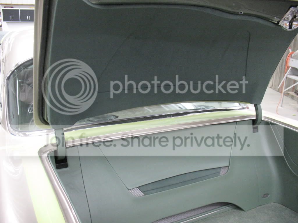

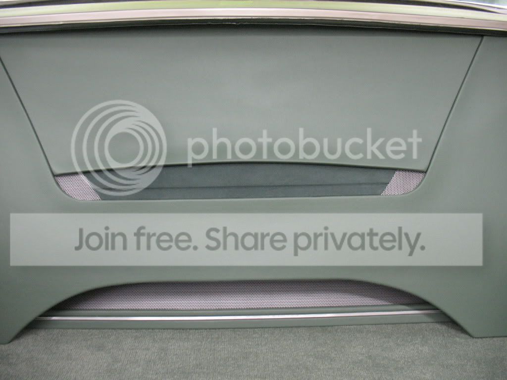

RECOVERY ROOM 11-18-2010 05:47 PM
Some trunk pics done in Ultraleather and suede
http://i338.photobucket.com/albums/n...1/IMG_5555.jpg
curved corners always look
http://i338.photobucket.com/albums/n...1/IMG_5557.jpg
http://i338.photobucket.com/albums/n...1/IMG_5587.jpg
