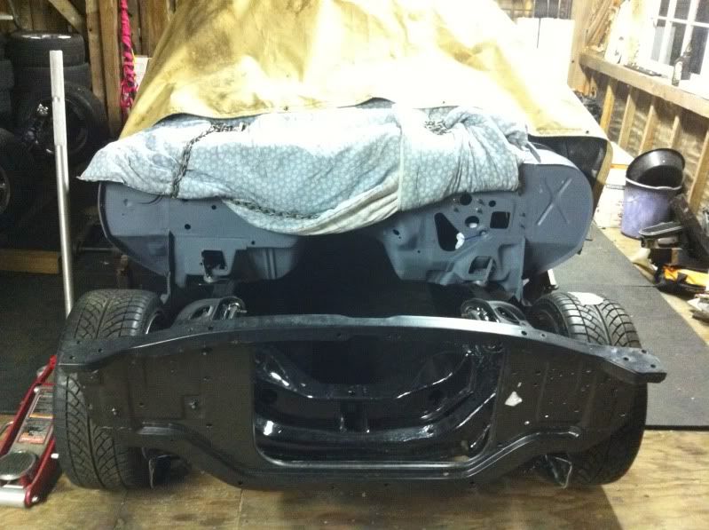

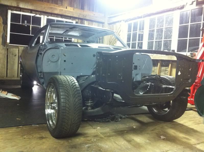

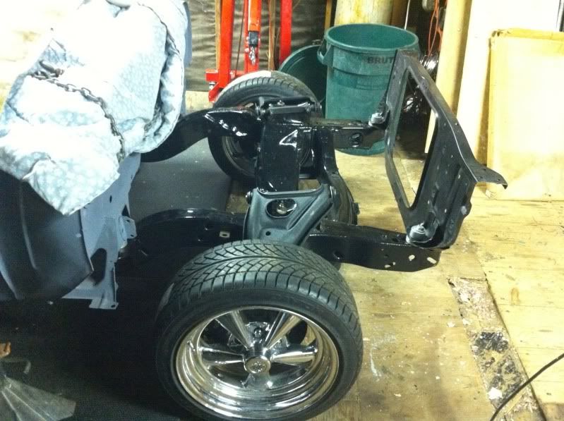

In other news Timmy is making progress on the gauge cluster and has to come back over for one last fit before he can put his final touches on it. It’s coming out great and I'm glad this is the route that we went. I got 4 small led lights from classic dash to have them wired into the stock dash cluster for turn signals, high beams, and brakes or check engine light so that will be soon. Now that the fuel stuff is all wired I plan on having Timmy also make a small panel to hold the pump, fuse..ect. It will be located right near the battery.
Onto some pictures from the past 2 weeks.

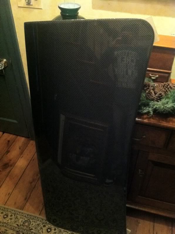

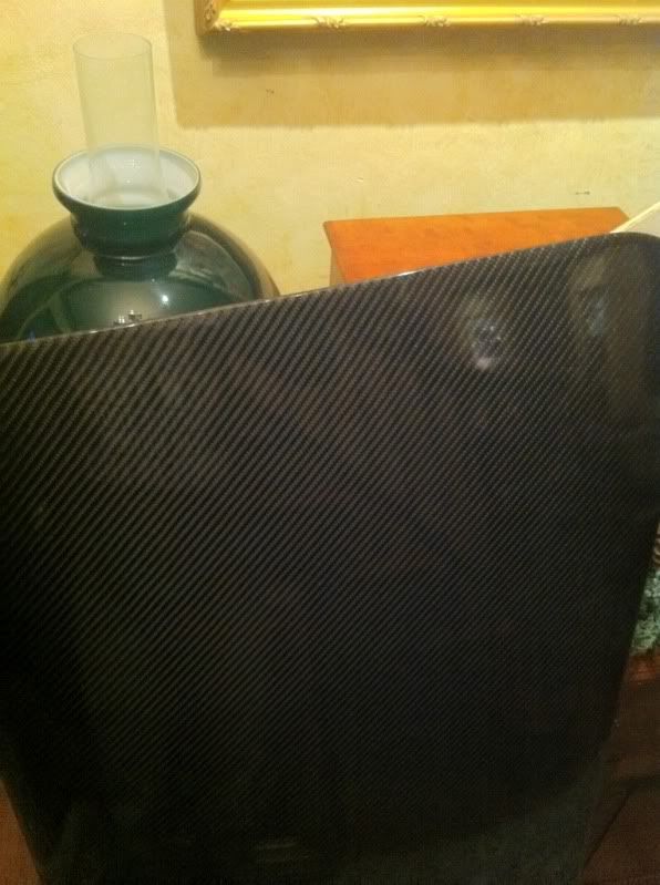

boostin05blacks 04-27-2012 07:38 AM
Thanks guys...:thumbsup:
So last night I took off from working on the car to spend some time with the family. I brought home a little clean project to work on while watching TV before bed. I’m still figuring out how I want the coils /spark plug wires to run. Id really like them to run under the headers and mount the coils to the frame in front of the motor out of sight. With that being said I know that heat is going to be the biggest problem. I bought some DEI heat shield for the wires that is rated to 500 degrees. I also have the end boots that are rated to over 1200 degrees. Between the two I think they should be fine... So I took apart the wires and ran the DEI sleeves over each one. Here are some pictures..

waynieZ 04-27-2012 06:01 PM
They look good. I was thinking of the boots for the ends. Nice job.
boostin05blacks 04-29-2012 06:29 PM
Thanks man, Yea they came out really nice. Hopefully I can tuck them under the headers nicely without and problems. Well see..:thumbsup:

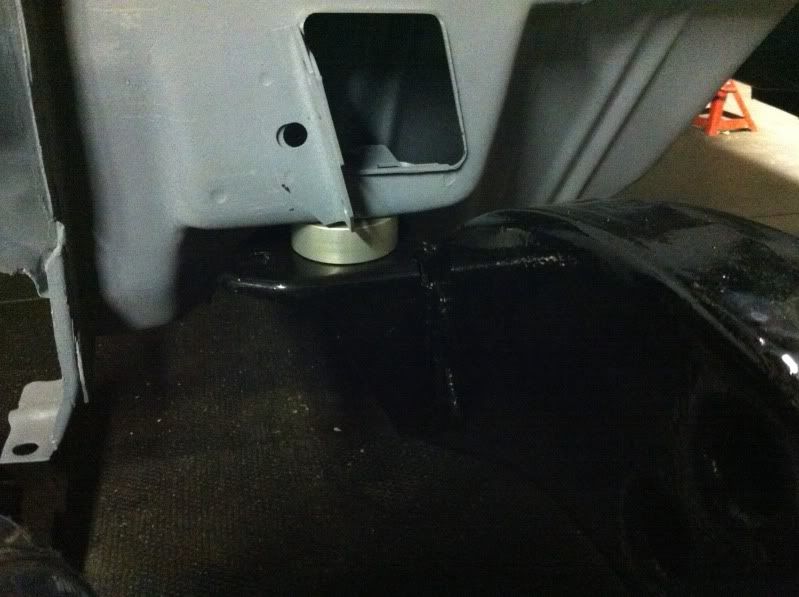

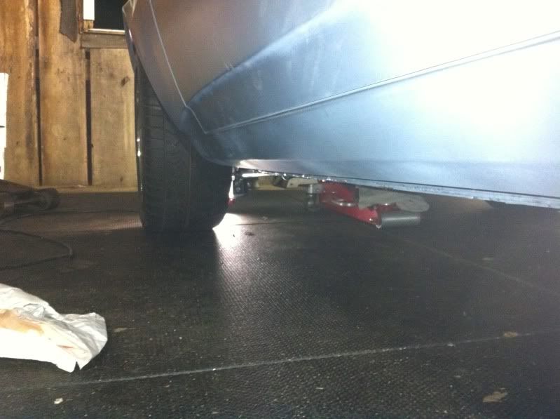

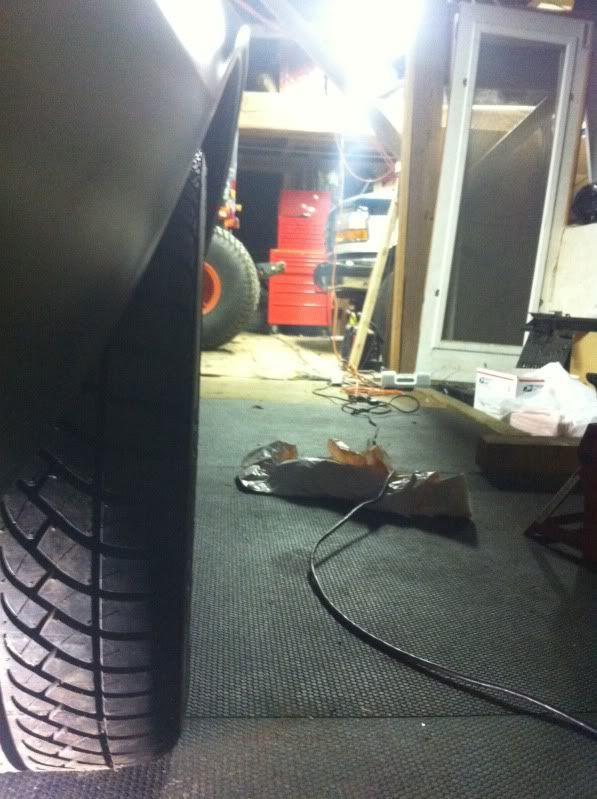

Got over to the car this weekend for a bit while the baby was napping. Still plugging away at the wiring. Not to much left really. Have to finish the wiring for the tach and water gauge , the 6-7 wires for the ecu, run the power for the fuel pump, put in two more main grounds, wire up the radiator/fans, run a power from the alternator to the main power connection, and run a power for the interior wiring to the main power connection. Actually looking at it wrote out it is enough. Soon enough. Mike and I ran the main power block to the drivers fender so I can get to it but it's out of the way enough that there should be no problems with anything else coming in contact with it. Extended the main power wire for the ecu to that and put the fuseable links in, also finished running the main power wire from the battery to it. Today I had some time so I drilled a hole in the floorboard for the pass thru connector. Mounted that and cut the main 1 gauge to size and finished crimping the ends. Also made the main wire to go from the connector on the engine bay side to the starter. In other news the radiator has been ordered and should be here soon. Also ordered a maf sensor so that should wrap up the ecu potion of wiring.
On Saturday the brake lines came in from inline tube. Seems like a really nice kit. Ordered all stainless and when I opened it I was scratching my head a bit as there was 8 lines. I though there was 7 lines for the brakes. Two smalll lines off the master to a distribution block right under the master cylinder. From the distribution block three lines come off that, one to the front right, one to the front left, and one long one to the rear that stops right before the rear axles which goes to a soft line. From the soft line to a "T" mounted on the rear axle which connects to a rear left and rear right line. 7 total. Anyone wanna guide me or tell me what I'm missing? Onto the pictures...
http://i18.photobucket.com/albums/b1...s/b2568599.jpg
http://i18.photobucket.com/albums/b1...s/78800584.jpg

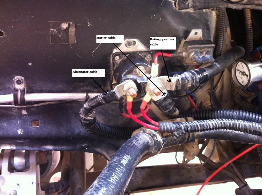

72Z/28 05-07-2012 02:09 PM
Thanks manand best of luckwith your project. I noticed that you hooked up a pink wire, which I assume is the S wire on the alternator pigtail, to the alternator post on the back side. What about the L wire, did you connect any resistor between the L wire and the alternator exciter?
http://i18.photobucket.com/albums/b1...s/8a8d4f9e.jpg
The reason why I am asking is that I have got the same alternator, and there was only the L wire on the alternator pigtail connected to the alternator exciter wire, and the S wire was not connected. The alternator was not charging the battery when the S wire was not connected. So, I connected the S wire to post on the backside of the alternator similar to yours and started to get 14.4V at the alternator, but there is no any resistor between the L wire and alternator exciter wire. I actually don't know whether the alternator exciter wire is hooked to the dash cluster or to the PCM, and there is no charge light.. I tried to trace the exciter wire but know luck. The wiring harness and the EFI harness are from Painless.
I also realized that a Ford starter solenoid was installed on the fender well,
http://i218.photobucket.com/albums/c...8/photo1-1.jpg
Honestly I don't know what the rest of the wires are for. :mad:

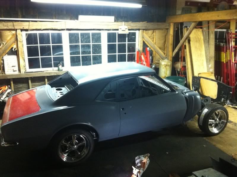

Got over to the car this weekend. Trying to wrap up the some of the small stuff and get ready for the car to be fired. First off was to rewrap the old wiring for the coil packs. That was done on the driver side as Timmy took the passenger side to make a heat shield. The one coil is a little over an inch away hopefully it will be fine. Well see..I also cleaned the header mounting surface off put the gasket in and put the apr bolts in with some anti-seize , torqued them to spec. Once I get the other coil pack back I'll finish the passenger side.
The radiator showed up on friday so I put that in also and my hoses fit but the lower is just too short. Im going to the auto store soon and see what I can come up with. other than that it should be simple. The wiring harness is really nice and simple. What a great piece compared to others that are close to double in price.
Me and my brother in law made wood blocks to get the car in the air to install and work on easier. So after we made them I put the car on them. The dimensions are 21" x 23" - 8 per block so a total of 32 each. I also got some shots of the of the pedal as people where asking how the travel is limited and exactly where it is located.
http://i18.photobucket.com/albums/b1...s/c1b2aa57.jpg
http://i18.photobucket.com/albums/b1...s/e3739985.jpg
http://i18.photobucket.com/albums/b1...s/a8a77a5f.jpg
http://i18.photobucket.com/albums/b1...s/7b6a3bef.jpg
http://i18.photobucket.com/albums/b1...s/2b9f6b6c.jpg
http://i18.photobucket.com/albums/b1...s/9d356fe0.jpg
http://i18.photobucket.com/albums/b1...s/0f2812b5.jpg
http://i18.photobucket.com/albums/b1...s/8444be92.jpg
http://i18.photobucket.com/albums/b1...s/9ec56e3c.jpg
http://i18.photobucket.com/albums/b1...s/00a47ee7.jpg
http://i18.photobucket.com/albums/b1...s/6d4504e1.jpg
http://i18.photobucket.com/albums/b1...s/4c14db38.jpg
http://i18.photobucket.com/albums/b1...s/43ab9528.jpg

In other news after driving for a bit I felt that the shifter/steering wheel/right leg area was to tight and I wanted to try to free up some space..so the first thing I did was to try to adjust the shifter and change the position to get it more towards the passenger side a bit. Well I failed at that after breaking 2 allen sockets and the allen key head off in the first bolt. The next day a quick call to Josh over at American Powertrain he tells me that the whole shifter I have it old and they have since revised it to have an internal seal to stop it from seeping. He offers to send me a brand new one and for me to just send the old one back. So that’s what I did...got the new one and took me around 2-3 hours to install. It was a bit tight in that tunnel trying to take out and replace 6 allen bolts by hand...but its done now and I can adjust it. Got some more room from that but I still wanted more so I started looking for a tilt column. Steve Rupp had a brushed aluminum ididit one for sale and I bought it from him and as always what a pleasure to do business with him. Called up ididit and ordered their steering wheel adapter and new rag joint. Got the order and the rag joint was wrong (my fault, counted the splines wrong) sent back the wrong one and am waiting on the new one to come back. Did a quick mock up with the column and with the tilt feature I think this room issue will be resolved all together.
So being that I can’t leave anything alone. I talked to Timmy the other day and we talked about starting the paint process over the winter..so he came over last Sunday and we pulled the whole front end apart so he could take the front fenders and weld up the lower extension to the fenders to give the car a cleaner look. He is also going to get me the primer I need to lay on the car for the blocking..ect. I also ordered the semi-gloss hotrod black single stage that will cover all the interior panels, dash, whole engine compartment, and rear tail panel. So that will get started in the near future. There’s lots of scuffing/blocking and prep work to be done so if your around the area and want to lend a hand let me know. The beer and food are on me.
And for my last update ill let the last picture do the talking..haha..
http://i18.photobucket.com/albums/b1...6AF25224C3.jpg
http://i18.photobucket.com/albums/b1...6AFA0D6AE9.jpg
http://i18.photobucket.com/albums/b1...6AE63501EB.jpg
http://i18.photobucket.com/albums/b1...6AD4490A8B.jpg
Much more to come..

What color are you planning painting it? Are you going to leave the Carbon exposed?
Awesome build BTW!
boostin05blacks 11-09-2012 09:04 AM
Awesome build BTW!
Thanks man. It will be painted a deep yellow with the z/28 stripes on the hood and trunk that will be left carbon. So far away it will look like black stripes untill you get up close.:thumbsup:
KPC67 11-09-2012 10:16 AM
Great job on everything.
What are you going to do about the stripes on the upper deck panel?
boostin05blacks 11-09-2012 11:40 AM
I have thought about this and there is not too many options that will look good. I was thinking some type or airbrush work / vinyl or maybe just a dark grey/black paint on this area..I could get a custom cf piece made for this area and take the thickness of the cf off that area and have it put in..that would be the best option but the most coastly. Im curious as to others thoughts on this.:thumbsup:
KPC67 11-09-2012 11:45 AM
Getting a sticker made would probably be the cheapest?
Ron in SoCal 11-09-2012 02:47 PM
There are no good options IMO unless you take the time/$ and french in a piece of CF. There was a guy @ SEMA in 2011 w a Gen 5 Camaro that did grand sport stripes that way. Came out smokin hot!
Fake/Hydro CF next to the real deal is kinda lame. Unless you go the distance, maybe end the stripes on the decklid?

So Timmy came over today being that the fenders where finished for now. I wanted to try to get over to the tuner soon to fix this check engine light that keeps coming up for the tps. Dale has to calibrate the parameters for the throttle body and that should fix the issue. I planned to drive the car over there and put some miles on the car too. Its about a half an hour from me so this would be the cars longest drive to date. So being that we blew the front end apart we reassembled it all again. The gaps and panels go together a bit easier now it seems or maybe I'm just getting good at it.. They have all been massaged in some way so I'm hoping that is the reason. The whole reason for this was to clean up the lines a bit and Timmy has came through again. It looks like it came from the factory like this. Actually when I showed some people they asked me what was done numerous times.. So I'm guessing the job looks good.
In the time I have been waiting for Timmy Ive been busy cleaning up some wiring, installed the parking brake set up, and I also finished installing the DSE wiper kit that I bought used for a good deal. Which went in awesome and works so much better that the stocker. Plus cleans it up a good bit too.

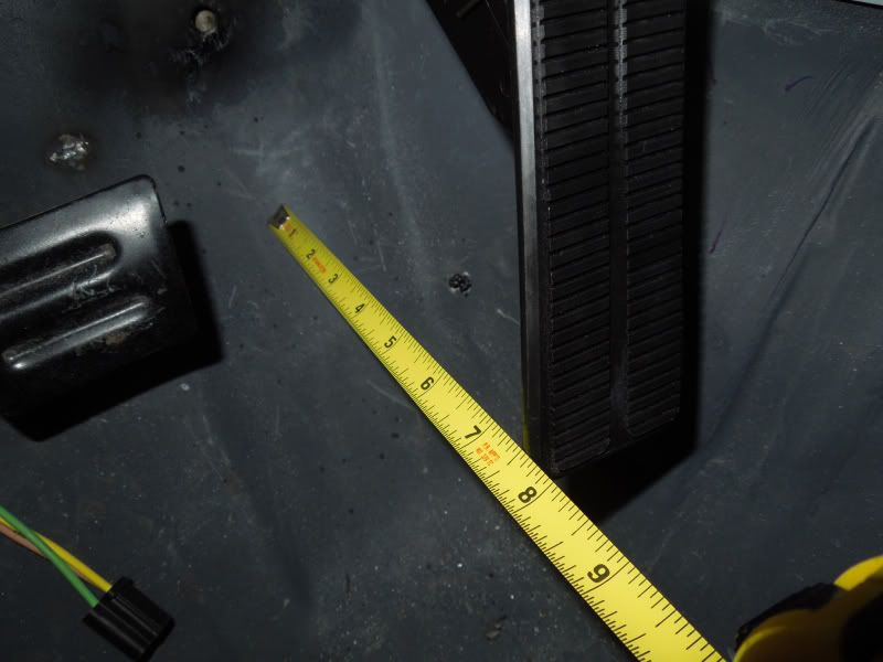

After all that I finished installing the new ididit steering column and getting that where I like it. Again a huge difference over stock, looks great and the adjustable was a must in my opinion. Next stop is back to the tuner for a quick fix and maybe even a colder weather tune... Well see..
Here is some pictures showing the stock position of the column and leg room or lack there of in 1st and 2nd..my right leg is touching the steering wheel
http://i18.photobucket.com/albums/b1...8580658309.jpg
http://i18.photobucket.com/albums/b1...0de2a20d60.jpg
And now tilted all the way up. Hard to see but the steering wheel is no longer on my right leg when I'm on the gas pedal. I have about 2-3 inch of room between now. Same thing 1st and 2nd..
http://i18.photobucket.com/albums/b1...2d8b00391f.jpg
http://i18.photobucket.com/albums/b1...dba1db098c.jpg
