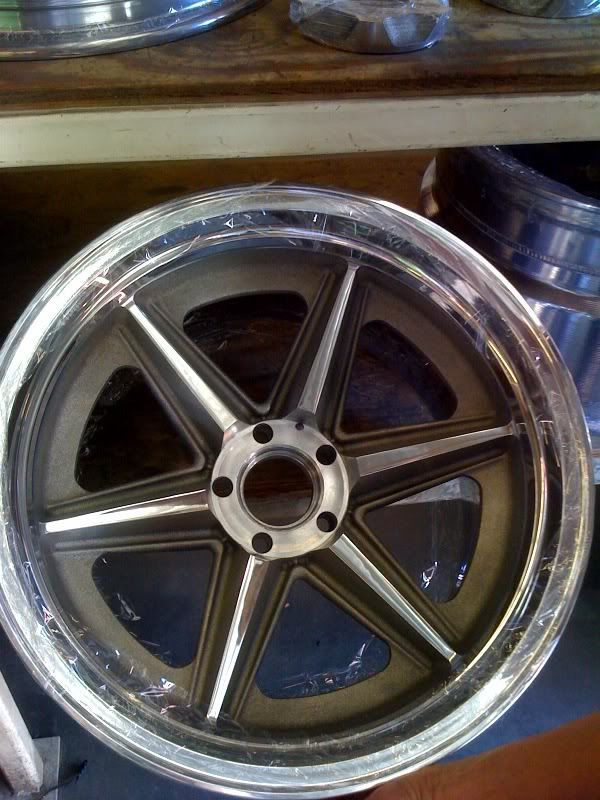

ANVIL1 10-09-2010 05:38 PM
Here's one of the wheels when we dropped them off at the powder coaters. Evod sanded and polished the tops of the spokes which was a big job and turned them around in no time for extraordinary results! The tops of the spokes and the polished rims will be masked and the middles will be powder coated a sort of magnesium color.

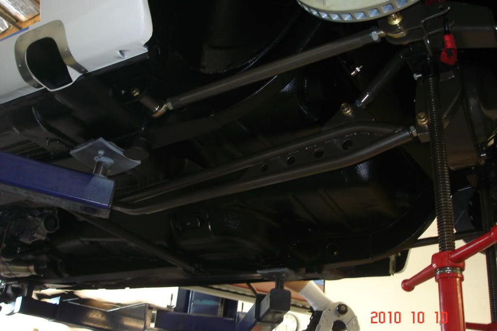

ANVIL1 10-10-2010 10:44 PM
This shot gives a better idea of the mods that were made to get the exhaust to exit out of the rockers. They had to modify the floor and go through the frame rails.

Bowtieracing 10-11-2010 08:16 AM
http://i219.photobucket.com/albums/c...g/Oct10008.jpg
The exhaust is really clever :bow: Matt where are those cool cad plated suspension bolts from??
ANVIL1 10-11-2010 04:15 PM
You are digging on my gold cad plated bolts which are specially ordered from ARP, no? They are jewel like, yes? If I were the gold chain wearin' type, I would wear them around my neck and leave the top 4 buttons on my shirt undone just to show them off with my wild and crazy crispy chest hairs! The chicks, they would not be able to stand me :cool:

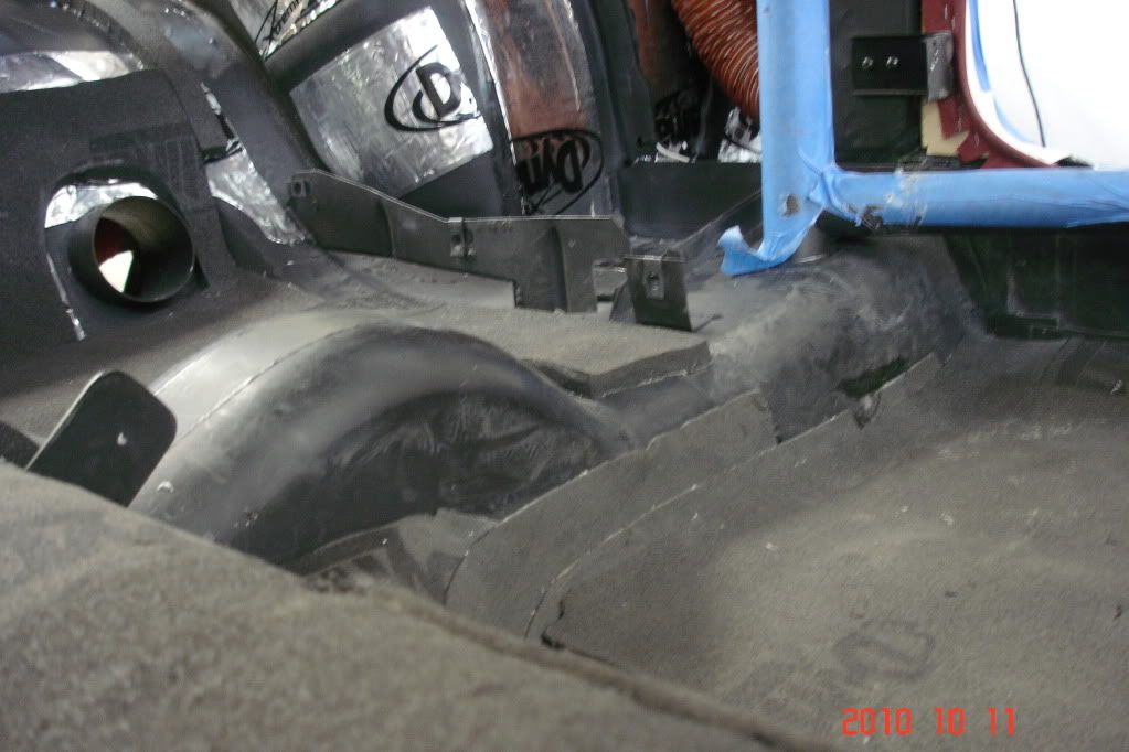

This shot shows how the floor has been modified to clear the driver's side exhaust as it turns up and over the torque arm and through the rocker panel
http://i219.photobucket.com/albums/c...g/Oct11006.jpg

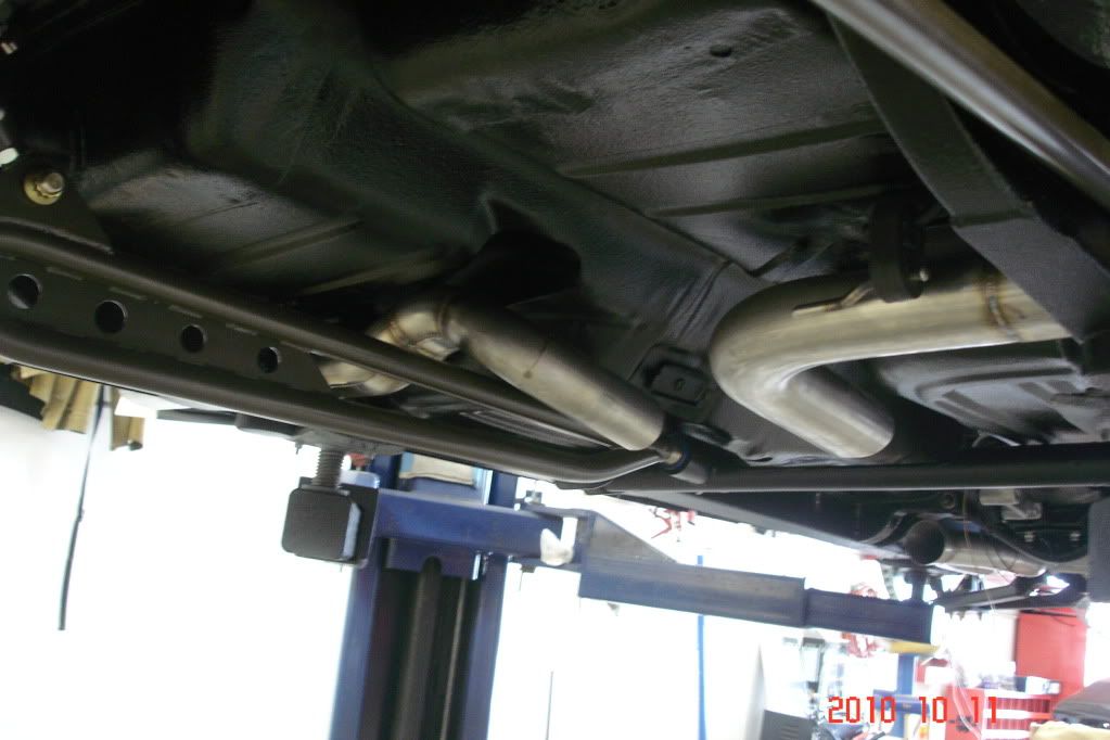

Here's the bottom of the same area. You can also see that the cross member where the front of the arm attaches has been notched on top to allow for the oval tube exhaust to clear over it.
http://i219.photobucket.com/albums/c...g/Oct11009.jpg

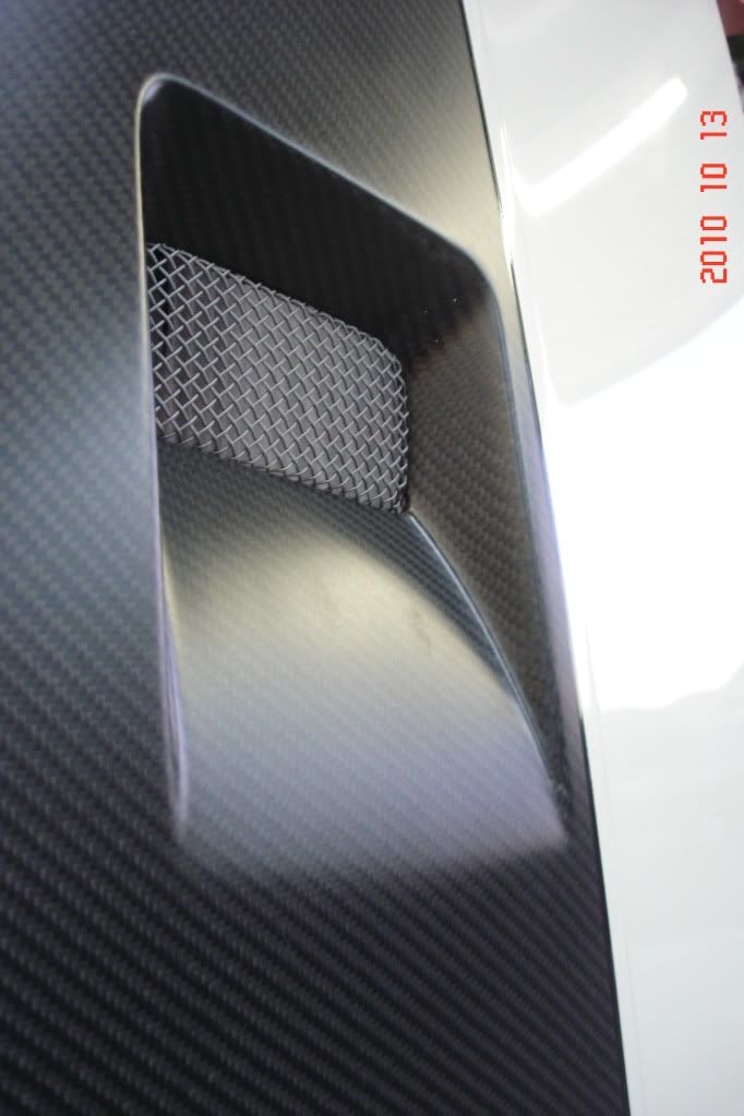

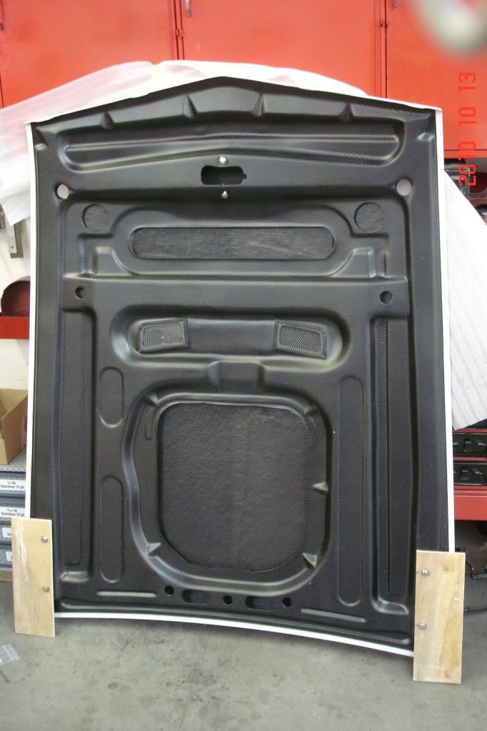

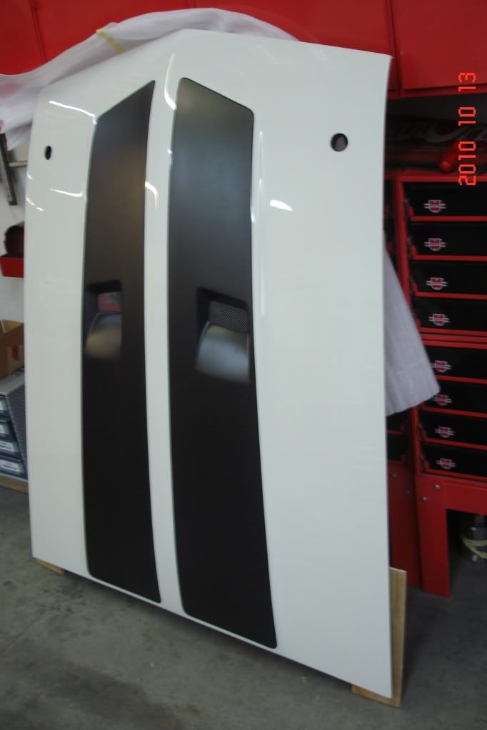

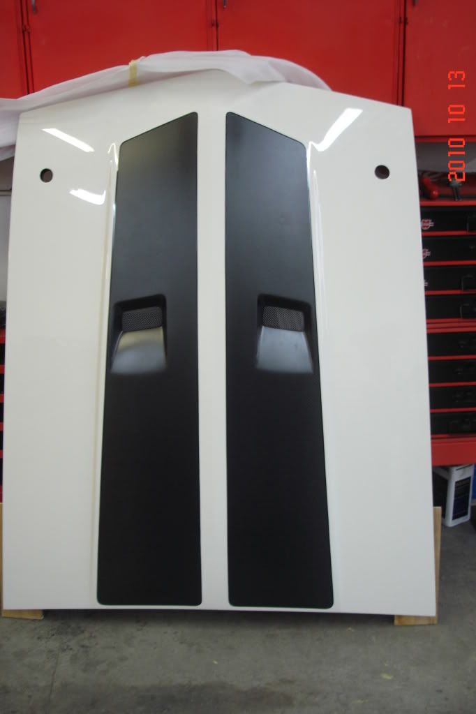

Picked up the hood and fenders from Mick today and I fit the mesh screens I made into the hood. The hood turned out really nice. I'll get pics of the fenders later, but they are very nice too.
http://i219.photobucket.com/albums/c...g/Oct13012.jpg
http://i219.photobucket.com/albums/c...g/Oct13013.jpg
http://i219.photobucket.com/albums/c...g/Oct13018.jpg
Back side is satin carbon fiber like all of the exposed carbon fiber on the car.
http://i219.photobucket.com/albums/c...g/Oct13022.jpg

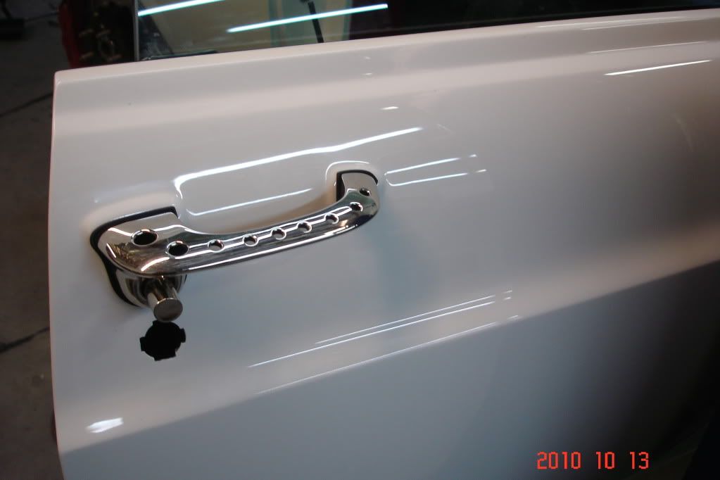

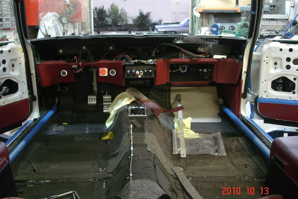

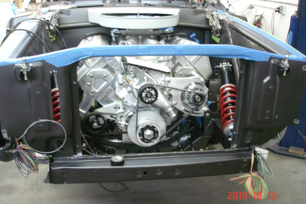

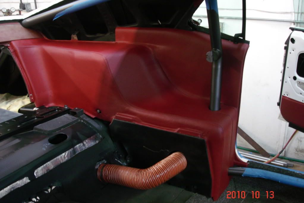

Some updated shots of the progress...
http://i219.photobucket.com/albums/c...g/Oct13033.jpg
http://i219.photobucket.com/albums/c...g/Oct13032.jpg
http://i219.photobucket.com/albums/c...g/Oct13028.jpg
http://i219.photobucket.com/albums/c...g/Oct13026.jpg

Matt, Man this this is frickin awesome.I love the satin carbon fiber.I have allway's loved Steve S. build style.You two make a hell of team.:thumbsup:
redfire69 10-14-2010 04:16 AM
Don't know if I missed it, but where did you source the tubing for the brake cooling vents?
Love that hood! :thumbsup:
tones2SS 10-14-2010 08:11 AM
That is SICK! Looking awesome. I like the hood!:thumbsup: :cheers:
ANVIL1 10-14-2010 11:49 AM
Steve got it from a Pegasus racing products in Wisconsin. I think you can also find it in the McMaster Carr (everything under the sun) catalog.

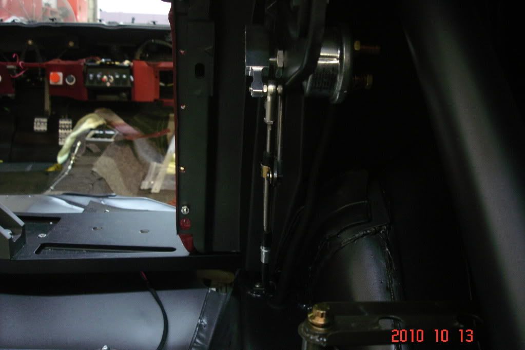

ANVIL1 10-14-2010 11:51 AM
Here's a cool little detail. Steve put a battery shut off in the trunk that has a cable to actuate it remotely from the driver's seat.

Musclerodz 10-14-2010 12:12 PM
you can also get it from A/C Spruce, Wick's, or Wag-Aero, or any other decent aircraft supply house. Called SCAT tubing
mfain 10-14-2010 12:59 PM
Battery shut off
1 Attachment(s)
No attempt to hijack. I wish I had seen your battery shut-off cable earlier. Very nice! I did something similar, but used an alluminum push rod and a bellcrank on the roll bar to put the shut-off near the trailing edge of the drivers window. It would have been easier to fire-seal with a cable.

redfire69 10-14-2010 01:42 PM
Thanks guys!

Can't what to see this sweet car. The hood is sweet!

wheels and hood are awesome:thumbsup:
