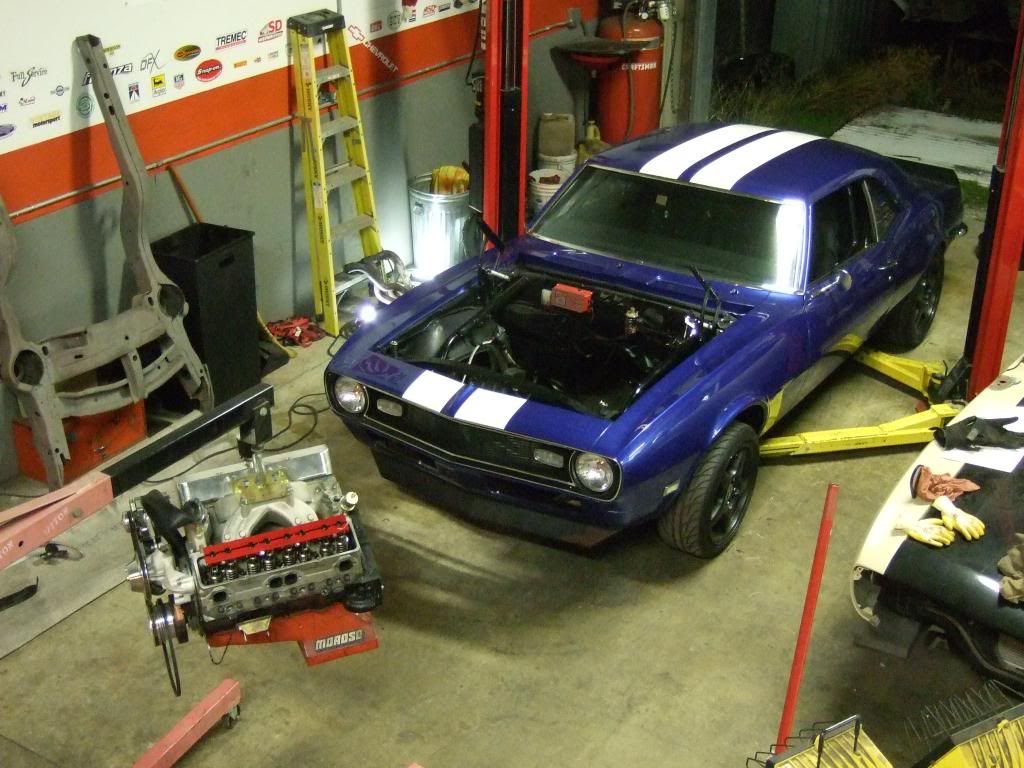

update time
Rich Bermea -- of Road Touring Customs in Gilroy, CA -- have been working on "Phase 2" of my Camaro with the sole purpose of getting it race and road-trip ready for RTTC II in February. Rich is a great dude and knows and loves Camaros. He just posted his own 68 Camaro build thread yesterday - "Pro Vintage." Check it out.
So.. just a few days ago I was almost set on getting the Liberty upgraded TKO 600 to replace my M-21, but after continuing to uncover bad seals and gaskets causing endless leaks on this car and motor, we decided to pull the motor and just reseal everything pretty much everywhere. So, that decision killed the tranny budget for now.
The trans, clutch, motor and most major parts look to be in pretty good condition, and I have put 500 pretty hard (ok, very hard) miles on this car since I got it 4 months ago. It came with a fair amount of paperwork, but many things are still a mystery... some we hope to uncover very soon.

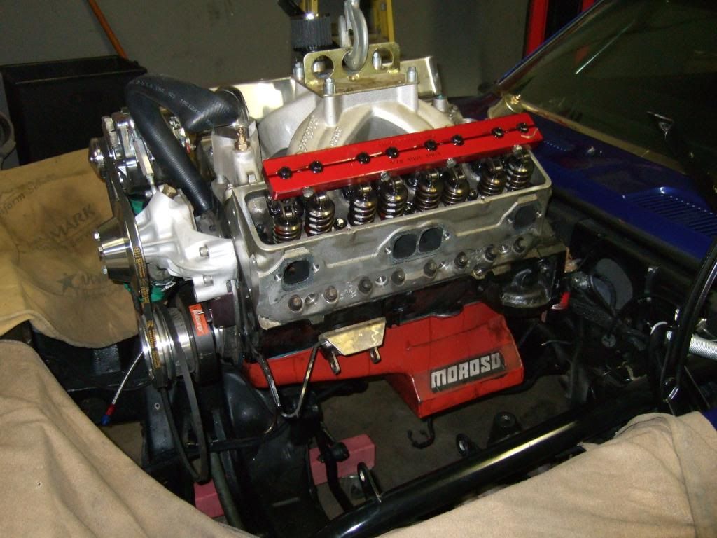

We got the motor pulled today and while I'm on vacation Rich will start on tearing the motor down, inspecting and resealing/gasketing. When I get back we will finish the rear suspension, brakes, trans, and a few other small things... wait, is anything ever really small? :_paranoid
Pics from today.
I'm really diggin the red Comp Cams stud girdle.
http://i236.photobucket.com/albums/f...8/DSCF3076.jpg

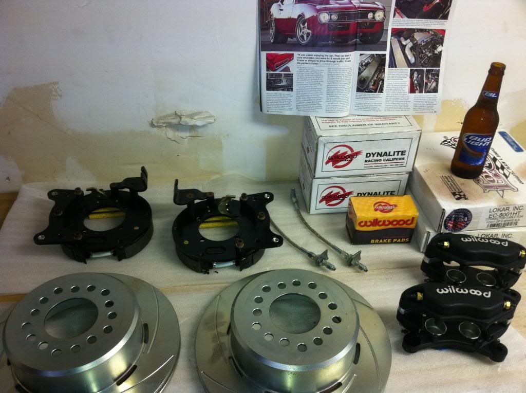

My rear Willwood kit with the obligatory beverage and Red Witch guide book.
http://i236.photobucket.com/albums/f...hoto_004-2.jpg

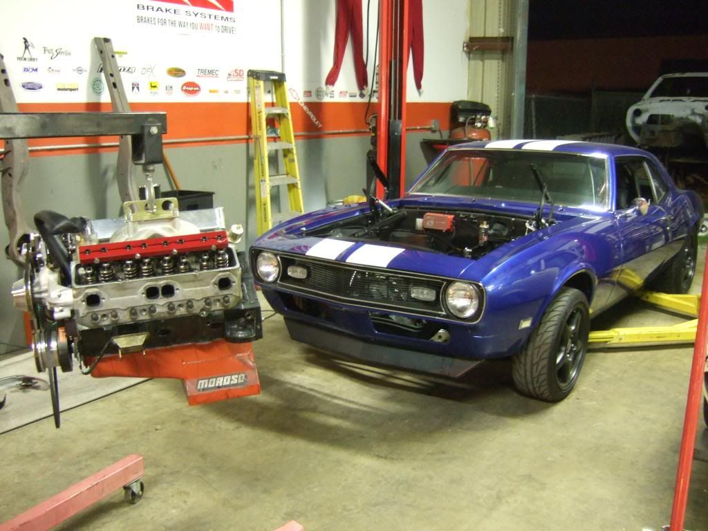

I finally became bumperless.
http://i236.photobucket.com/albums/f...8/DSCF3093.jpg

Vegas69 12-18-2010 01:29 PM
Dave, VR1 is good oil. Pettis has seen bearings, pistons, cams, etc after seasons with Brad Penn. He said it's better than VR1. Marginally I'm sure.
If you are coming from drums, then you may very well have the knockback. Do you have power brakes or manual. I'm guessing manual with that huge cam.
Flash68 12-18-2010 03:18 PM
Good deal on the VR1. It was in the motor when I got the car, and we changed it and decided to keep using it after looking into it and seeing it seemed like a quality oil.
Yep, I am a manual braker. Looks like I am headed for Team Knockback.
Vegas69 12-18-2010 04:01 PM
Personally, I'd put a floating caliper on it now and sell that kit. At the very least, make sure those axle bearings are tight.
