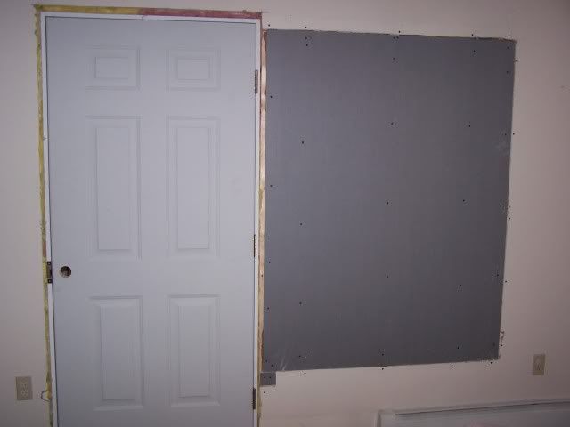

This is from in the garage side. Tomorrow we get stairs. The hole you see to the right of the door was so we could get to the out let to move the wire without disturbing the plaster.
http://i172.photobucket.com/albums/w...sMonday002.jpg

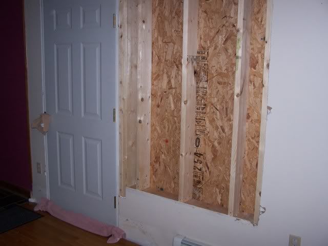

Now from in the house. I still need to insulate and blue board and get someone to skimcoat it. I also have to rewire the outlet on the left . It was connected to the one on the right. I was all set to do it but only had 14/2 and its wired with 12/2. That was a surpirse.
http://i172.photobucket.com/albums/w...sMonday003.jpg

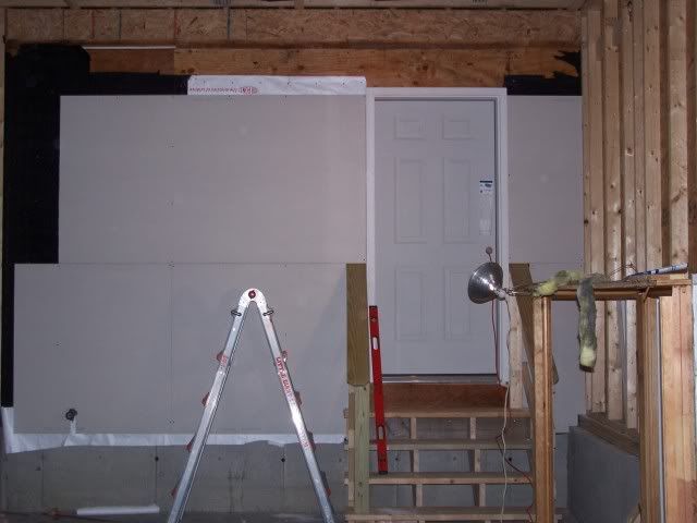

Yesterday they installed the fire rated sheet rock on the wall between the house and garage. It had to go all the way up to the roof because I'm not going to finnish the rest of the insulation and sheet rock for a while. We also blocked the opening inside wher'e the window used to be. We insulated and put blue board so it can be plastered.
Here are some pictures.

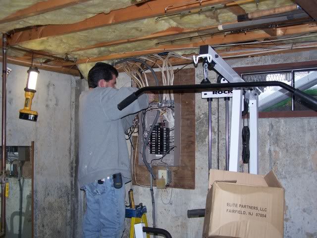

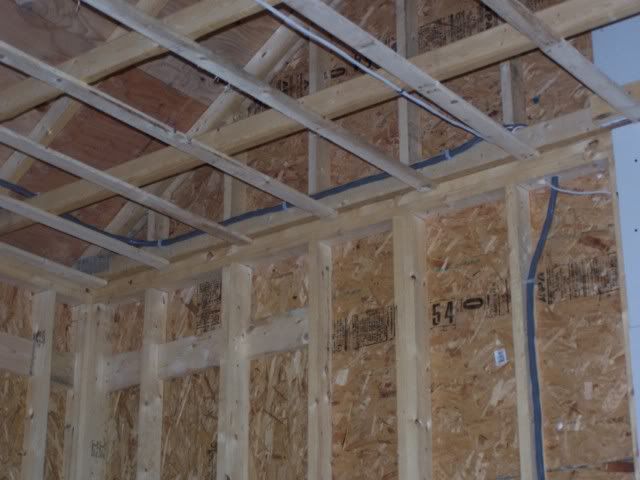

Today the electrician showed up and started the ruff in for thr electric. They ran the wire for the power to the house from the panel in the garage. The house will stay on temporary power for a while longer but will only need the connection at the meter when we're ready. The're putting one light out side the man door, plus one inside, a receptical and a heat detector. Also putting power for the Liftmaster and buttons at each door to operate the door.I'll put more later when my wallet recovers.
