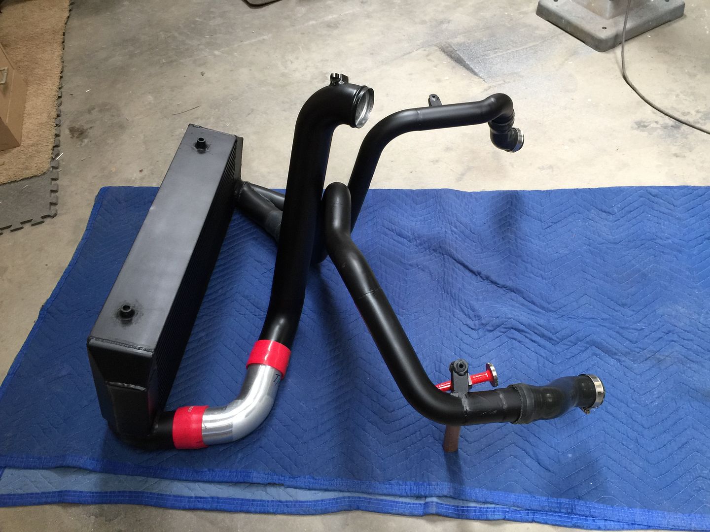

As a stock 2018 Raptor owner, beyond the garret intercooler, what other upgrades are you making to achieve the great power and MPG goals? Maybe it's time to spend more time on the fordraptorforum as I average 15mpg and no where close to that power...
thanks.

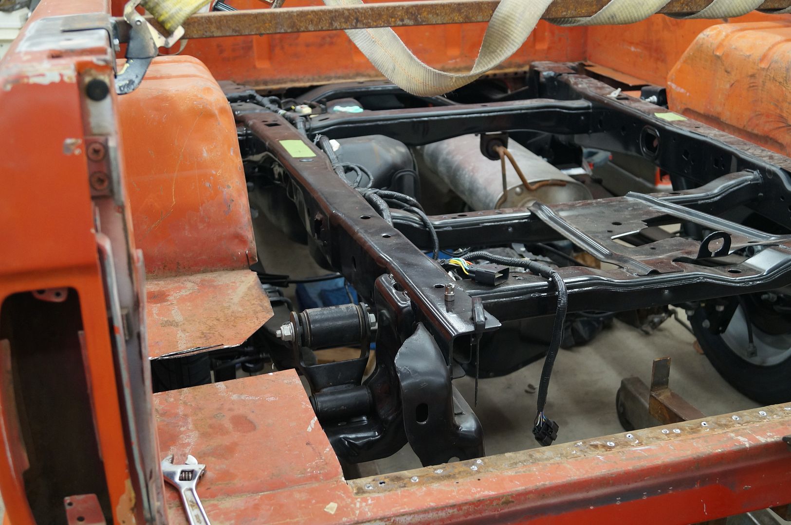

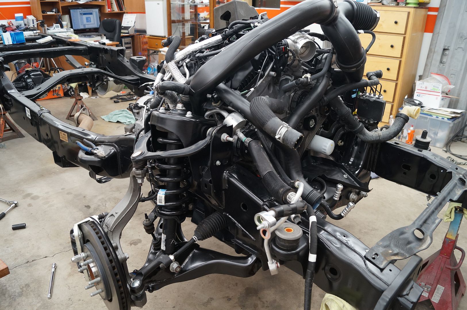

Originally Posted by TimeWarpF100 (Post 710567)

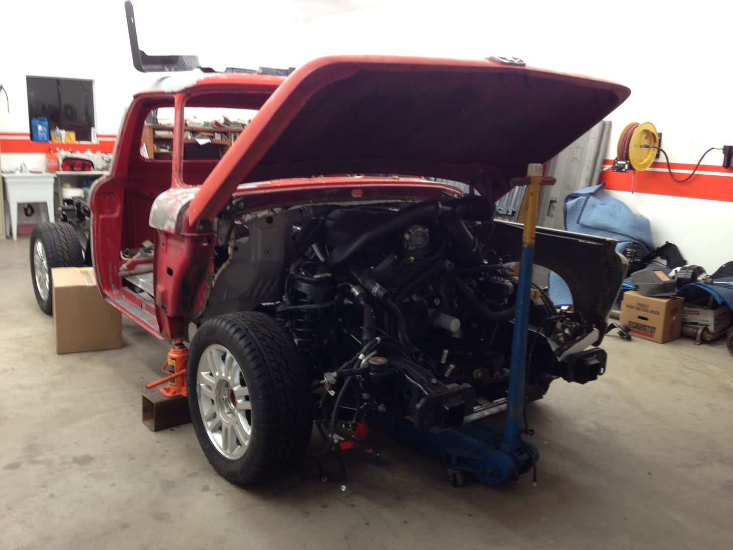

Few goals:
600 HP 600TQ @ tire on E50 (pump gas here)
25 MPG @ 65 mph
11.50 or better 1/4 mi at 120+ mph 1/4
900 mi per fuel fill
Would love to see 100 mph in 1/8 but don’t think enough power for that!

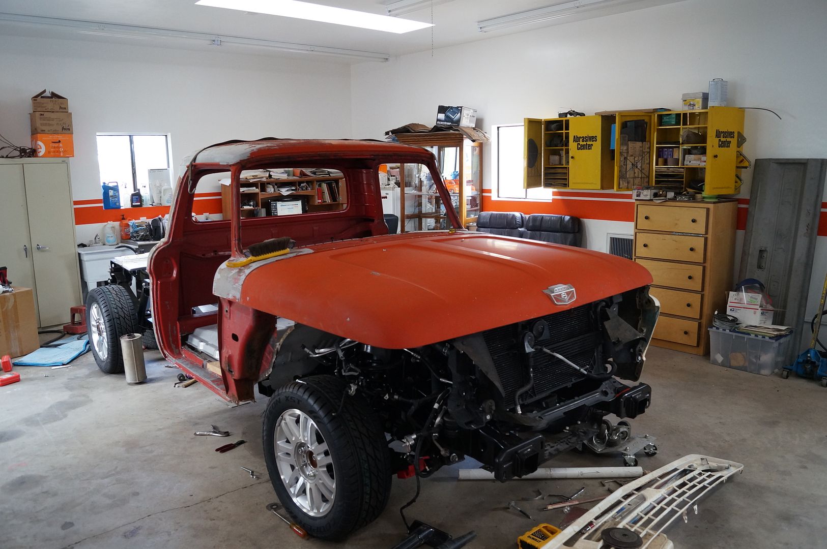

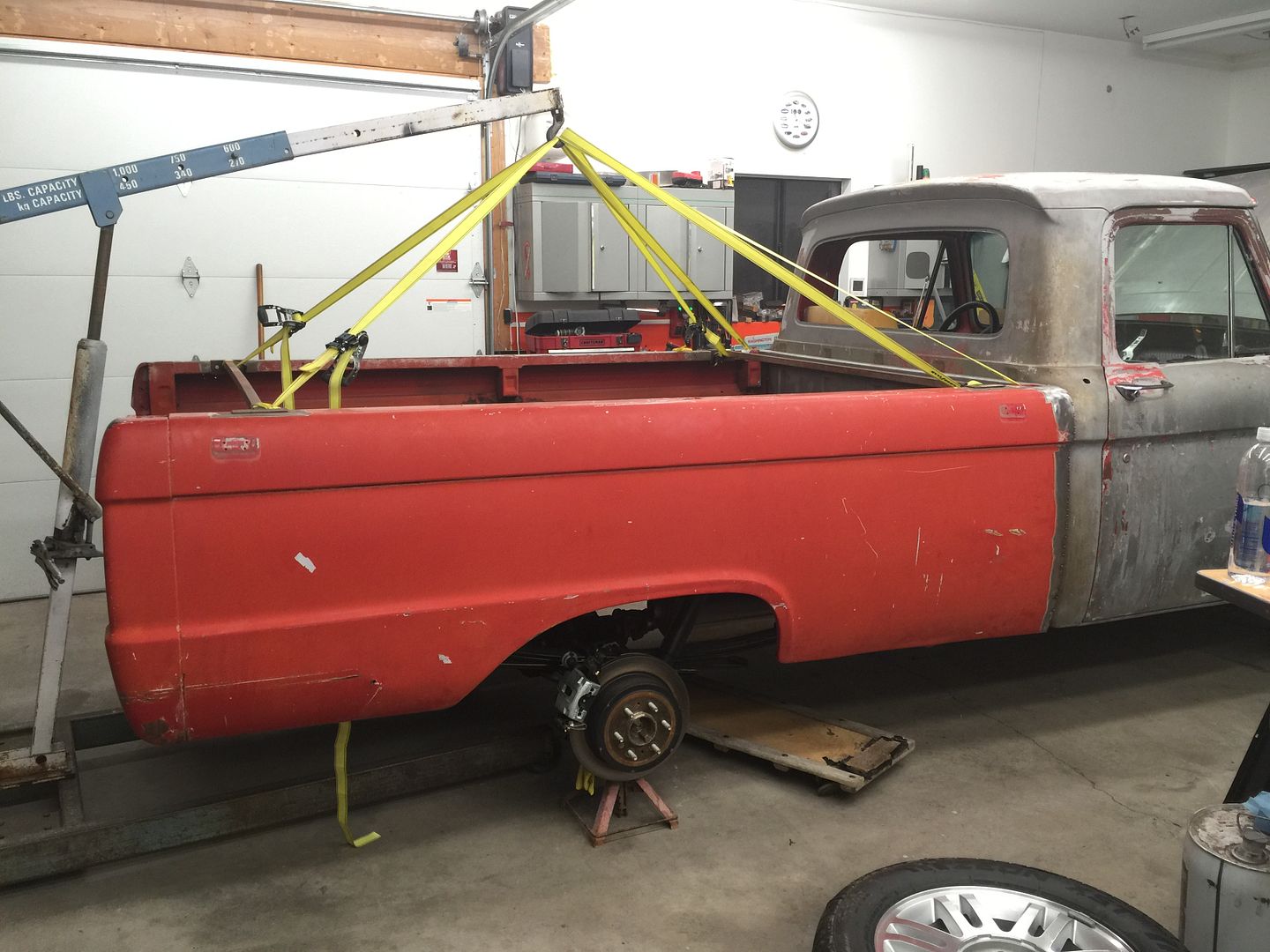

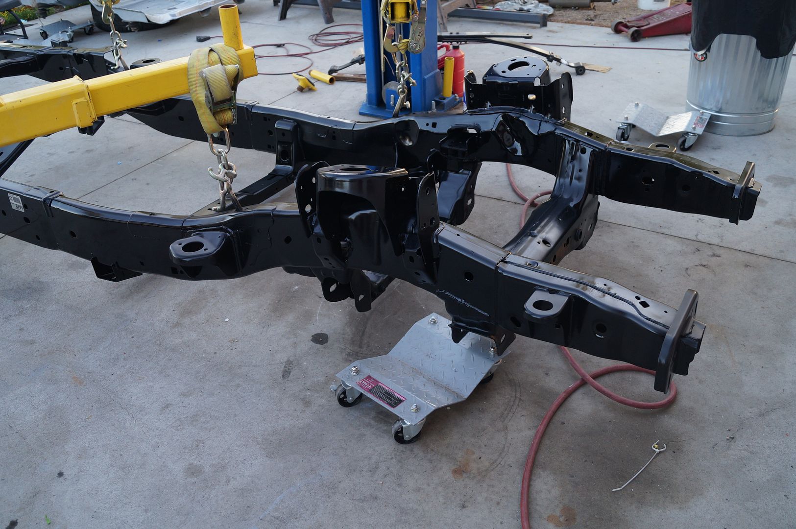

As in photo I added a 16:1 Redhead steering box.
I wanted to keep the Twin I Beam suspension so can only go so low
On ride height. No way was I going CRown Vic stuff.
No $$ for full chassis from RS.

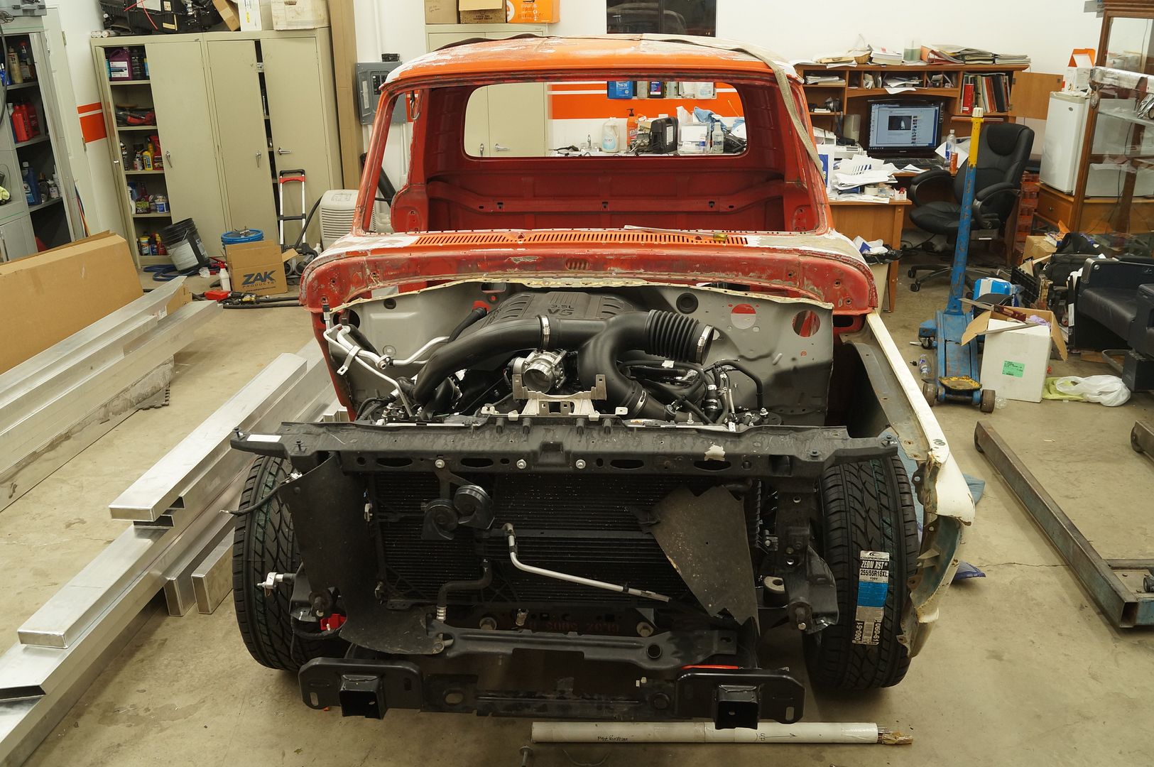

Performance wise it should be 2200 lb less than typical Raptor. That should also help MPG somewhat too. MPG wise it will need to be on 91 Octane numbers drop fair amount on E50.
Big difference for HP numbers (at least noticeable) Is my tire wheel package is under 50 lb per corner while Raptor wheel/tire typical is over 100 lb.
Will not know until I try though as think the 9" Ford axle uses more hp than the 9 3/4" Raptor version.
Huge disappointment if it does not make at least 500 RWHP on 91.
Only mods from stock are minimal each. More of a direct Ram Air for airbox, Big change in exhaust that is very similar to the 2021 Raptor. Garrett says only around 13 hp gain from cooler although here it may be more in hot summer but again I have no clue about airflow through engine bay.
I have seen other trucks make 575 at tire so figured a 25 gain with just the 1/2 weight tire wheel combo. Gearing may make a diff too. I can also run in 7th gear which is 1-1. My tire height is only 27" and am running 3.50 rear gearing.
If I look at what my other eco swap truck did it ran 13.0 @ 105 with base engine and tune only it made 420 RWHP and track weight was 4750 lb that truck I had to leave at idle or it would just spin. Much better and larger tires on this one. Adding 150hp and taking away 800+ lbs of weight should get me to 11.50's. If It will make 600 RWHP and I can get it to hook and leave on boost it may net me a 10 second quarter mile. Not sure how the engine will hold up to that HP level (Pistons/Rods) All I want is a long distance cruiser that has acceptable performance, MPG and long distance cruising. Truck looks decent and is reliable.
So goals are from past experience with ecoswap. I think just the tire size alone will be huge for MPG, weight and other factors should be huge too.

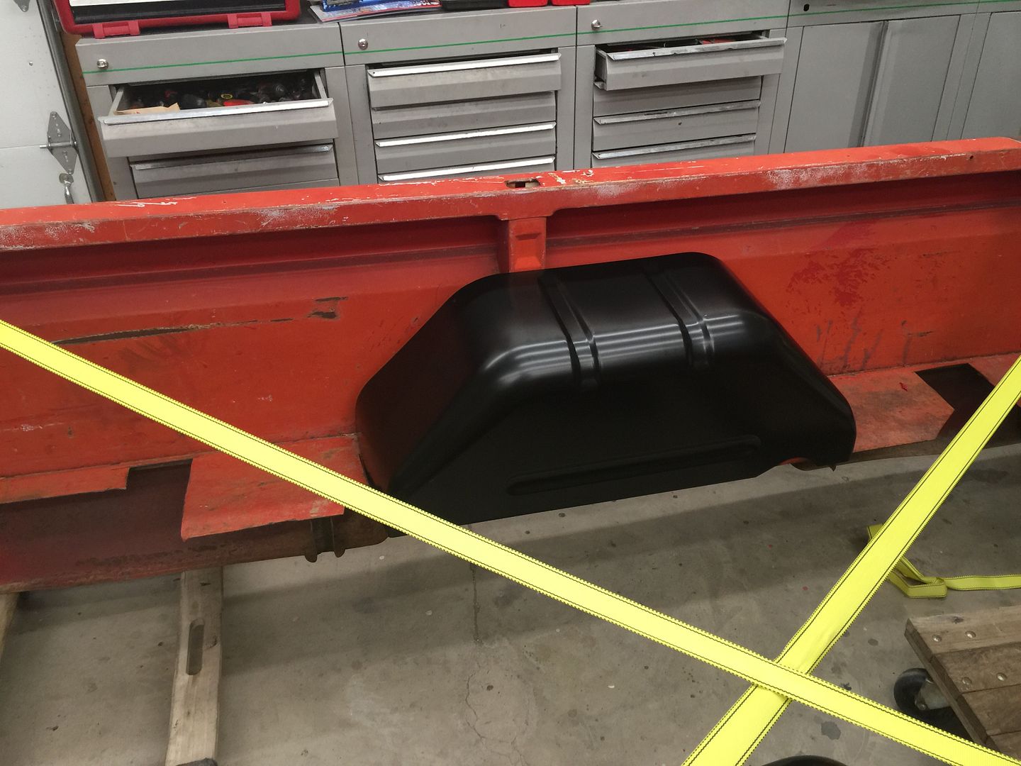

TimeWarpF100 09-19-2022 09:46 AM
7 Attachment(s)
Originally Posted by ScotI (Post 716770)
Ooooo.... Post up some images.
1966 N700 CrewCab
Built by Louisville KY truck plant june 1966 for the Northern Pacific Railway for use as a high rail truck. Dump bed too.
I found it hiding behind this chicken shed where it sat at least 31 yrs. Bringing it back to life.
Although a bunch more costly decided to go original vs taking cab and dropping on something else ruining the Railroad history at same time.
For well over 30 yrs the decal on door was covered in white paint protecting it from the elements. I was able to figure out how to remove white paint revealing the mint decal underneath.
Long history this truck has.
