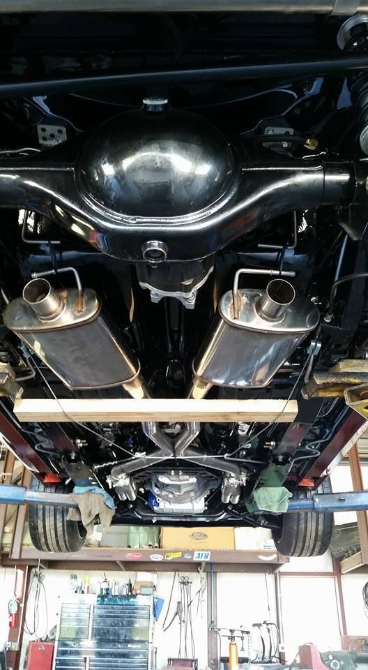

randy 08-04-2015 09:21 PM
ls3/ 480hp gm ls3
2 1/2 exhaust or 3"?????
I need to update this thread soon.
Lots of work is done
ls3/480hp t56 installed
Fuel and brake lines installed
Fuel lines converted to -6an
Hydroboost with wildwood master cylinder installed. Using a art morrison ( great clearance and much better than wilwoods kit) wilwood proportioning valve kit
Kwik AC bracket with corvette accessories installed
Tunnel is raised using chris alston t56 tunnel
Finch dual vent installed
DSE battery relocation kit and bulk heads installed
Holley t56 crossmember ( fit like ****) modified it and now it works great
Holley black billet fuel rails are on the way. Will be installed this week
Fuel system will be completed and all brake lines this weekend. After that time for wiring and maybe hear it run?????

randy 08-06-2015 06:19 PM
Originally Posted by MCB Matt (Post 613095)
You might as well go 3" if the cross member will allow. I have heard about quite a few guys not getting along with that cross member! What did you have to do to it to make it work?
Great to see the car finally close to done!!
Matt
Cut a lot out of it. First the crossmember was touching the floor. Only bairly. I had to cut the top down. In order to get to the 3 degree angle i had to cut underneath it exhaust cut outs. The headers were in more than the arches so i had to remove even more metal and offset the crossmember to the right side of the engine. Total PITA.

randy 08-07-2015 03:14 PM
Originally Posted by paulk68 (Post 613220)
well this sucks to see, I ordered this crossmember as well for my swap.I was looking back through your thread and I saw you had a hurst driveline crossmember then you said you got the speedtech cross member, did you have issues with those as well?
See i want my exhaust close to the floor and to get my driveline angle at 3 degrees. This wouldn't be so bad if i wanted my exhaust to hang little but i don't and my car is slammed. Not to mention the slip on connectors with my stainless works headers didn't fit well either. the bungs location would hit the crossmember

randy 08-12-2015 07:50 PM
thoughts?
http://www.eddiemotorsports.com/prod...el-ms140-54bk/
I also purchased this dipstick handle cover. I love it love it love it. Simple for $25 and covers that ugly yellow handle
http://www.phastekperformance.com/20...120001-blk.htm
