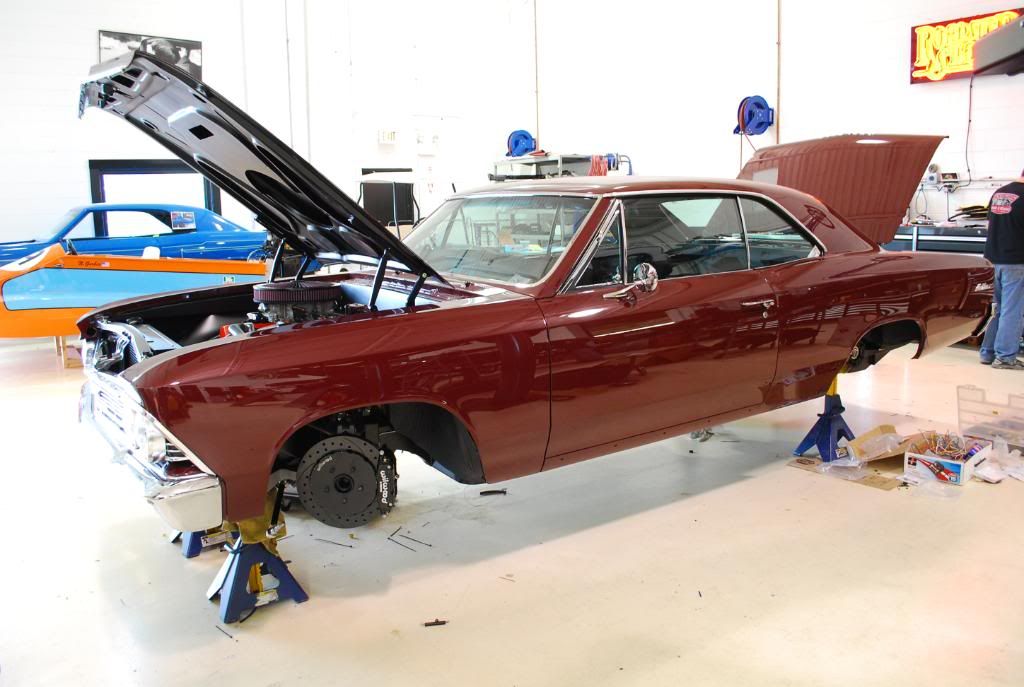

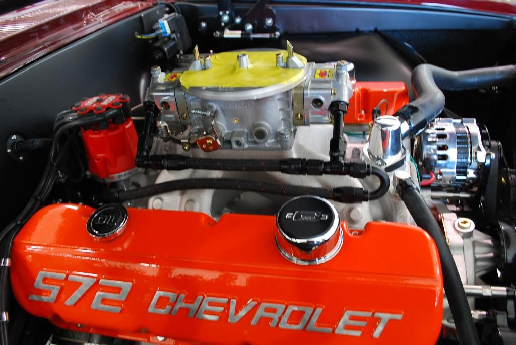

Update
[IMG]http://i1222.photobucket.com/albums/...ture221867.jpg[/IMG]
[IMG]http://i1222.photobucket.com/albums/...ture221836.jpg[/IMG]
[IMG]http://i1222.photobucket.com/albums/...ture221833.jpg[/IMG]
[IMG]http://i1222.photobucket.com/albums/...ture221831.jpg[/IMG]

waynieZ 02-15-2012 05:37 PM

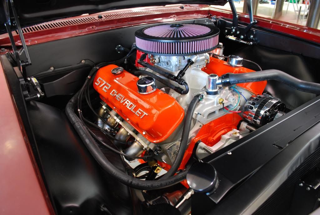

Very Nice. The engine looks sweet in there. Who's and what kind of hose is that your using for fuel line?

Roadster Shop 02-21-2012 12:55 PM
Thanks. The hose is Aeroquip
Originally Posted by gearbange (Post 396009)
Dont know if your interested, but you can take a little laquer thinner on a rag and take the lettering right off those thermo hose clamps. Kind of makes them look even better IMO.
Thanks, we use thinner on all of the hoses and clamps to get the printing off once the car is completed. The green text definitely jumps out on the clamps and is rather ugly.

G-Body 02-22-2012 09:01 AM
Whats up with the fuel line why is is looped?
Seems flipping the fuel log mount would of fixed that problem if you wanted fuel line to come from the rear looks alot out of place.

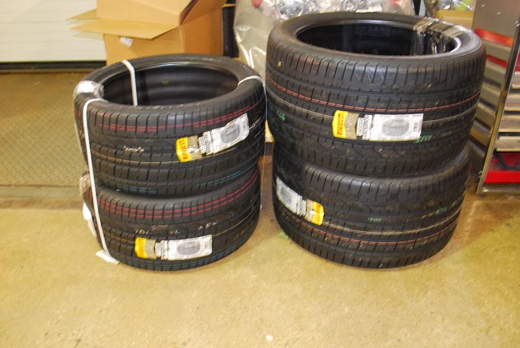

What sizes are you running on the wheels/tires? Any more updates on the blue 67 Chevelle? Looks like it's coming together in the background.
W84IT 02-23-2012 04:45 PM
The fronts at 265x35Rx18 (18x9) and rear 335x30Rx20 (20x12)
The regulator is mounted on the firewall behind the passenger side head so the fuel lines visible are not running up the firewall and then draping over the motor. There is not enough room between the regulator and the back of the fuel rail to run a line direct. So, it is run to the front of the fuel rail.
We are running 18x9 and 20x12's on this car. The Blue 67 will hopefully be out this summer if we can find some free time to work on it. The car is probably about 2-3 weeks away from being ready for upholstery. It is just hard finding those 2-3 weeks.

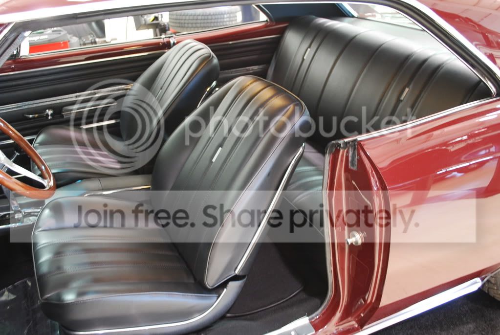

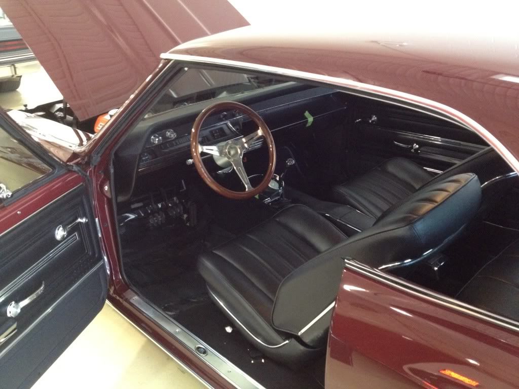

Got the car back from the upholstery
[IMG]http://i1222.photobucket.com/albums/.../interior1.jpg[/IMG]
[IMG]http://i1222.photobucket.com/albums/.../interior2.jpg[/IMG]
[IMG]http://i1222.photobucket.com/albums/.../interior3.jpg[/IMG]
INTMD8 03-31-2012 01:45 PM
Very nice! Who did the work?
214Chevy 03-31-2012 03:04 PM
Very classy, not too overboard.:yes: :yes:
coolwelder62 03-31-2012 03:23 PM
1st.Class guy's.:thumbsup: :thumbsup: Man I love that color.:thumbsup:
waynieZ 03-31-2012 05:18 PM
Very Nice, they did a great job.

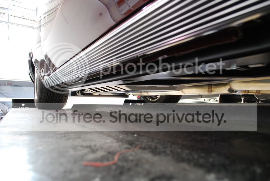

The car was on a lift today so I managed to get a couple of shots of the underside / chassis :
http://i563.photobucket.com/albums/s...e/DSC_0043.jpg
http://i563.photobucket.com/albums/s...e/DSC_0045.jpg
http://i563.photobucket.com/albums/s...e/DSC_0055.jpg
http://i563.photobucket.com/albums/s...e/DSC_0064.jpg
http://i563.photobucket.com/albums/s...e/DSC_0060.jpg
http://i563.photobucket.com/albums/s...e/DSC_0069.jpg
http://i563.photobucket.com/albums/s...e/DSC_0077.jpg

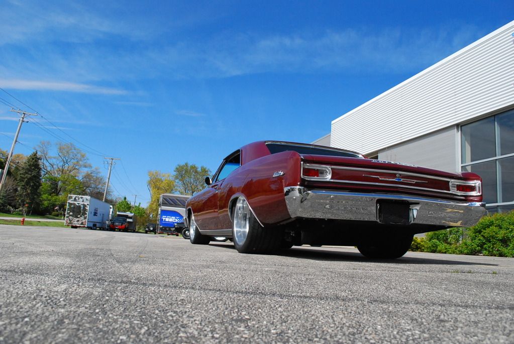

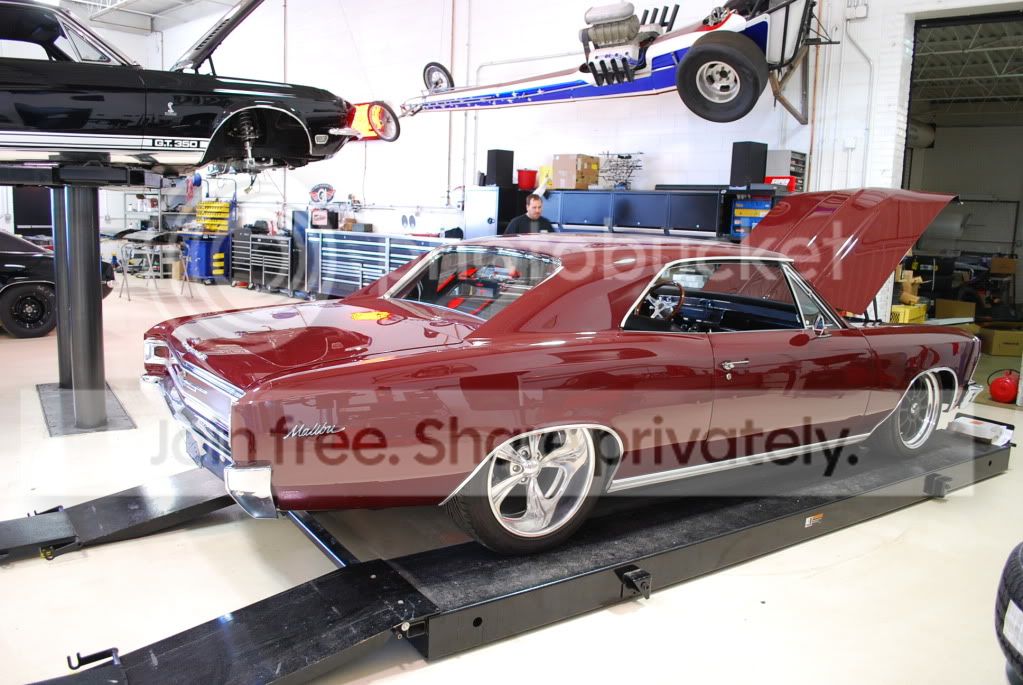

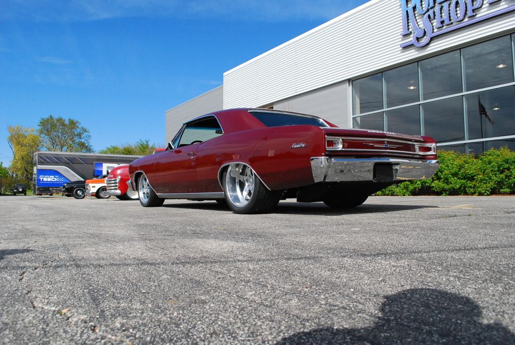

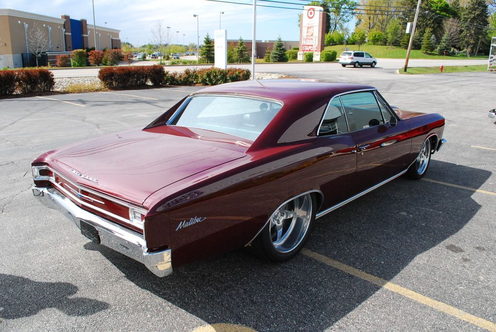

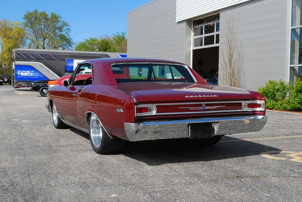

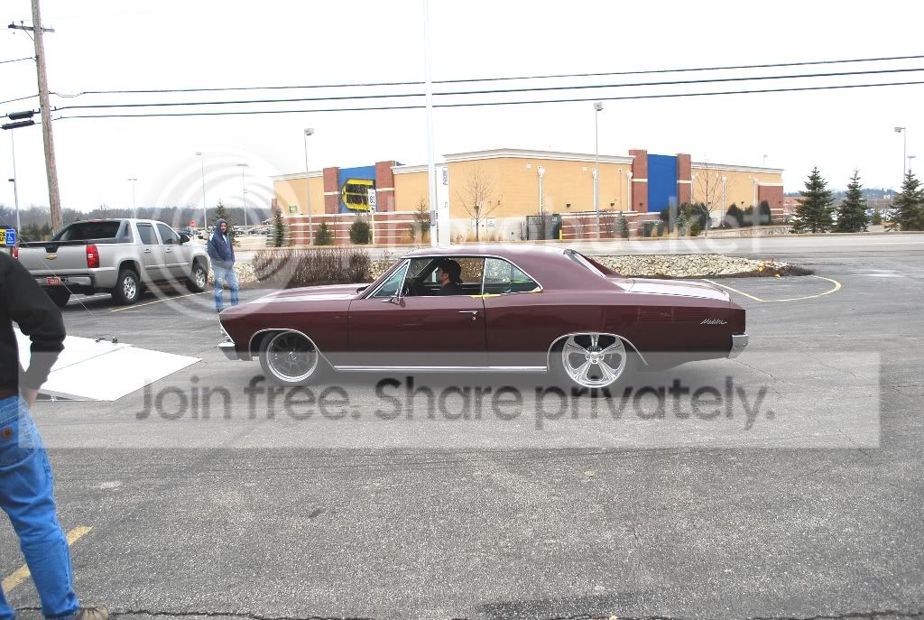

W84IT 04-28-2012 01:03 PM
Wheels on and test driving, almost done!
[IMG]http://i1222.photobucket.com/albums/...e/DSC_0017.jpg[/IMG]
[IMG]http://i1222.photobucket.com/albums/...e/DSC_0016.jpg[/IMG]
[IMG]http://i1222.photobucket.com/albums/...e/DSC_0014.jpg[/IMG]
[IMG]http://i1222.photobucket.com/albums/...e/DSC_0013.jpg[/IMG]
[IMG]http://i1222.photobucket.com/albums/...e/DSC_0012.jpg[/IMG]
[IMG]http://i1222.photobucket.com/albums/...e/DSC_0009.jpg[/IMG]
[IMG]http://i1222.photobucket.com/albums/...e/DSC_0008.jpg[/IMG]
FETorino 04-28-2012 01:24 PM
Wow she really did turn out beautiful. I mean what's not to like. :hail:
:question: What size wheel and tire combo did you end up with?
W84IT 04-28-2012 01:33 PM
Fronts: 18x10 275x30x18
Rear: 20x12 335x30x20
Rick D 04-28-2012 06:10 PM
WOW that turned out great really love this one!
